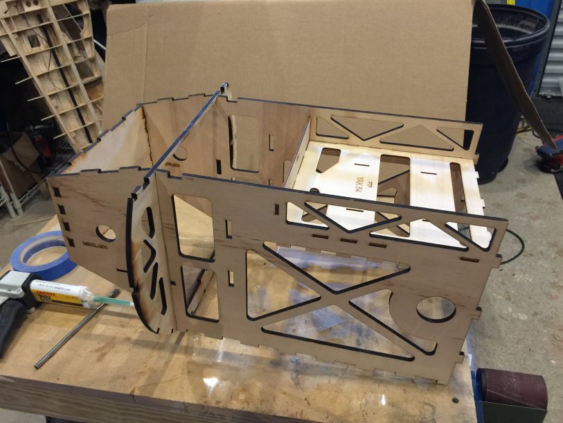

Step 1 from manual.
Dry fit tail pieces...
then glue...
I am using epoxy glue, that cures in about 24 hours. Very slow glue.
Vpoxy. Sets in 1 hour. But it will be in the clamps for 24 hours or so.
Then glue..

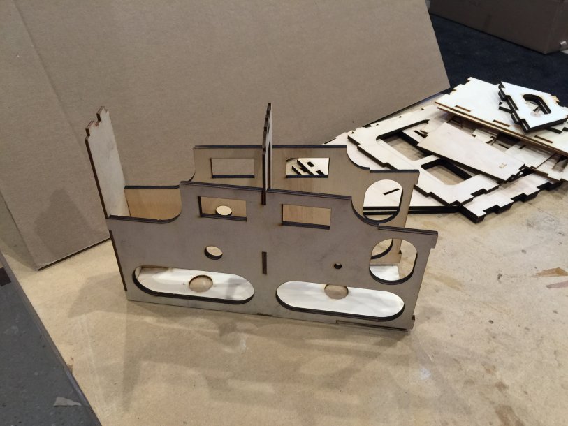

however, steps, important to know, for all others who want to build this kit.
1st, look at both sides, the right side is shorter than the left side.
Also, the firewall is higher on the right side than on the left side.
Must know this orientation to make it properly.
2nd, F1 former, the ring like structure, it has to be assembled in following order
insert right side into F1, then push out into tabs. gets locked in.
then left side into F1. (could go either way, i chose right side 1st), this order does not matter.
Ok, then insert firewall. Then the MBB (motor box bottom).
then, insert the gas tank tray, then last is the front of the gas tank tray piece.

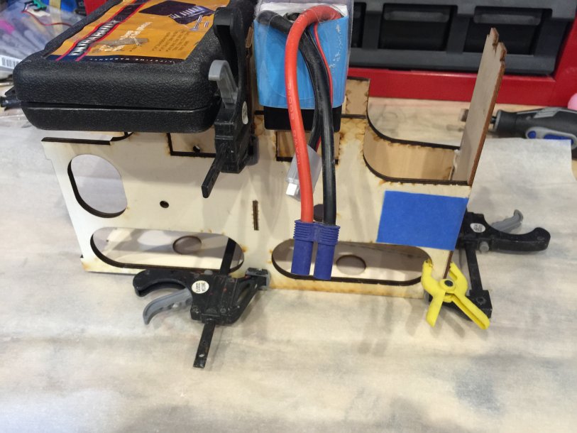

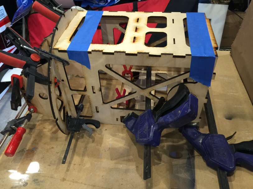

Once happy with dry fit, time to glue all these parts together.
However, the gear plate, will not be glued yet, but, should be put in place and held with tape or clamps during the glue in process/clamping. to assure it remains square.
