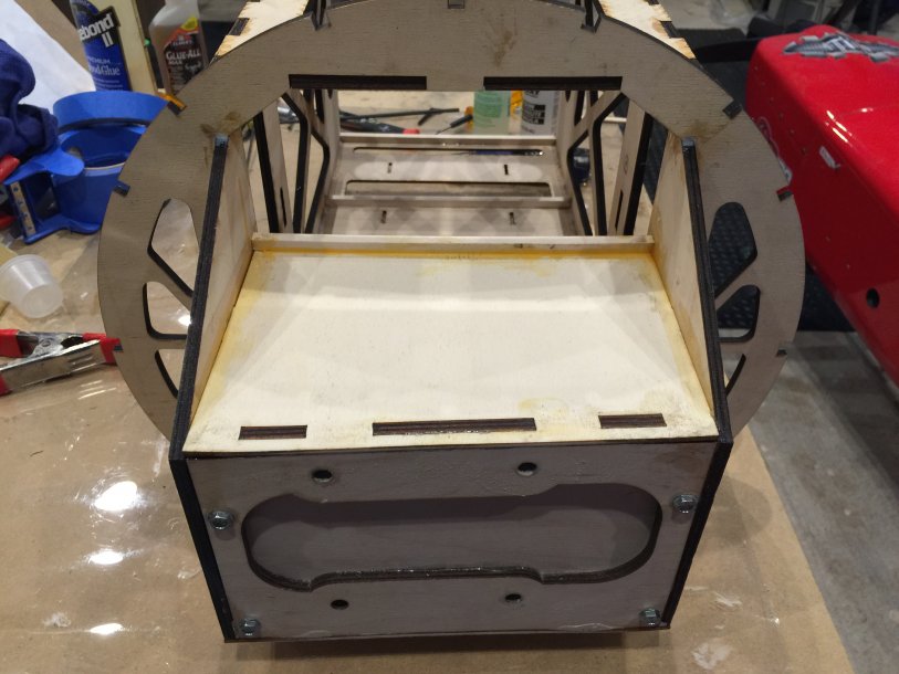

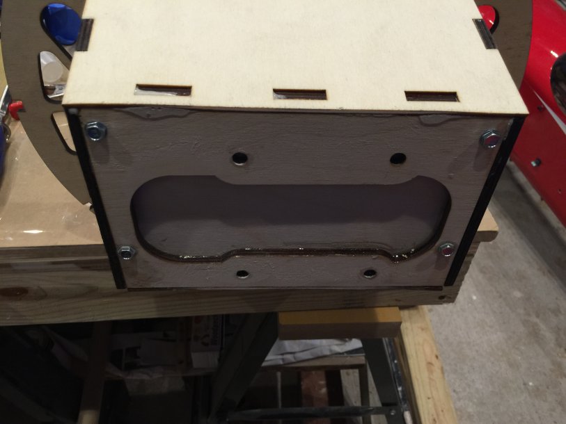

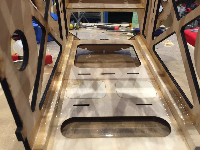

Inside of gear plate/mb area is strengthened with 1/2" hardwood that runs from front to back. The gear screws will go thru these hardwood pieces.

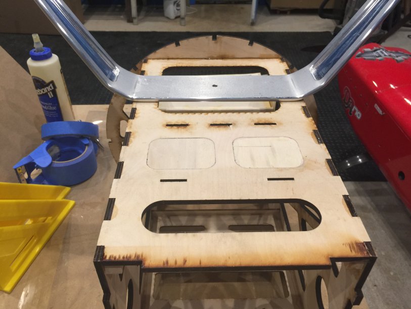

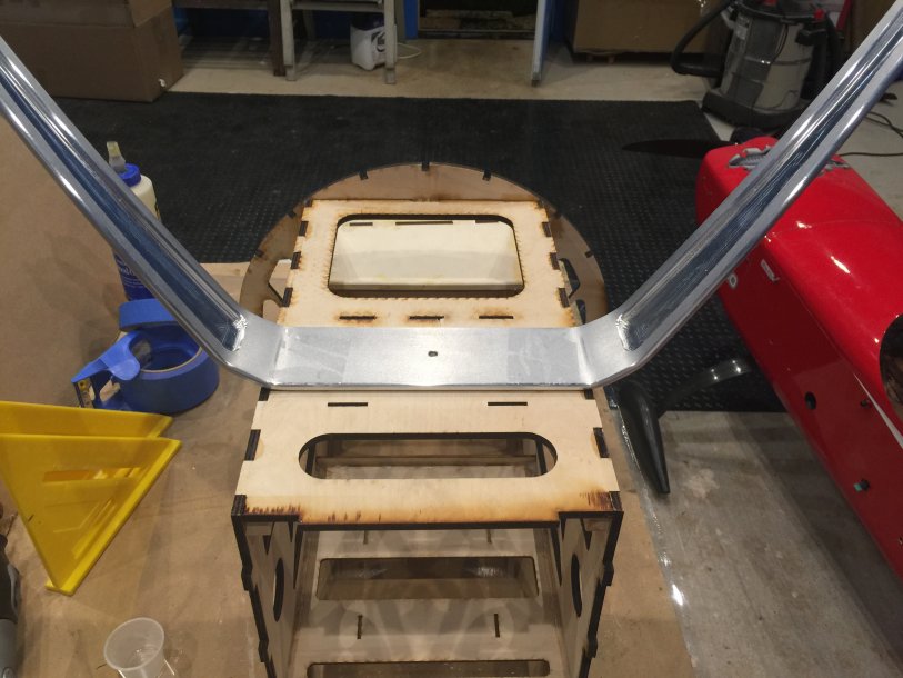

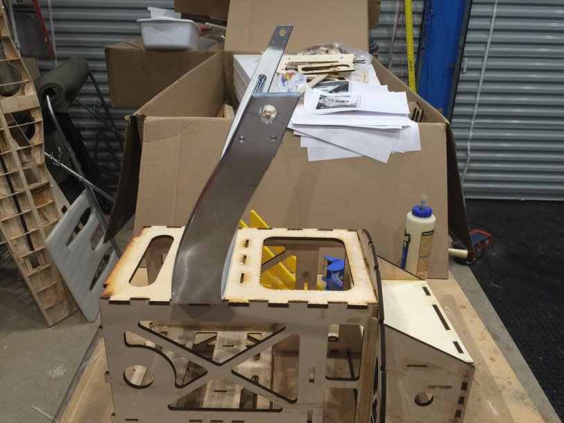

I am ordering a carbon fiber landing gear from Bill Hempel, this is just what it will look like... My reason being, that , priming and painting this surface is quite tricky, and no matter what I do, when this bird lands, and this flexes, the paint will invariable crack.
capthis
I personally like the aluminum gear as it bends and doesn't break like the carbon does. If you do bend it it's true the paint can flake off, but it's easy to touch back up. I get lazy and don't even paint the gear some times! :)
I would think you would want both header lengths to be the same whether you run cans or pipes. If you are used to flying cans or pipes, you probably won't like stock mufflers as they are much louder.
I really like the shape of that gear plus it's been lightened!
I like aluminum gear for the same reason that it flexs. I will prolly never paint my gear anyways I like the look of them being all sanded down to about 2000 grit paper and then polished up. Nice and shiney.

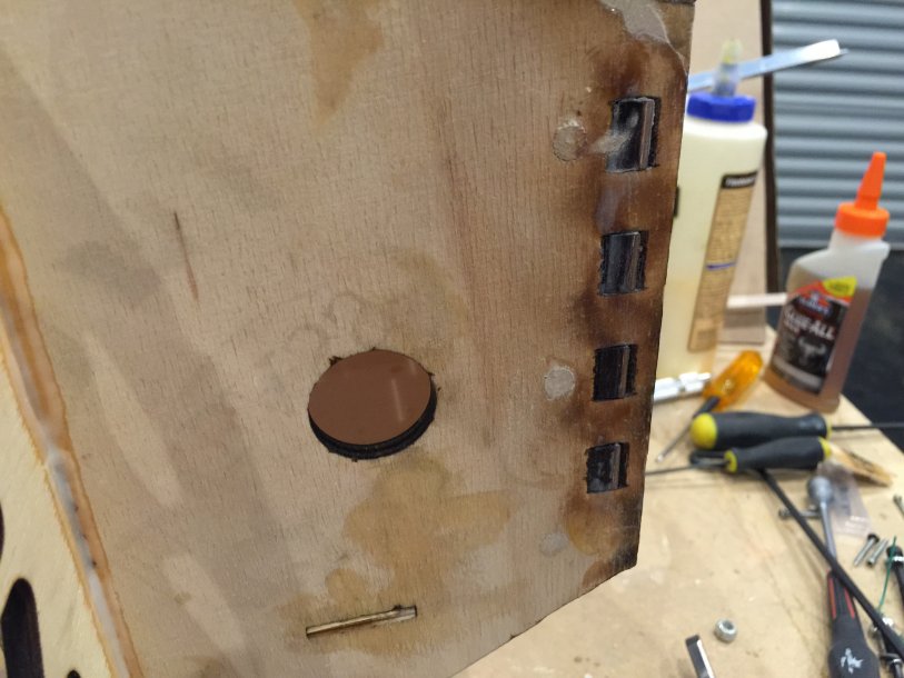

The firewall is glued in. I pinned the firewall from the side using wood dowels, and the front was compressed with these #10 screws. The screws worked real well. I also used glue around the threads of the screws.

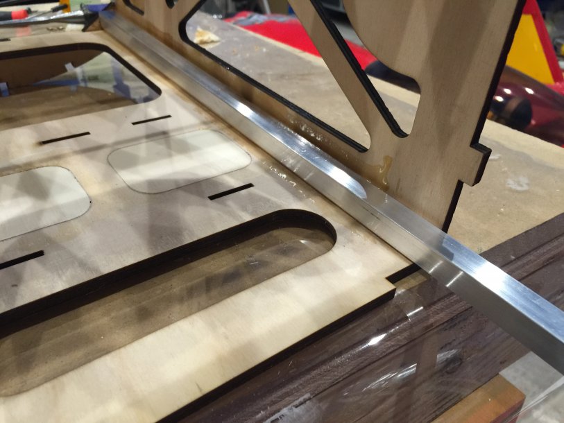

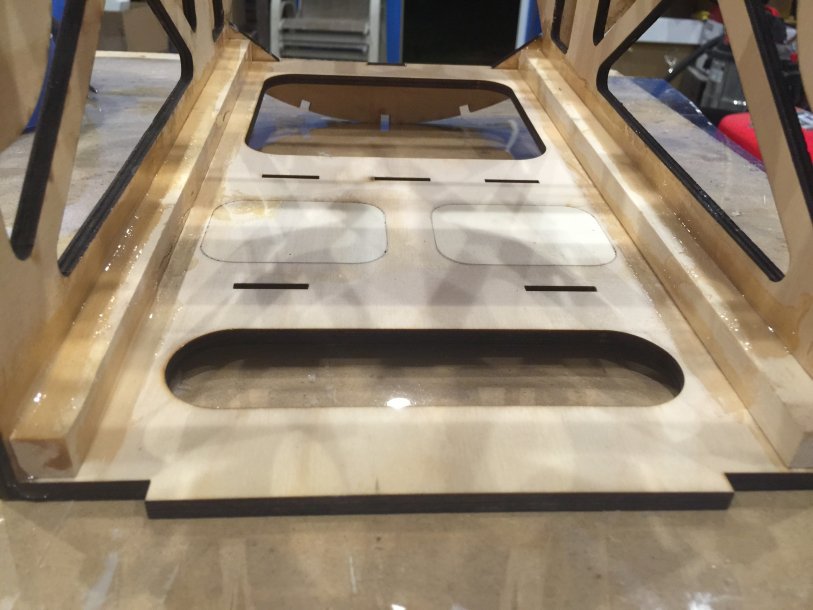

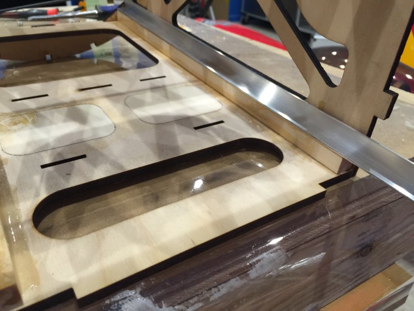

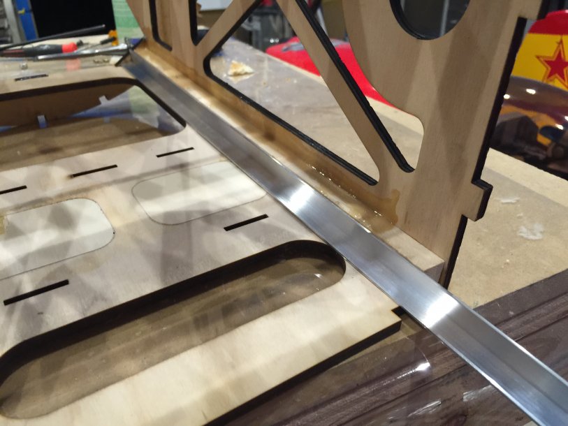

Here is my dilemma. And i need to be very careful here.
I want to beef up the landing gear area. And I do not know where to put the angled aluminum.
I have ordered 1/8 " which is 1/2"
The ones in the picture are 1/16", which will not be used.
Anyone have any suggestions. Considering the fact, that i will be installing canisters.
Cam, I have used another 1/2" x 1/2" oak piece instead of the Al I used 24hr epoxy to glue them together - one of top of the other. I believe the glue holds better to wood than it does to Al but who really knows? Also, if you have to glue your canister supports in then you will have wood to wood glue joints AND they are easier to dremel to the correct size if need be.
