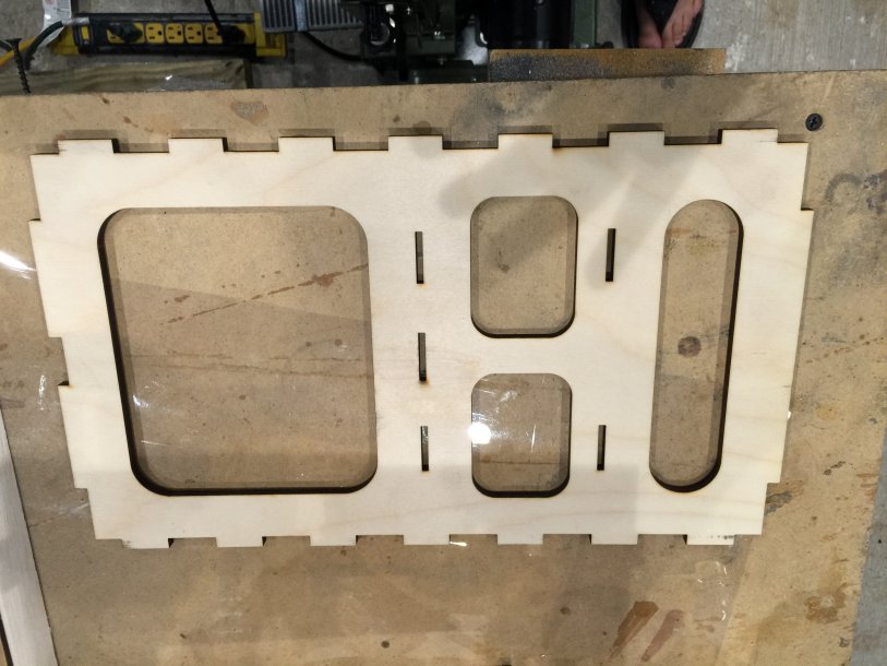

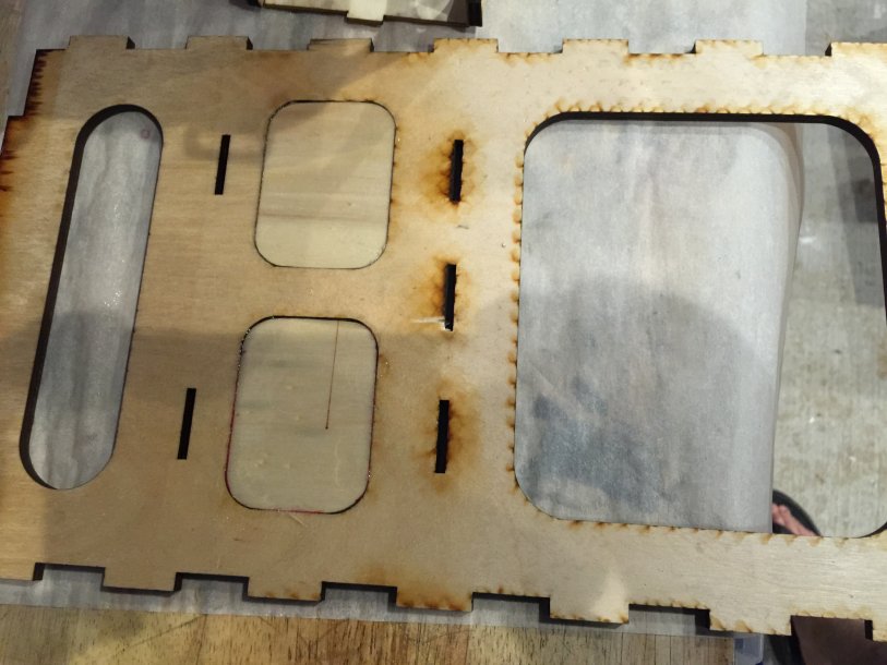

I was looking at the plans and the manual, and i noticed the gear plate i have looks slightly different than the gear plate in the manual.
Mine has three openings and the ones in the manual has 2 openings.

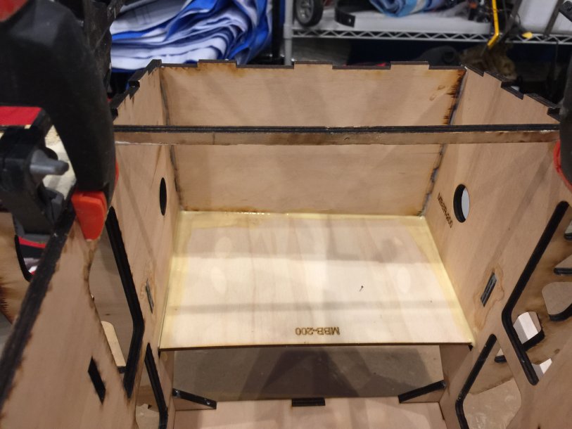

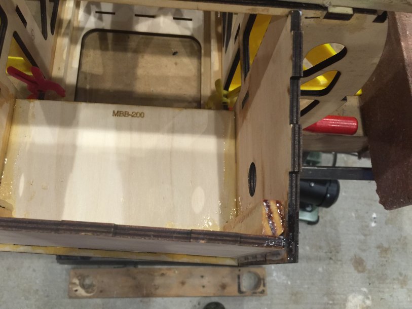

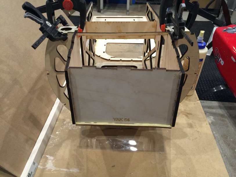

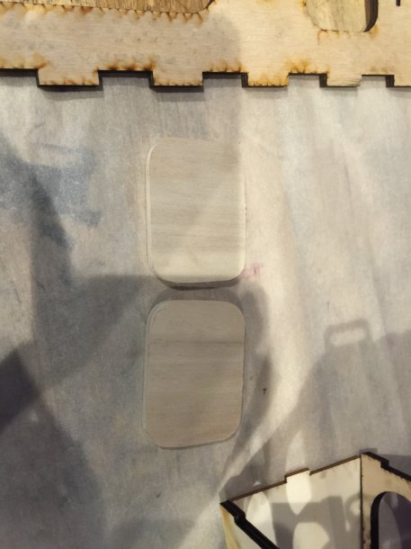

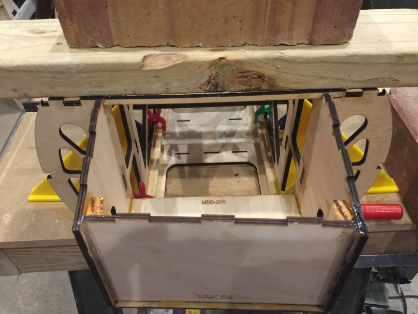

The middle pair of openings is directly at the level of the landing gear. I decided to beef this area up. I cut some 1/4" thick plywood, and have glued them in.
