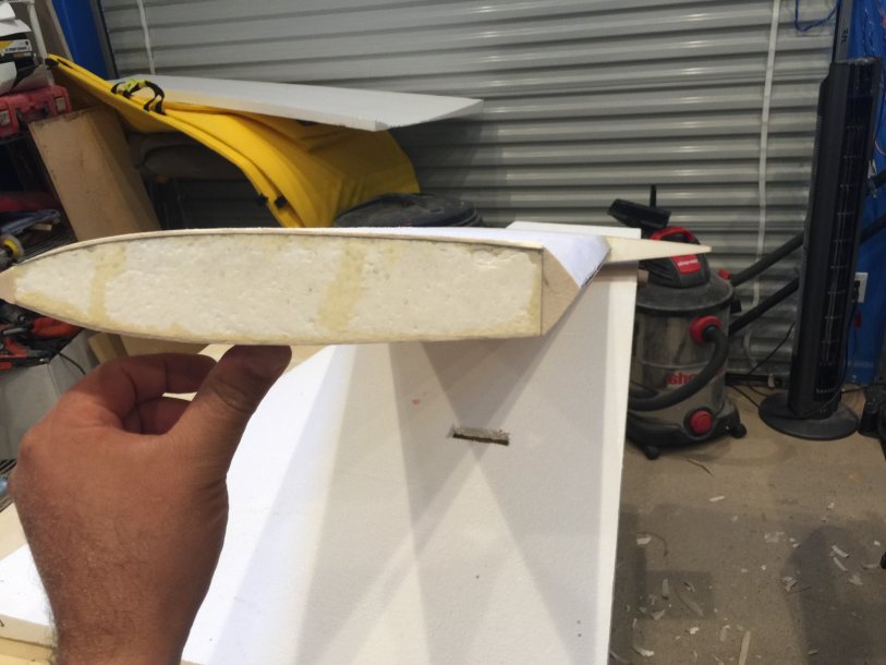

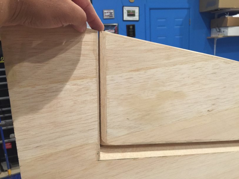

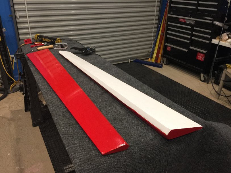

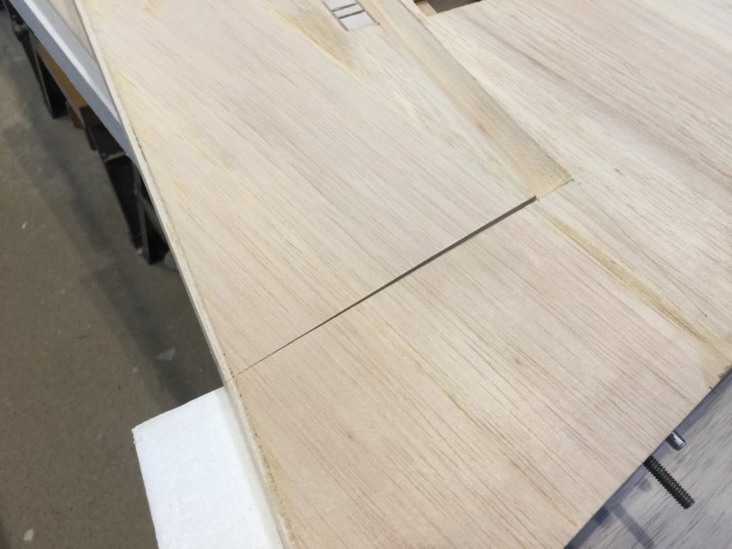

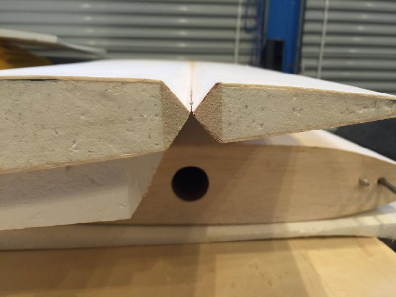

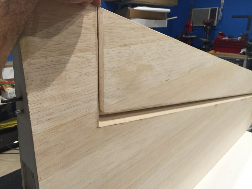

Just got it hinged, beveled, and now capped. Waiting for caps to cure, then sand them flush.

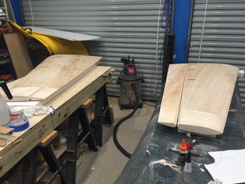

The wings are ready now for a good final sanding, then, to thoroughly remove all the dust from both wings/ailerons. Then, remove the wings from the shop (take them inside the house (dining room table), and again, repeat the removal of dust (brush, tack cloth, compressed air, wipe down with alcohol), then covering can resume. Should be within 3 months now.
Something wet to help take the last smallest particles, but, that will evaporate ASAP. If it is water, it can cause further swelling. Someone else suggested using mineral spirits, but I was concerned it would or could melt the foam under.

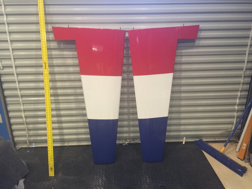

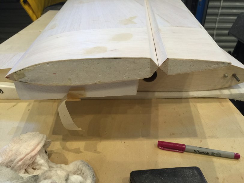

Just finished covering the bottom of the wings. All that is needed now is to cover the top of the wings!!!
