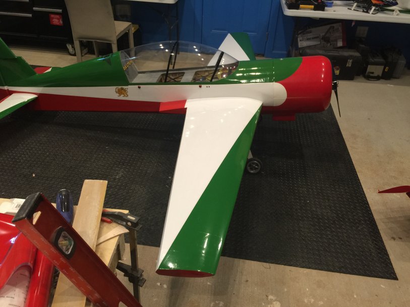

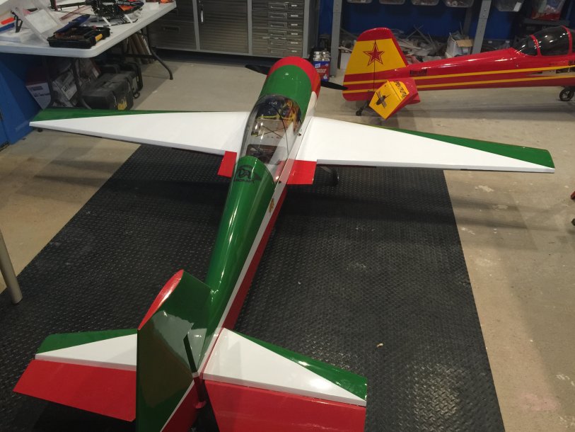

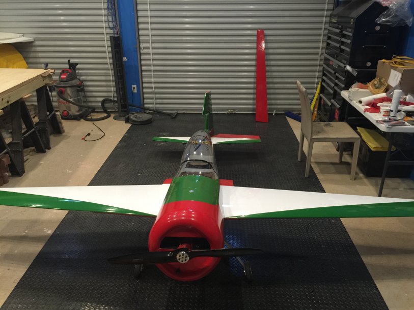

This is one big bird!!! Al,most done.

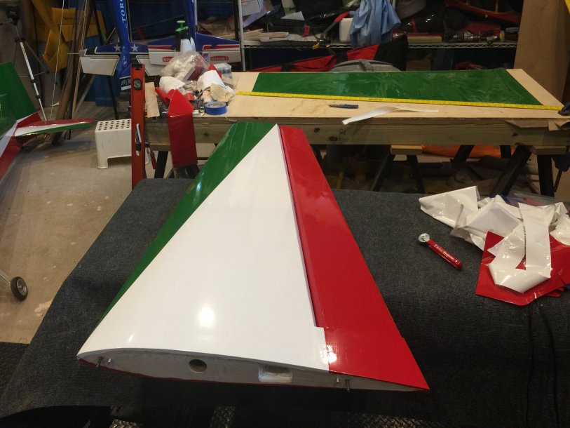

Nest step, glue the point hinges in and then install the servos. Also, we need to seal the hinge gaps and make the turnbuckles for the servo arm to control horn. Using 6-32 monster ball links.

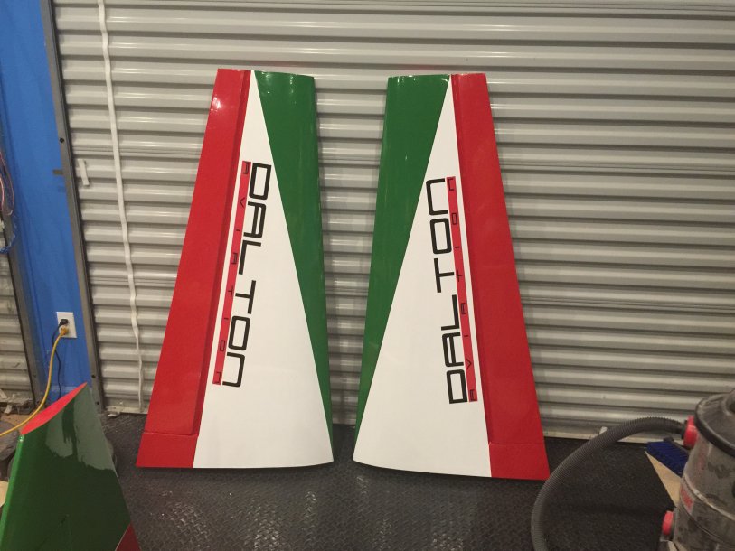

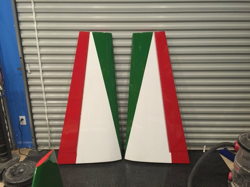

Wings are almost finished.
1. seal the hinge gap
2. install the aileron servos
3. make the push rods with 6-32 rods and CF tubes
4. balance & match the servos
then, check the airplanes CG point.
