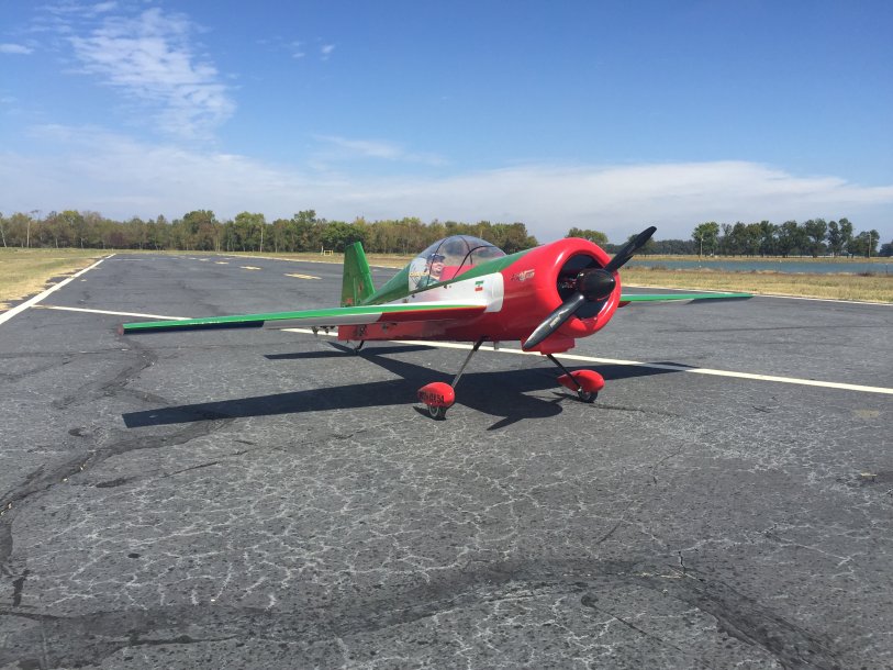

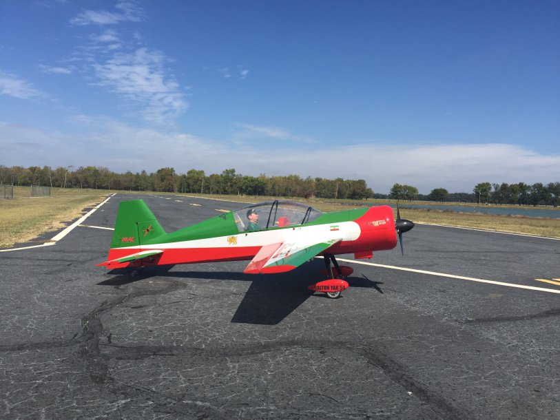

Today was the maiden, and a total success!
WOW, flies much nicer, to me, than the extra. Slows down good on downlines, the snaps are way clean and quick, did not need any thrust correction., Do have slight amount of coupling, rudder to elevator. This is fixed with a mix. needed a tiny bit of up elevator as trim, as it wanted to dive slightly during level flight. After that, the airplane is just a tad nose heavy, but i will leave alone. This was fixed with elevator trim. The spin entry is wow!! awesome. Yep, still needs a good amount of trimming. Needs a tiny bit for a down line mix to keep it from pulling out. OTW, i am very happy. And, landing her, wow, she floats in!!
I will post some telemetry soon. My buddy made a boo boo, and he did not turn on the camera to film the take off and landing. Oh well. What a shame, i was hoping he could have caught it on film. HE did manage to film me turning it on!
