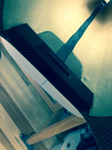

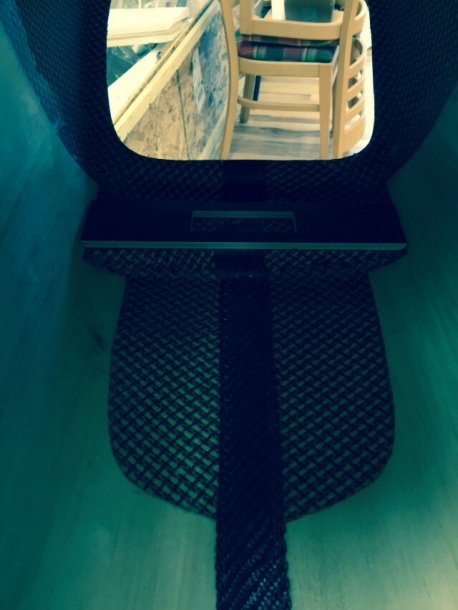

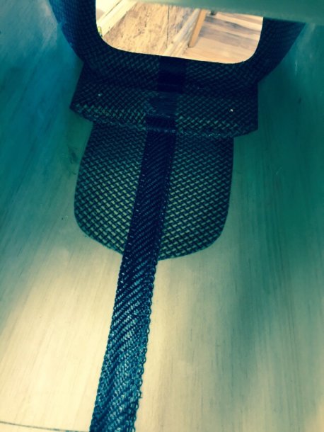

The landing gear mount in the recessed slot in the bottom of the aircraft...these photos show both the inside of the fuse as it comes as well as the landing gear doubler that gives you something to bolt to. This doubler has been epoxied in, and there is a really neat structure to go with that but you'll have to wait 'til this epoxy dries so I can fit those reinforcement structures.

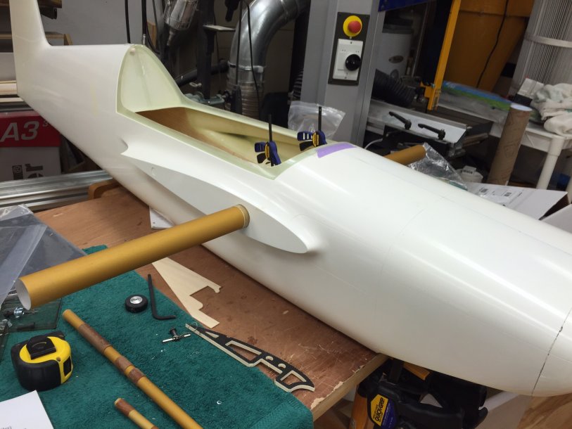

Also got,the wing tube roughed into the fuse as well today, need a bit of work to insure the rear of the fuse is supported and rigid so I can align the vertical stab and and the wing tube precisely!

Looks great. I'm not sure if you've worked much with the composites, but make sure you really skuff up the surface of the parts you're going to Hysol together.
Also, you may want to wash the fuse in a shower/bathtub before you try to glue much in it. I'm sure the PVA is still on the fuse and you need to wash that off before you stuff the parts, or you'll have PVA in the joints, which is mold release.

Thanks...never considered the mold release...but have been busy scuffing away!
