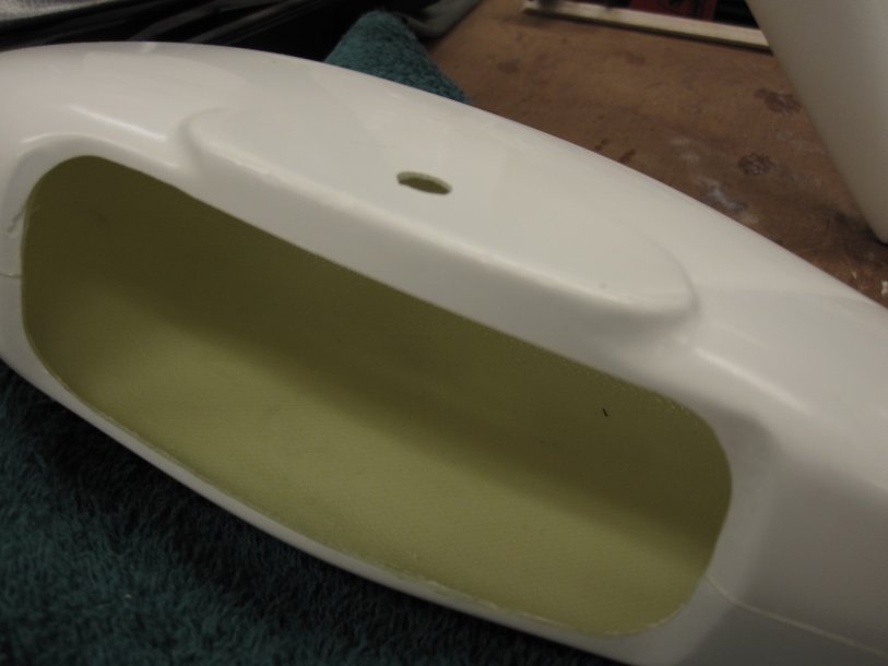

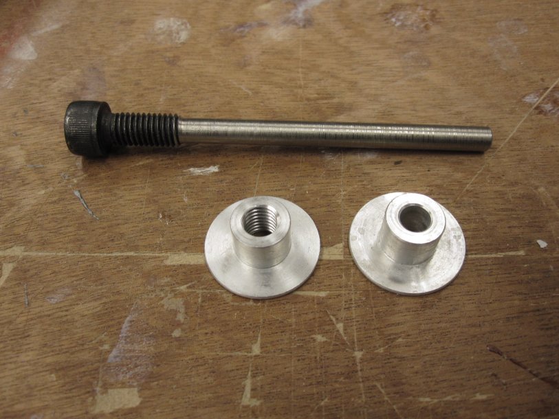

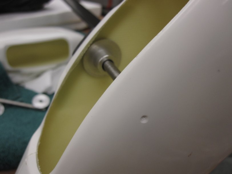

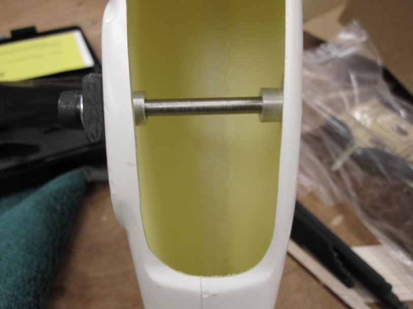

I think it's gonna be pretty simple Alky6...I'll just cut 2 flat plates that slide into the opposing surfaces, and overlap in the middle where the bearings seat and the rod runs through it for each hinge point...The most important point to me is that this system will allow me to have the control surface seated into the flight surface and have a cover that extends beyond the back edge of the flight surface like full scale...and also giving me a hinge gap seal by default (and also making the hinges/gap much less visible.
I'll create the extensions on the rear of the flight surfaces by cutting thin composite sheet into a strip...I'll router a recess in for this sheet to sit on the rear of the surface...and allow it to extend out beyond the rear hiding the gap. Once I fiberglass the whole wing/tail you'll never know I made the mod!
