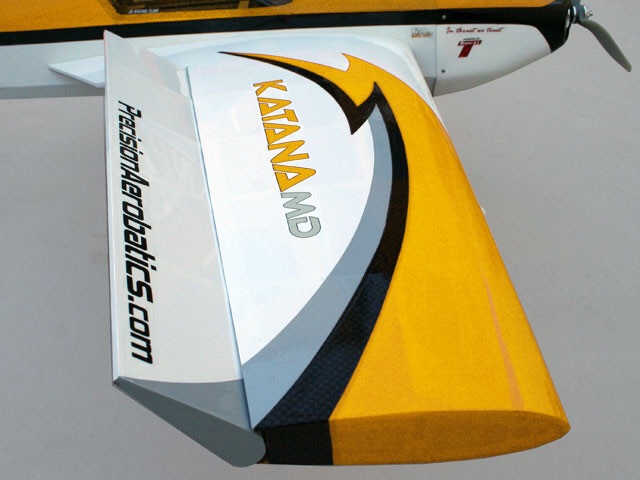

MattyMatt, just to make sure I understand what your saying...
I think you are saying I should leave the hinges V- shaped and use something like Robart hinge points, then seal the gap the traditional way. You would do this as opposed to mimicking the type of hinging used in full scale aerobatic ships where the hinges are hidden, then surfaces of the wing extend rearward, and the round LE of the aileron is inserted into that ( see image) is that a correct understanding of what you were saying or am I confused?
Thanks for the input!
MattyMatt
That is correct.

So can someone explain to me why this design concept is used/works on full scale but not on our models? I'm quite curious to hear everyone's opinions.
There are a lot of things they do that doesn't work well in RC and there are a lot of things we do that don't scale up well. It's physics.
You probably aren't aware, but many prototypes have been made with the pocket hinges, and we're not put into production because they didn't work well. It is very critical about the gap made between the front of the aileron and the back of the wing. The pivot point of the aileron...
On one particular plane we had 45 degrees of aileron throw with the pocket hinging for the plane to snap at the same speed as the second prototype with 25 degrees and the only difference was the conventional robart style hinging.
On the other side, look at horizontal stab position of almost all full scale aerobatic planes; they are at the top of the fuse. On our models, if you do this the coupling is horrible.

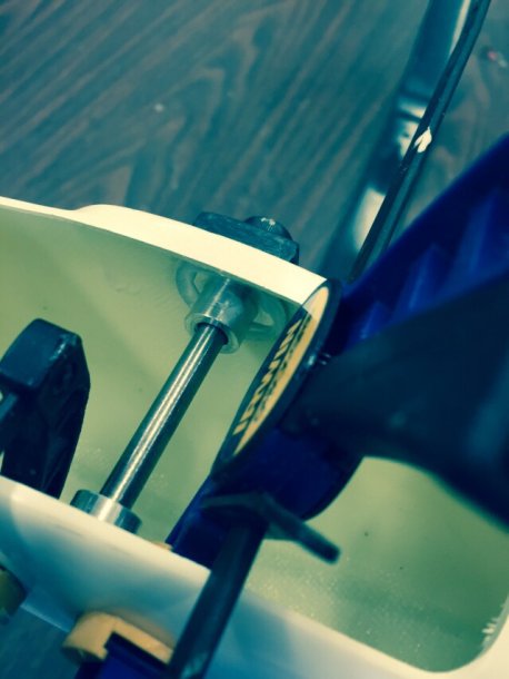

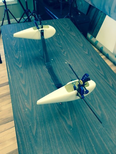

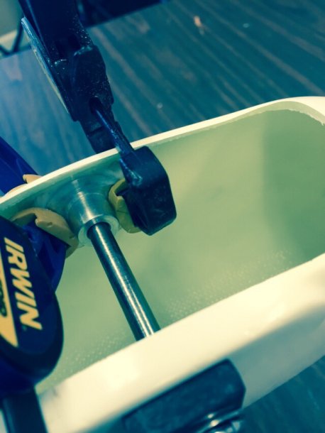

Worked on the wheel pants today...I've found working with a composite fuse is a bit like working with a greased pig...nothing to grab onto without worrying about breaking something...so I figure if I can get it up on it's gear that will help. Epoxied the inner and outer axle supports into the wheel pants. I plan to glass over these mounts for a bit more strength once the Hysol dries on this...the more I work with this mount system the more impressed I am with the idea!
