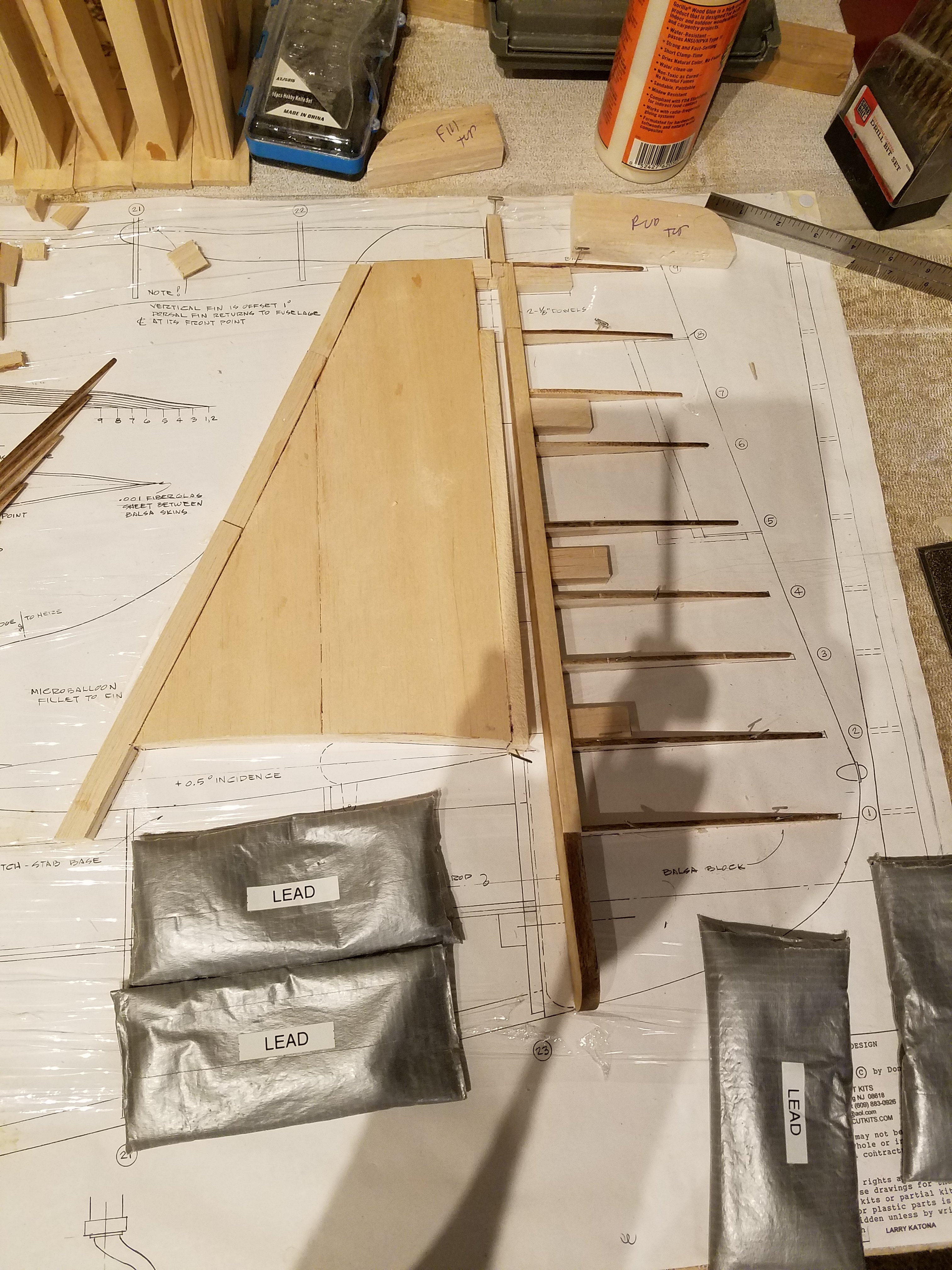

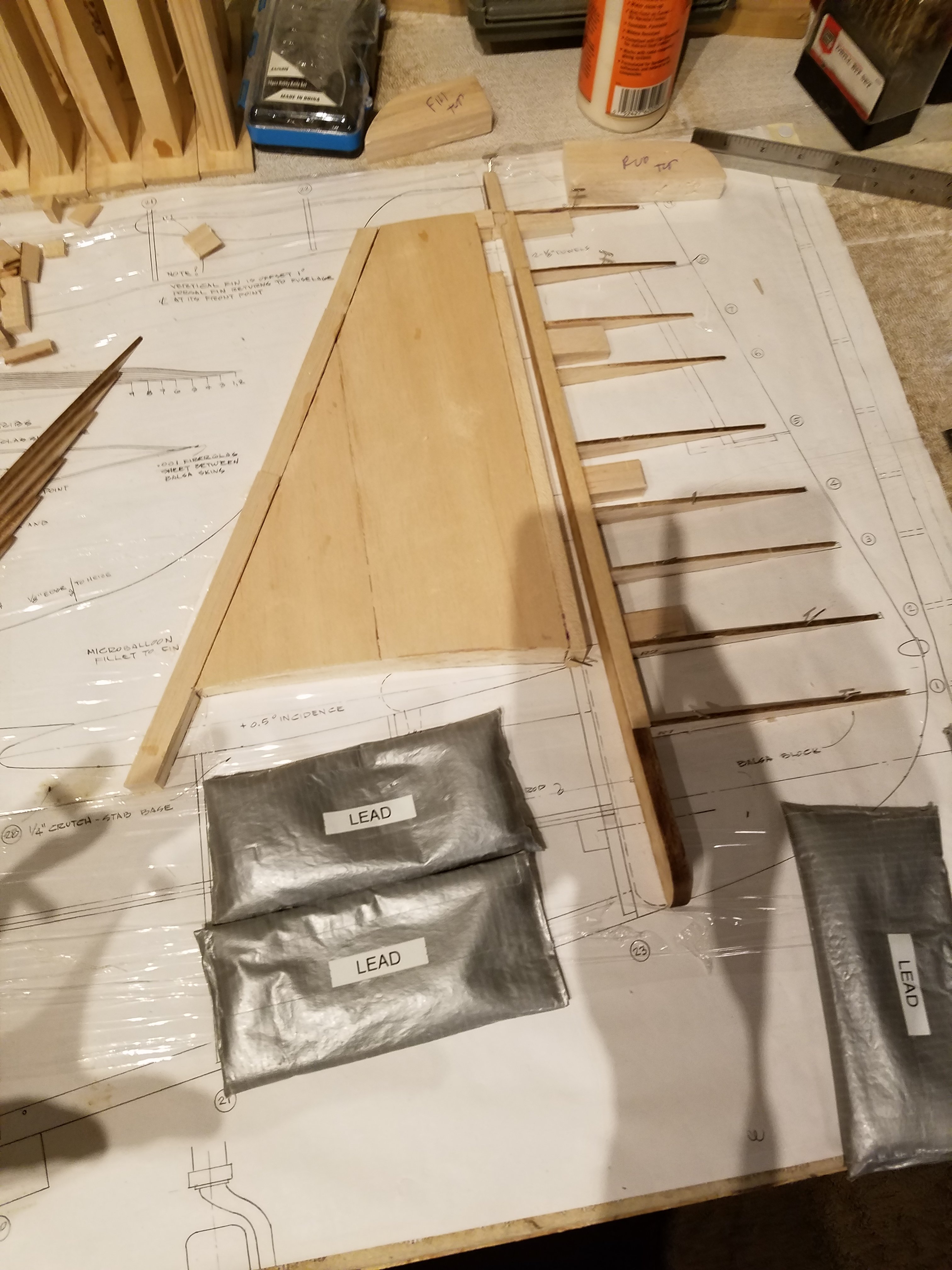

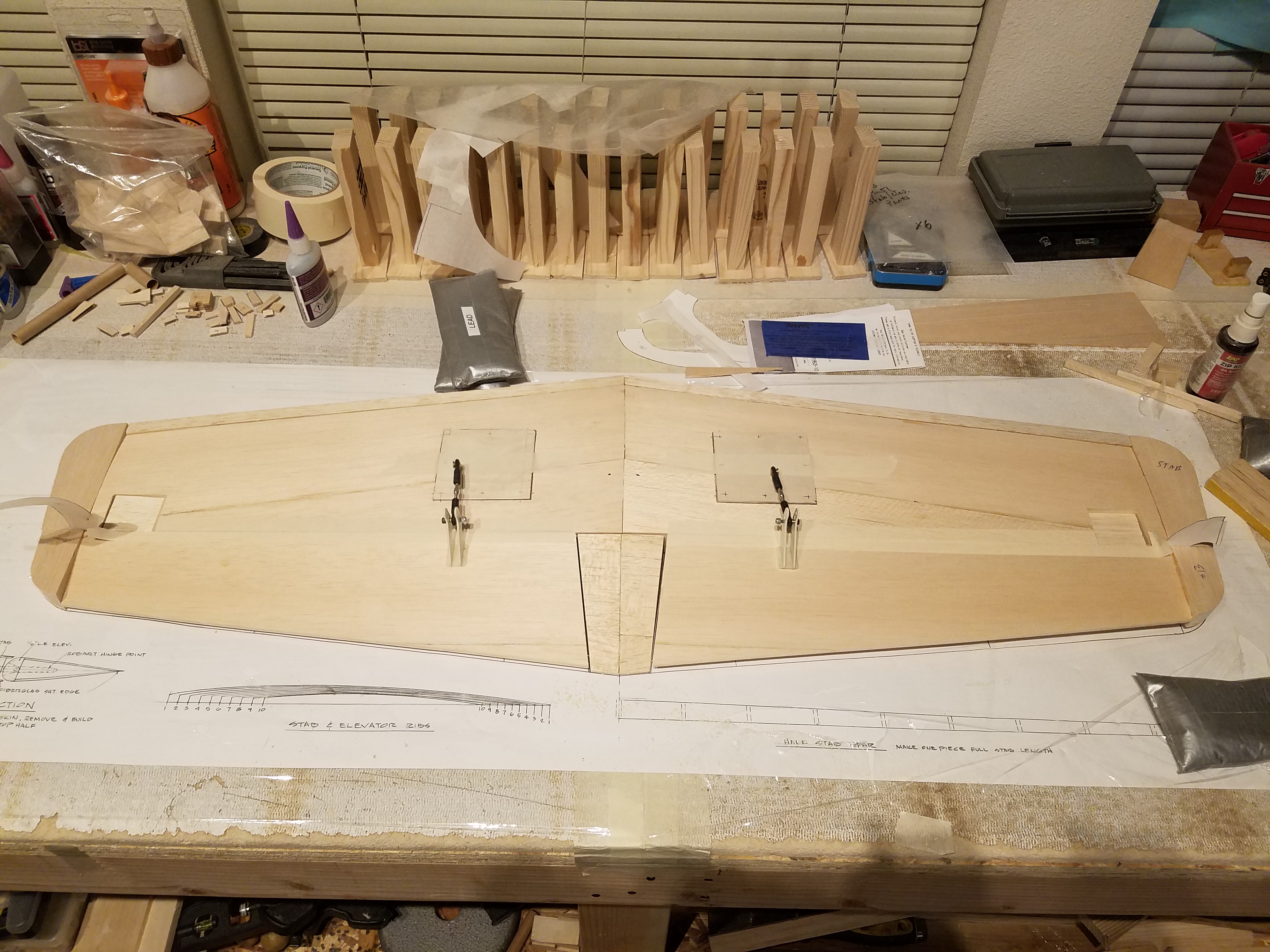

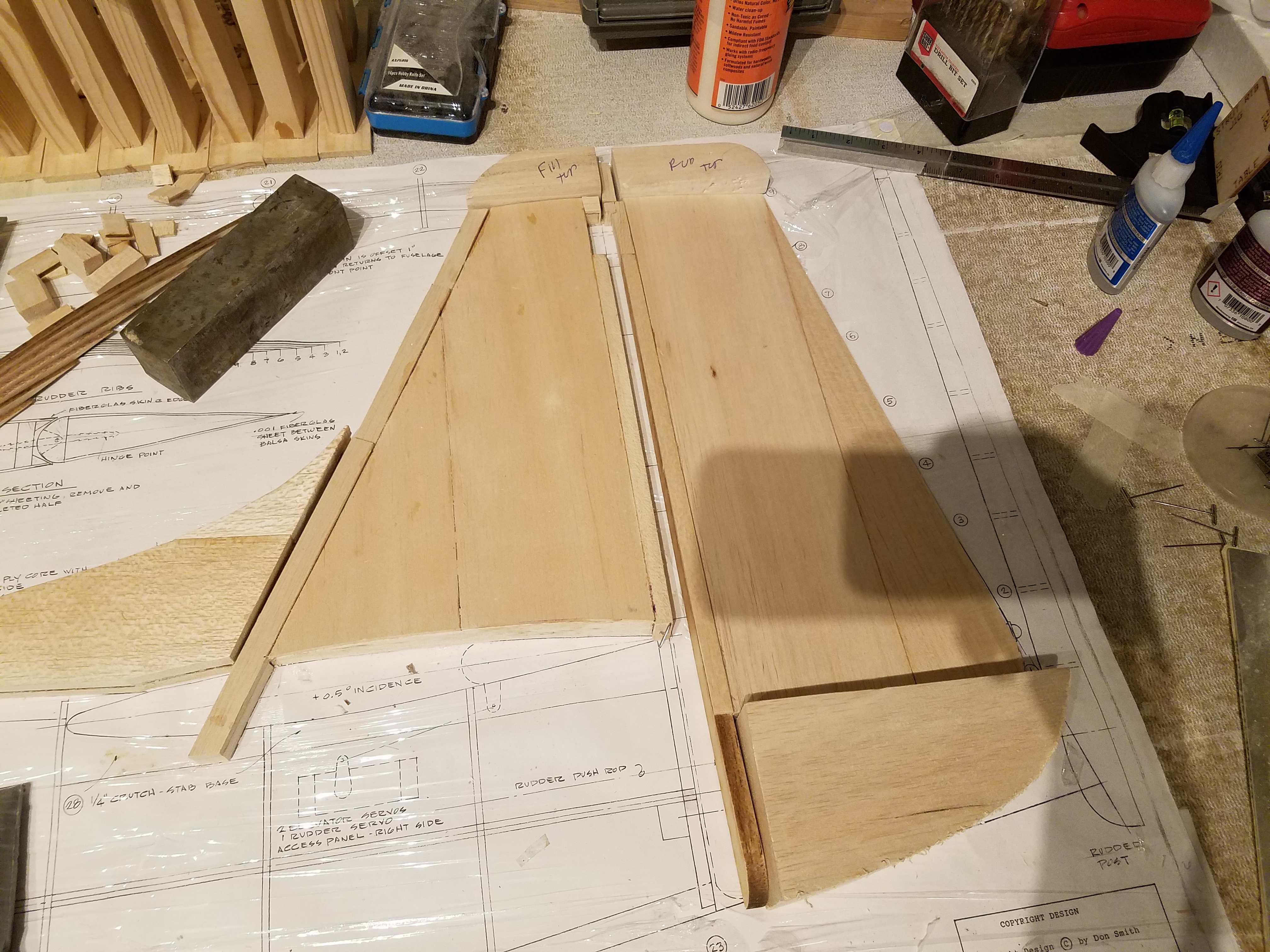

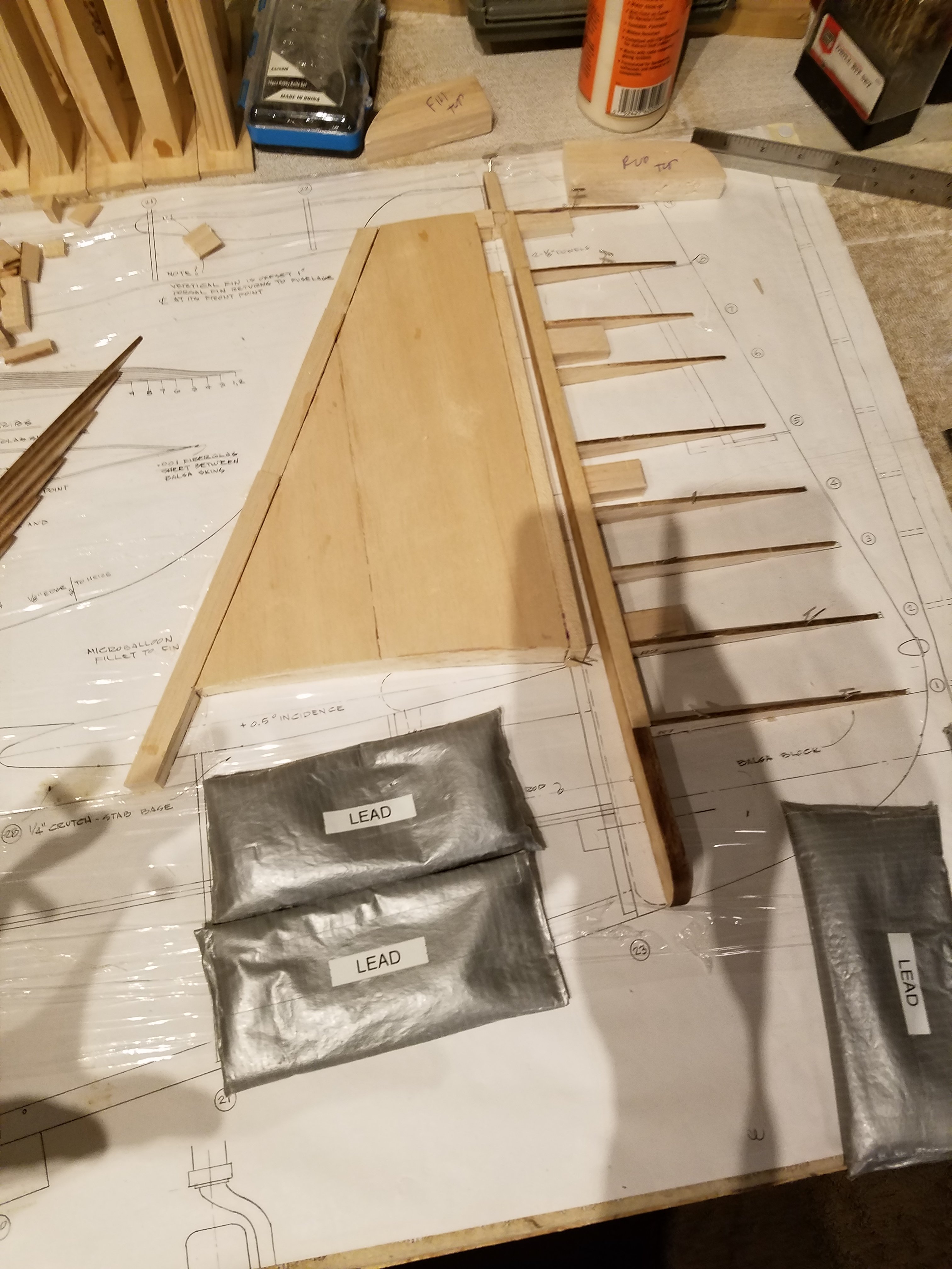

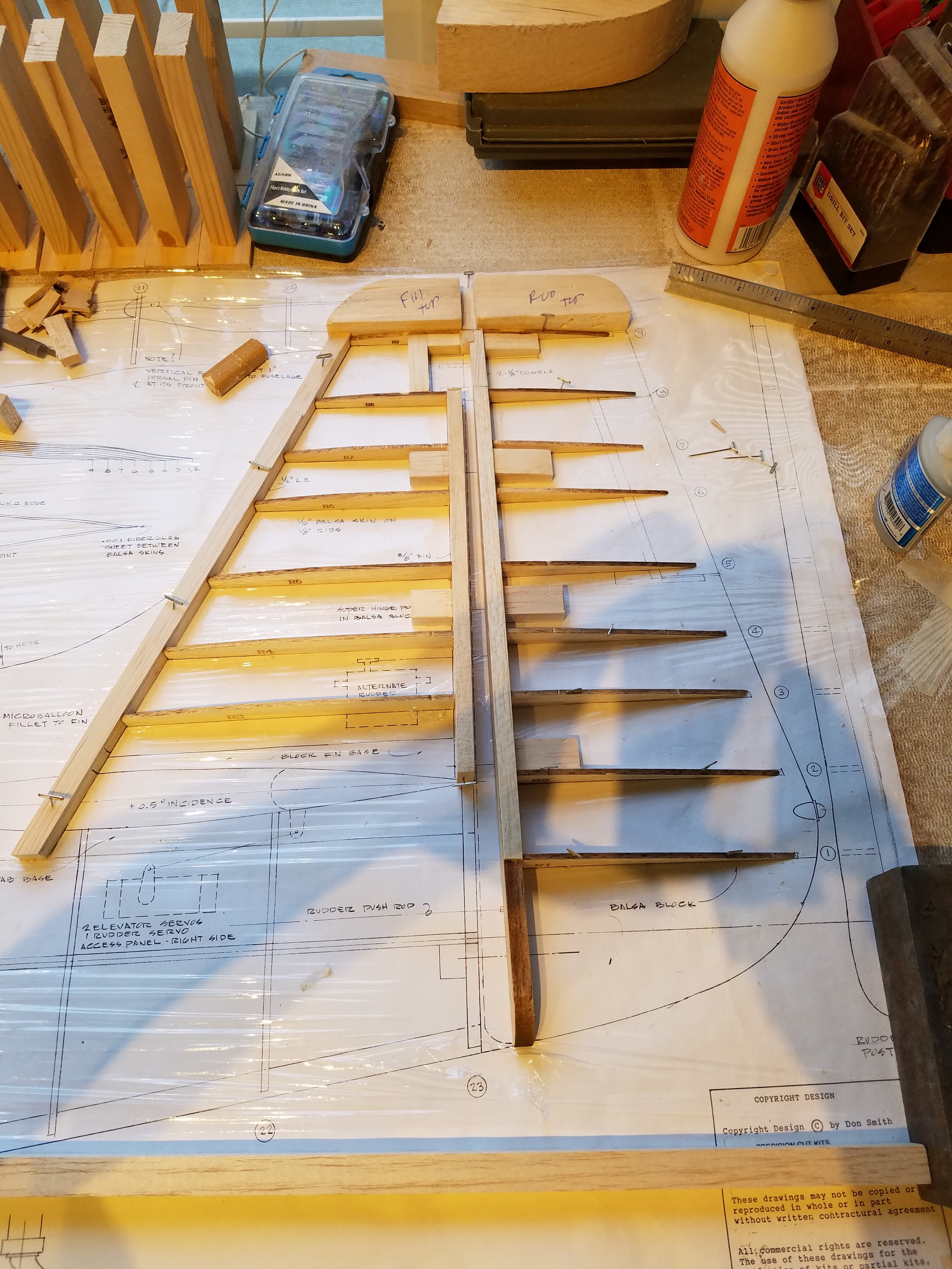

    20190228_210113.jpg How long does it take to glue stab and elevator tips on? About 2 minutes and 43 seconds. Could be why I just got that outta the way. Lol. More later...

    Nice bags of lead by the way. Talk about uniform weight distribution!
    What is your build surface comprised of exactly???

    The top of the table is (2) 7/16" OSB. One on top of the other. Then on top of those is good ole normal ceiling tiles. My son and I have used them for...well, forever really. I thought about the magnet type setup and even the glass system. But I am just set in my ways I guess. You find something that works, why change it? I use the bottom side of the tile as the up side. It gives a very flat surface in which to work from. They are compressed tight enough that when using "T" pins to stabilize your build, they dont give or allow the pin to move. They are easy to cut if you want exact table top fit. I also like them because they are dirt cheap. About 3 and a half bucks for 3. On my table I used two end to end and seamed with 3" wide masking tape. Then split the third sheet lengthwise and again seamed together. Makes for a good work surface. If one get cut up, or starts deteriorating, simple replace it.

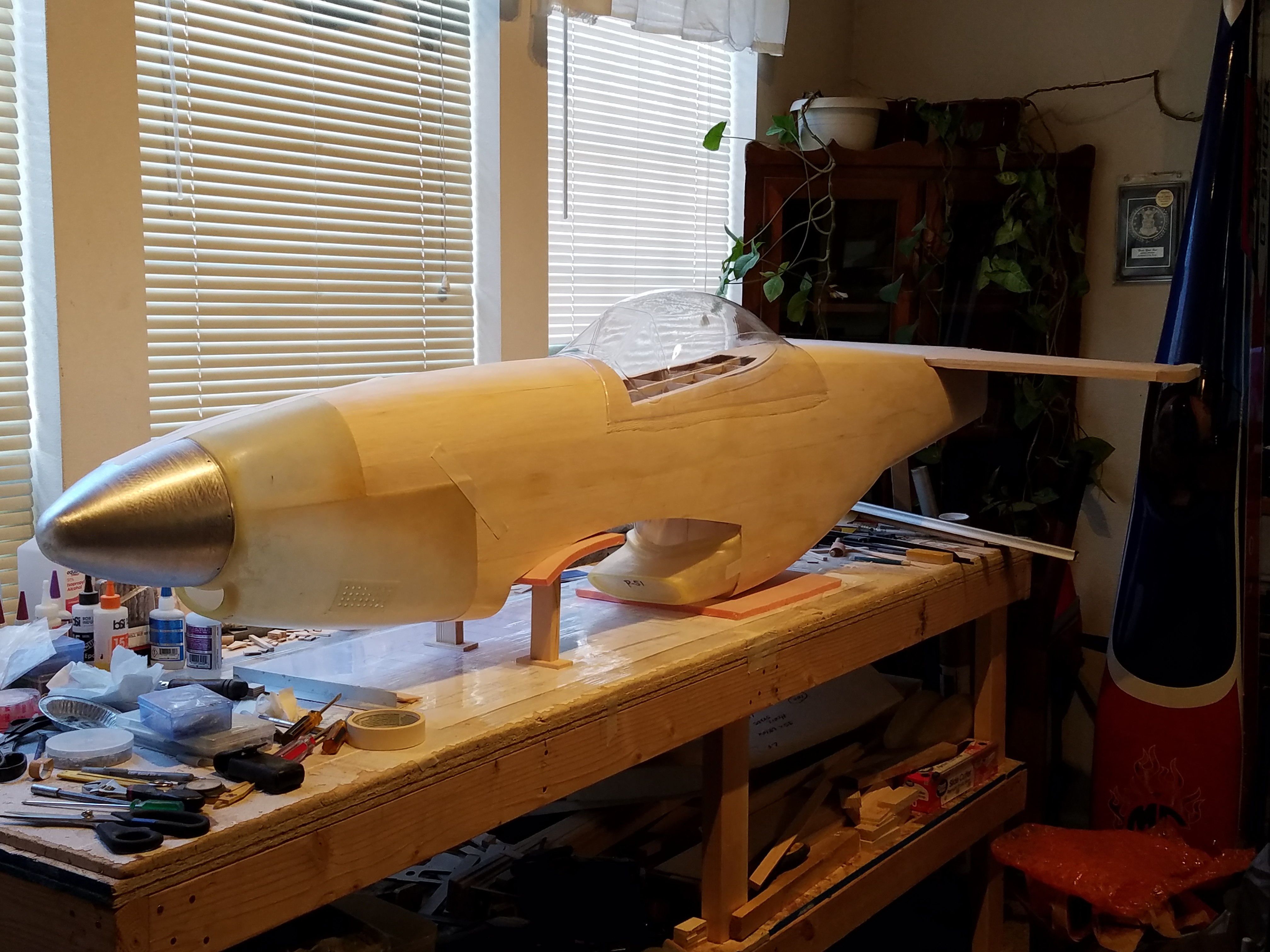

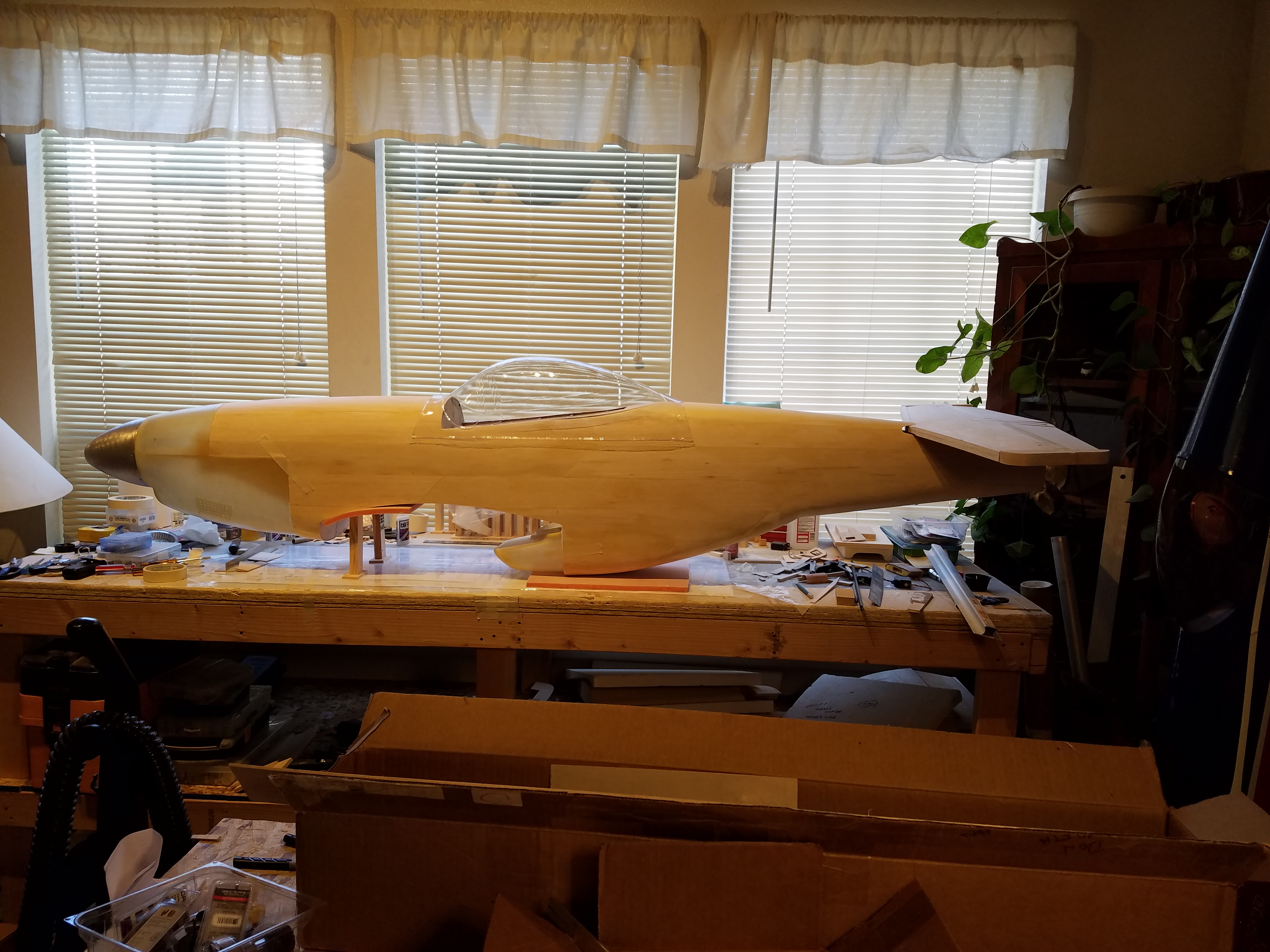

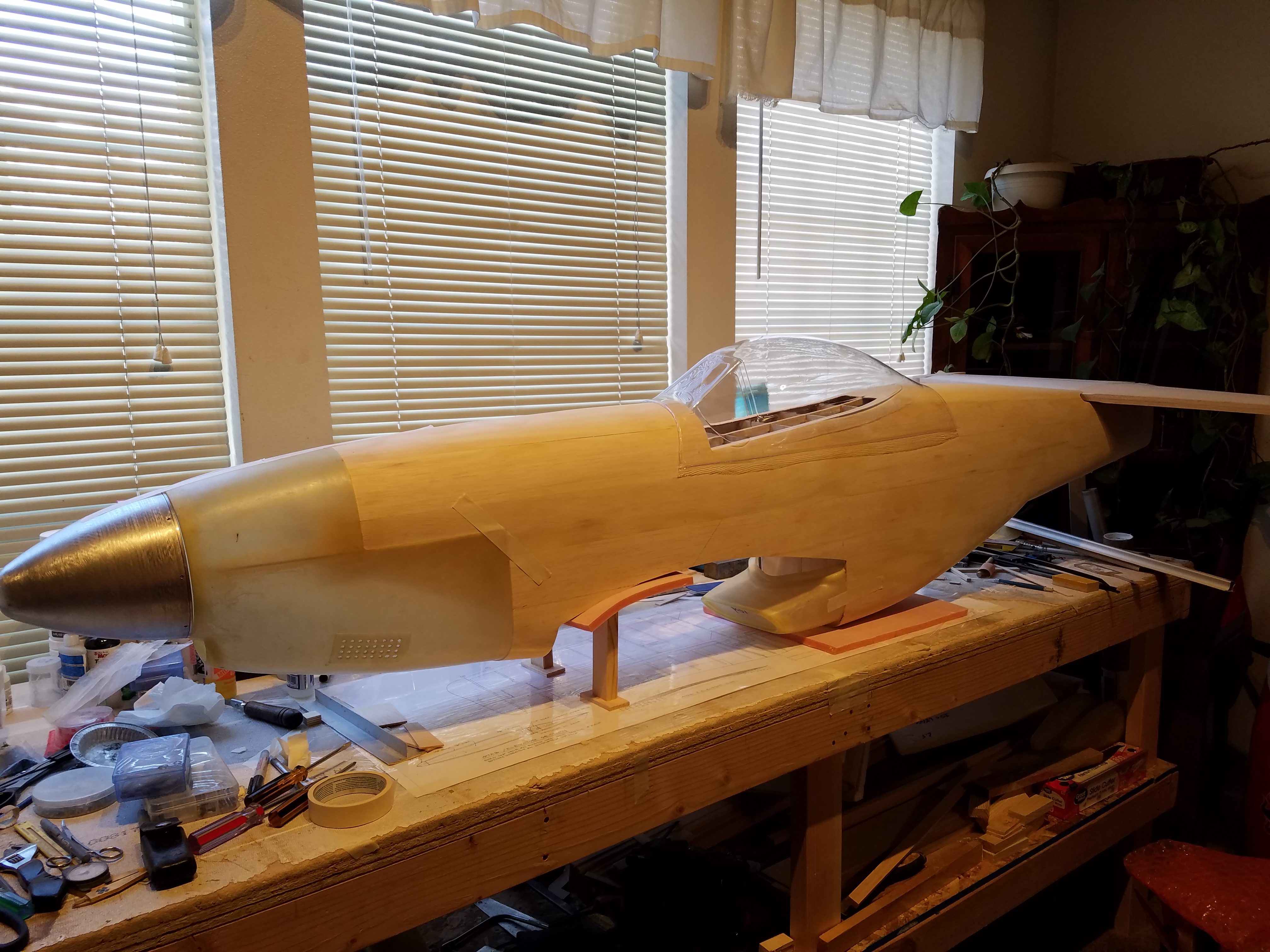

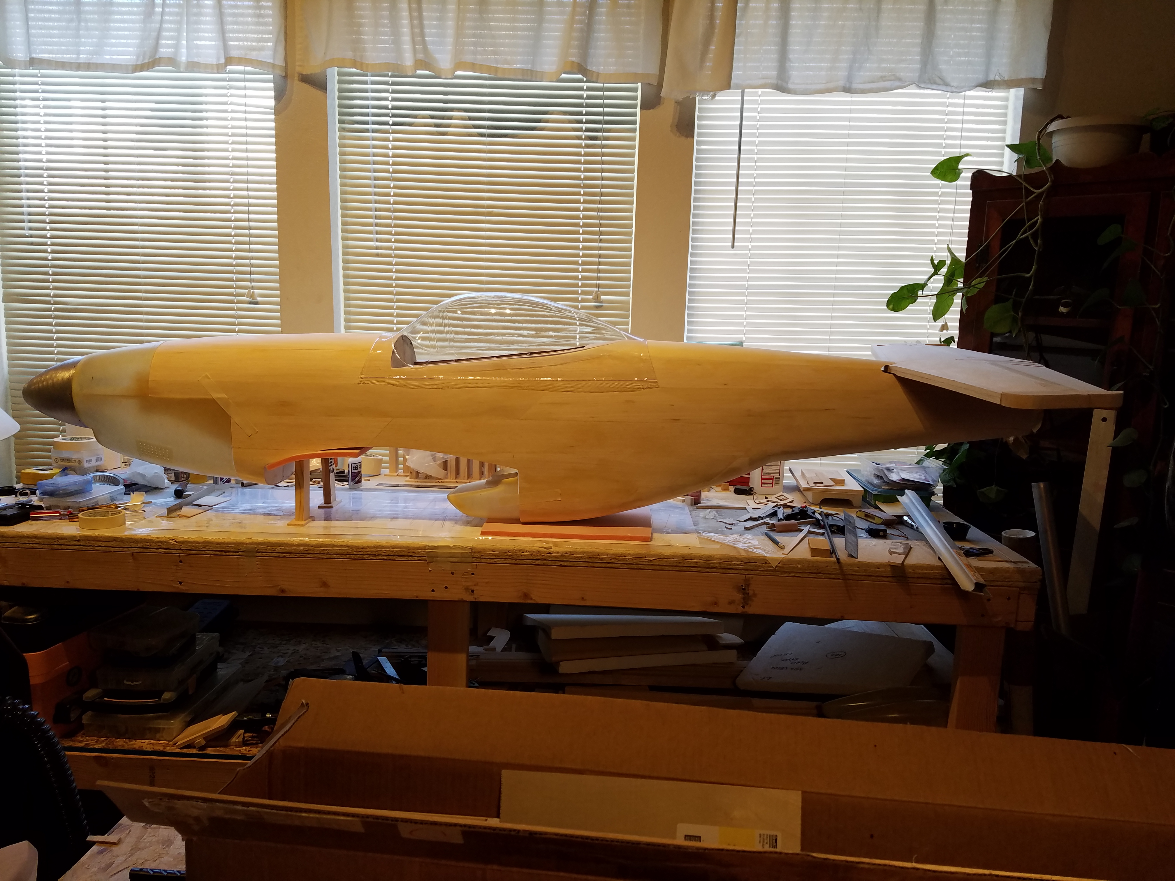

    Sorry fellas. I just couldn't resist. I sometimes need a little prompting and a little push. Nothing like being caught alone with Emma Samms. Dont need no prompting there. Lol. Just had to catch a rough draft of the Behemoth Stang. Dang, this thing is still growing in size. Lol

  9. 49dimes
    49dimes Damn I'm hungry
    That thing gonna be friggen AWESOME! :big_yes:.

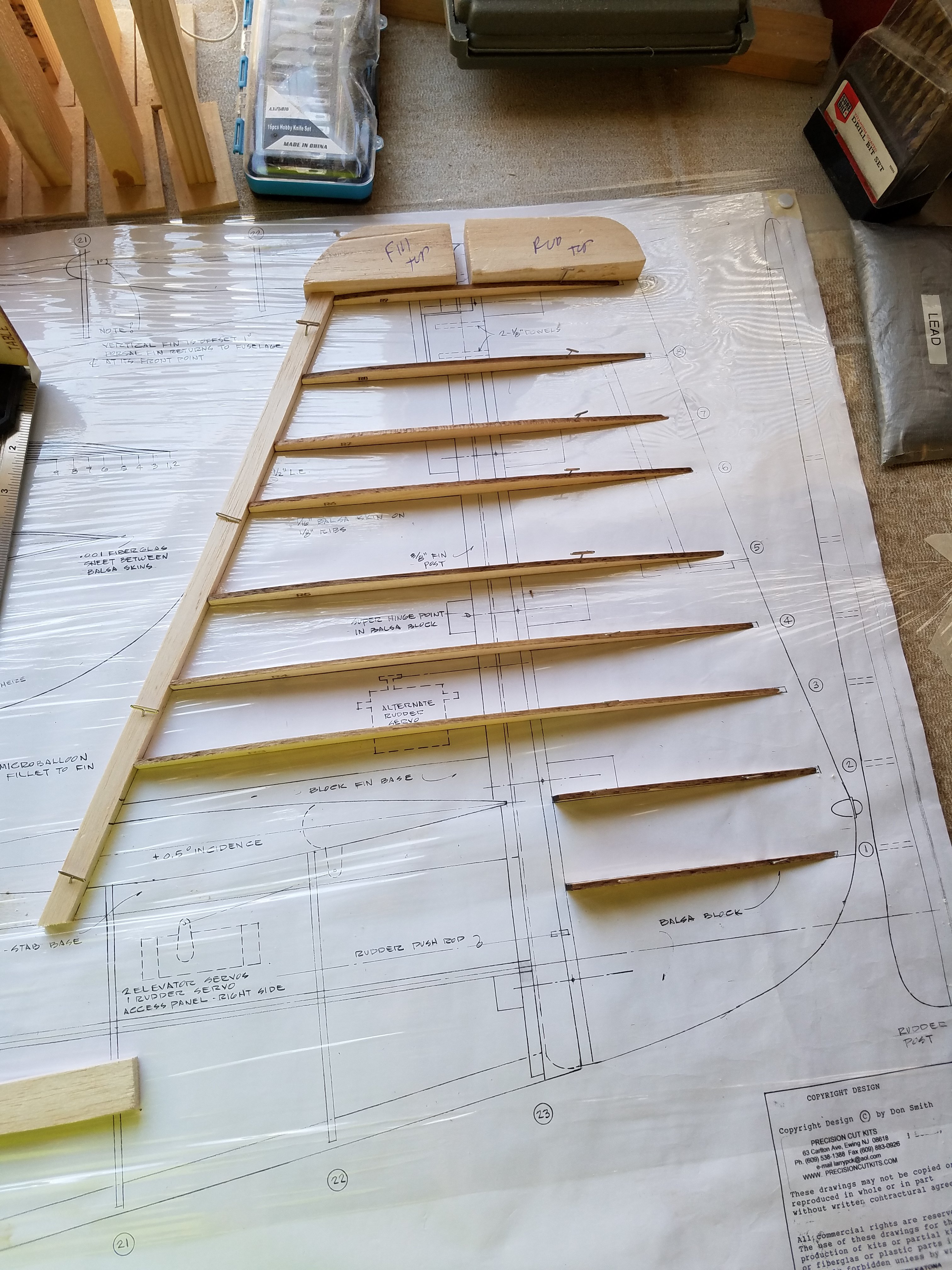

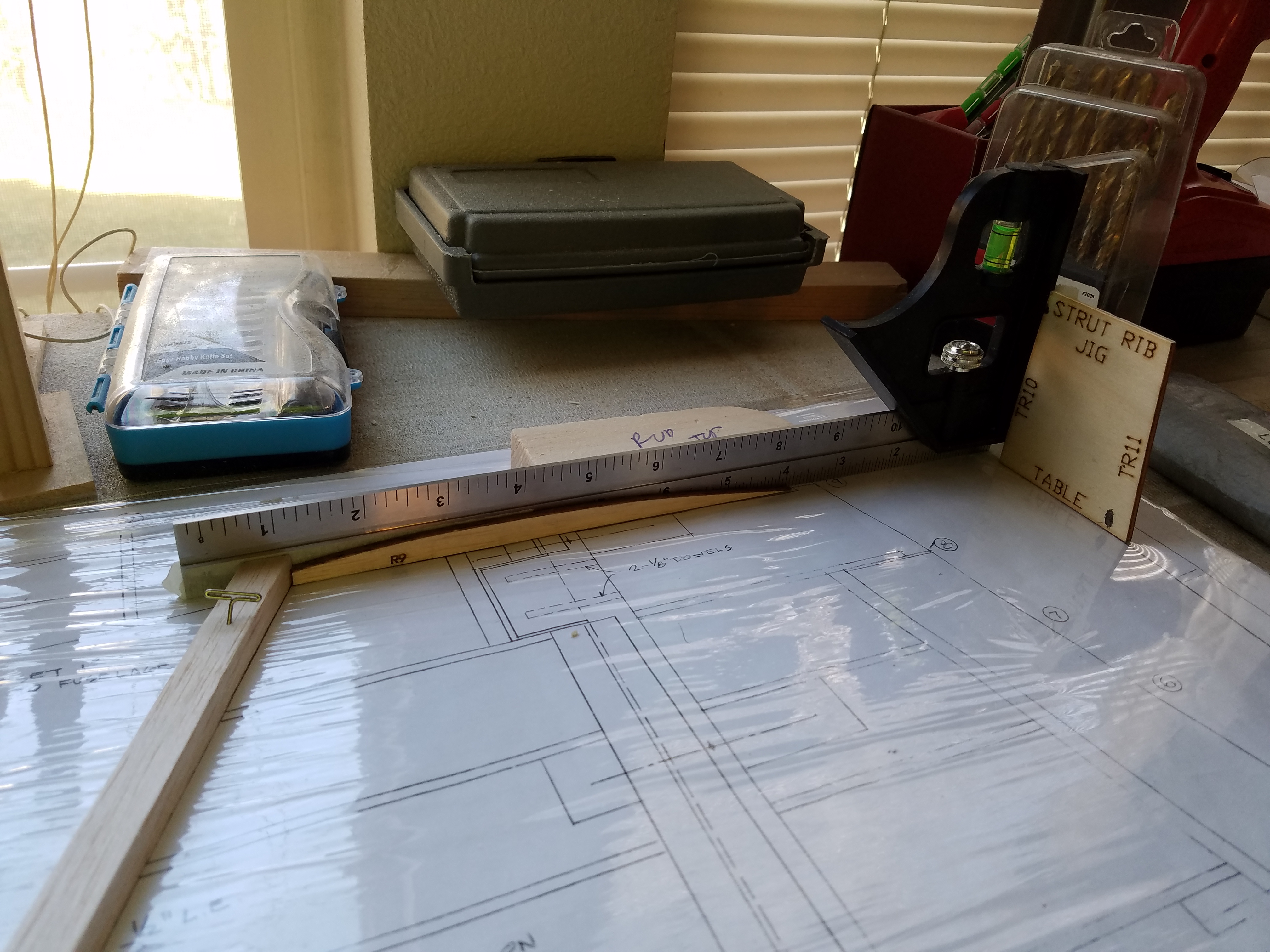

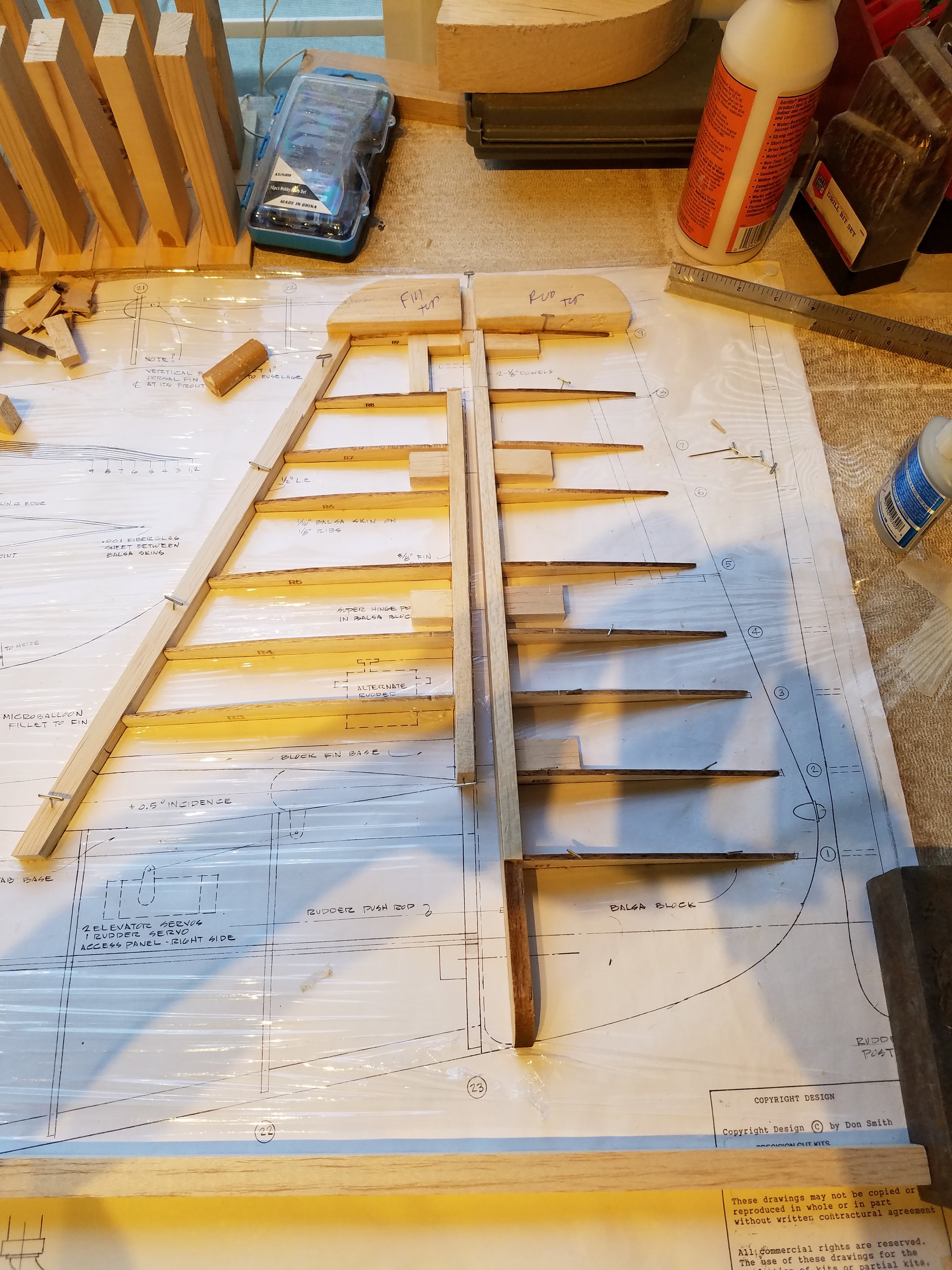

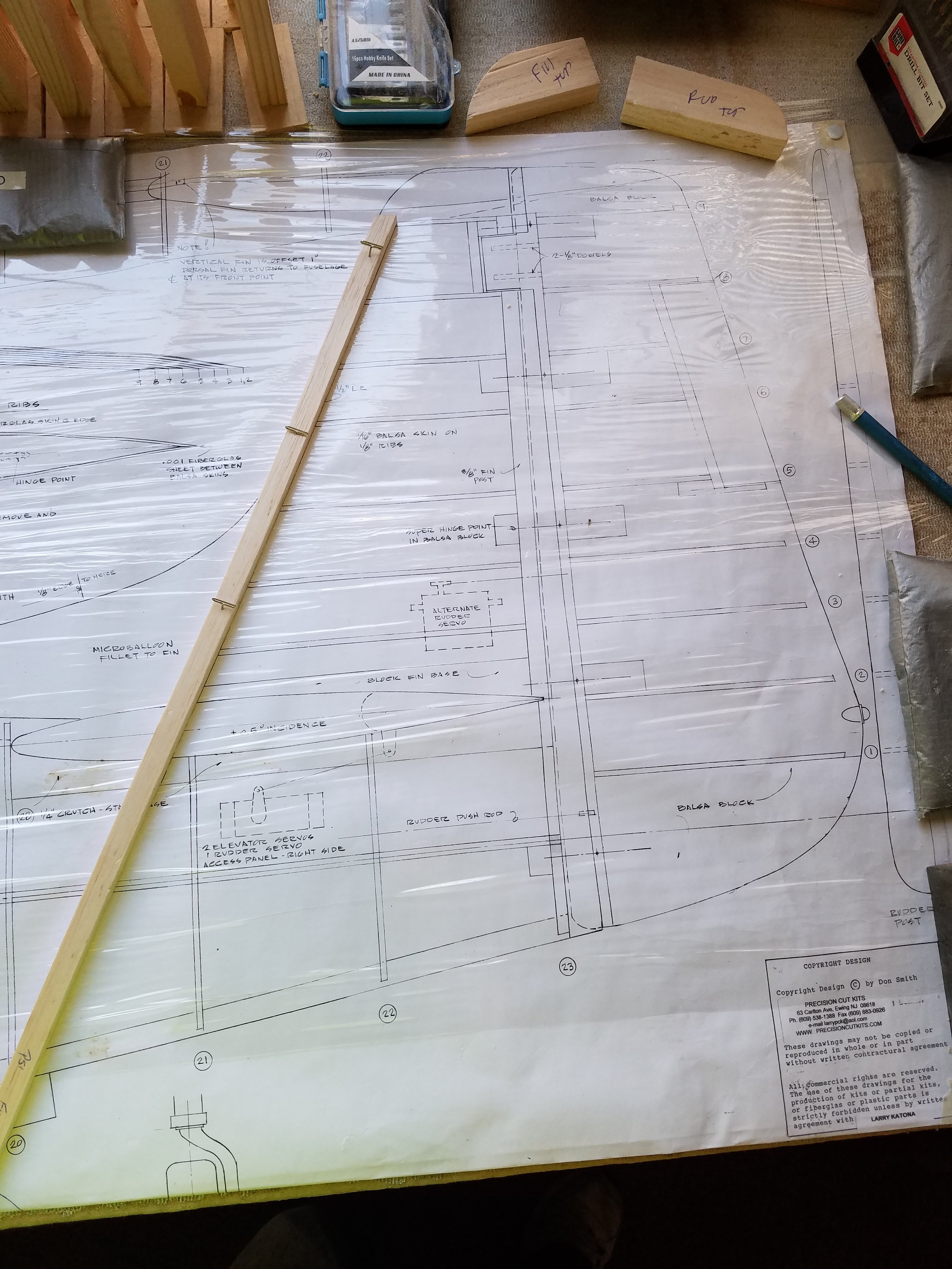

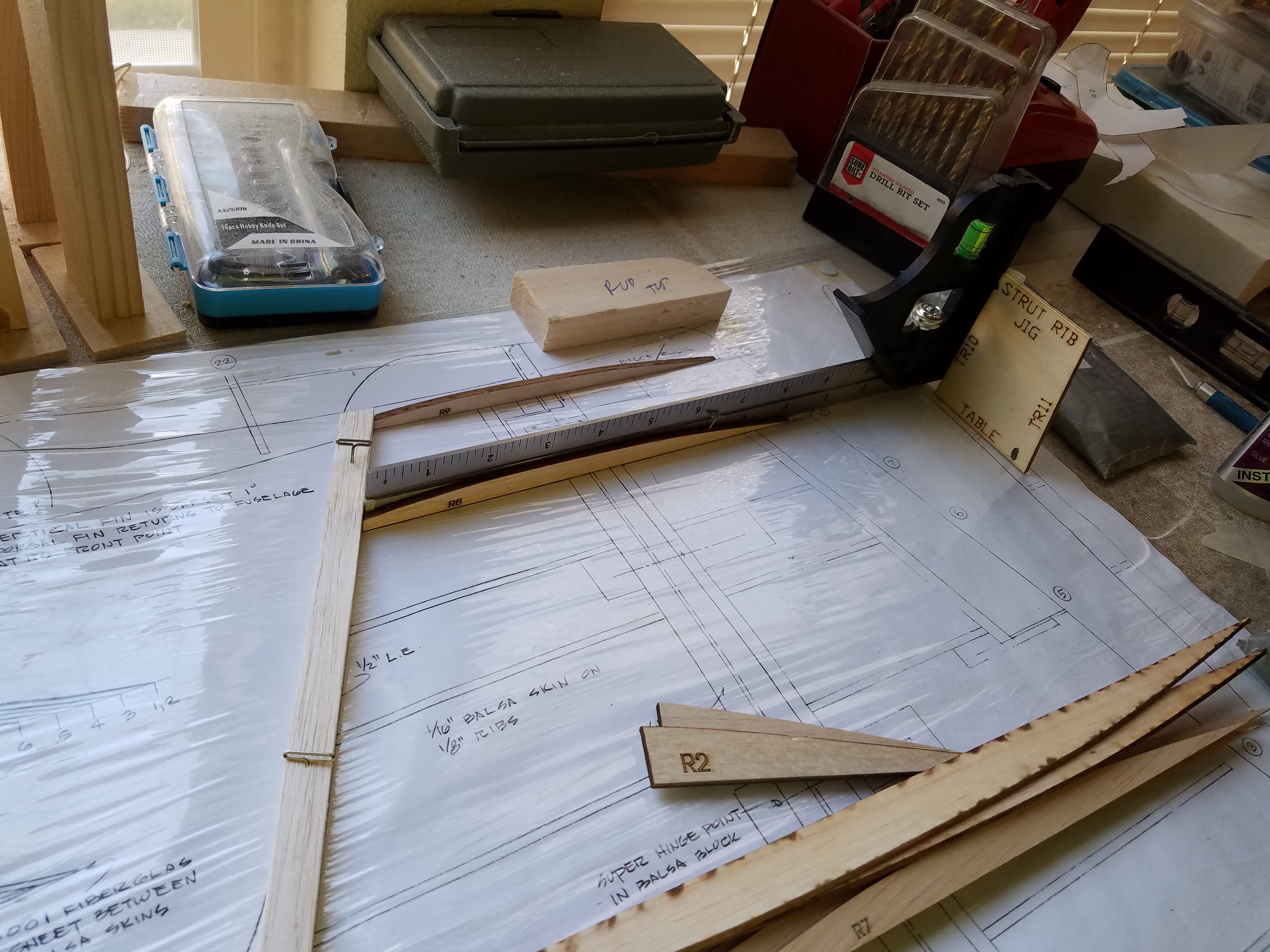

    Thank you Kelly. I appreciate your compliment. I just hope I dont let you fellas down. Trying to think about everything before I proceed with each step. I want this as perfect as possible. It is a lot of work I gotta tell you. I have spent basically 10 hours on one half of the fin and rudder construction. And really, not even 50% done with the build. I'm sure I'll get there. A little at a time. Here is the most recent progress as of today.
    20190304_112819.jpg 20190304_113559.jpg 20190304_114023.jpg 20190304_121235.jpg 20190304_181043.jpg 20190304_191807.jpg 20190304_191814.jpg 20190304_200517.jpg
    Hopefully will finish up the main construction of the fin/rudder this weekend.
