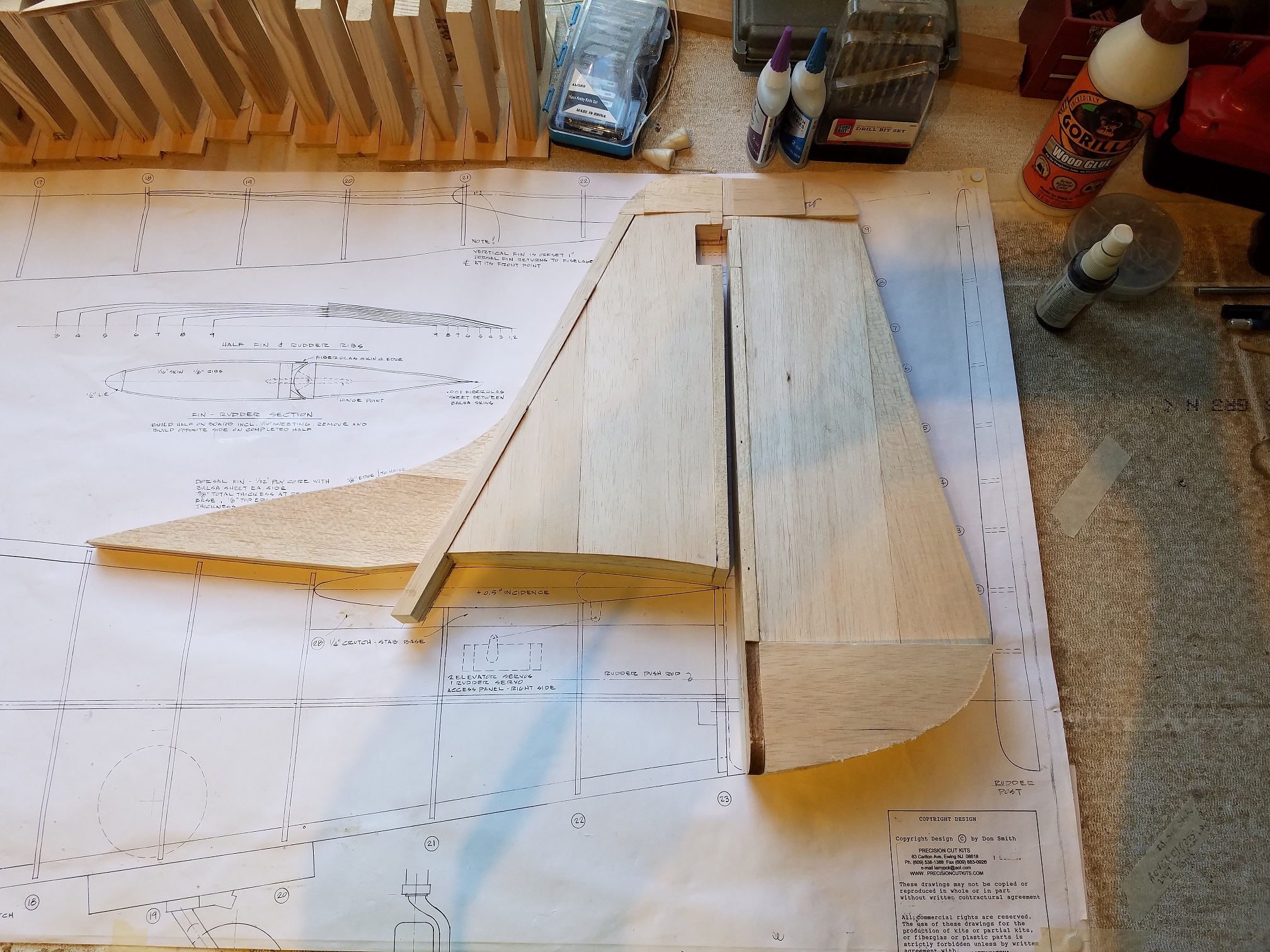

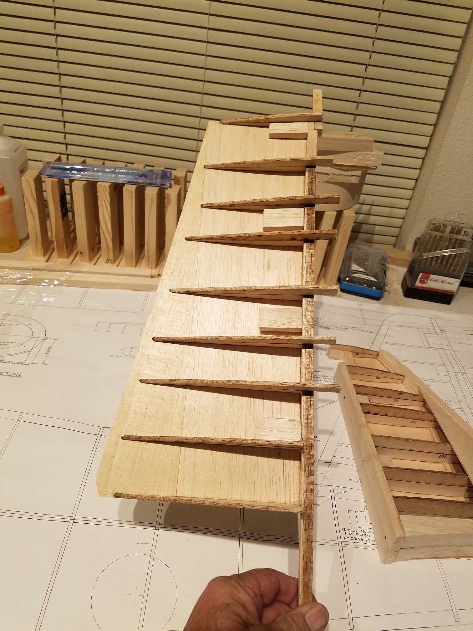

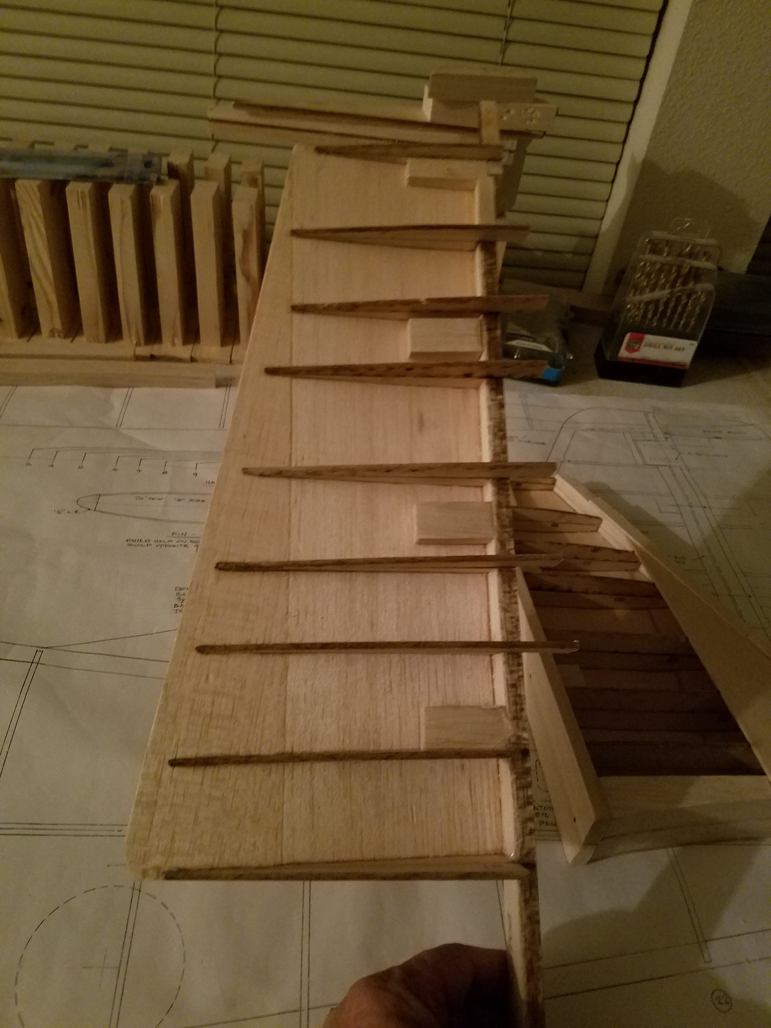

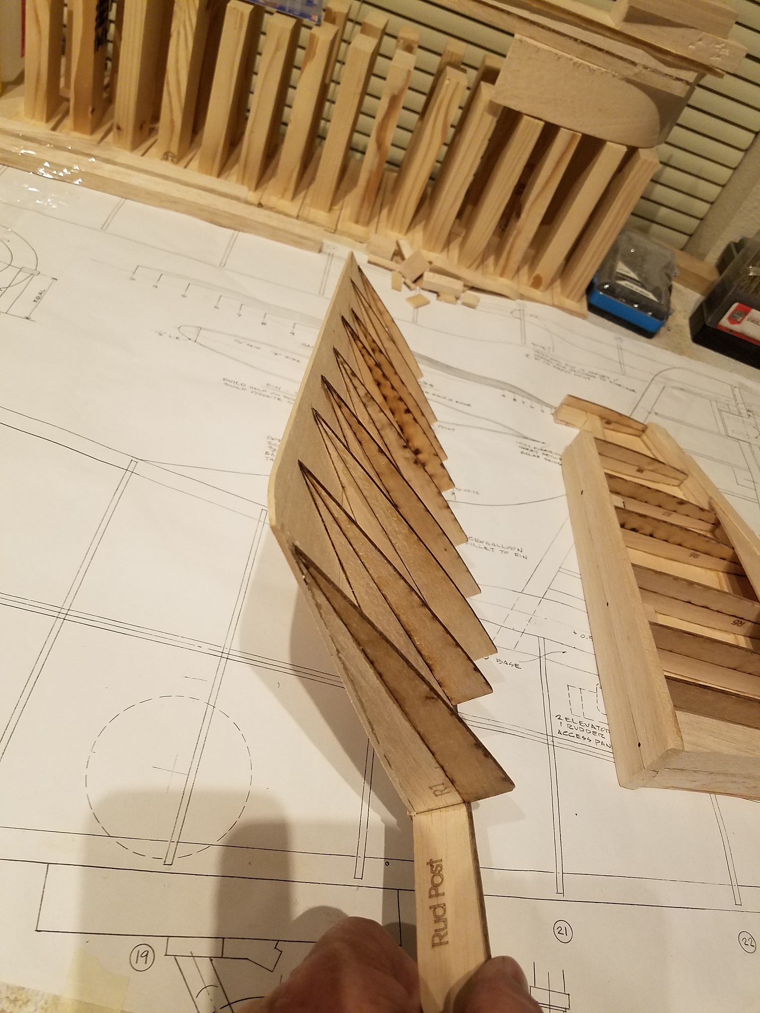

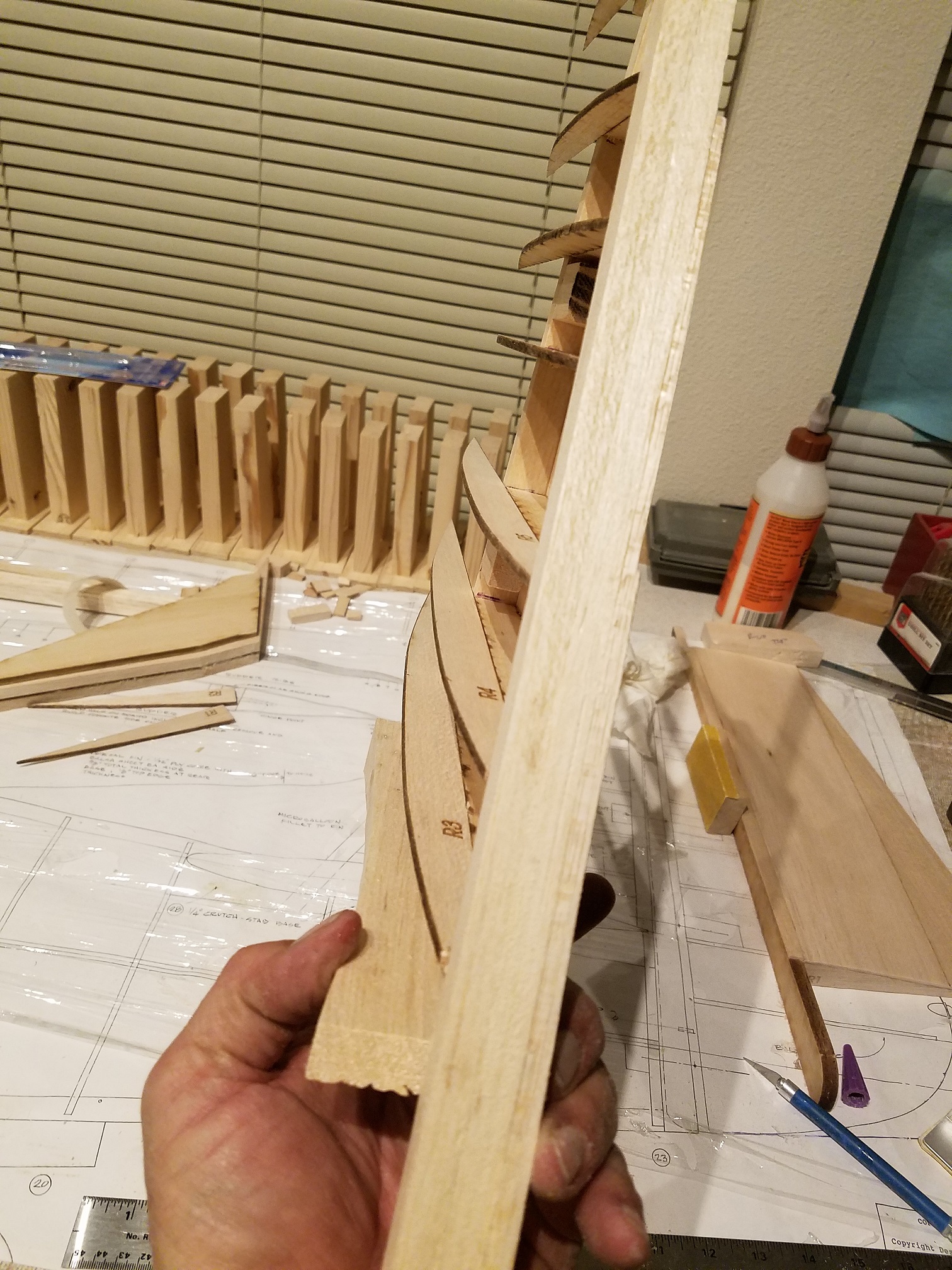

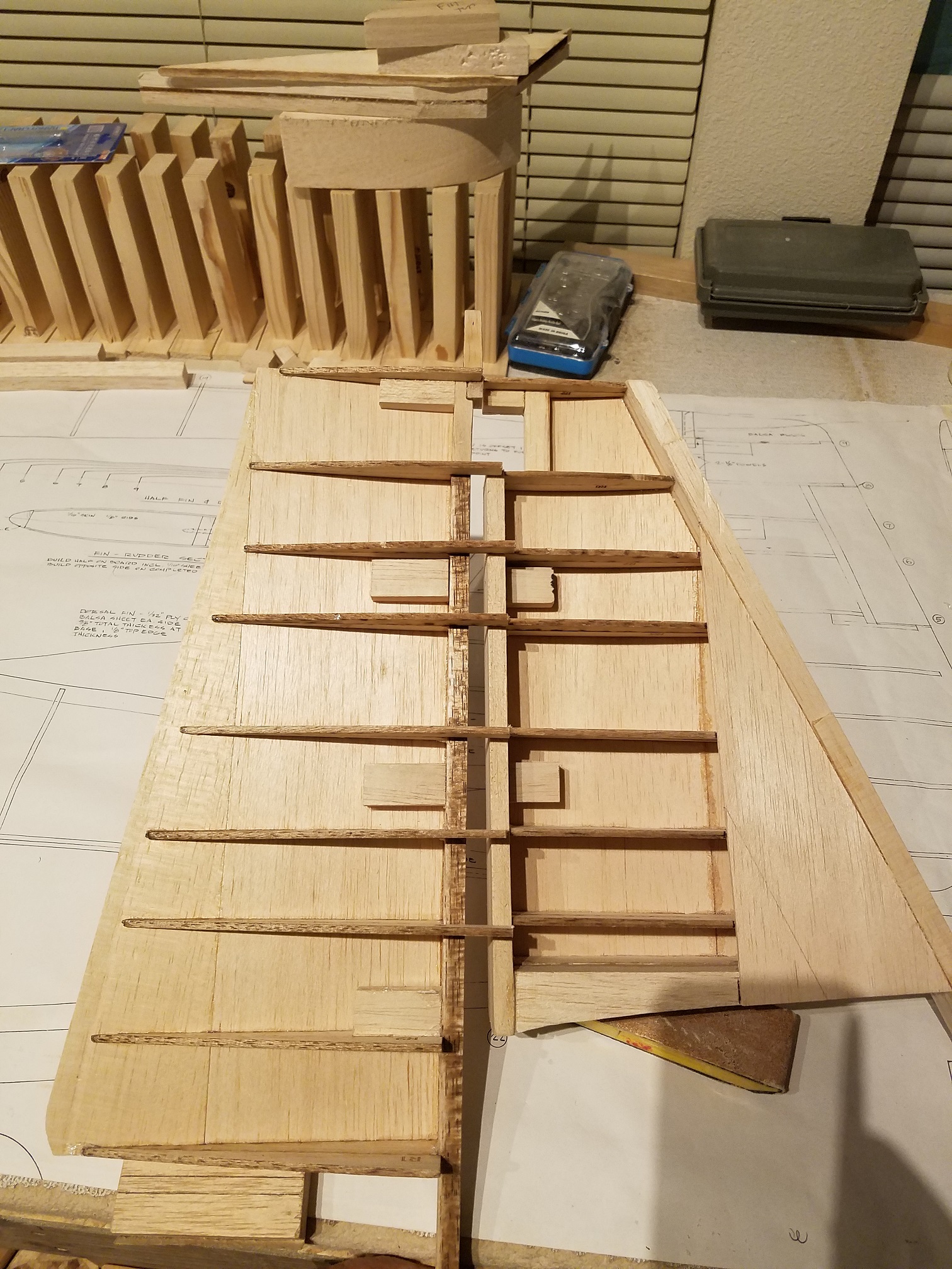

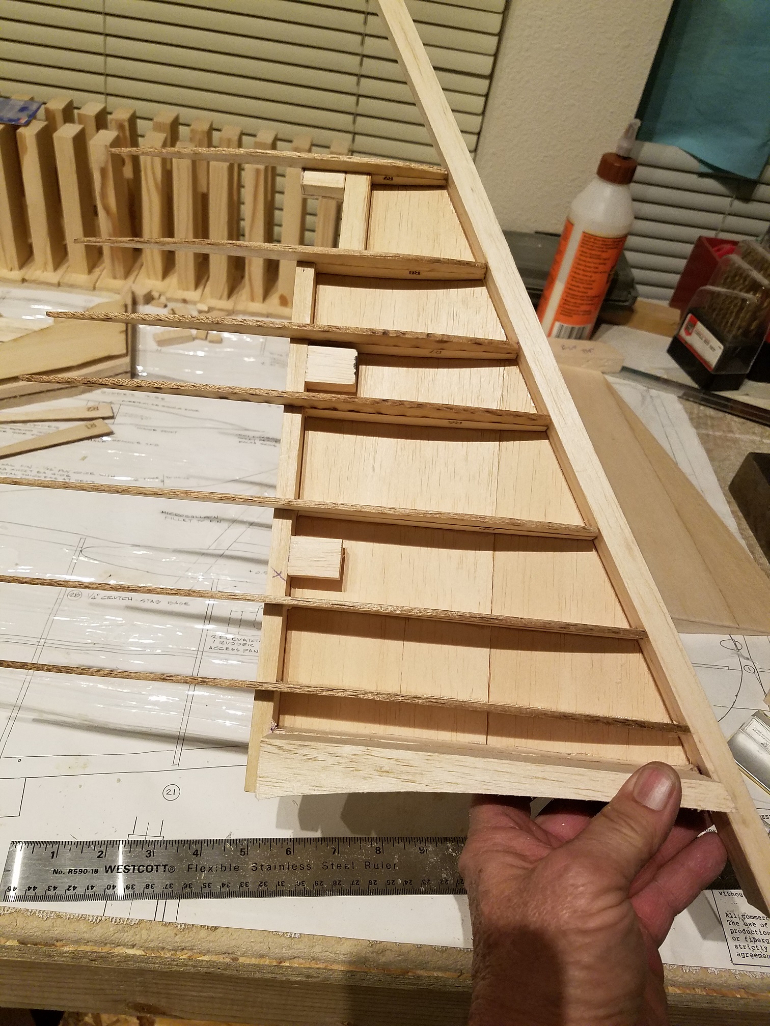

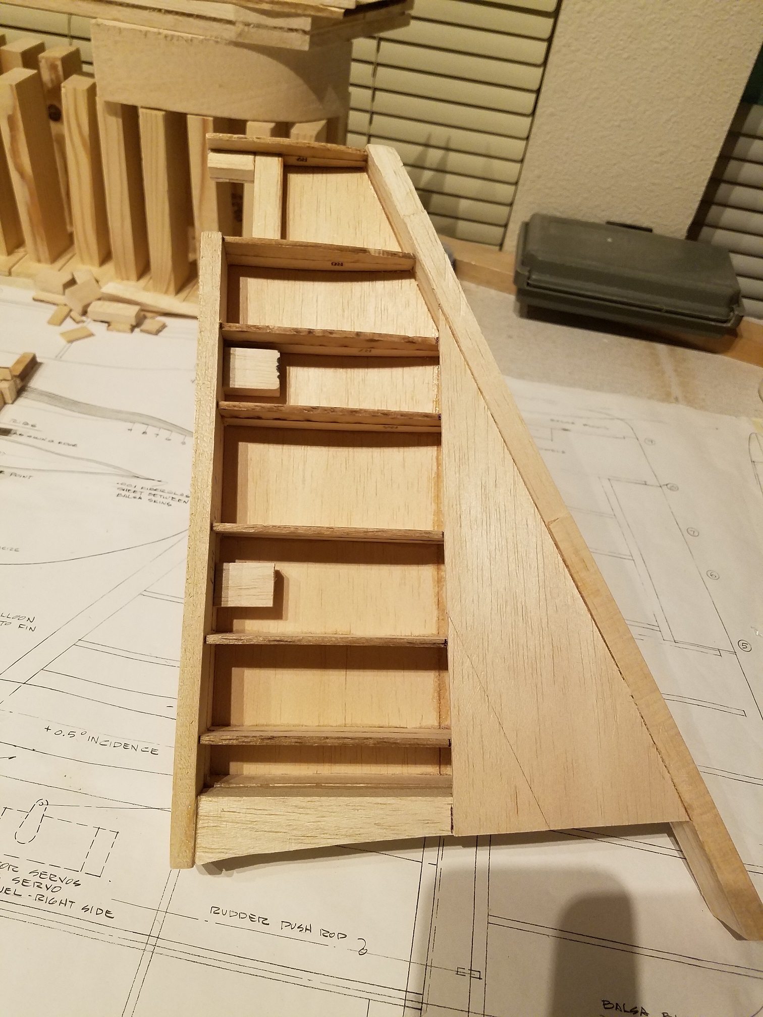

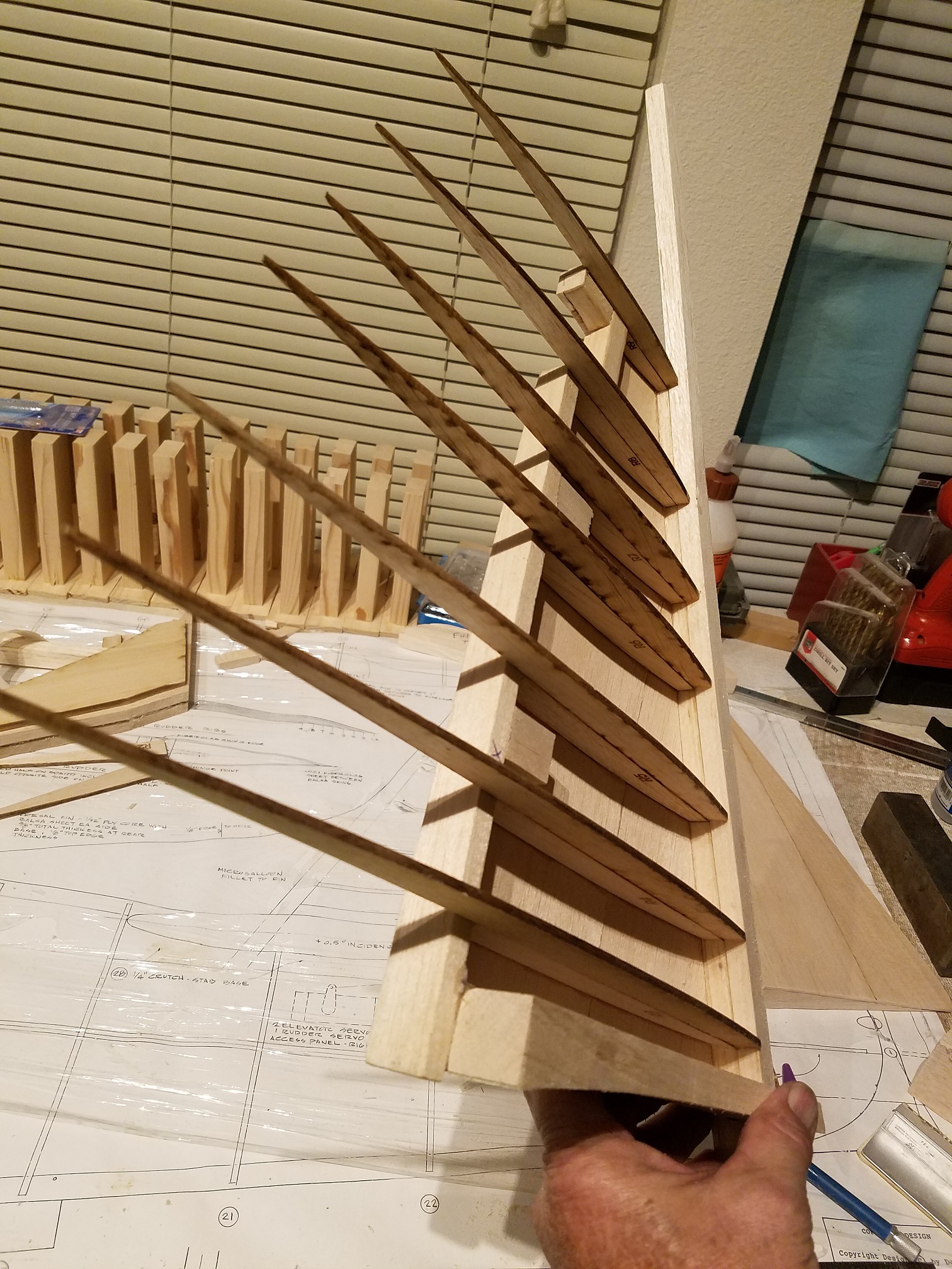

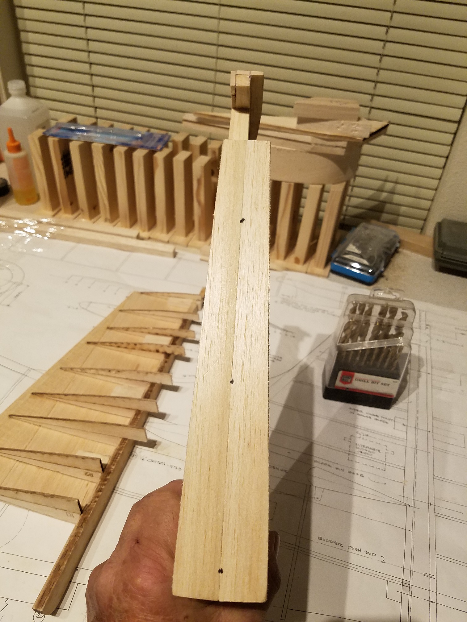

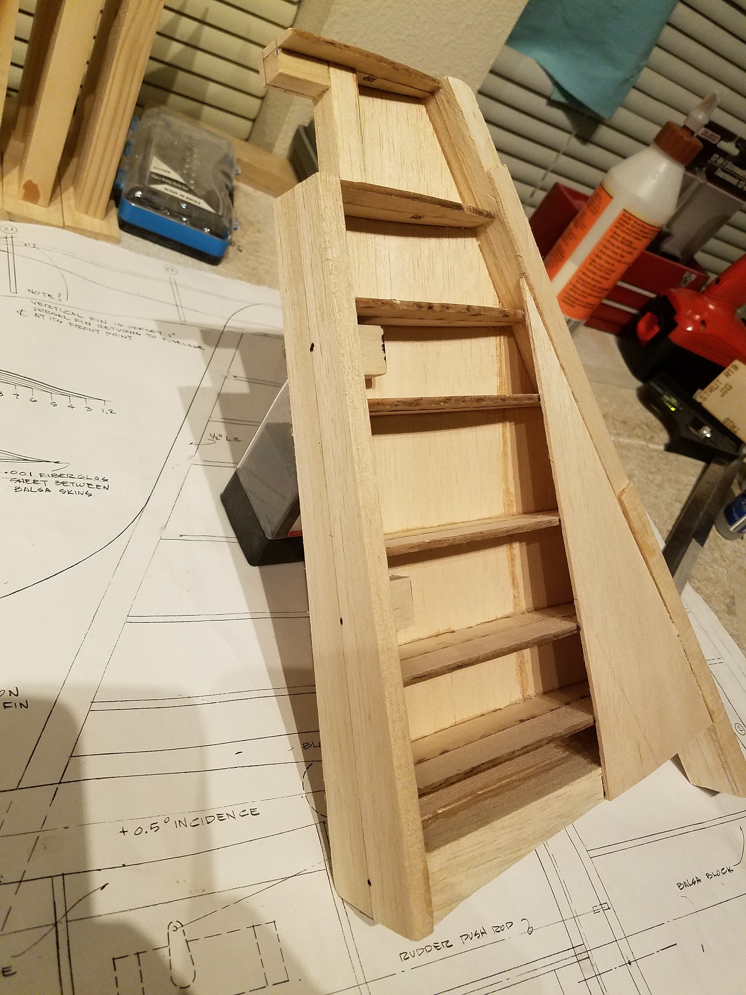

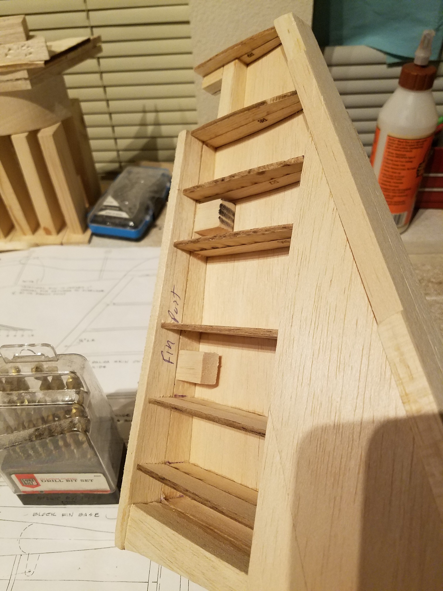

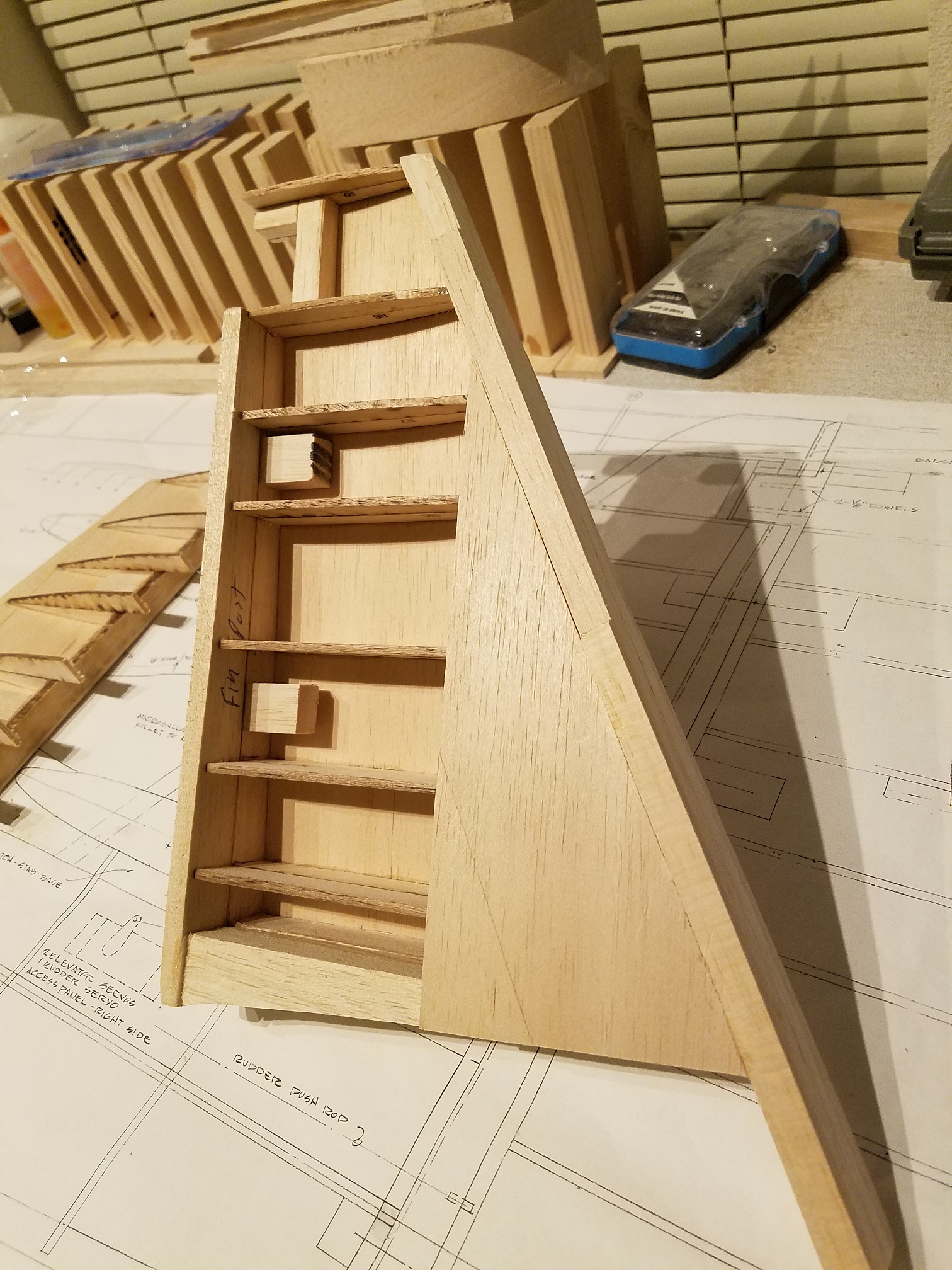

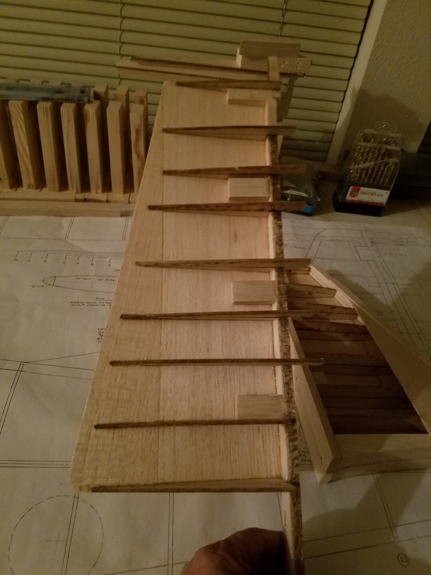

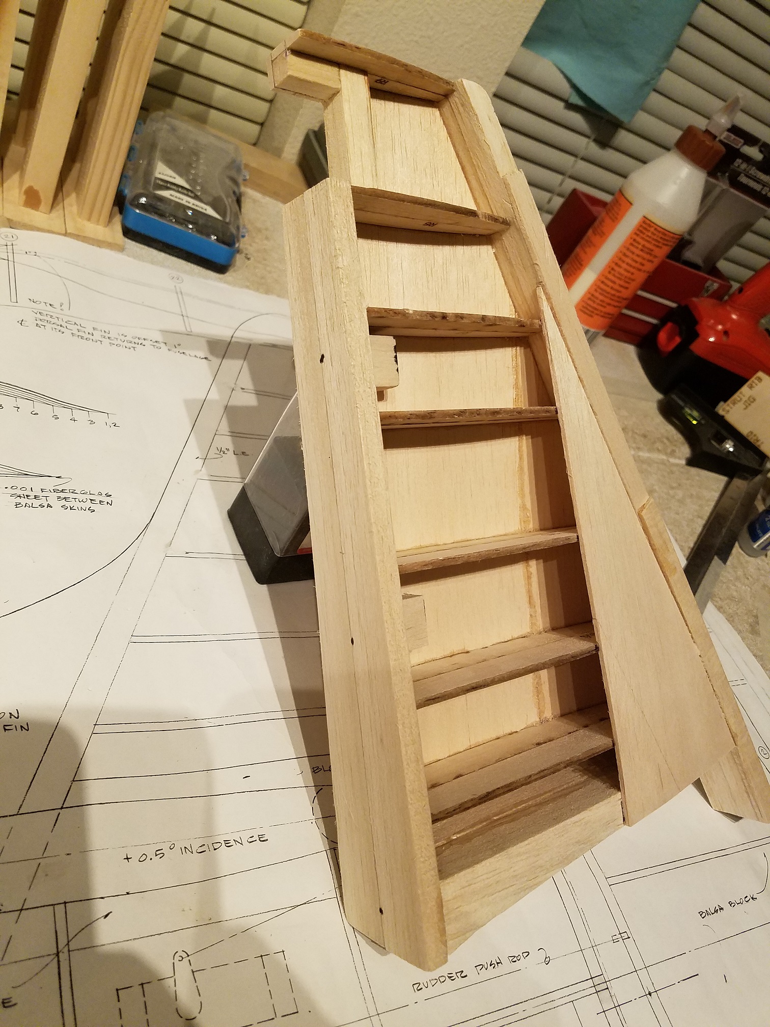

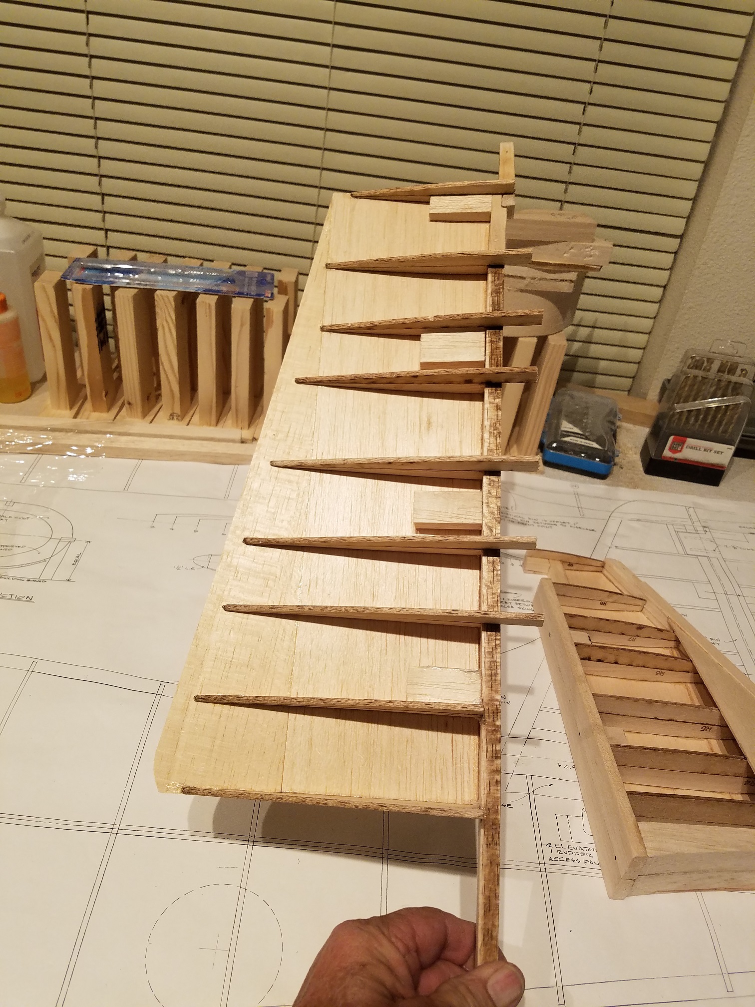

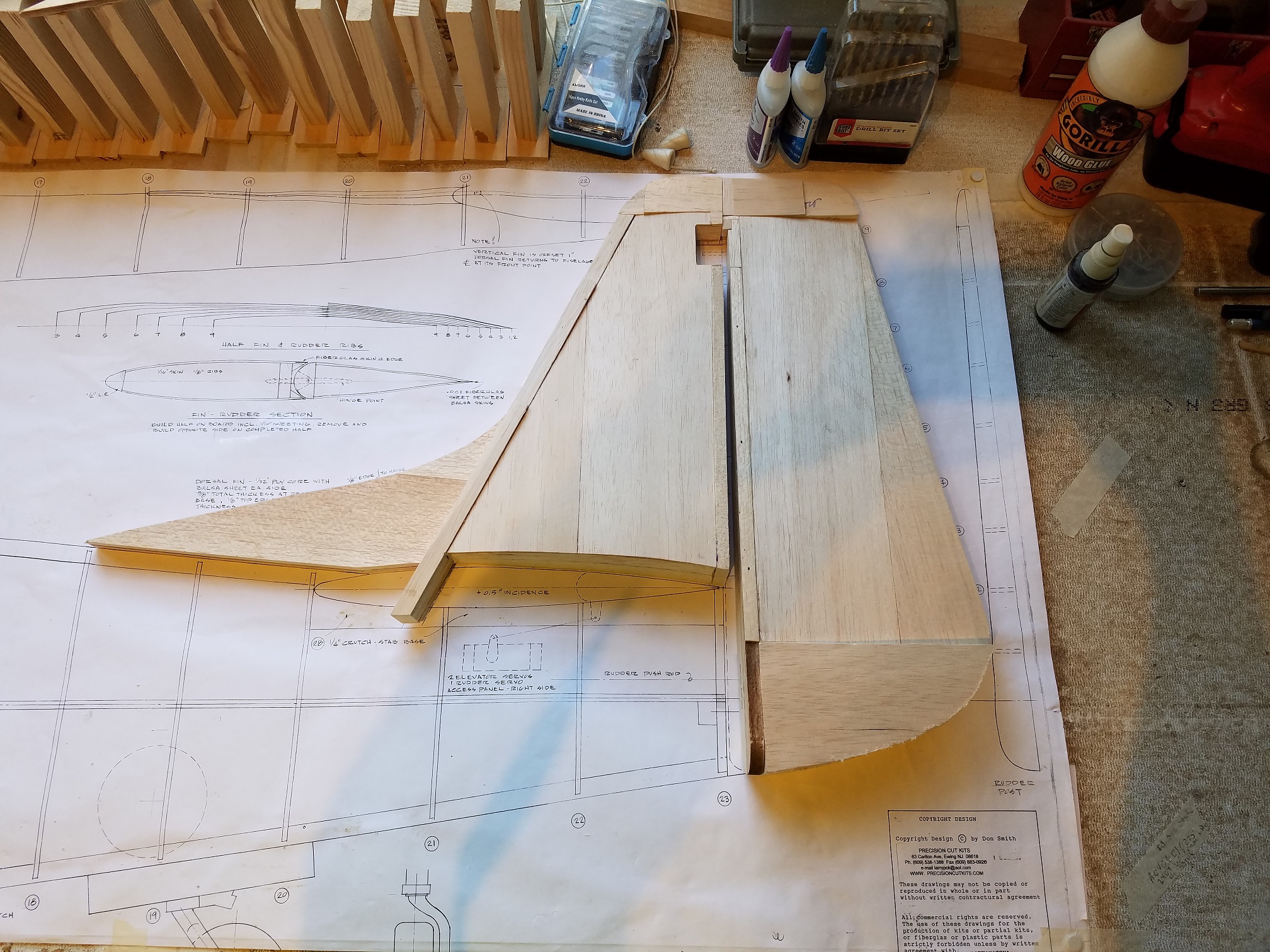

    I spent a few more hours with the fin and rudder this morning. Now basically done, about all that is left is to build the counter balance for the rudder. Then shape and sand.
    20190307_213002.jpg 20190307_213012.jpg 20190307_213018.jpg 20190308_053340.jpg 20190308_053414.jpg 20190308_053421.jpg 20190308_053500.jpg 20190308_053508.jpg 20190308_053517.jpg 20190308_053538.jpg 20190308_053747.jpg 20190308_053835.jpg 20190310_145436.jpg
    There have been a lot of things about this build I just do not understand why they were designed to be built the way they were. Namely for example, the hinge point blocks. According to the plans, a half of a hinge block is glued in to each side of the assemblies. When the other half of the two components are glued together or, for the lack of a better term...assembled on top of one another, everything is supposed to come together. I think it would have made more sense to put full blocks in place. Yes, I already know what some of you may be thinking. So, why didn't I do it that way? Simple, I am trying to go "exactly" from the plans. I know me well enough to know that when I start altering construction methods, too much weight gets inadvertently added. Suffice it to say, everything aligned up perfectly. I gave the structures a little "twist" once all the sheeting was in place. Talk about strong. I could not put any form of twist on either the fin or the rudder. I suppose if I really tried, they would both break quite easily. But that would not be normal "torsional" stress the airframe will endure under normal flight conditions.
    I will probably get to a little more of the Behemoth Stang build in a few days. I should have everything I need now for the main wing construction. We'll see how it goes. Hopefully I can get the wings framed up soon.
