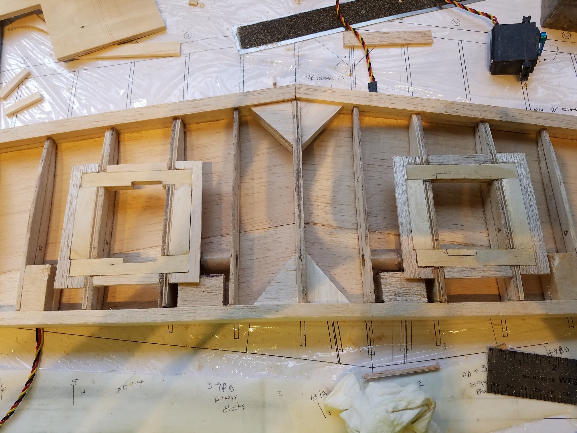

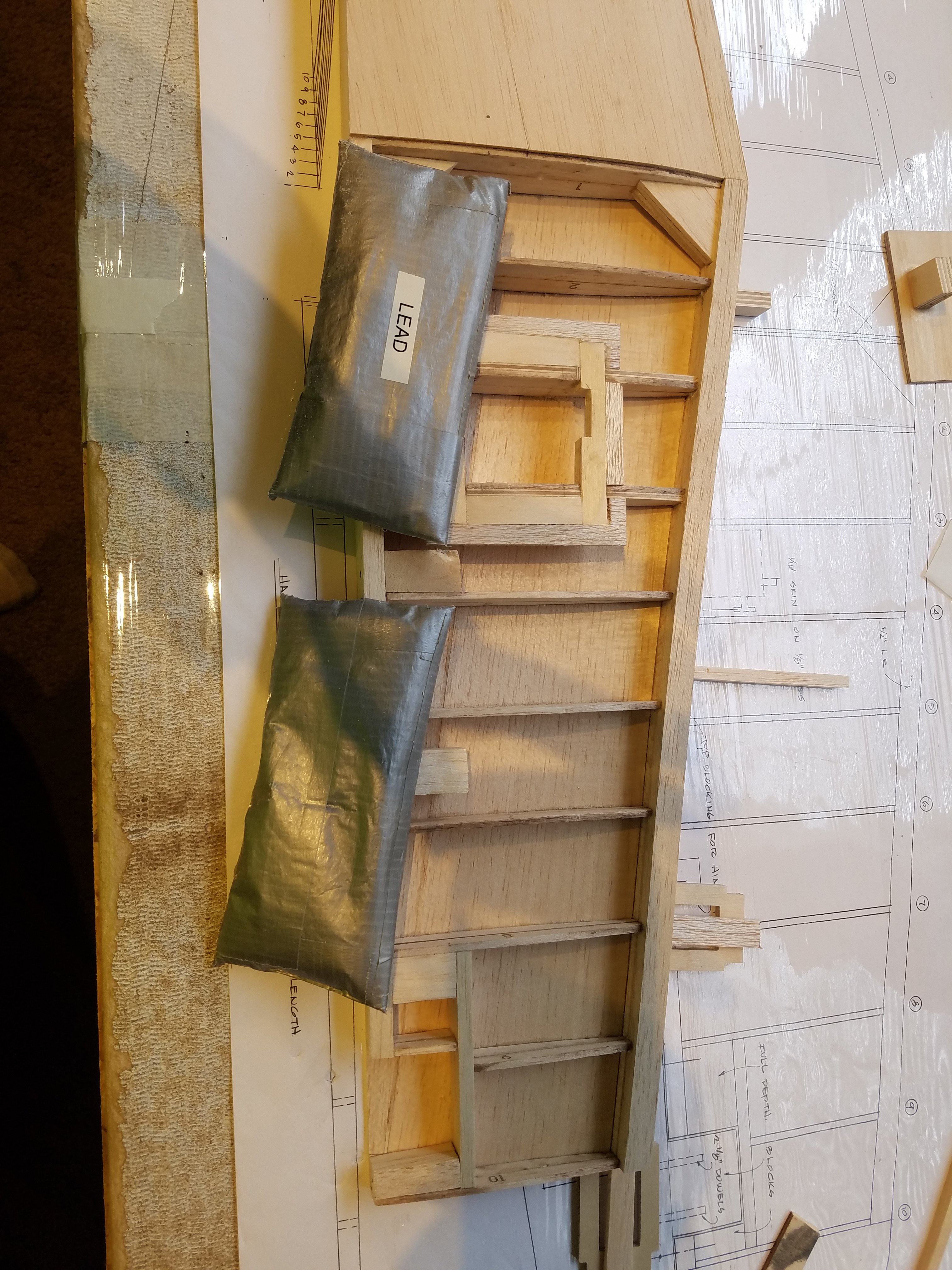

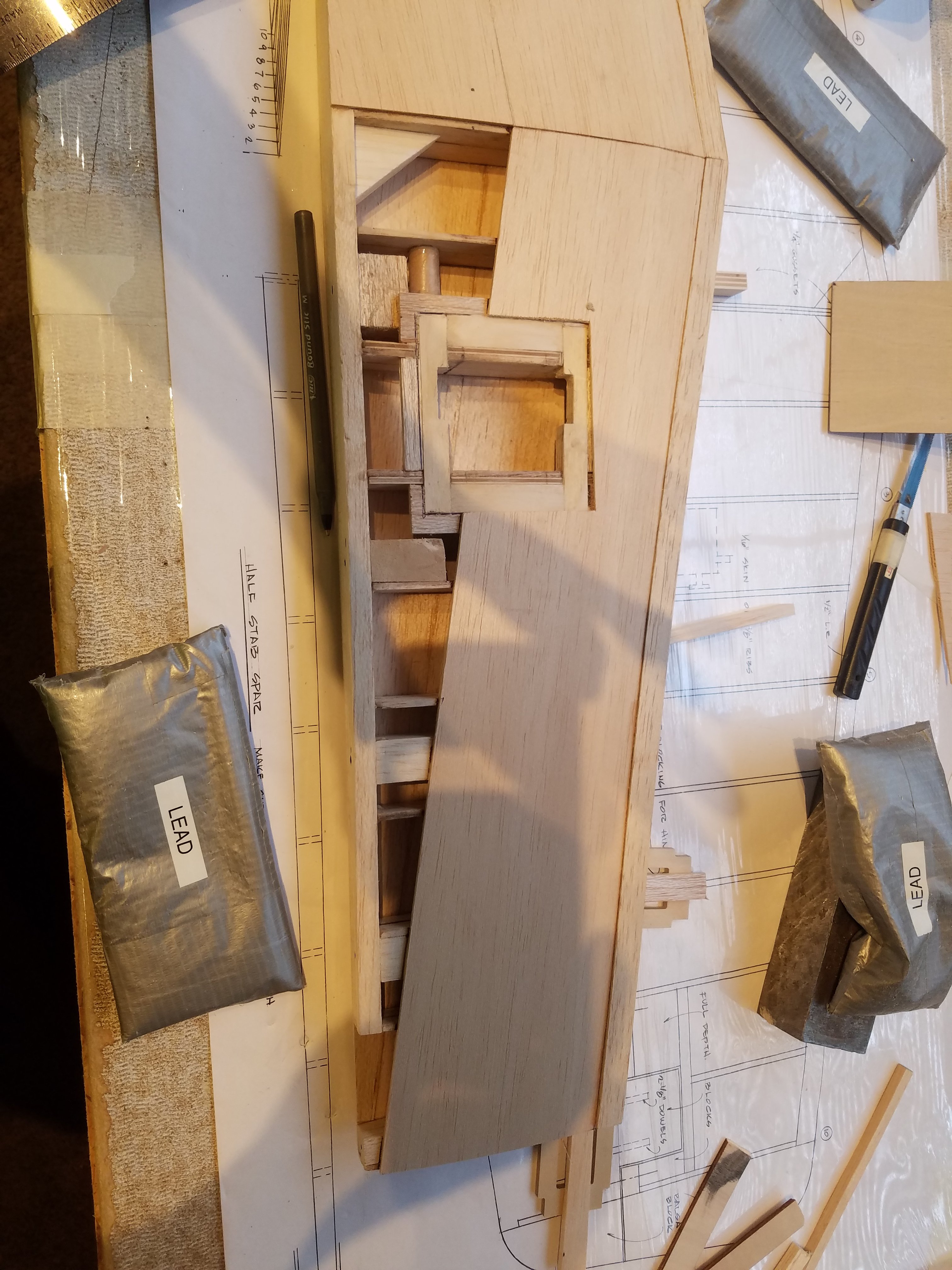

I got as far as I am going to tonight fellas. I finished up the servo door rails and border. Then finished the servo doors and servo mounting blocks. Got the bottom right side of the stab sheeted. The rest will just have to wait. I have a CA Headache. LOL.
20190227_153624.jpg 20190227_153631.jpg 20190227_161321.jpg 20190227_163400.jpg 20190227_193416.jpg

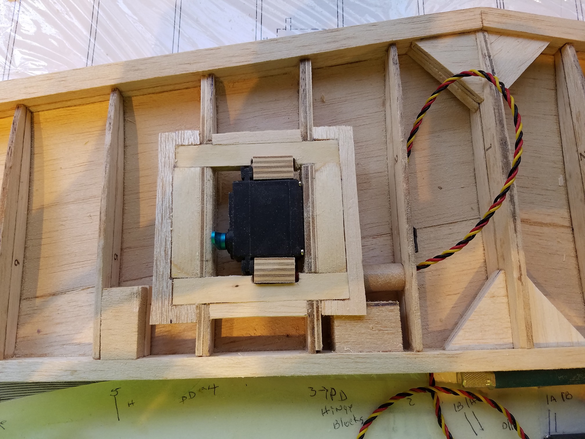

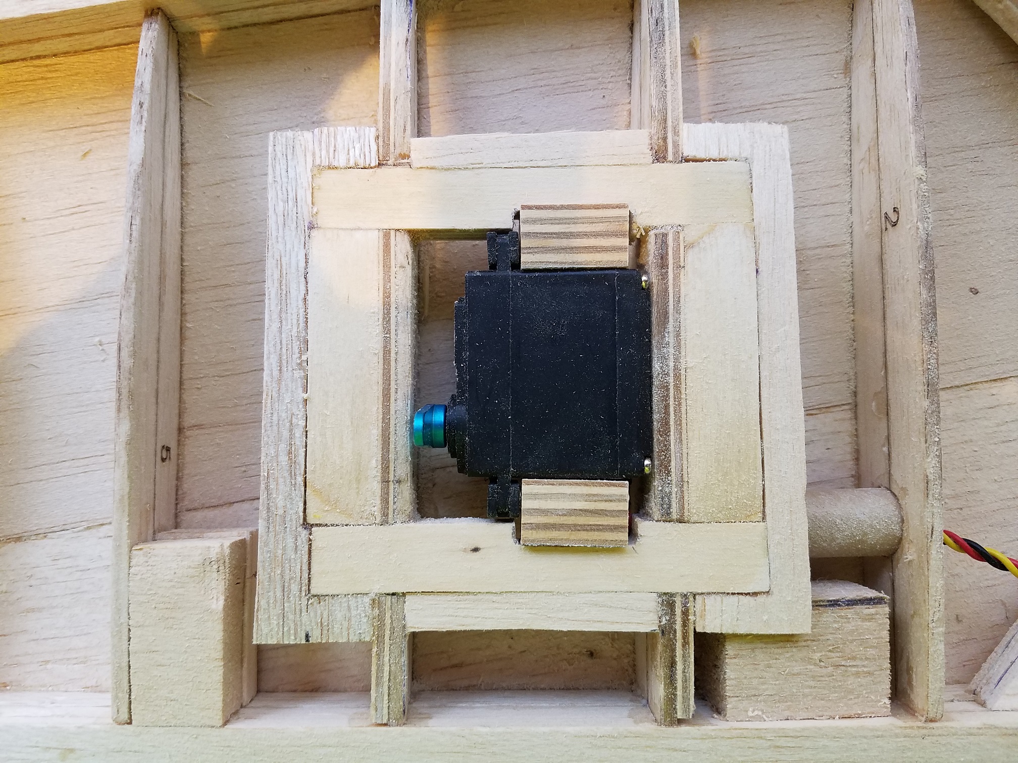

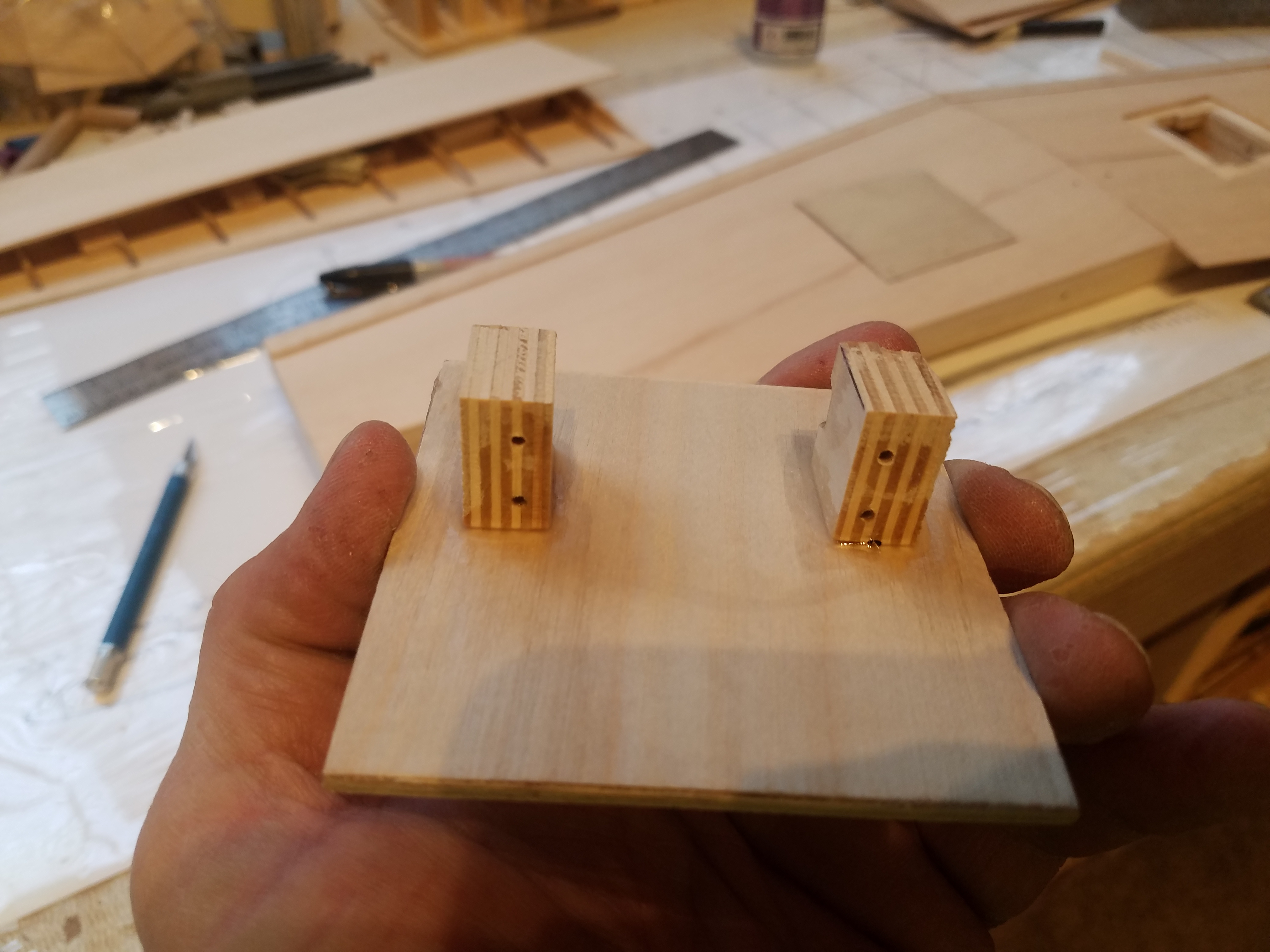

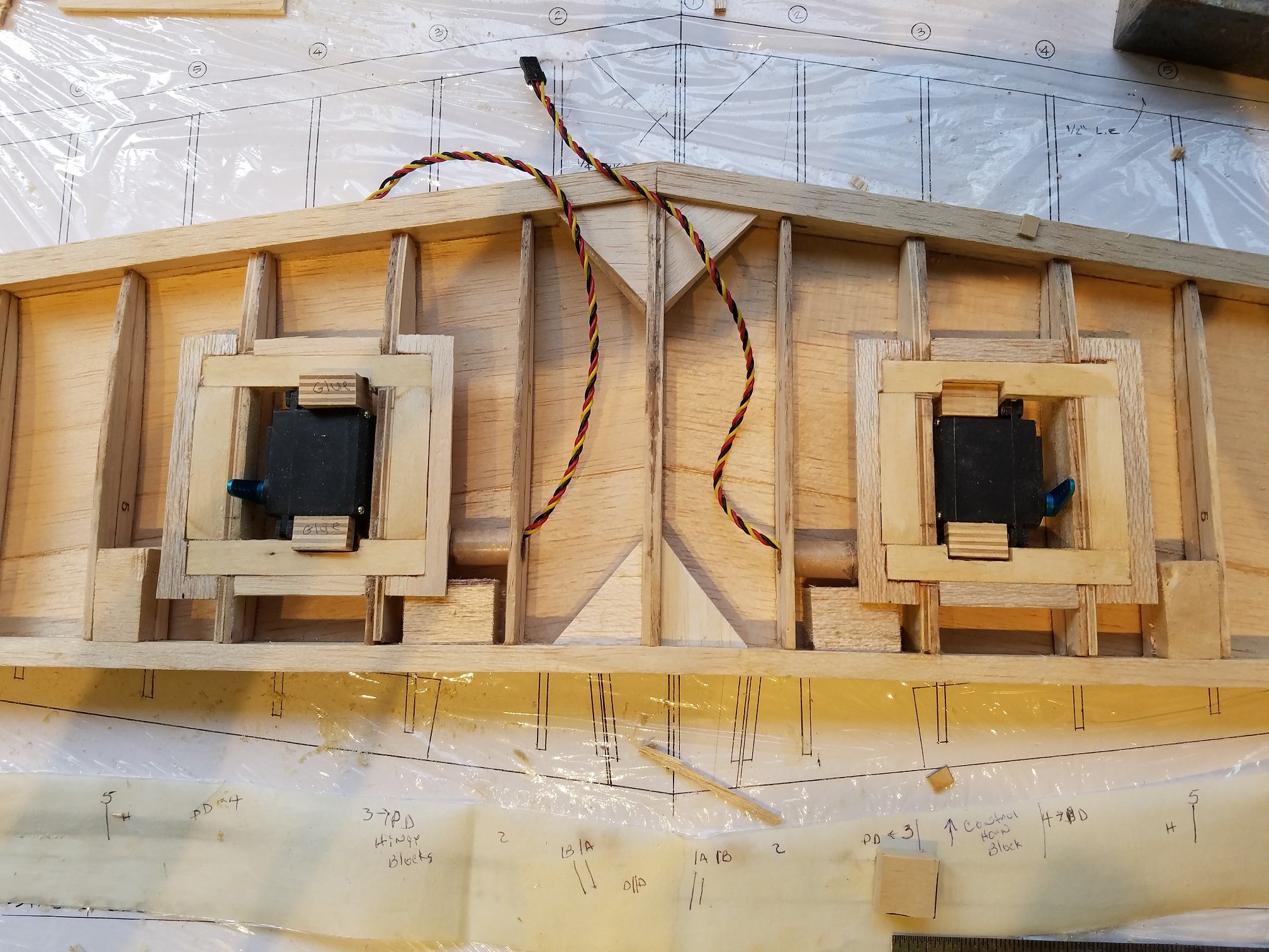

I really didn't know any other way of insuring a perfect alignment of the servo mounting blocks to the servo doors. Soooo.... I improvised. LOL. Basically what I did was slightly insert the servos into their perspective bays leaving them protruding out just a little. Then after applying the necessary amount of glue to "tack" them into position, carefully aligned the door over the correct location and layed them on top of the blocks. It actually worked great. Now I know they are perfectly set. After removing the servo door and servos from the servo bay, I finished the gluing process of the blocks to the inside of the doors and set aside to cure. Once that was done, I sheeted the bottom right side of the stab.

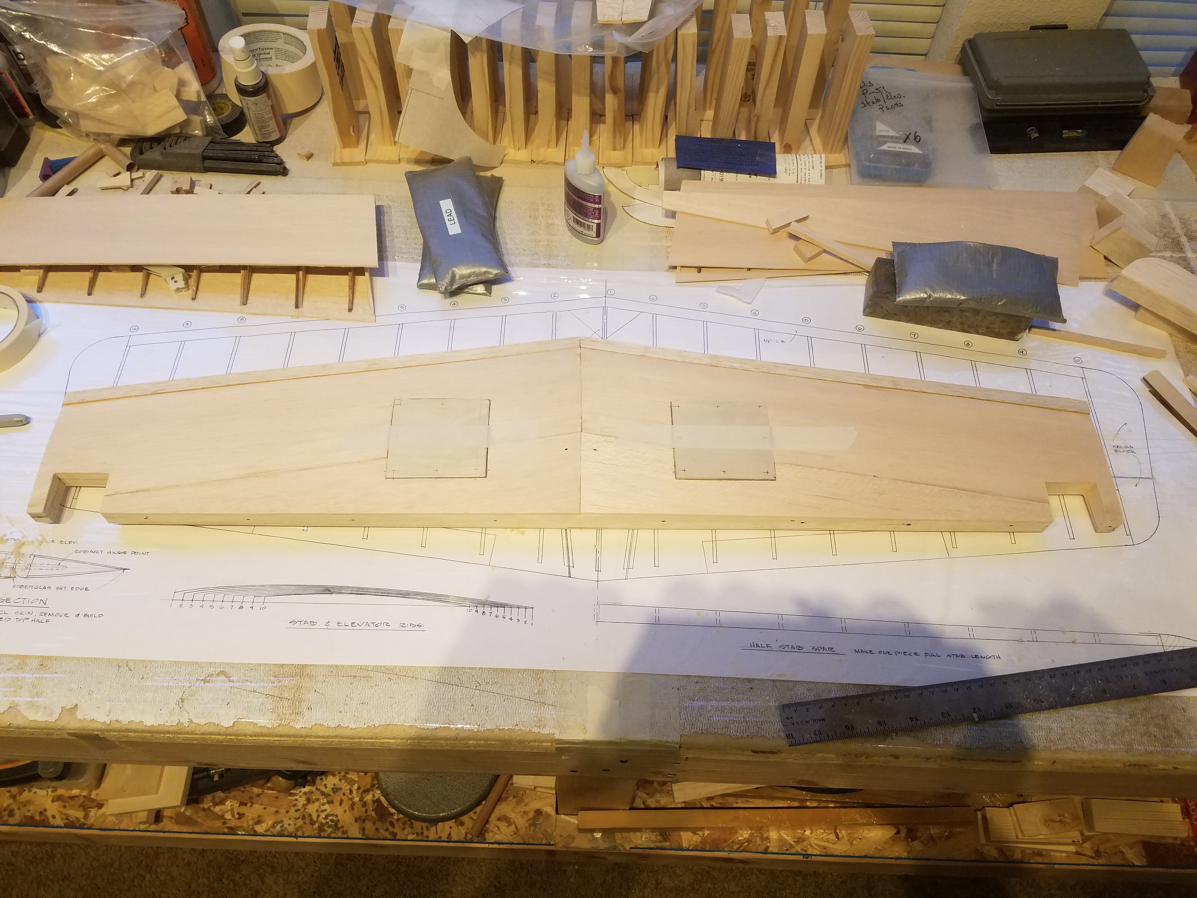

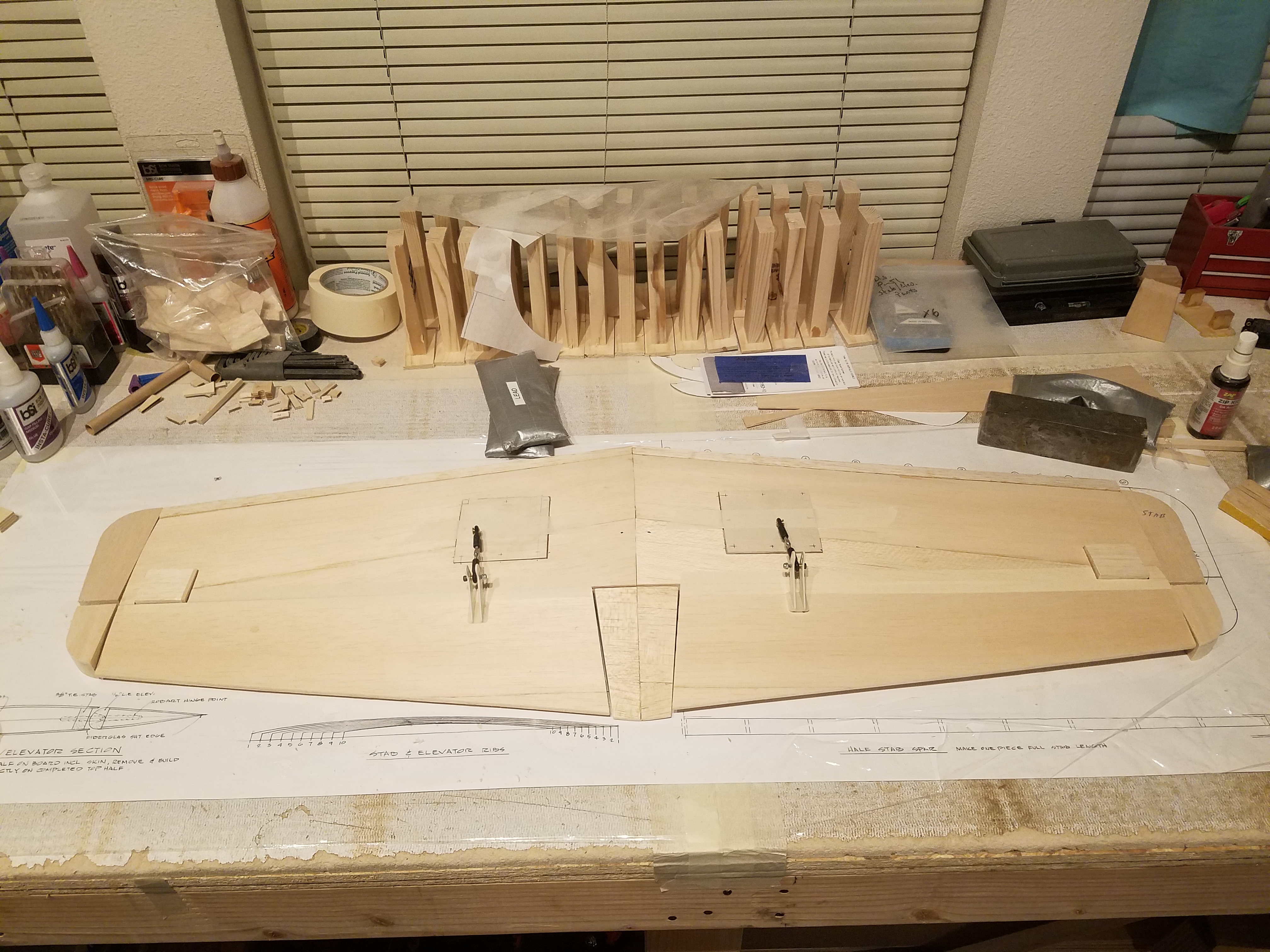

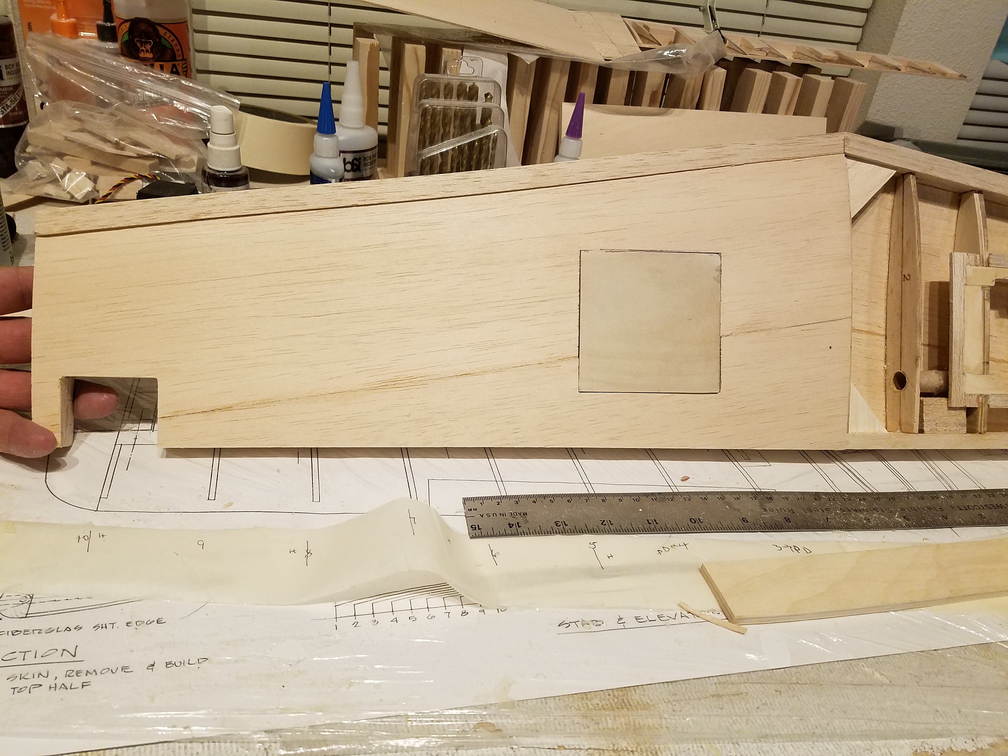

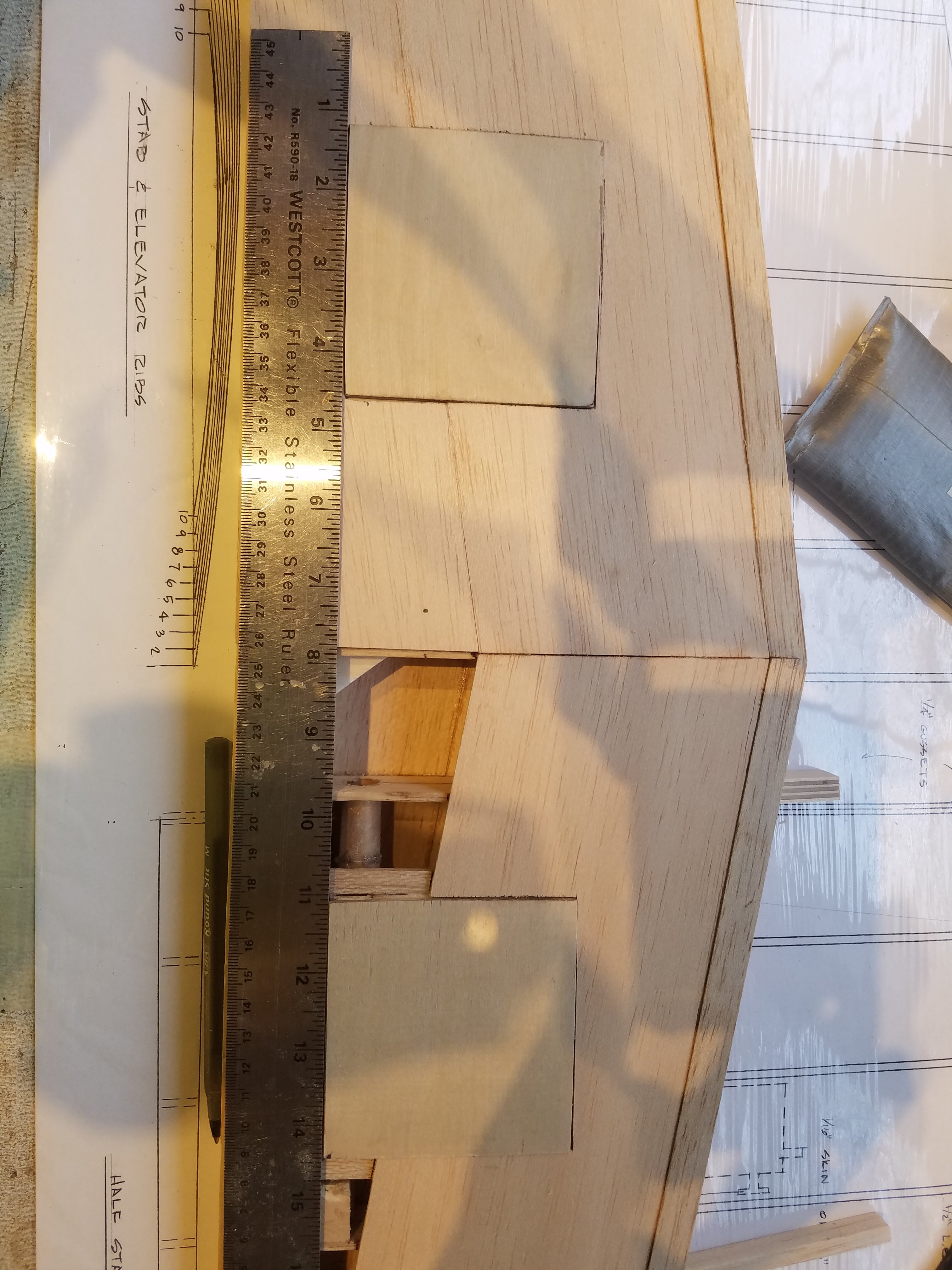

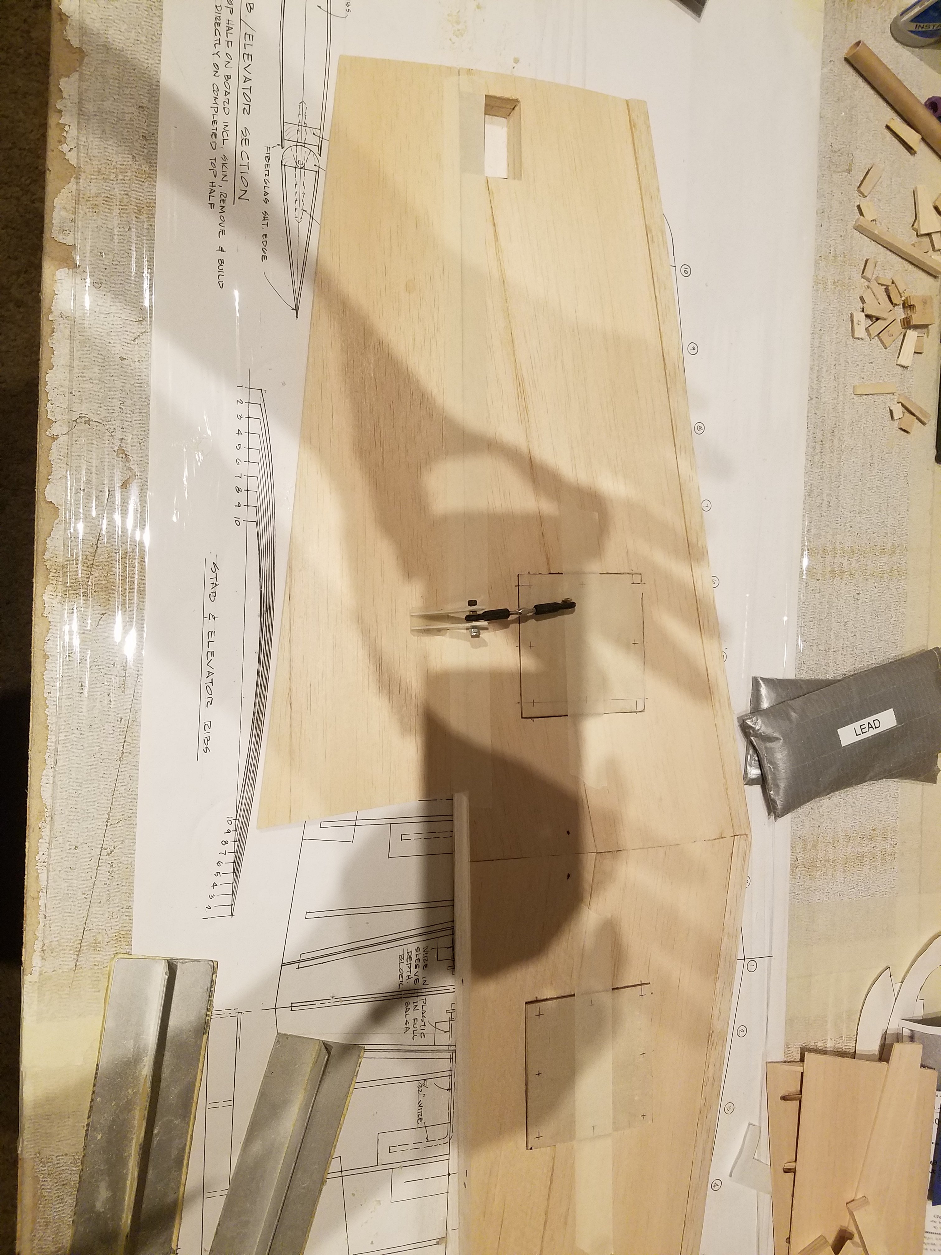

A little more work on the Mustang stab and elevators after work today. Which actually leaves very little yet to do. I accomplished getting the stabs and elevators sheeted on the bottom. Slotted the elevators for the control horns. Which was very easy since all I had to do was slice the sheeting over the top of the preexisting slots in the control horn blocks. About all that is left to do is glue the tips on the ends of the stabs and elevators. Then shape and sand and set aside for glassing.
20190228_162530.jpg 20190228_171054.jpg 20190228_171205.jpg 20190228_173946.jpg 20190228_181811.jpg 20190228_185110.jpg 20190228_195325.jpg
I will probably finish the stabs/elevators this weekend and set them aside.
