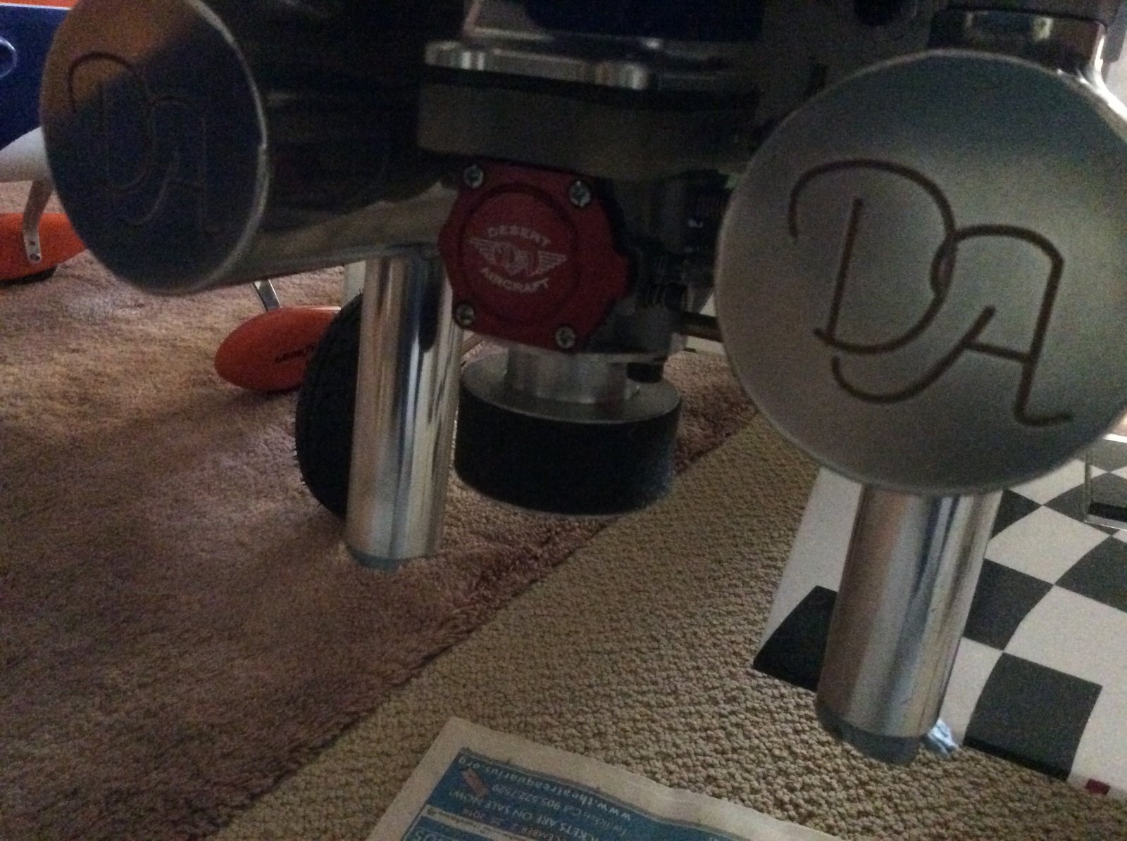

    If you look at carburetor you will see an air intake and filter on it works great and it is made by DA. Keeps the dirt out and has zero effect on the engine no rpm loss at all great little air cleaner to keep dirt out of you engine.
    One comment if you face the Secraft intake forward you will run into some real tuning problems. Tryed it and could not get it to work ran it backwards and all my difficulties went away. If you do get to work pointing forwards would really like to know the outcome and what you did.

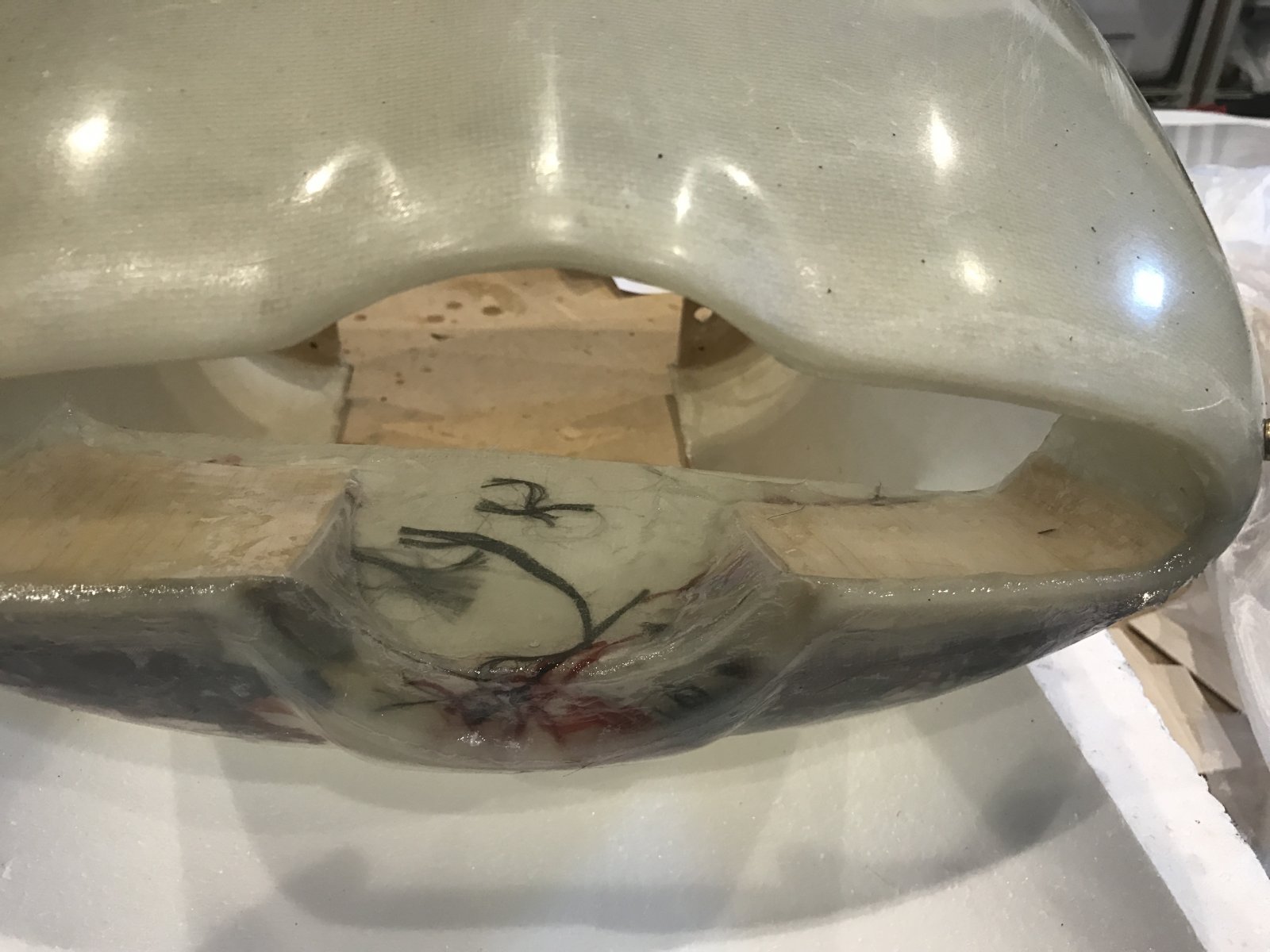

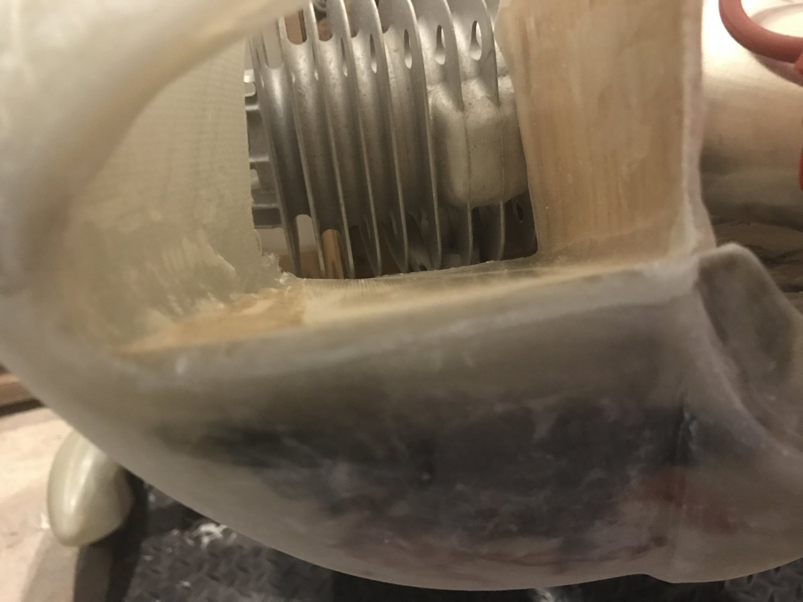

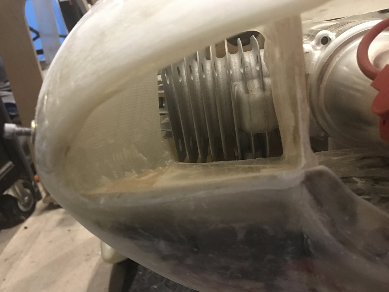

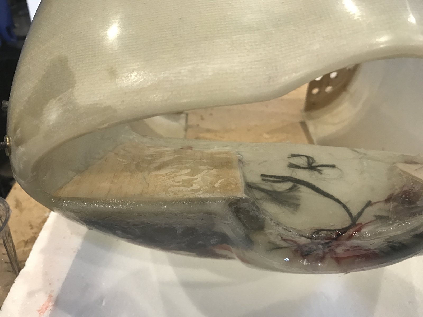

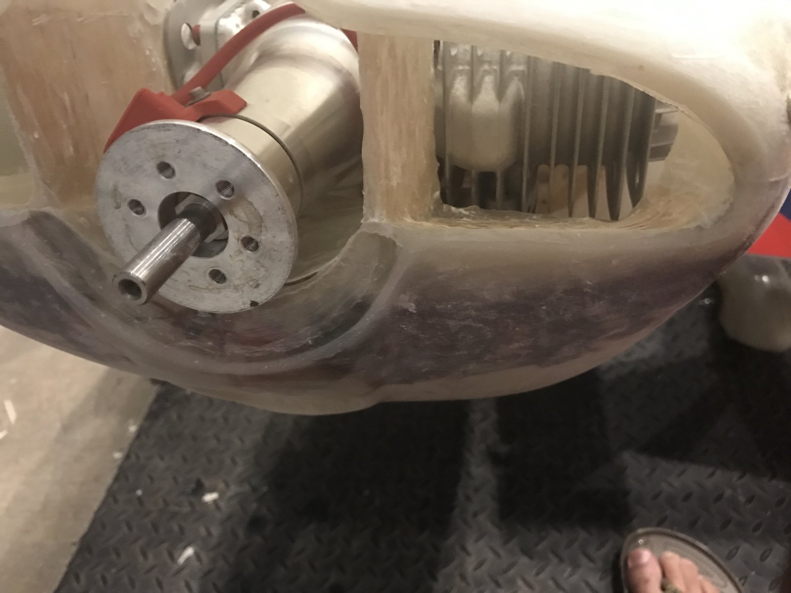

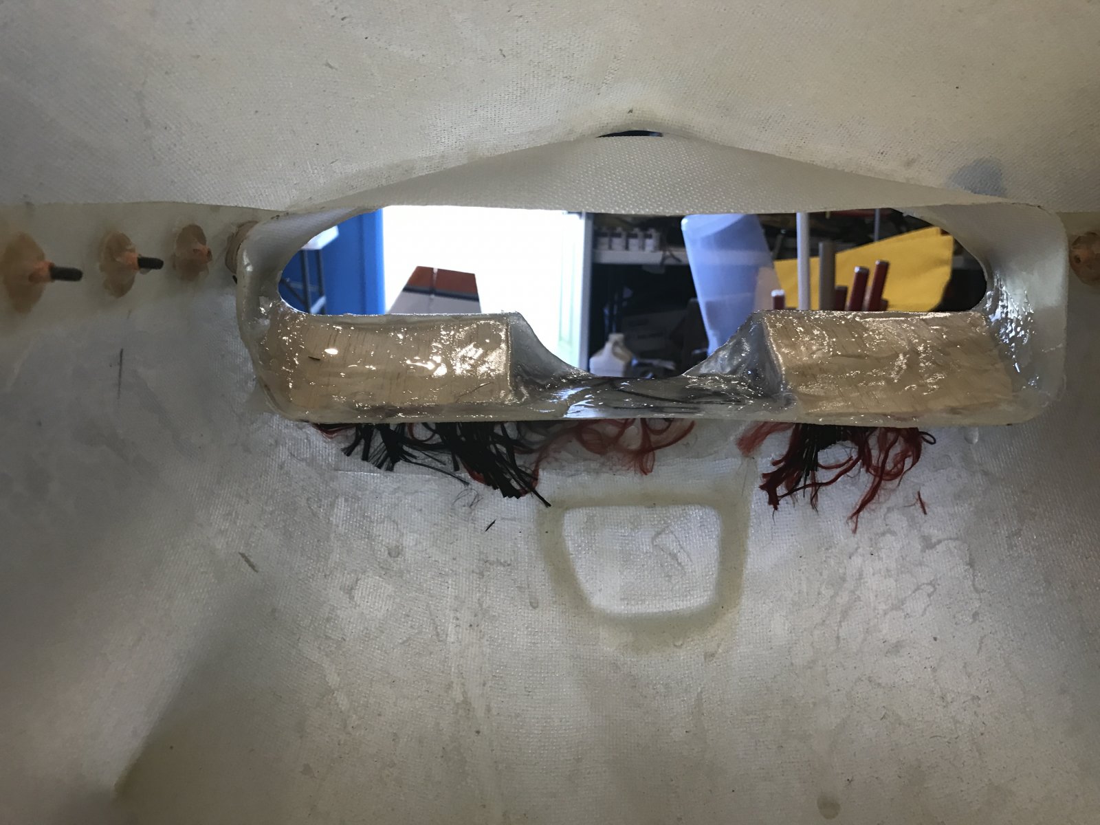

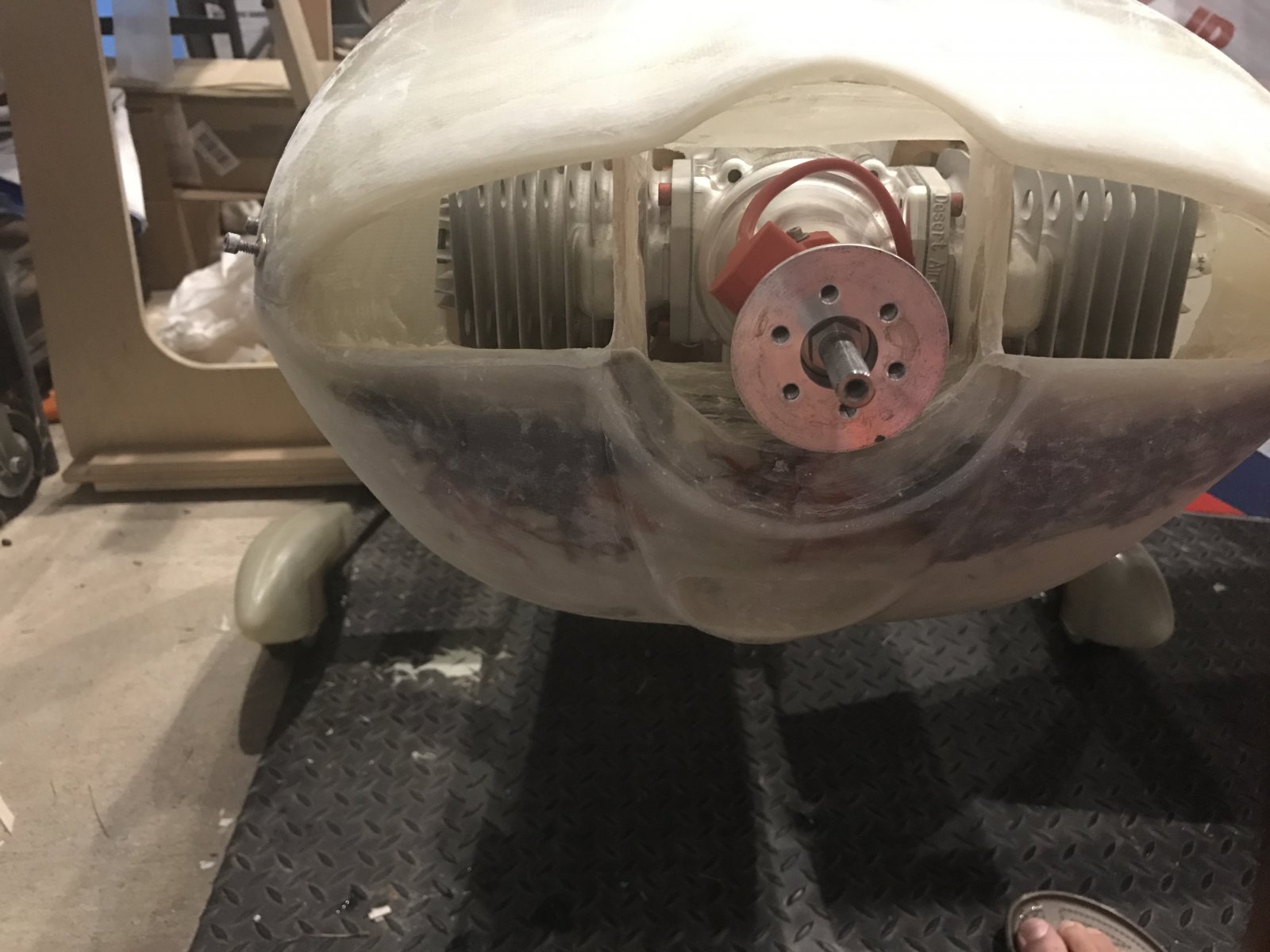

    In Dallas right now with the family. Took these pictures before leaving. Still not done with it, but you can get an idea of what I am doing. Once this cures, will lay one last layer of cloth and resin then fill gaps with the Dolphin glaze, then sand it smooth. Then I can primer and paint.
    thurmma, pawnshopmike and Rusty 73 like this.
  6. That should hold up fine under , i like how you incorperated a few strands of fibres in with the epoxy . Your artistic side haha
    I like how you used balsa wood to support the fiberglass , well done Cam.

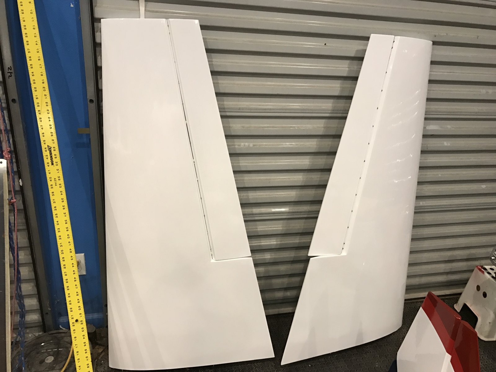

    Finally finished the baffles for the airplane with the twin. Now, to work on the baffles for the airplane with the quad.
    Also, almost done covering the last set of wings, except, I am having difficulty doing the final curves on the top of the wings.

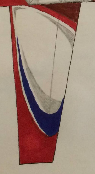

    wings are covered, I just need to figure out how I will cut these patterns:
    Snoopy1, Rusty 73 and WMcNabb like this.
  10. HRRC Flyer
    HRRC Flyer GSN Sponsor Tier 1
    Hey Cam,
    Here's a little trick I learned that you may already know. Make a cardboard or thin ply template of the shapes you want. Then take two pieces of Monocote and lay one face up and one face down on top of each other on a glass or very hard surface. Put your pattern on top and cut through both layers of Monocote at the same time. This way you will have two pieces that are an exact mirror of each other. Most importantly, be careful so your template doesn't move.
