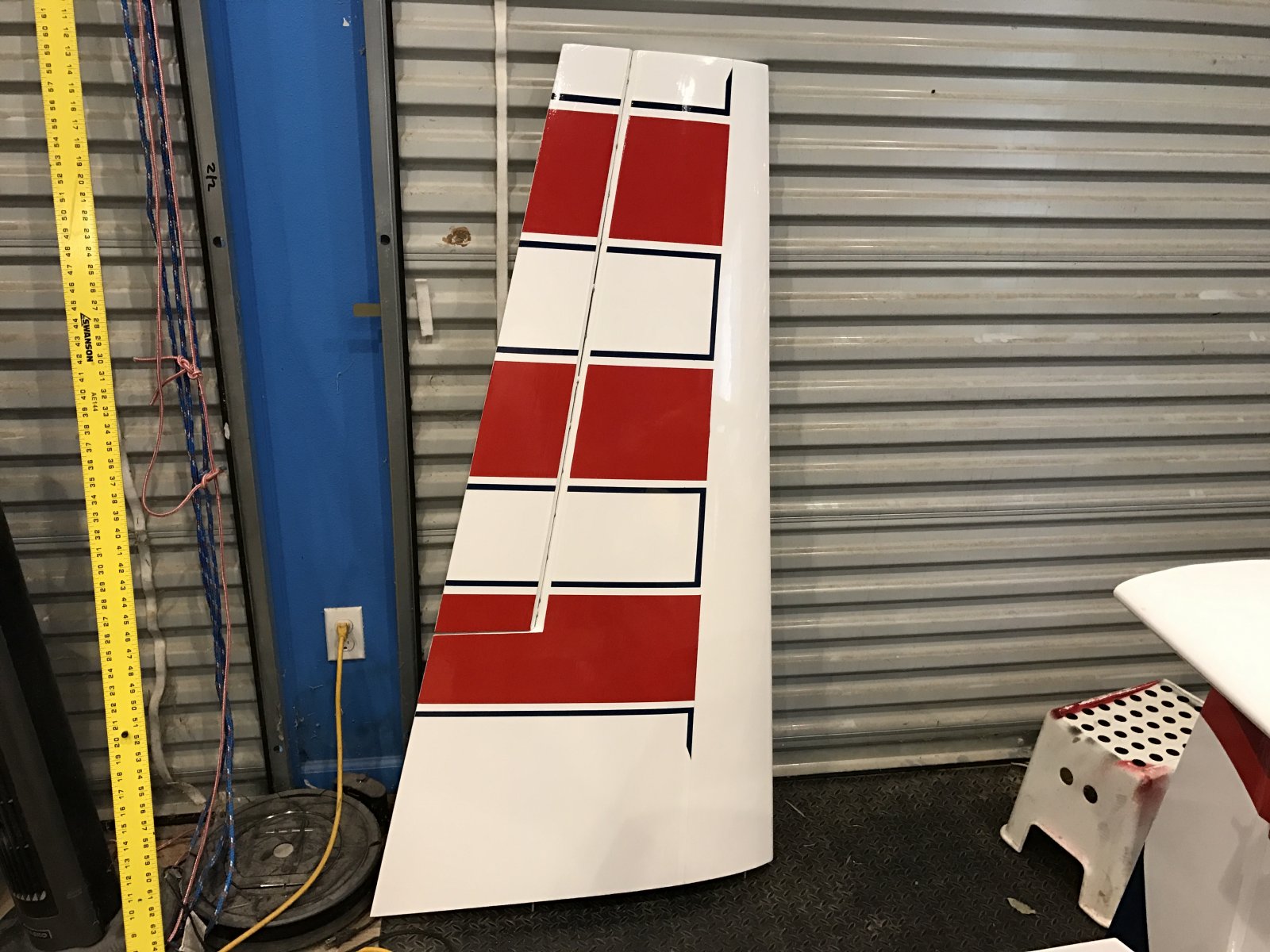

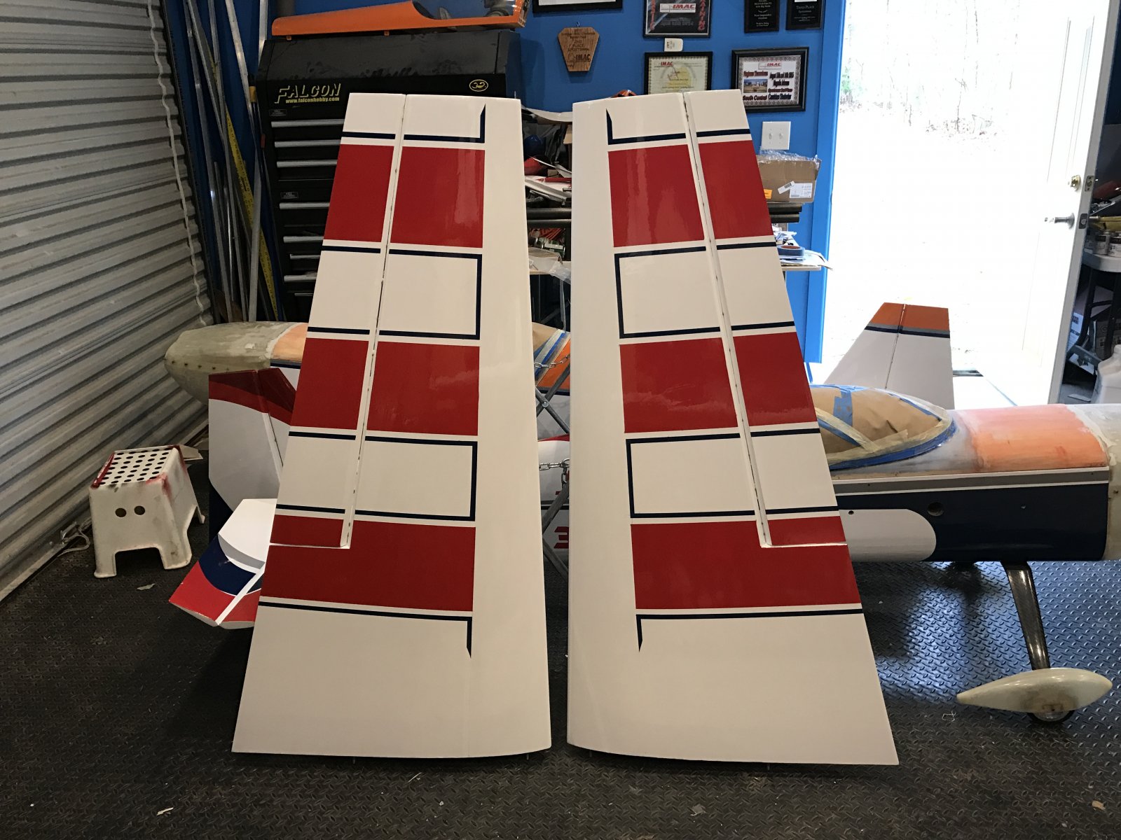

    Did the stripes on the bottom of the wings. Soon, to tackle the top side! As you can all see, I am very hesitant or should I say, timid, on tackling the top covering!

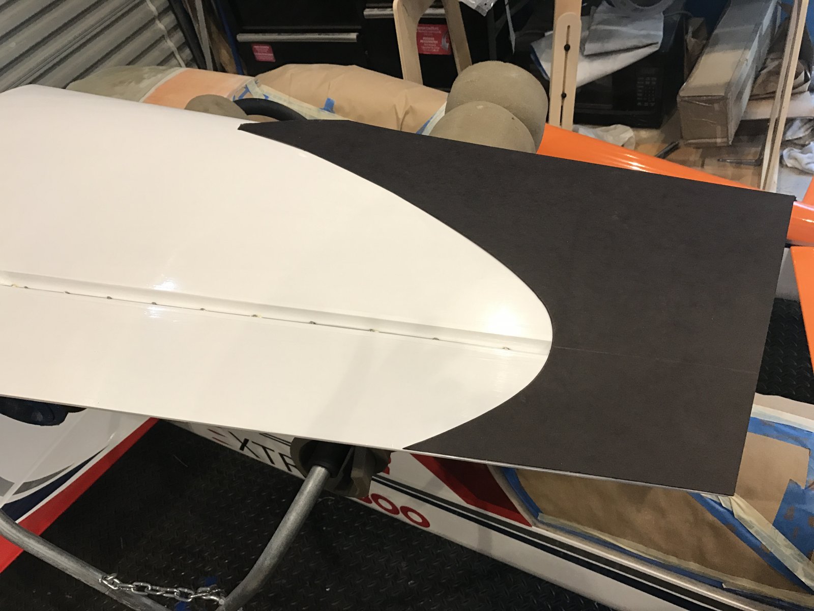

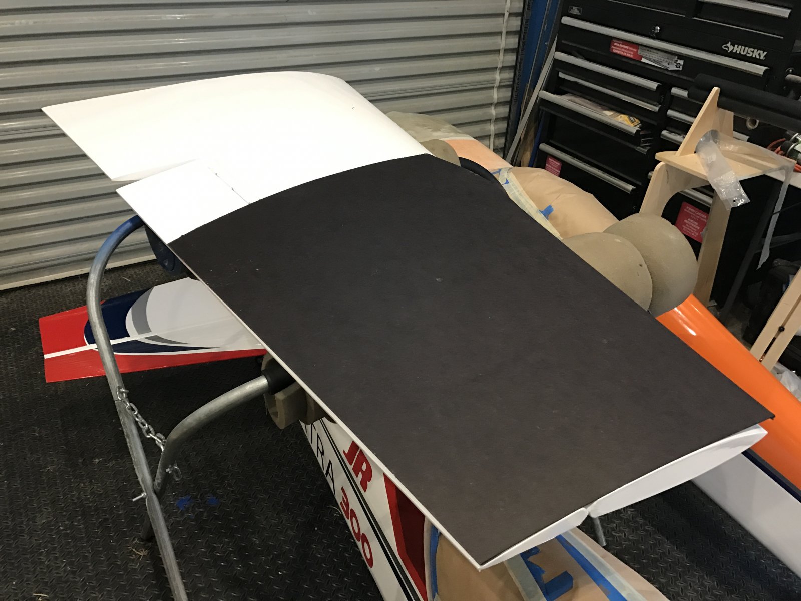

    Ok, I got off my keister and started to work on the top covering for the wings.
    this is the bottom of both wings,
    I used this thick cardboard, and cut it to the profile of the wing tip.
    Then, using long French curves, and all kinds of calculations, I was able to cut this template to this...

  6. It's a bombe -0.5f or -18c outside .
    So did you use the template for the elevator cuve and just increased the curve to match the design on the wing ..
    orthobird likes this.
  7. orthobird
    orthobird 150cc
    No, I made a new one.

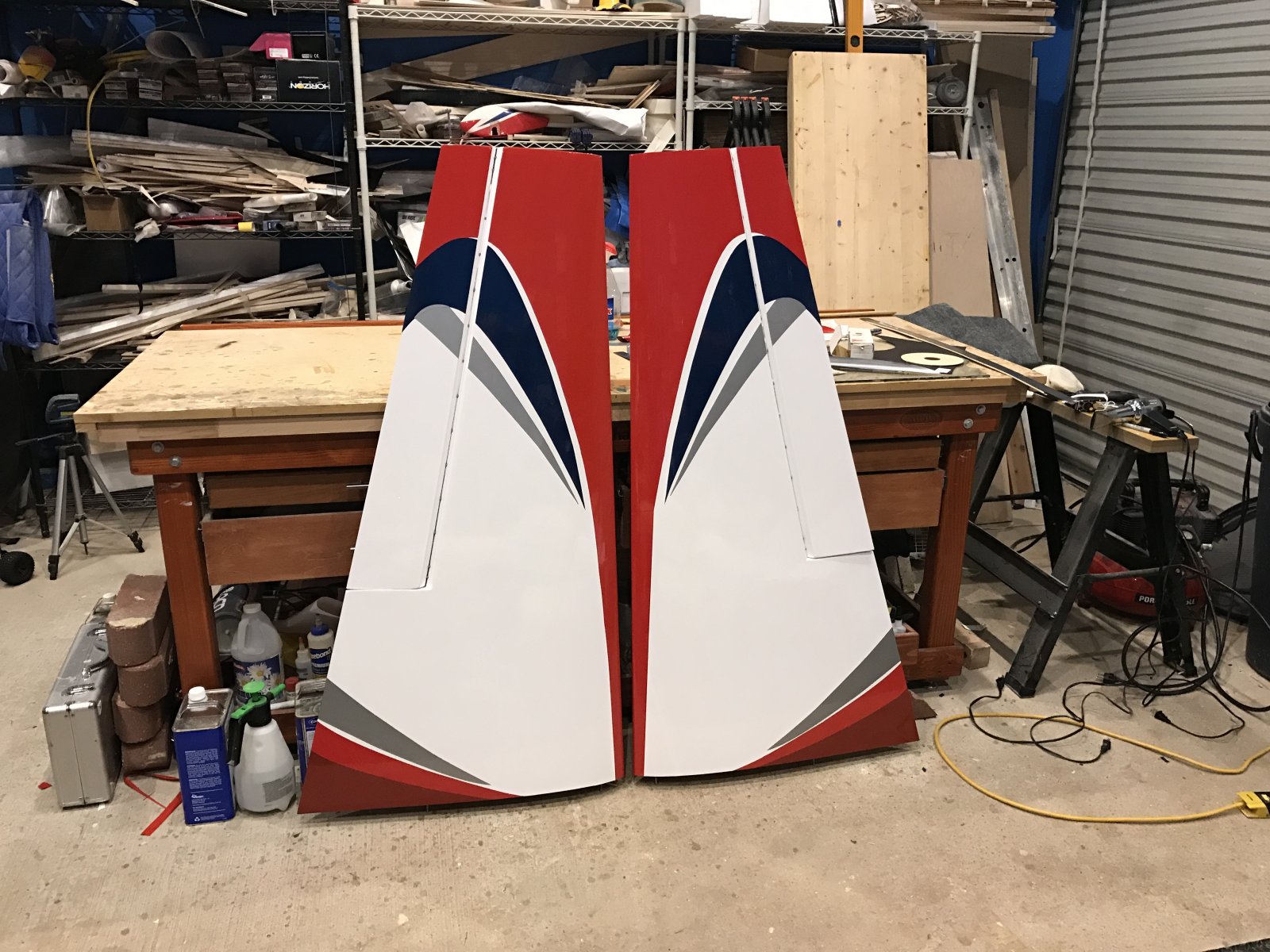

    Finally! Done with covering. Next step is the primer and painting of the glassed parts (landing gear cuffs, wheel pants, cowl, & canopy). And, before that, one last thing, the baffles for the quad.

    Wow that was quick. Looks great. Have 2questions. One of my problems is that I have a French curve but only 12 inch long how long is one you have. And second question is the Ultracoat over the white did you use water soap method and then squeegee the water out with balsa and then seal the edges. If you did how long before you sealed it or put heat to it to seal it.
  10. orthobird
    orthobird 150cc
    Thank you Snoopy!
    I want to say it is almost 24" long
    I am using Monokote, and used ammonia dilute with water. (With Ultracote, it would be soapy water).
    With the Monokote, there are threads that describe the technique, of "Monokote over Monokote", and they say, wait 24 hours after applying, and then 24 hours later, seal the edges, either with trim solvent, or warm iron.
