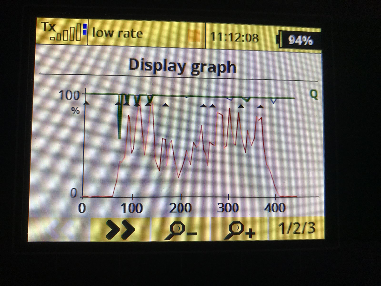

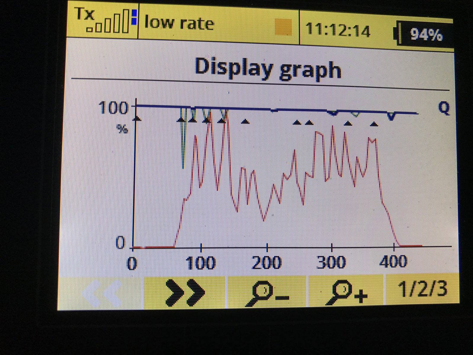

Question trying to understand the signal strength grafts. Please just bear with me. At 100% does that mean the receiver received 100 % of the info from the radio. So at 50% what did you lose. You got 50% less of what and what does it impact. (Only distance does that mean you have lost half the operating distances?...). Ok at what % loss are you at risk of losing the plane.

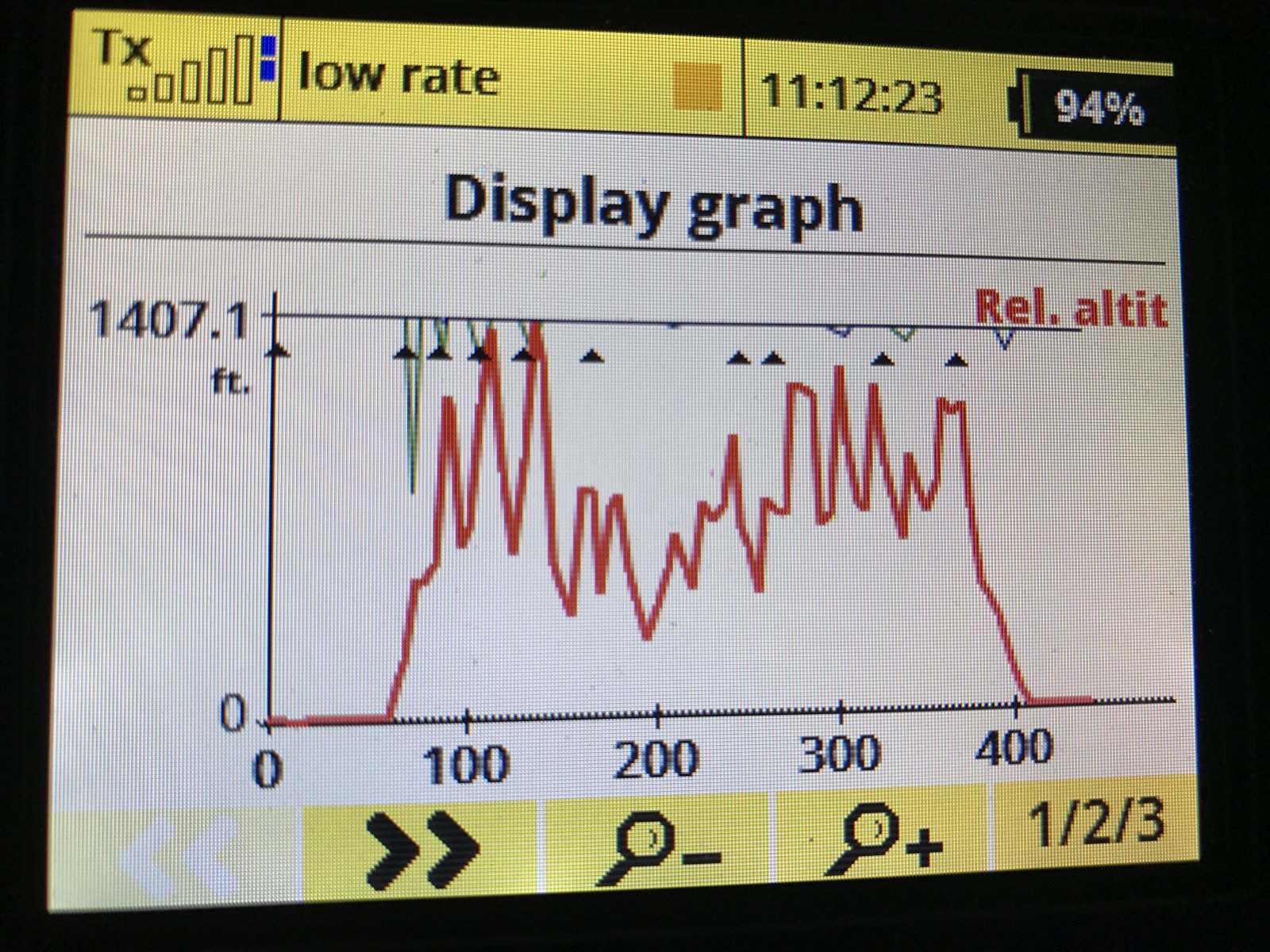

Love the height graphics are you surprised at height you are flying at it looks like you averaging 500 ft that is a surprise to me or am I reading the graph wrong. I do like it.

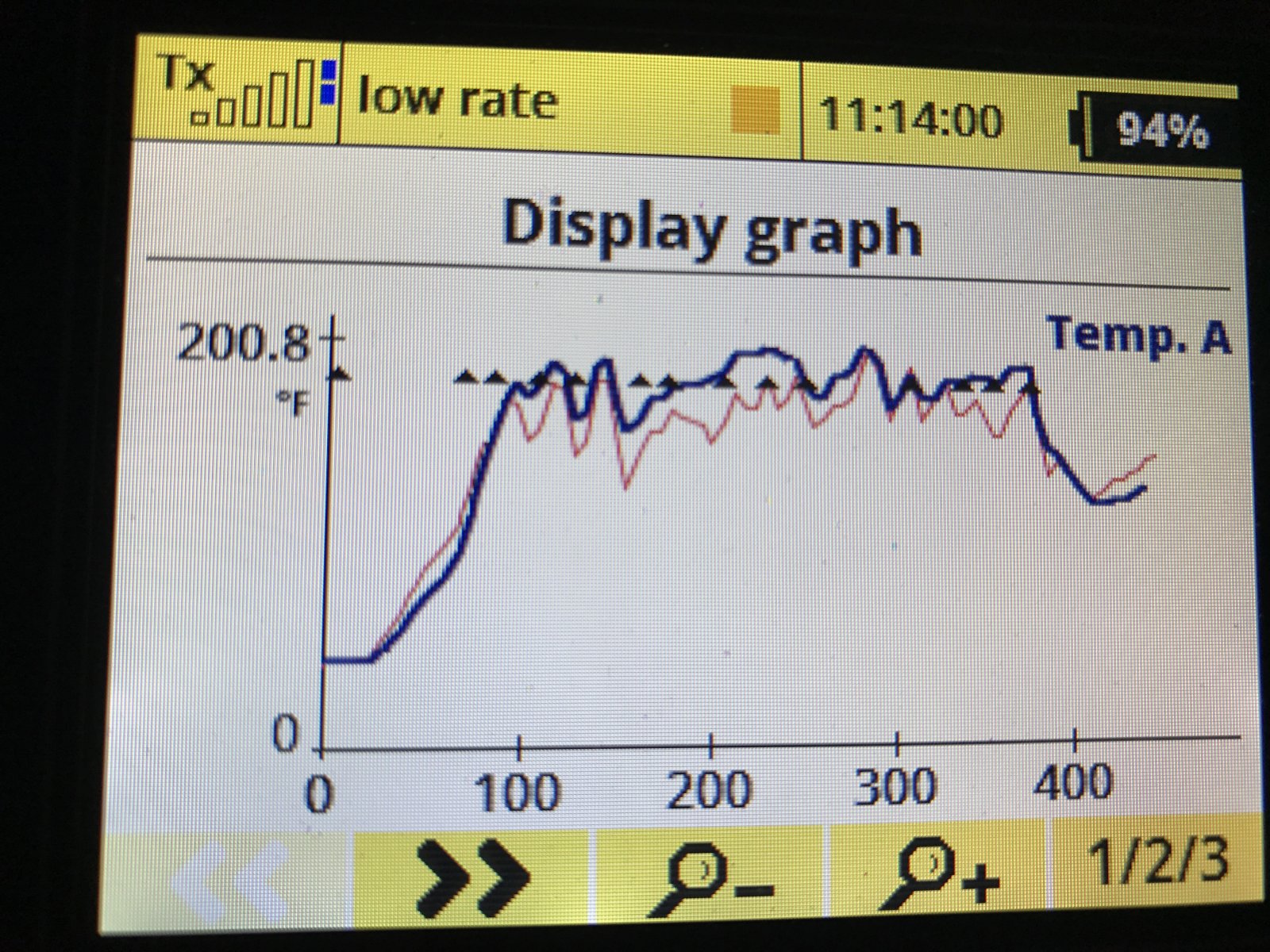

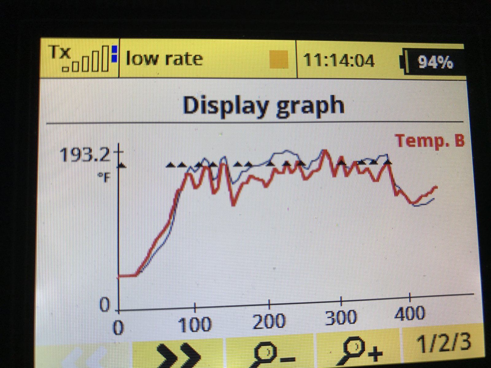

I know it's cooler now than summer but how high would your engine cylinder temps peak at before your alarm comes on ?

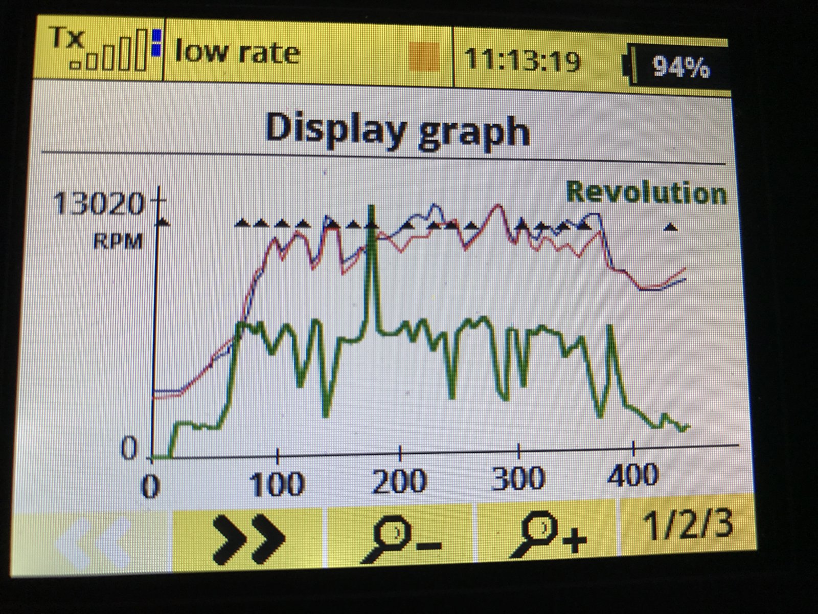

I just cannot stop looking at the graphs. Looking at your temperature and RPM graphs it looks like your temps are going up when your rpm props or the the two graphs not quite lining up. Would be interesting to see the a long sustained run and then look at the temperature correlation.
