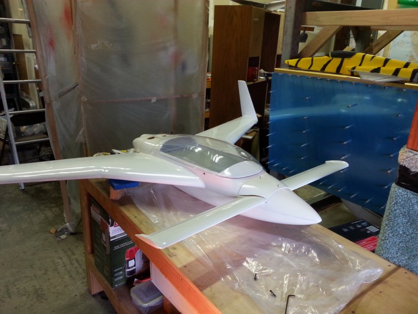

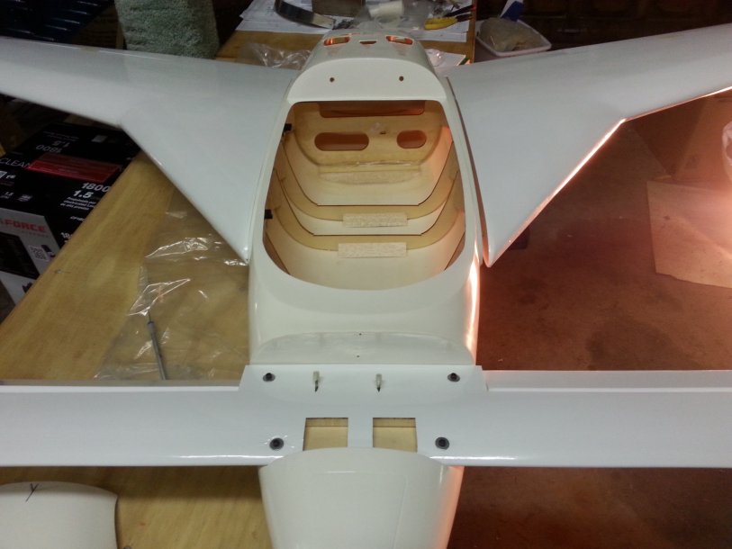

  3. I wanted to get an idea of the fit and quality of the parts, so a mock-up was the first thing I accomplished. In general, the parts are pretty good quality. The formers in the fiberglass fuse weren't glued in very well, but the kit actually includes some fiberglass and microballoons so you can reinforce those joints. The built-up wings, winglets, and canard seem sturdy, and are covered in Ultracote. A little CA here and there will make me feel better but the parts seem plenty strong for flight. The aluminum wing tube was a bit of a tight fit, so some light sanding on it helped there. I haven't used an aluminum tube in some time and forgot about how they oxidize and get on your hands. Yuck.
    The canard is removable with four screws, the wings are two-piece, and the winglets remove from the wings with four screws. The servos are mounted right to the canard and winglets, making it very easy to break this plane down quite a bit for transport if needed.
    The canopy is one-piece lexan, so that will need to be painted to give the proper cabin look. The window frames are molded into the canopy and paint mask decals come with the kit, so painting it shouldn't be much of an issue. The fiberglass fuse is white but doesn't match the Ultracote very well, so I'll be painting that and the wheel pants for a better match. I want to capture the look of the full scale Velocity, so my plane will be mostly white with some trim here and here to add a little color.

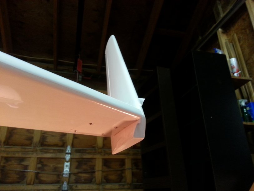

  7. Here's a shot of the winglet being epoxied to its mounting plate. The instructions call for epoxying the winglet to the plate first, then drilling the screw holes and mounting the plate to the wing. If I had done that, the winglets would have had a bit of a gap between them and the wing tips. What I did was drill and screw the plates in place first, then fit the winglet to the plate. In doing so, I found I needed to trim about 1/4" off the ends of the plates so the winglets would sit up against the wing. A little wax paper in place while the epoxy cures, and the end result is a nice, tight joint. I got a little more work done but didn't take any pics before heading out on a trip, so that's all for now. I'm hoping to get more garage time in soon so I can have this plane flying by the beginning of summer. 20150220_091400.jpg

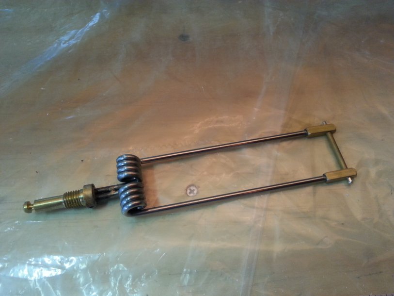

  9. 20150304_115154.jpg Got some more work done on the Velocity last week. The nose gear is a very beefy double-strut unit that gets soldered into a brass pivot unit. This will stick outside the scale nosewheel pant and fairing, but there will be quite a bit of weight on the nosewheel so the manufacturer found it necessary to go with this setup.

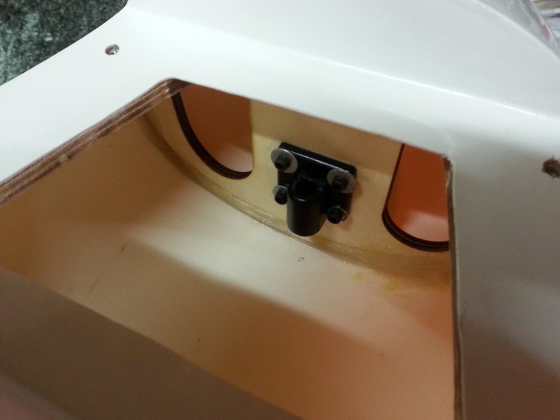

  10. 20150304_115219.jpg Here is the nose gear mount. Very beefy setup. Looking at the CG, nearly half of the model's weight will be on the nosewheel. This is much more than a typical tricycle gear setup. A hole will be drilled in the belly to allow the brass unit to slide into the mount.
