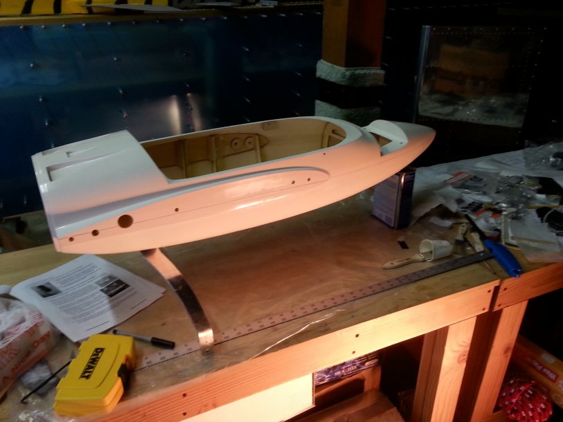

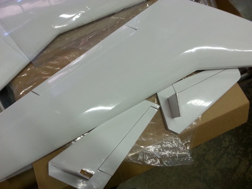

  1. 20150304_112038.jpg All control surfaces are hinged. I bought some pinned flat hinges but did a crappy job keeping glue off the pivot points, so by the time I got to the ailerons I said hell with it and used the included CA hinges. I hate hinging. Controls on this plane are scale and tiny!

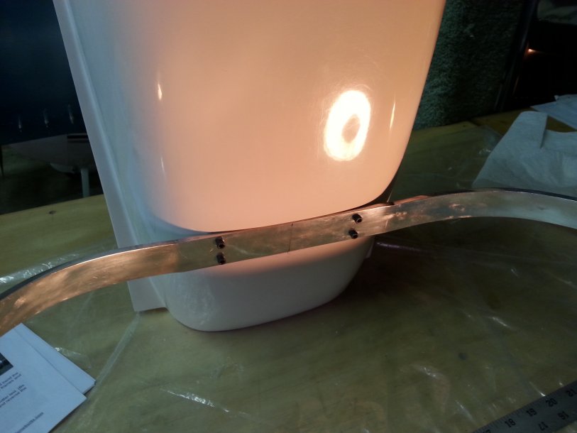

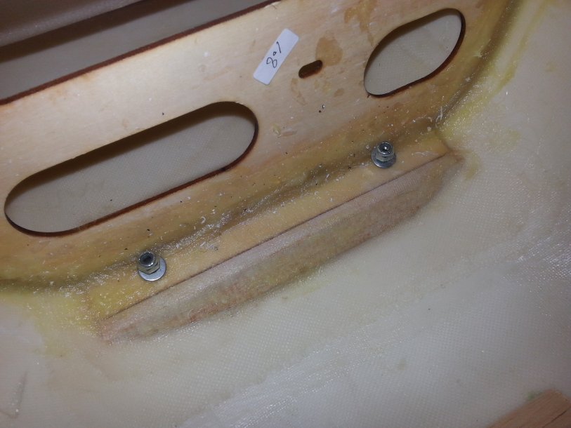

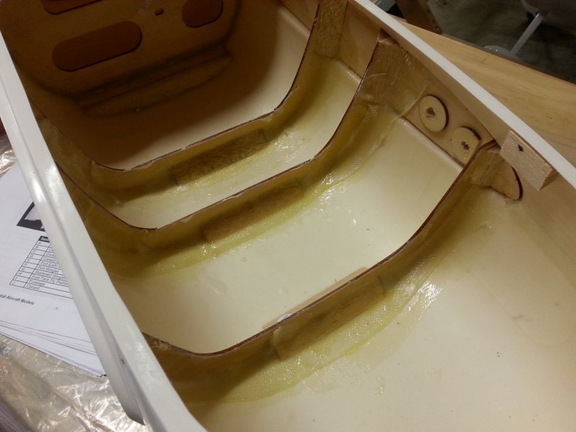

  2. 20150304_112023.jpg The kit comes with fiberglass and microballoons for reinforcing the fuselage to former joints. I used thinned epoxy for the fiberglassing. Kinda turned out meh but the joints are plenty strong now. I still have to reinforce the two formers in the nose. The manual says it's very important to reinforce the former where the nose gear attaches so I can't skip that.

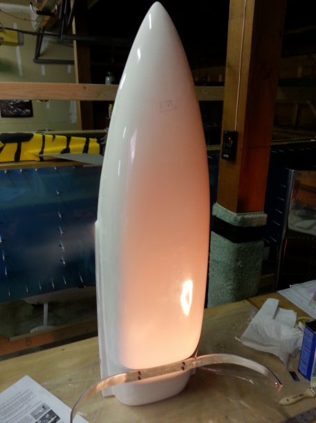

  3. The main gear is predrilled but the gear mount on the fuselage needs to be drilled for the bolts. The gear attaches with a washer and locknut on the inside of the fuse, which becomes tricky for the rear bolts since there is a former right in the middle of the gear plate. A quick test fit of the main and nose gear shows everything looking pretty good. 20150304_114810.jpg 20150304_114802.jpg 20150304_121323.jpg 20150304_114912.jpg

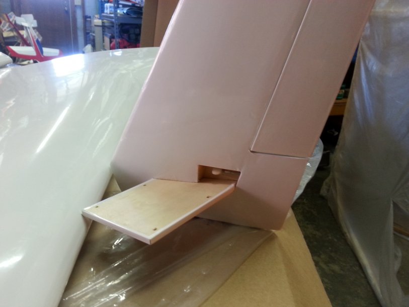

  4. Starting the servo installation with the rudders. The rudder servos mount to the wingtip plates, making the wingtips easily removable. The kit includes a servo saver type setup that allows the servo to pull the rudder horn, but not push it. A spring is used to center the rudder when the servo centers, however, I found that the spring doesn't do a very good job centering the rudder. I attribute this to too much friction on the servo saver, not allowing the pushrod to slide freely through the barrel on the servo arm. The geometry between the servo arm and control horn motion is pretty jacked and I don't think it's a good setup, so I will simply run two rudder channels and set up the ATVs to only allow the servos to move in one direction (outboard) 20150304_121305.jpg 20150305_131652.jpg . This will allow me to use a solid rudder pushrod.
