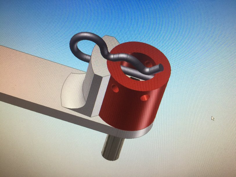

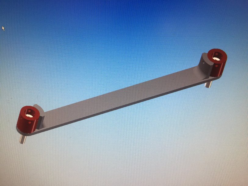

I have a new, smaller vehicle as my daily driver, a Chevy Equinox so I am going to have to take the stabs off and on to transport it. This precludes Locktite etc. I'm worried about the M3 stab screws backing off. Here is a possible idea, with a printed and epoxy'ed plastic knob over a M3 socket head, and use a baby pin to lock thru the holes.

I take my stabs off quite frequently as well. I have had good luck with bonded washers but I keep a ball driver in my pocket and check stabs every 1-2 flights and they have rarely ever moved.
Sent from my iPad using Tapatalk
Neat idea but like others I have never had an issue using rubber washers underneath the steel washers. Even the canopy.
Speaking of canopy! Now here if you could engineer a quick release like a quarter turn device that would be awesome. I hate two canopy screws much less SIX!
