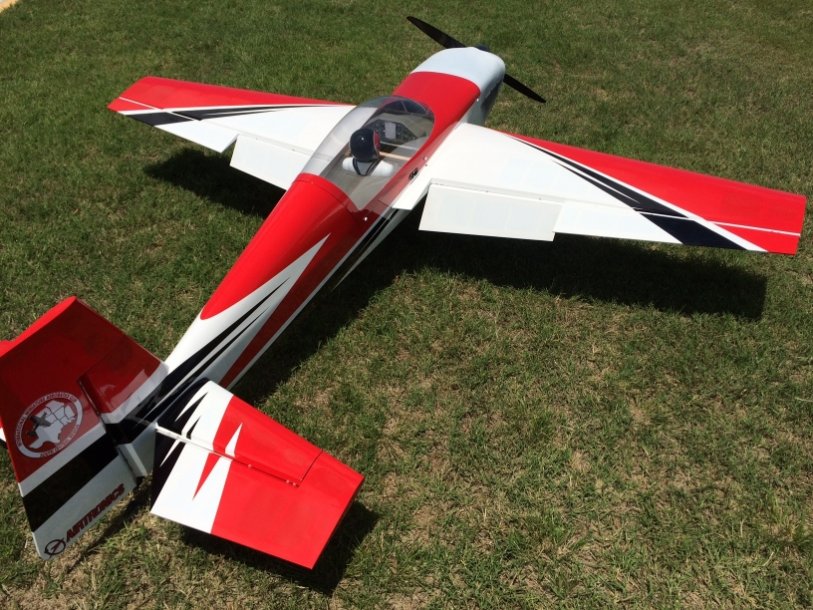

Made a small covering change at the field today........removed the "inboard" red splinters from each wing. Seems to help me when flying my IMAC sequence; the red made the top of the wing a little dark for my taste. Now with the larger white area I'm seeing the plane better when the canopy is towards me, especially when the Extra is down range from me during turn-a-round figures.
