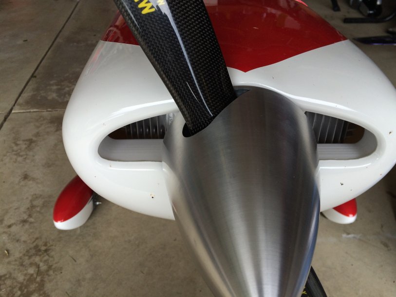

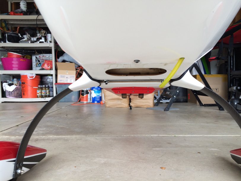

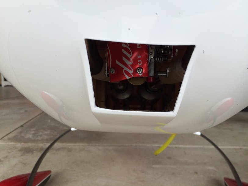

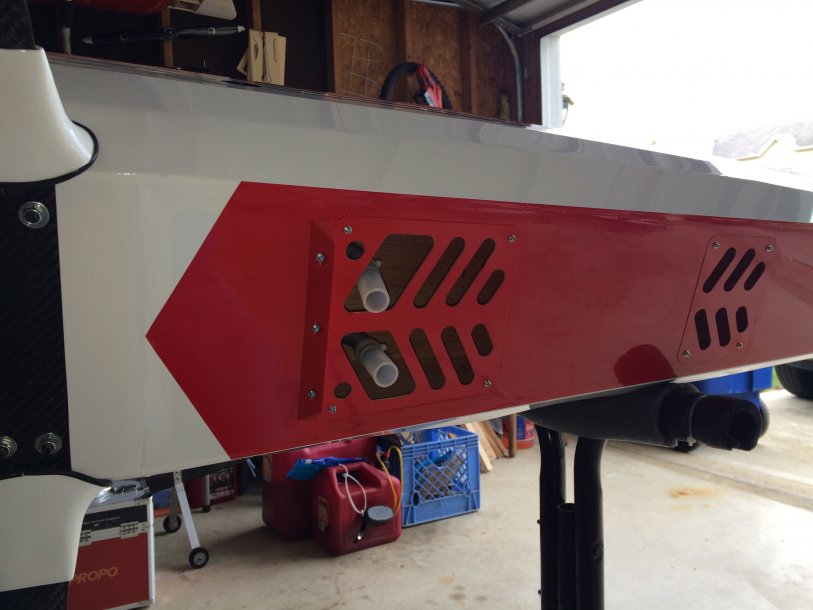

The air intake to exit

For some reason when using cans this engine can get very insensitive with the needles at first then very sensitive ( go figure). I believe this to be because the crank case pressure is lower and less stable in the midrange rpm band when new and causing the fuel path way in the carb to fight one another between high needle outlet and low needle outlet. This is my guess. I kept tuning until it was gone in very small increments and only slightly richened the high needle from 1.5 turns out. Your location can also play a roll as how much fine tune you have to do. It's a PIA but go fly for tuning reasons alone. You will get rid of that surge so don't worry. Once mine broke in the surge came back but it was minimal. The engine low end had richened up (which is normal) . Another tweek on the low needle and VIOLA!. Smooth raw power at me finger tips:).
