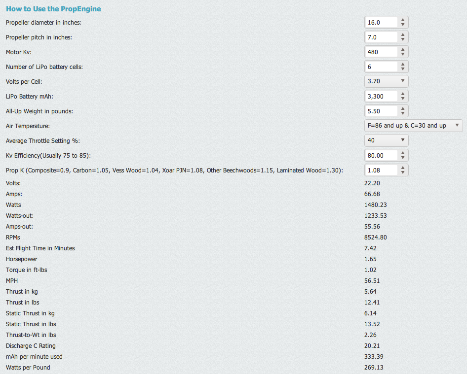

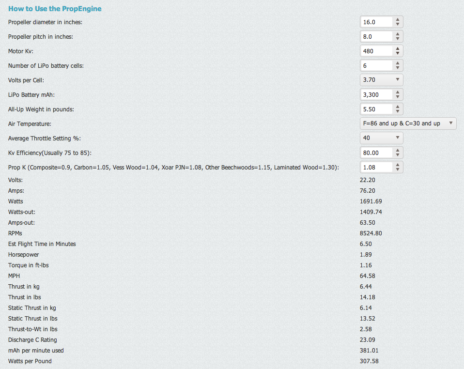

Here is the difference that you will see in power from the 16x7 to 16x8 one your Motrolfly. I am also thinking about trying the 16x8 but the 16x7 does have lots of power and is easier on the motor and ESC so I have never changed. Watts go from 1480 to 1691. Amps go from 66.6 to 76.4. On Kens site the 480 on 6S is 1400w and 65A Max ratings. There are many using the 16x8 however with no problems but do mention staying out of full throttle. I would change if it had more air going over the control surfaces at hover and slow speeds but not for raw power.
