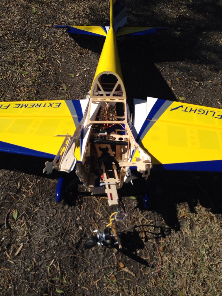

Damn, we've got twins :(
Sorry about your plane Robert
YellowJacketsRC
I have been trying hard to master the rolling loop. It's just about the only 3D maneuver that still escapes me. I had a break through today and then made the mistake of switching to high rates.....
