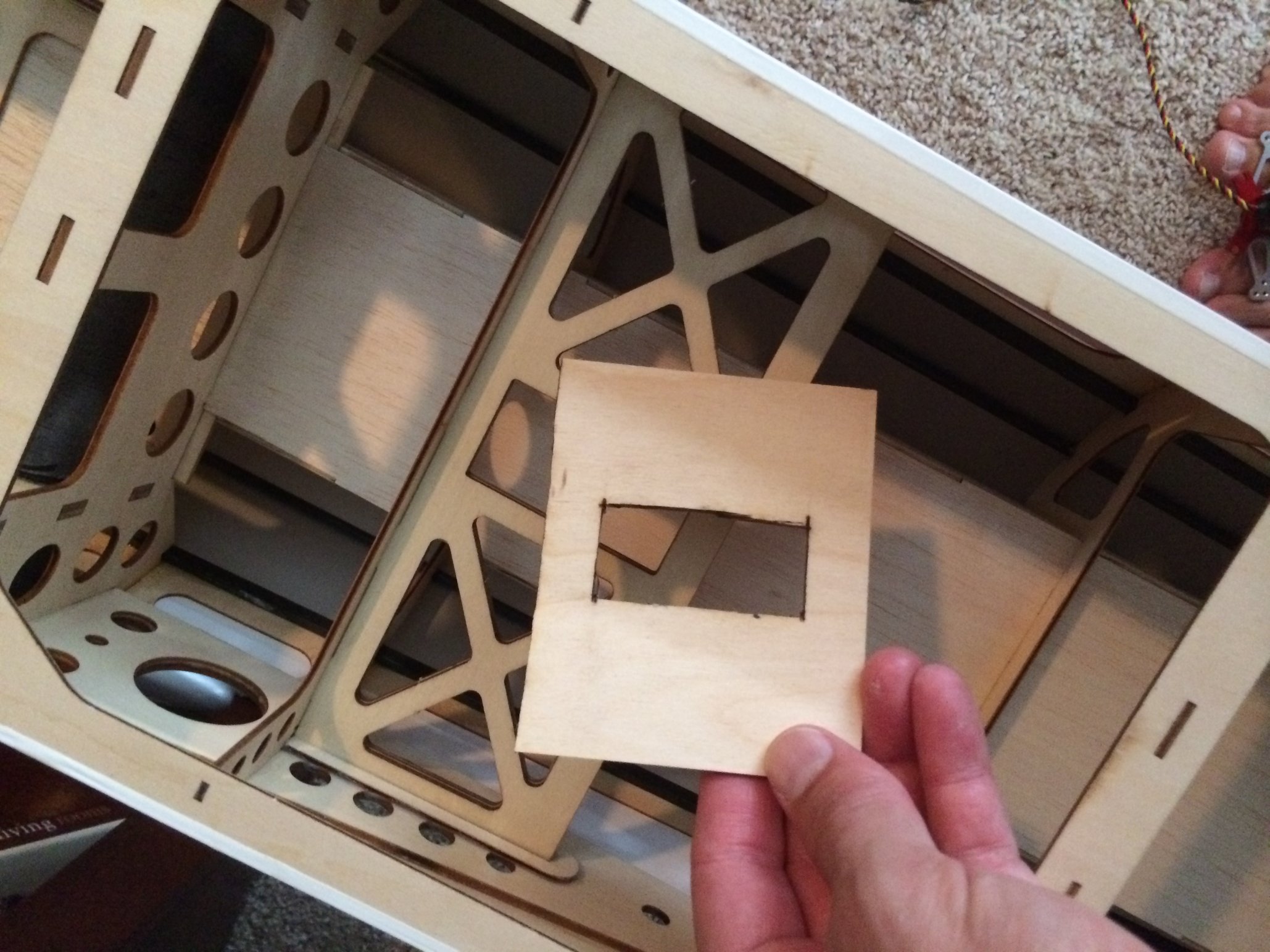

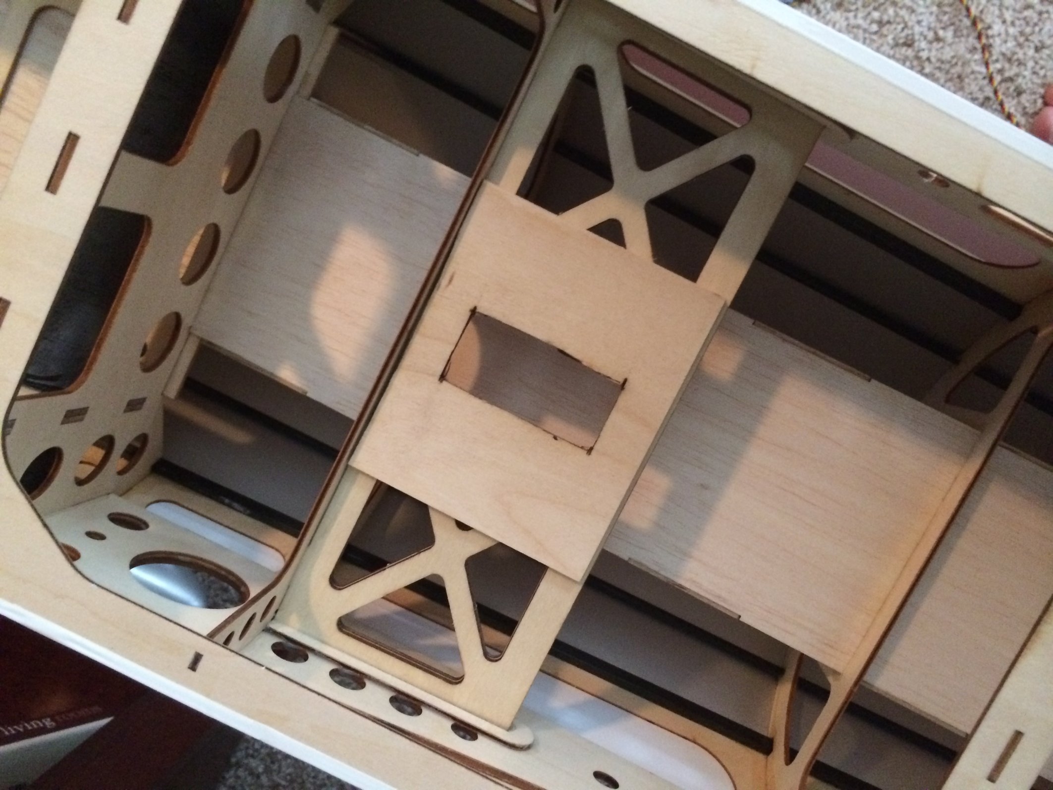

New rudder servo came in the mail. I picked the Hitec HS-7956 mostly because it looks cool. The specs are good but dang, it just looks cool. My daughter picked up on that too :)

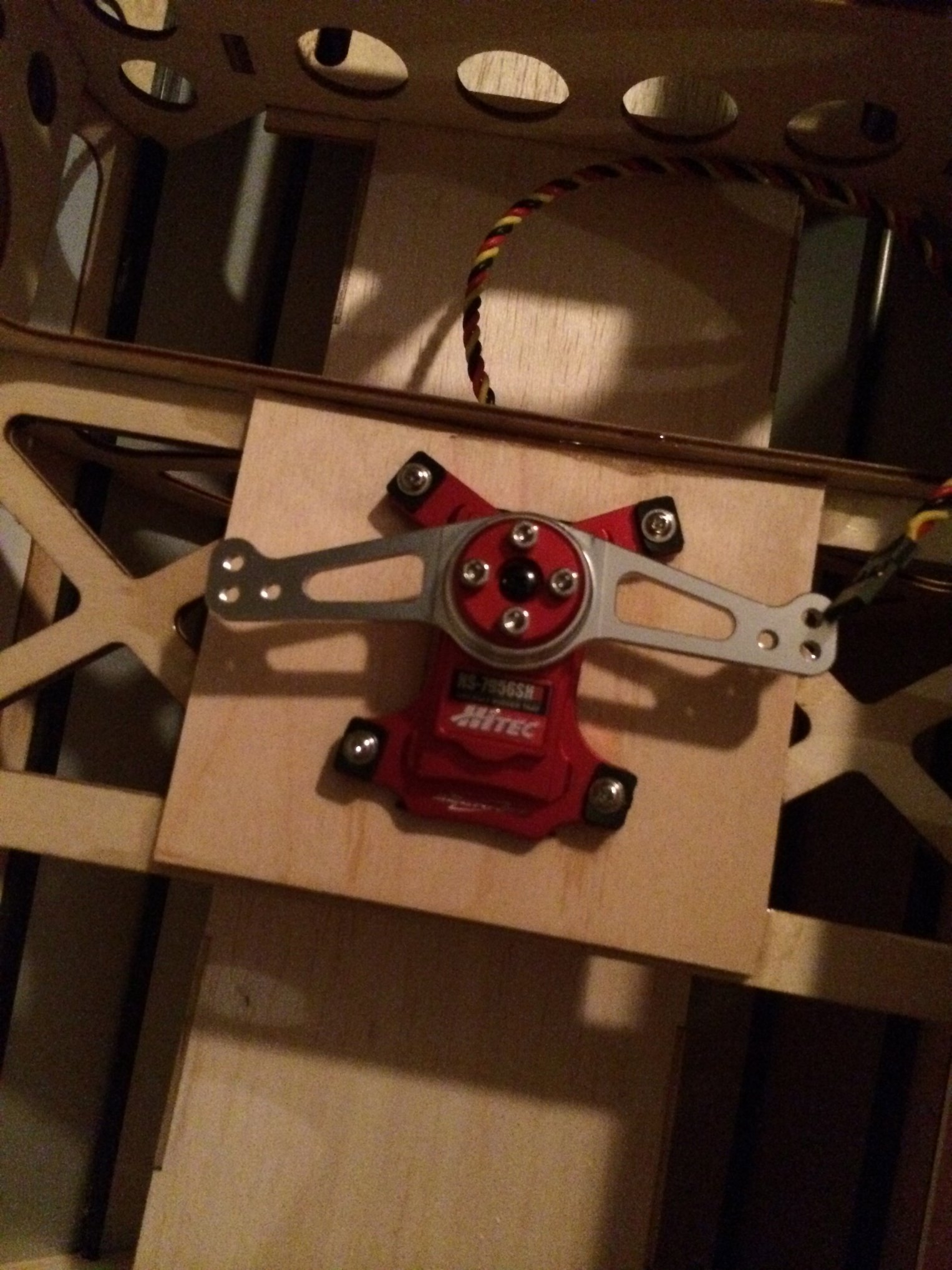

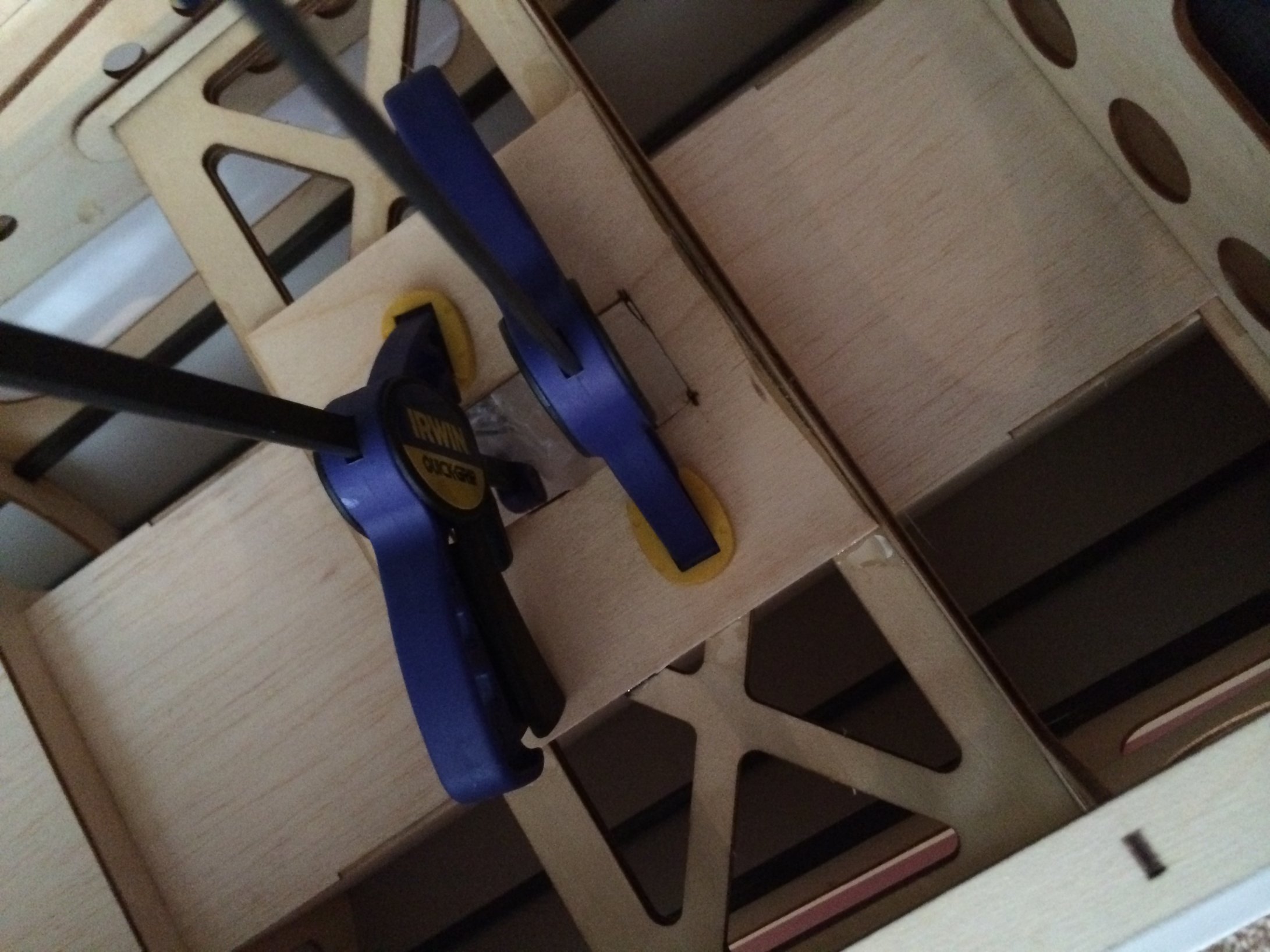

This is the spot in the Yak that they made for the rudder servo:
...and my new piece of ply to epoxy in
And now it's screwed in. Looks great right?

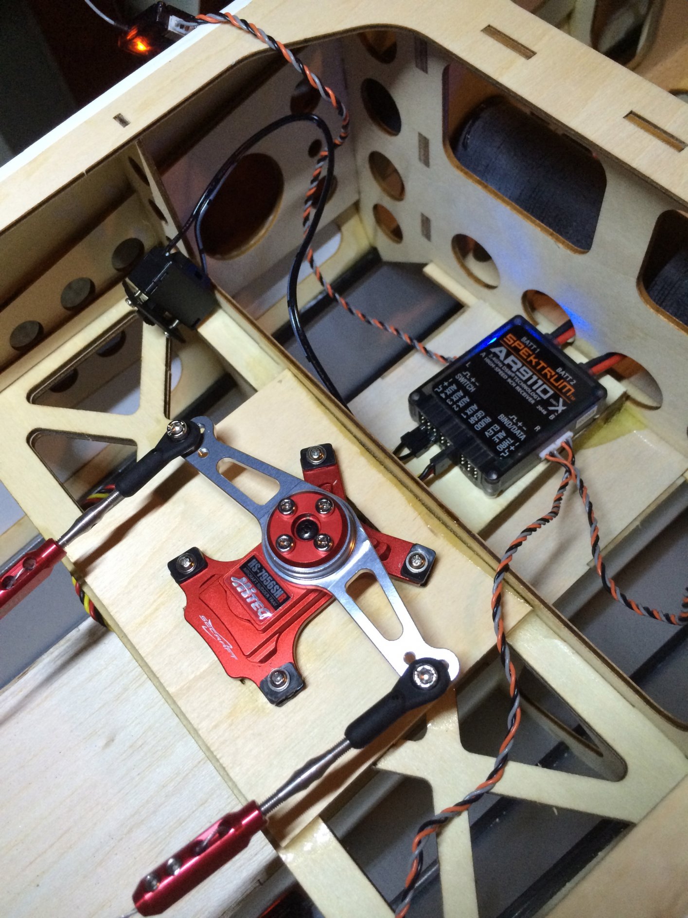

Started hooking up the pull-pull system and couldn't get the turnbuckles threaded into the ends. Spent a long time and ended up using the ends from EF instead. You'd never know [style-wise] and they went right together. Anyway -- pull-pull is complete.

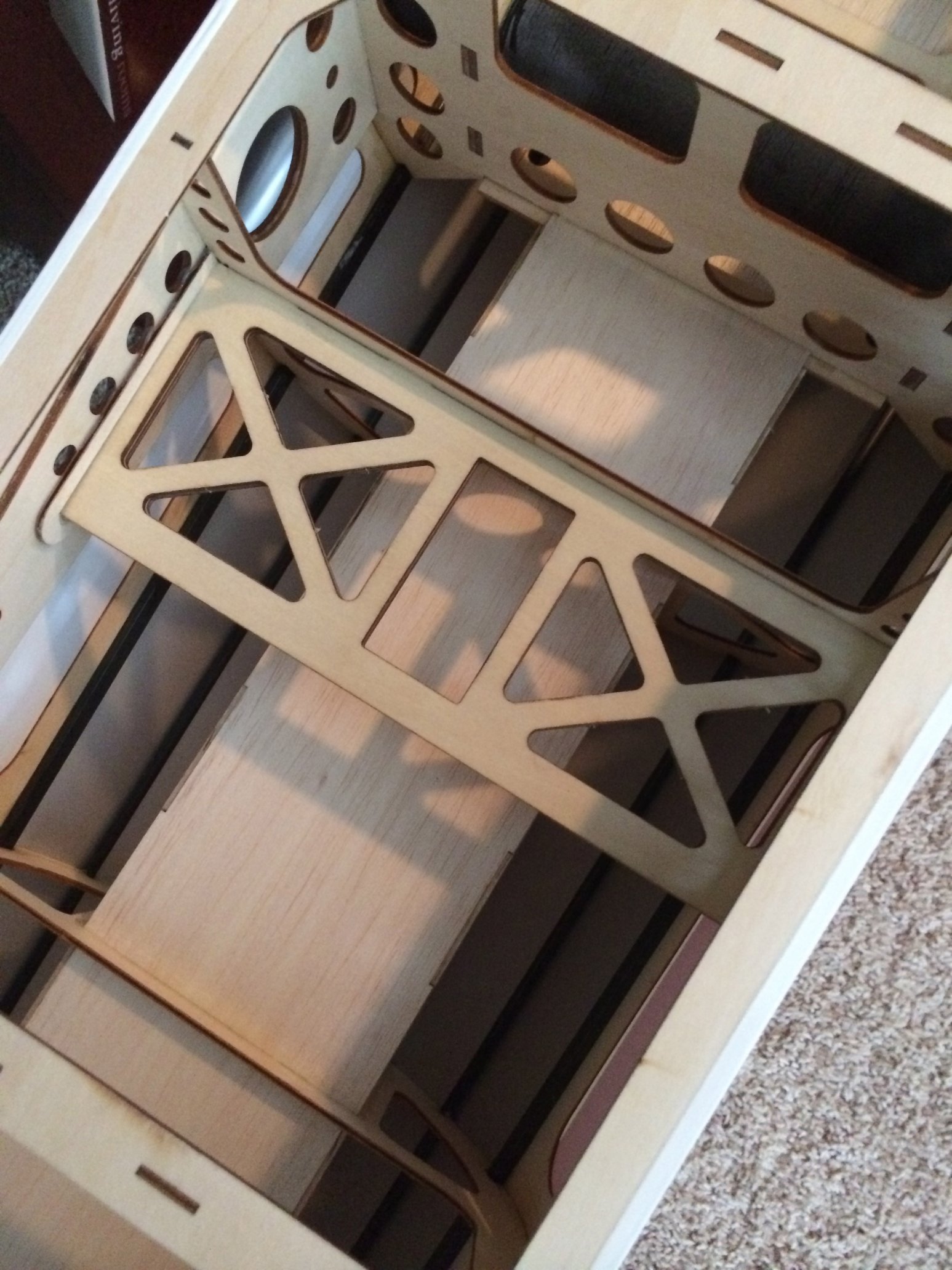

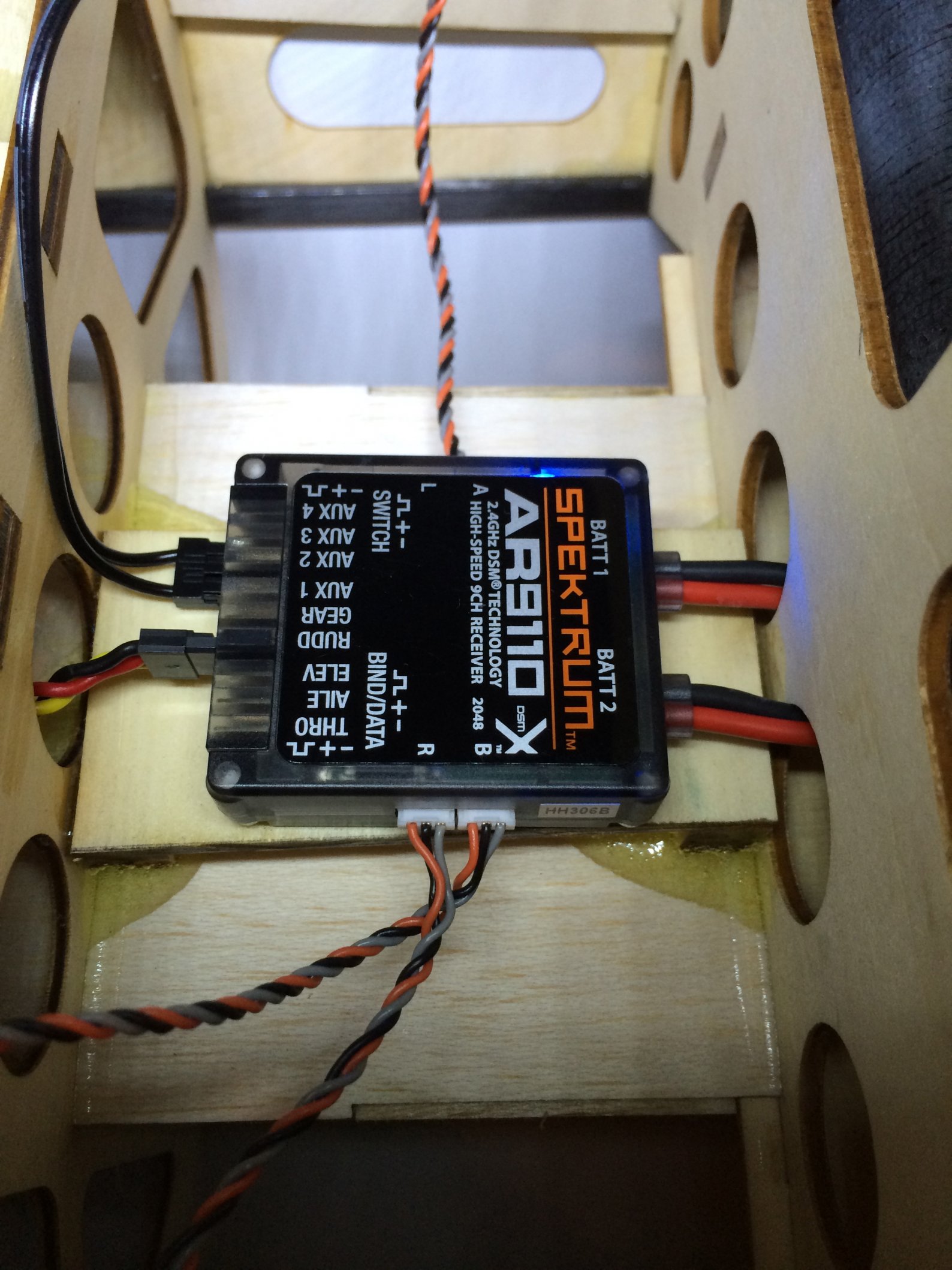

There didn't seem to be a designated spot for the receiver in this plane although there is a lot of space. I built a small platform that fits behind the wing tube bulkhead and in front of the rudder platform. Check it out. I did a test fit of the receiver and it looks good. The two battery wires from the AR9110 will run perfectly forward where the batteries will be on the outside of the tank. There should be good wire length to allow a slide forward and aft for balance.

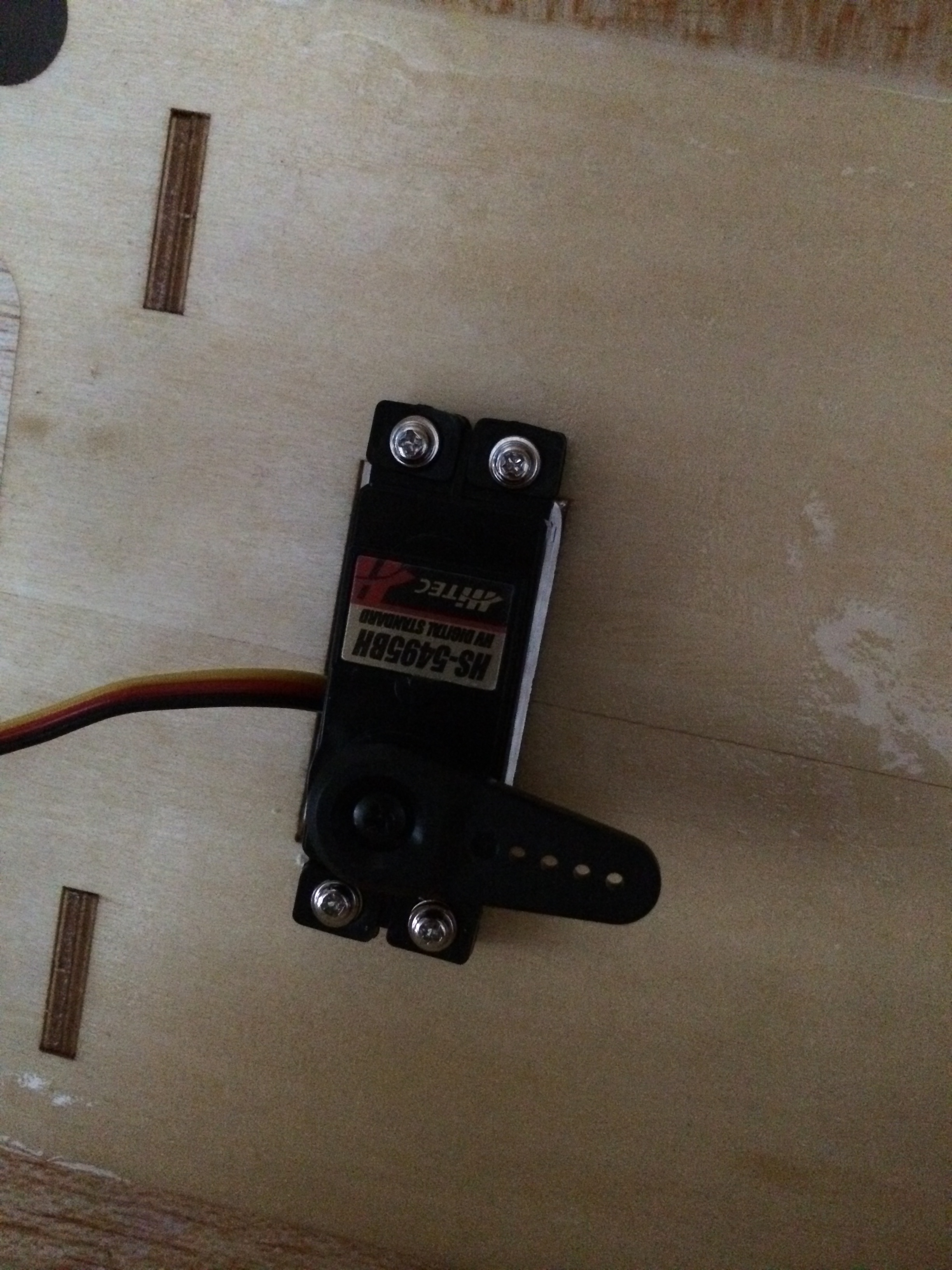

Installed my throttle servo HS-5495BH but no linkage yet until the da-60 shows up.

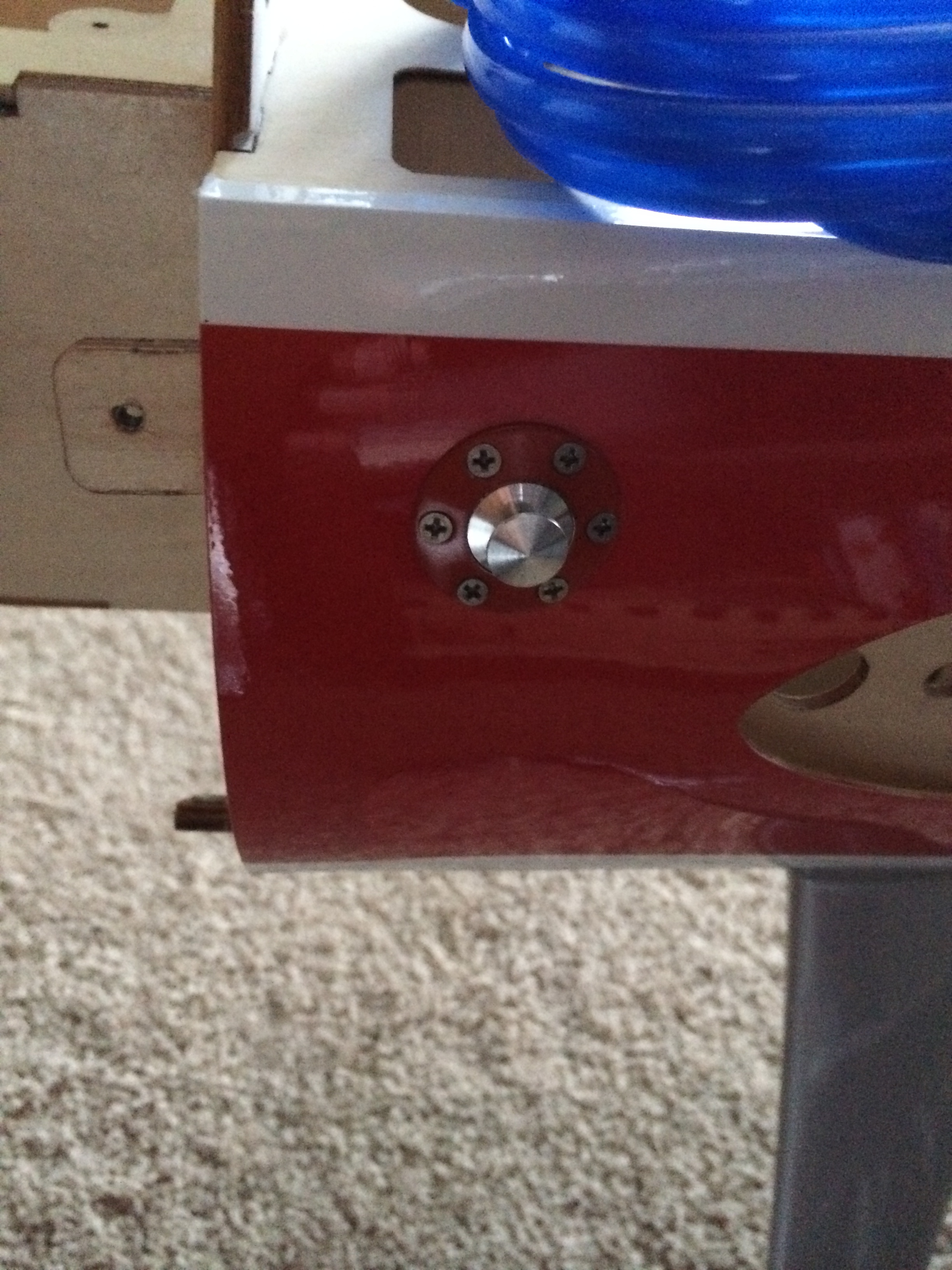

Installed the fuel dot on the left hand side by drilling a single hole. I like the dots from JEM because of the bigger pulling surface. Works well with my hands.

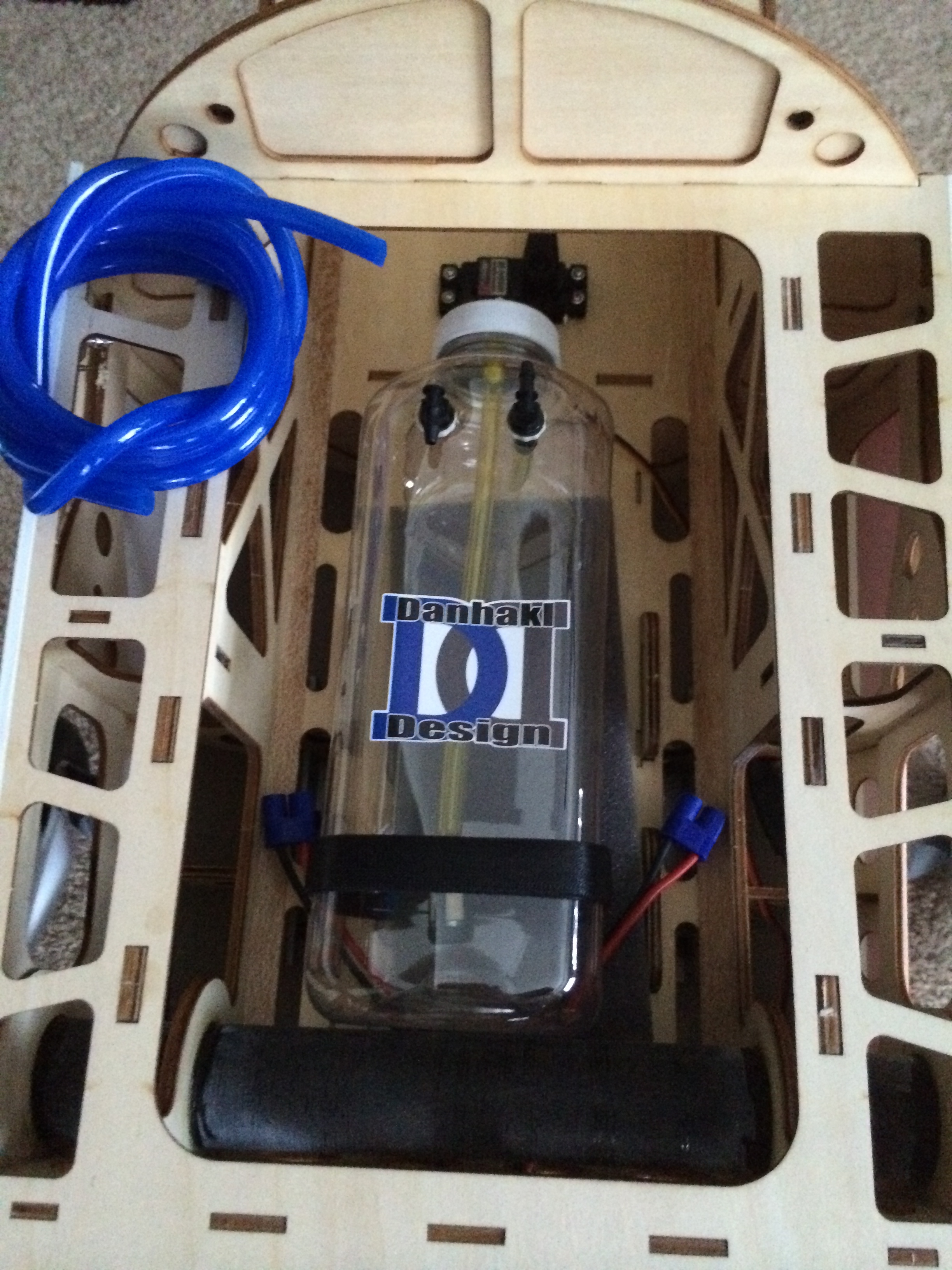

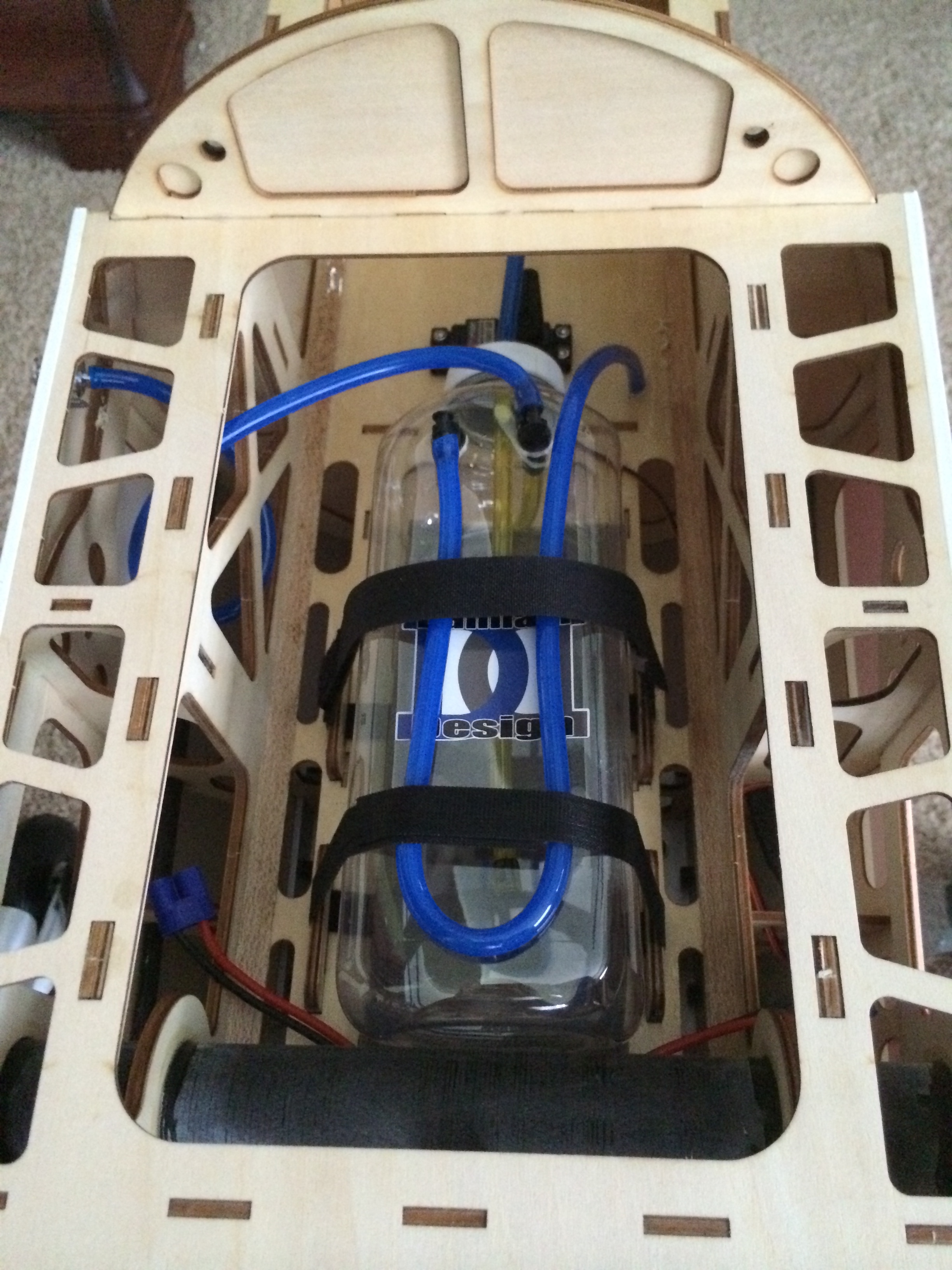

Got my 4titude RTU fuel tank [go] in the mail today and did a quick test fit -- looks great especially with the blue lines. All plumbed in - at least to the fuel dot and the vent line.
Receiver batteries from FromeCo will be showing up in a few days as well as the Savox servos for the ailerons and elevator. Batteries should sit perfectly on both sides of the tank to complete the pic.Will need to get the wing hinged and ready.

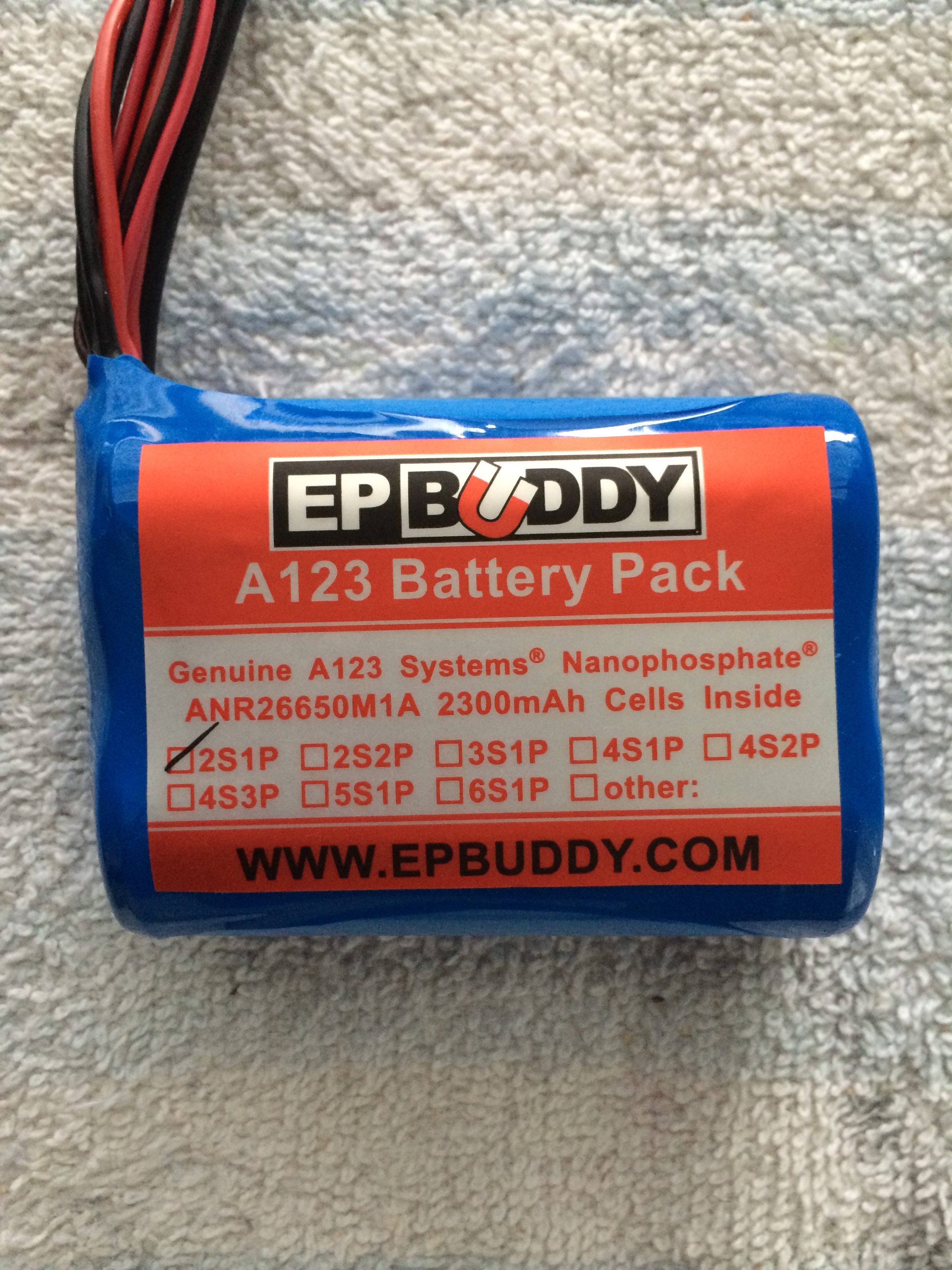

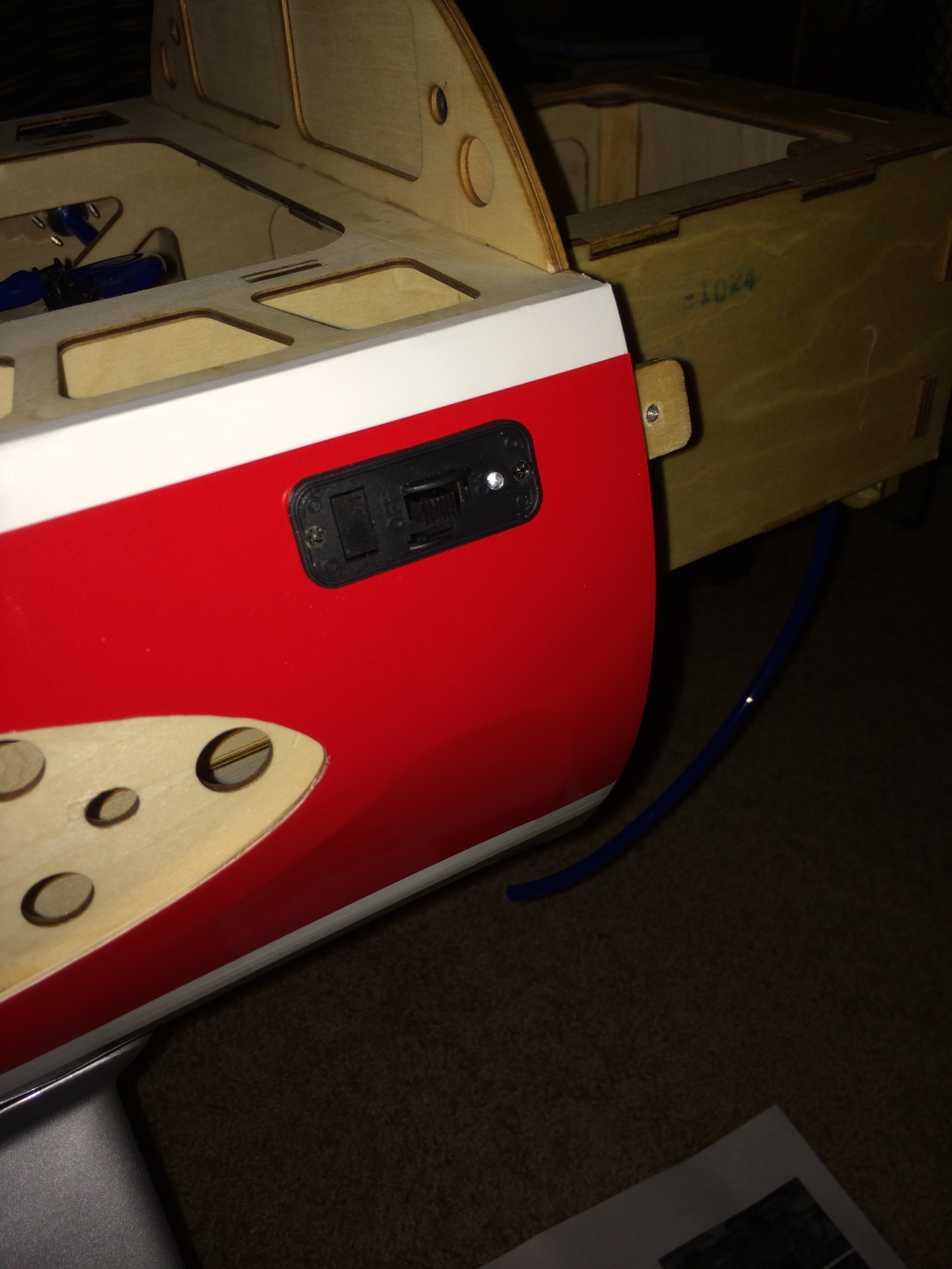

In the meantime I got some busy work done including mounting the ignition switch / charge jack. Going with an A123 battery up front.

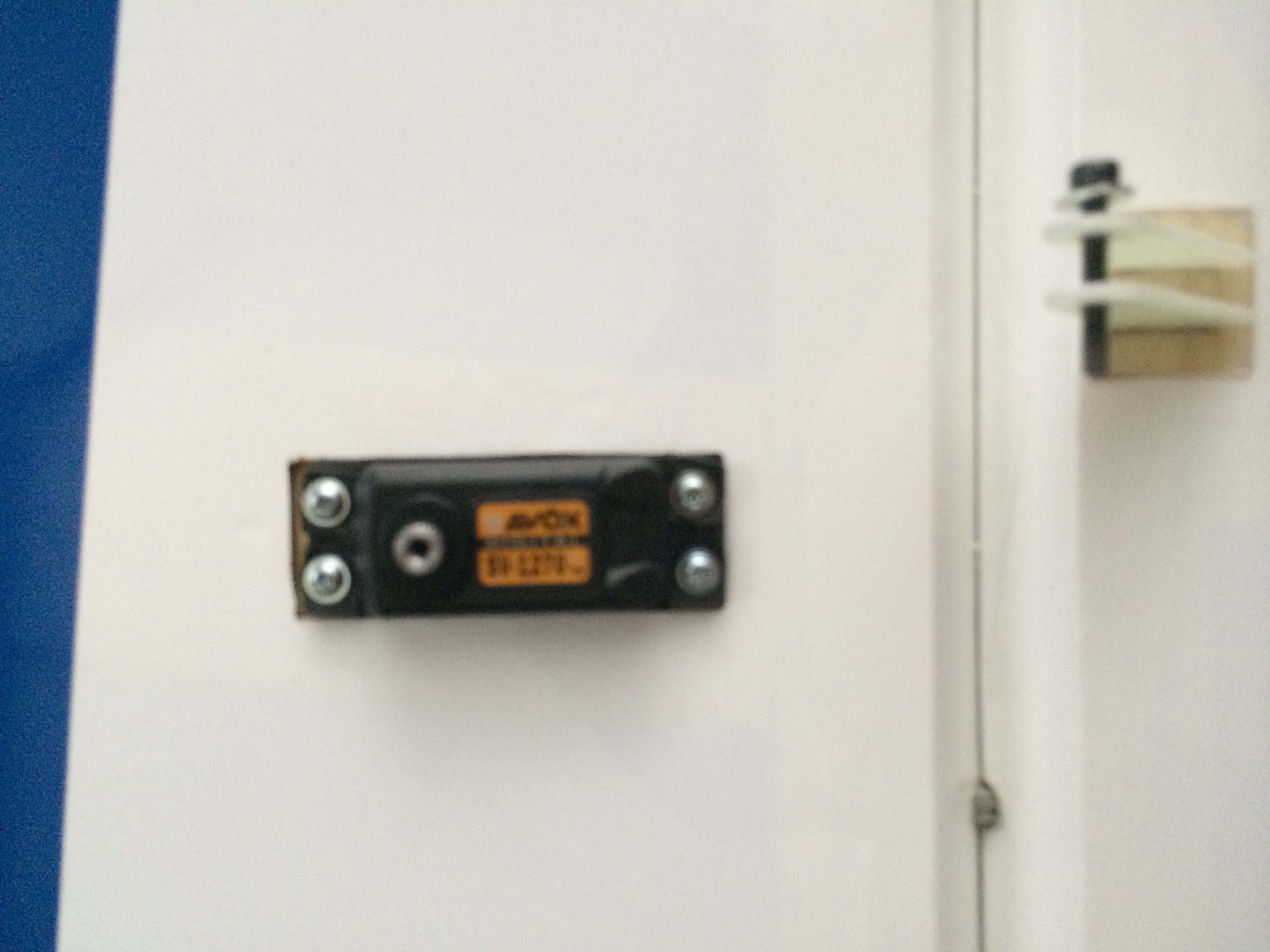

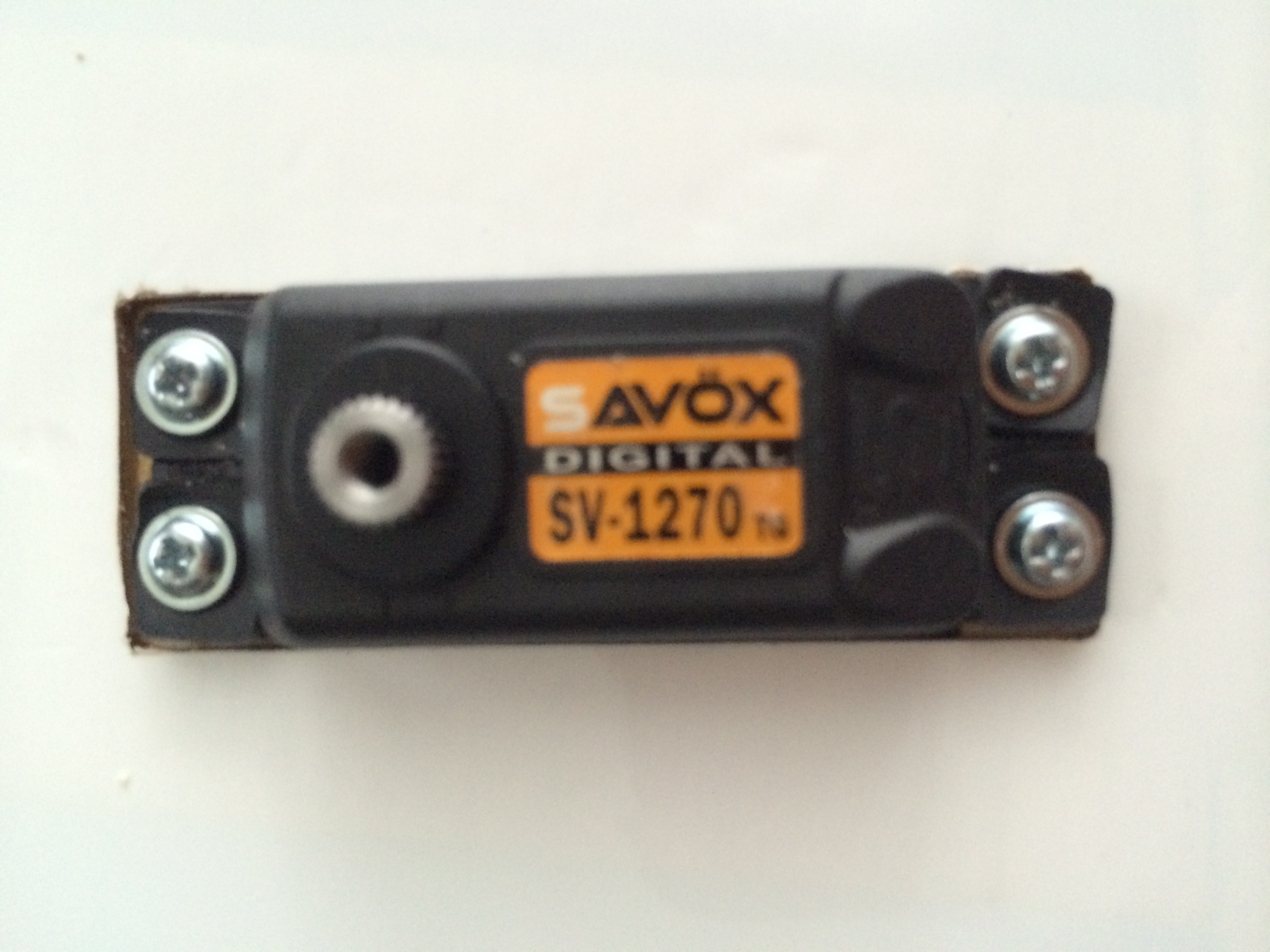

...and installing the servos in the wings. A few days ago I hinged the wings and sealed the gaps. If you're wondering why there is no linkage, I had ordered MPI arms a while back for hitec servos and ended up using the Savox instead. Had to re-order the arms :( The Savox servos fit in the wing with ZERO slop. Perfect fit.

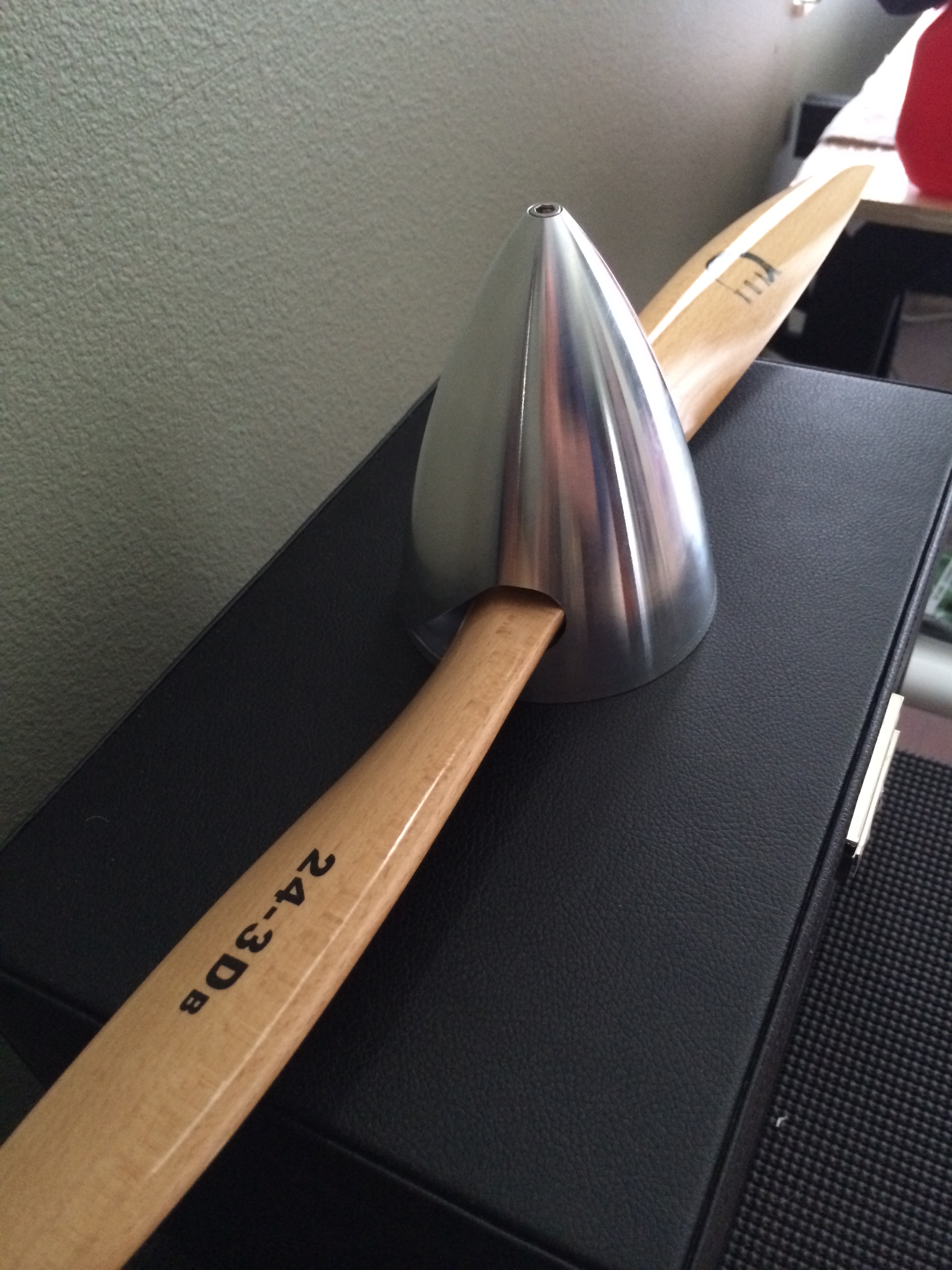

...and btw, my spinner showed up from Tru-turn. Wendy helped me thru the process to make sure I got the right parts. GREAT customer service.
