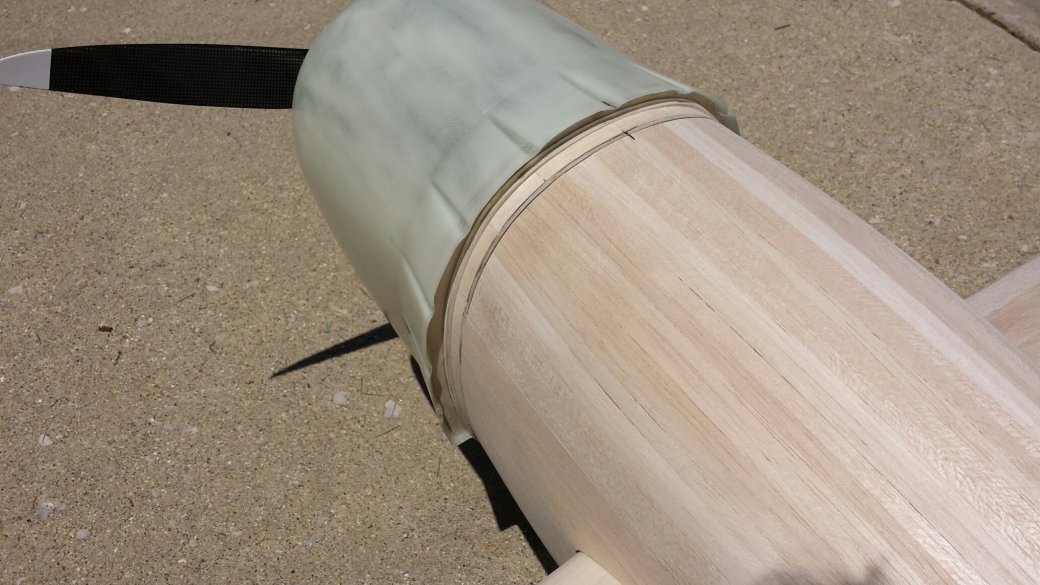

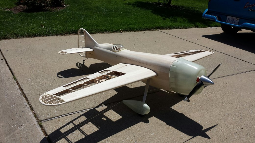

No pictures, but I got my elevator all hinged up, control horn installed and gap sealed in prep for the monster Savox servos that should show up in a few days.
Installed my throttle servo HS-5495BH but no linkage yet until the da-60 shows up.
Installed the fuel dot on the left hand side by drilling a single hole. I like the dots from JEM because of the bigger pulling surface. Works well with my hands.
Got my 4titude RTU fuel tank [go] in the mail today and did a quick test fit -- looks great especially with the blue lines. All plumbed in - at least to the fuel dot and the vent line.
Receiver batteries from FromeCo will be showing up in a few days as well as the Savox servos for the ailerons and elevator. Batteries should sit perfectly on both sides of the tank to complete the pic.Will need to get the wing hinged and ready.
That's all for now. Did get to fly my MXS today -- 5 flights with no one else at the field![]()
Peace.

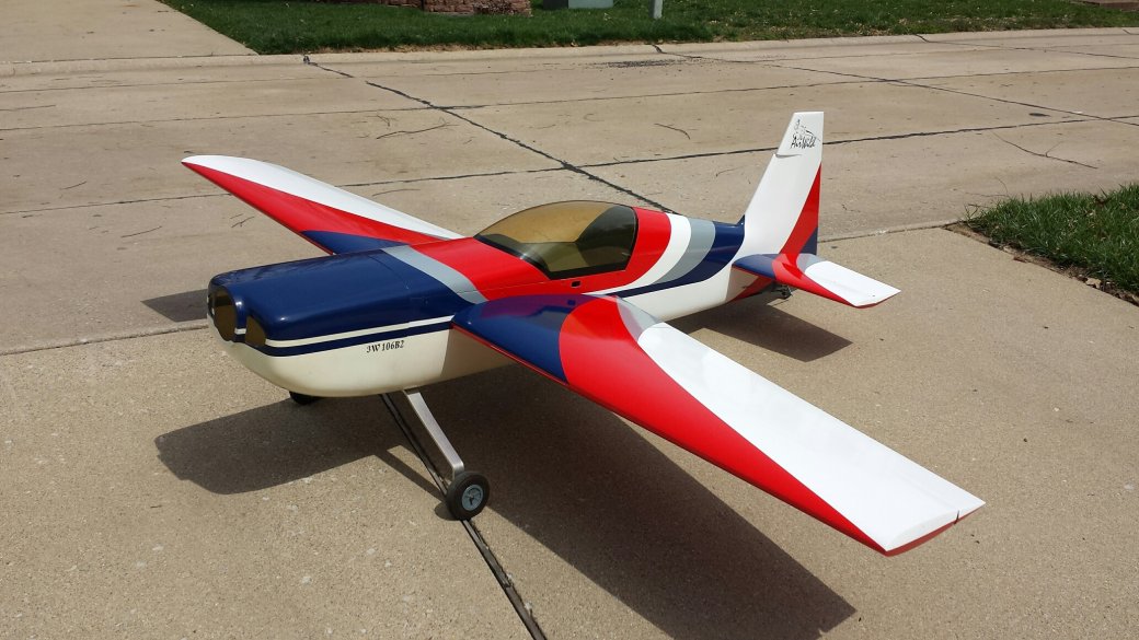

I suggest not using a Hitec 5495BH. I had them in my 3DHS 87" Extra 300 for my throttle servo and 2 of them burned up in their first flight. I think it is because they are not metal gear. As I said in the beginning just a suggestion from my personal experience.
