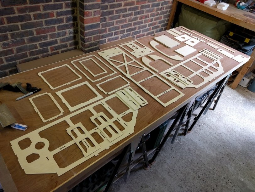

  1. My Carden 124" Extra 300 Pro kit arrived yesterday. I've got a reasonable amount of building experience, but this will be my first time building a giant scale model. I'm not in a rush as I have a good IMAC frame already so I'll be taking my time in the hope of getting things right. Thanks already go to @orthobird for answering a few questions for me while the kit was being manufactured, but as I go along I would be very grateful for any advice from anyone with experience.
    The plan is to fit a DA170 on KS1090 pipes and vacuum bag the wings. Beyond that my only real objective is to learn from the build and keep the final dry weight well below 20Kg (44lb). Oh, and hopefully have an airframe that flies straight at the end!
    Watch this space...

  5. Big jigsaw puzzle (CNC quality is fantastic!)...

    I am in too! This is awesome! Don't you just love the quality of the wood (balsa and ply)?
    It is top quality. I decided to go with the DA 150L and the KS 1090 tuned pipes. Hopefully mine will be in 39 pound range.
