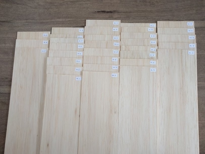

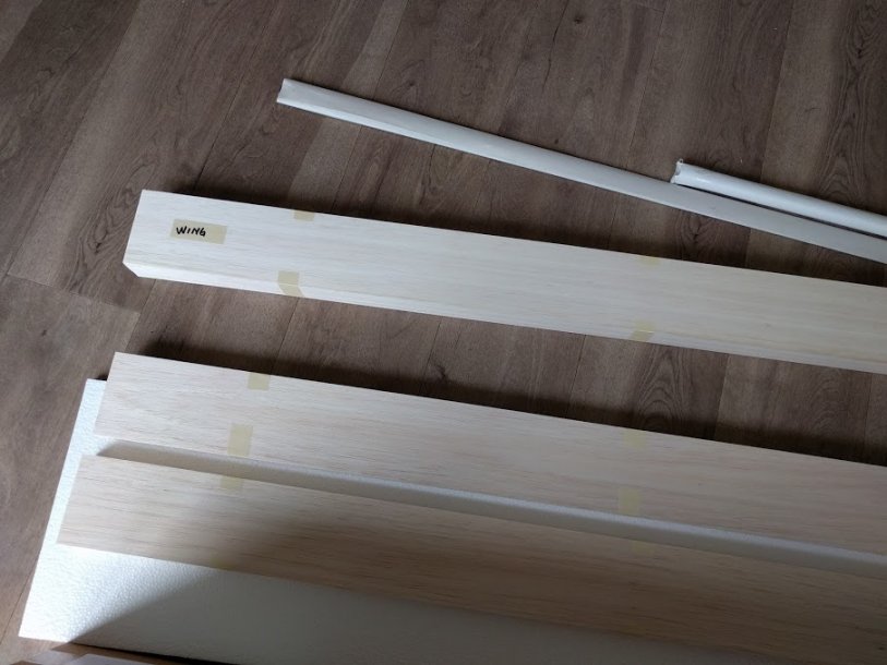

  1. I had originally planned to start with the motor box, but now decided to start with the stabs then wings followed by fuselage. Began by weighing all the sheeting supplied with the kit and grouping it for the various foam parts. Just waiting for the postman to bring a bottle of Titebond II and I'll get started on making the stab skins. Dennis at Carden pre-groups the wing sheeting (which requires hard density) which saved me a fair bit of work.

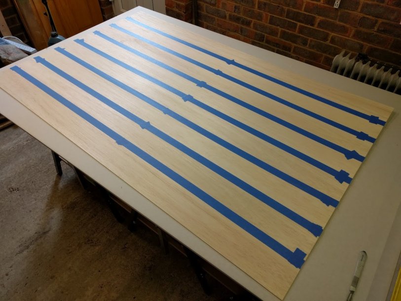

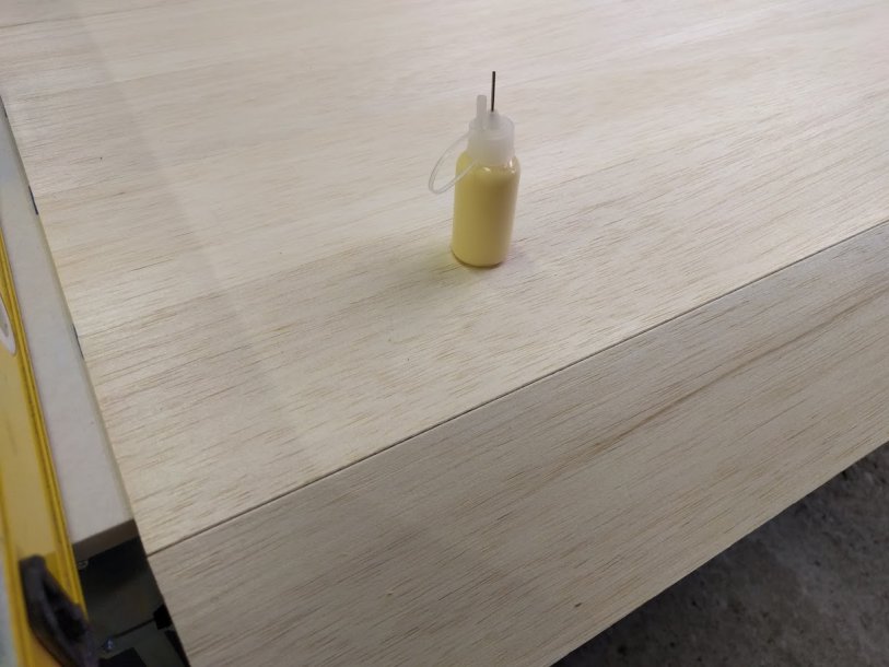

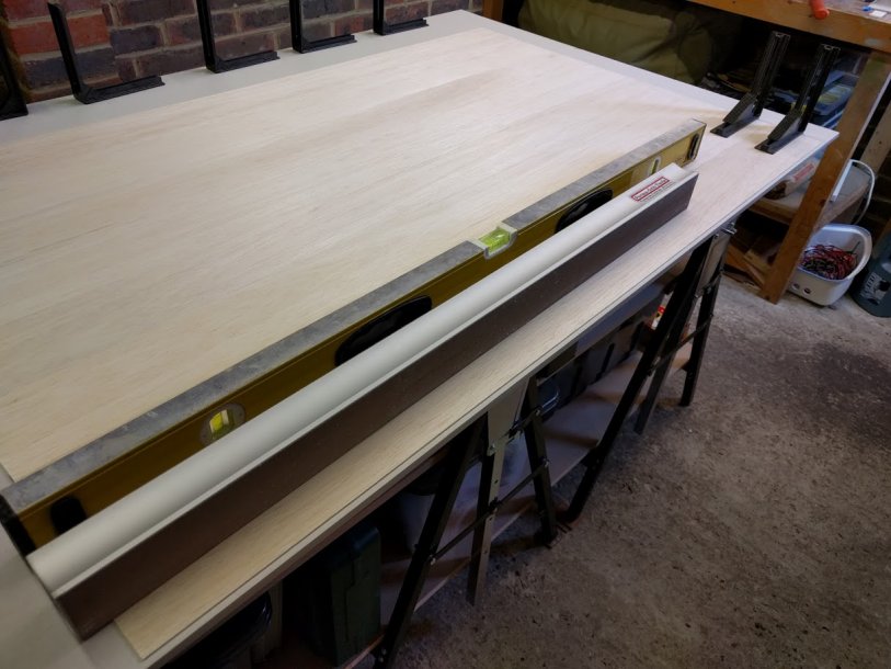

  5. Titebond II arrived, so I taped up the skin for the horizontal stabs. Using a small injector bottle I glued a single edge just to get a feel for what was involved - so, thin bead of glue, closed the joint, wiped the glue away with a putty knife and then sanded over the joint to try and get balsa dust to fill the smaller cracks. Finally, weighted it down and it's drying.
    So, this is all good, but there are another 50+ edges to glue - so what's the secret to doing an entire skin in one go? Currently I've just got visions of glue going everywhere and ending up with a buckled skin!!
  6. I go to Tractor Supply or another small farm/ranch supply place and buy needles with syringes. You can also get syringes from pharmacies but I don't know what gauge of needles they carry since humans typically need smaller sizes.
    scruffmeister likes this.
  7. Alky6
    Alky6 150cc
    If you are vacuum bagging you don't need to edge glue. The vacuum will pull some epoxy into the joint. Just trim your edges so the fit right and tape them together to hold them in place. Super easy! I would have died if I had to edge glue every piece on my jtec.
  8. I am vacuum bagging, but was planning to edge glue too. @Terryscustom what're your thoughts on this as in your video (which is essentially my "manual"!) shows tape on the sheeting but I can't tell if is edge glued at 09:53?

  9. BalsaDust
    BalsaDust Moderator
    I do not believe terry edge glues his. If I remember correctly going the vacuum bag route it basically sucks the glue into the joints.
