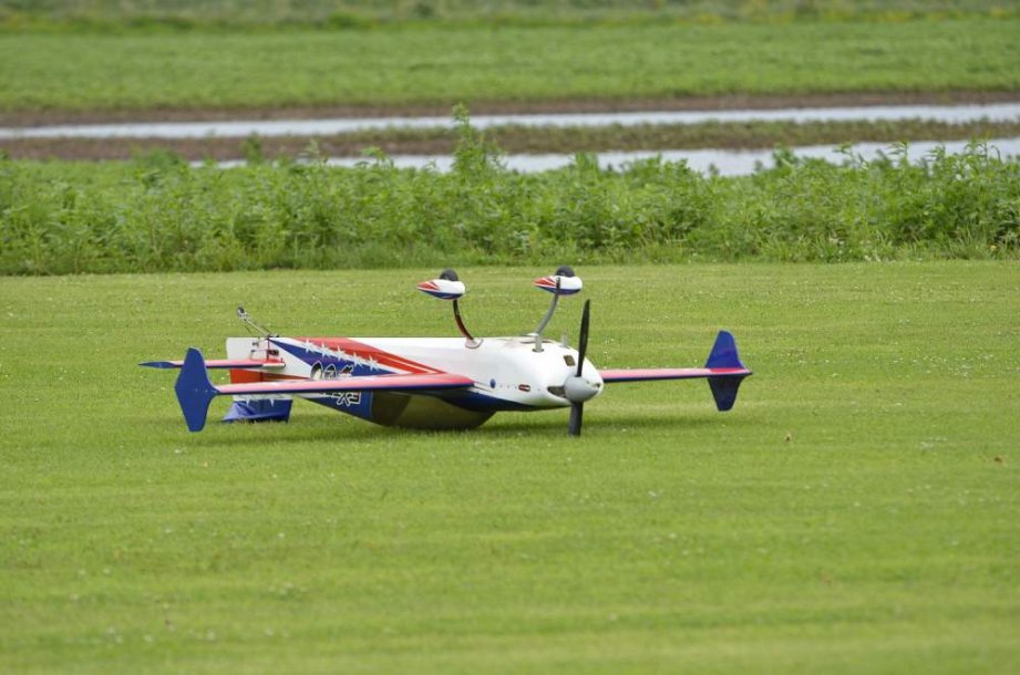

I know the wind pushed me over and cartwheeled my Extra and even after landing like this there still isn't any signs of a problem. This plane made it to 4 huckfests and 5 other weekend long events in the sun in 2014 and the tint held up better than the rest of the canopy in the sun.

Looks like the rudder took a hit on the counter balance. Not the way we want to see a top of the line ARF sitting on the deck.
