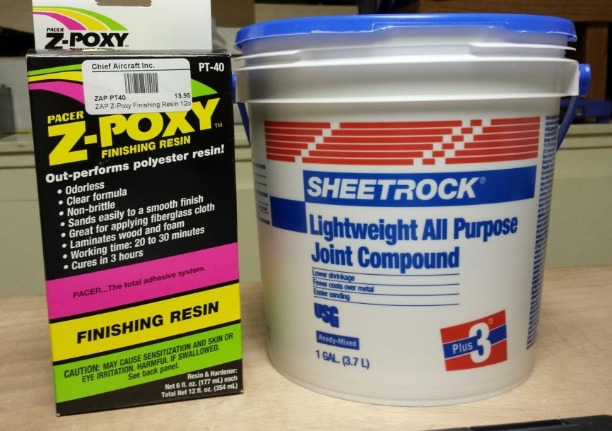

well, you guys caught me at the right time, I am ready to final sand and fill. I have no problems trying the joint compound. Are you using just regular premixed USG or a powder 20 minute?
Jetpainter
I used premixed lightweight joint compound.
Terryscustom
Yup, I did not use the lightweight just because I had regular on hand from some mold making, but the P-mix is awesome and you will sand off 99% of it anyway. I'll be back to work on my hatch later this week, so I'll post more pics when I get caught up on "work" work.
