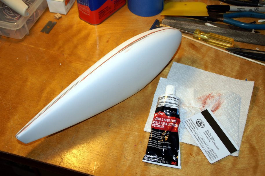

So far on my Krill I've been using the Bondo Glazing & Spot Putty (Red Stuff) for filling in the "low" side after sanding the seams. Really no large depressions and most gets wet sanded away before primer. Am I OK using this stuff or do y'all recommend a better product? This shows the little bit left before priming. It seems to work well and sands easily.

That kinda stuff I think you'd be fine going over an entire hatch or an entire plane to fill weave would be a no-no. You don't want to fill anything that requires any build-up with this material though.

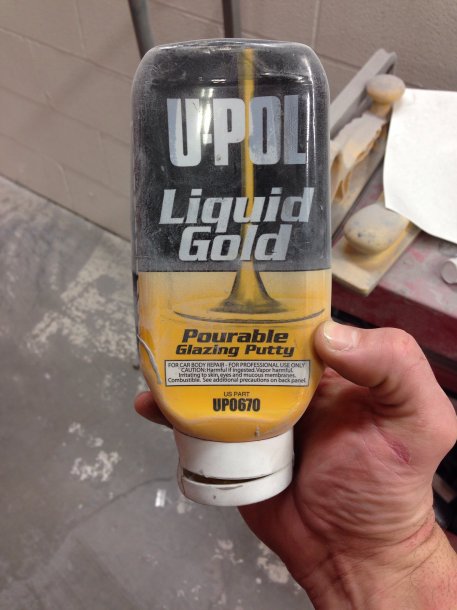

What I typically use if I need a thin buildup is Glazing body filler. Thinner than bondo, sands nice and sets up quickly. I've used it to fill weave on canopies before and it was a lot of elbow grease to sand that large of an area while keeping it flat and it does add weight.
