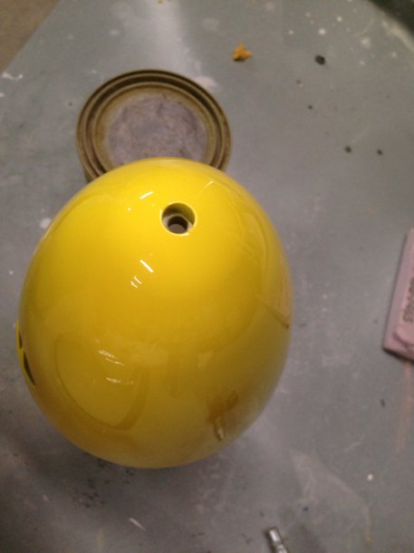

Agreed with Nason clear ,, easy to shoot no thinning drys quickly to touch ! Also shot chroma premier single stage similar to Imron on the bearcat last week for a base color came out like glass with no clear ..yellow spinner is base clear coat Nason product with Nason clear ! Good luck
