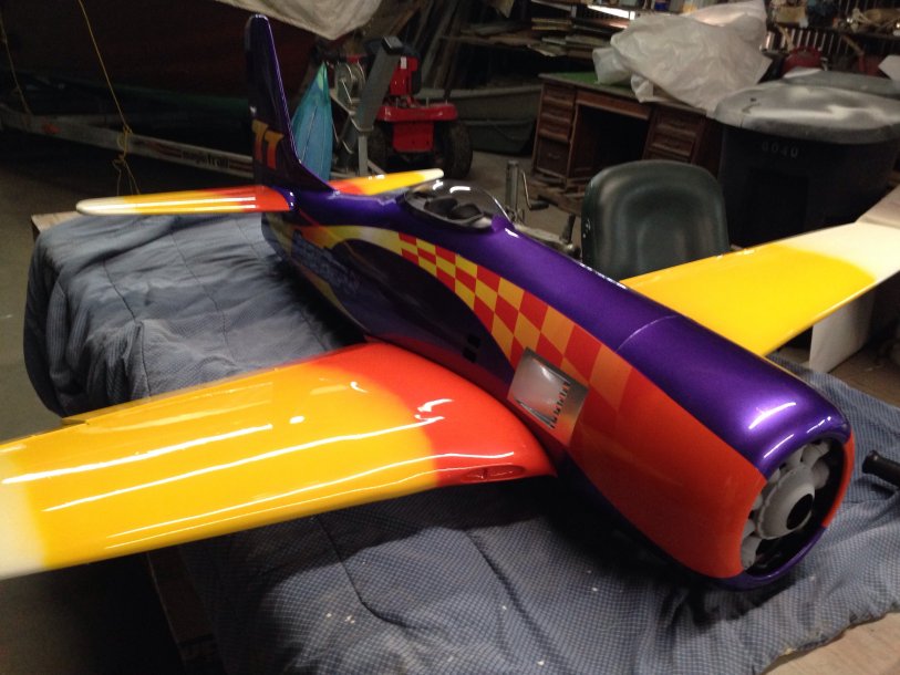

    Thought I'd share my last paint job with my rc buddy's ! American Eagle 1/5 Bearcat done up in Rare Bear colors .. These planes r few and far apart ! 50 -100 cc size . Paint is DuPont base clear / Croma systems. Callie Graphics Thanks again ... image.jpg image.jpg image.jpg image.jpg image.jpg image.jpg image.jpg image.jpg image.jpg

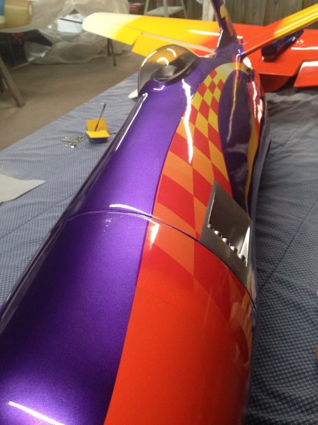

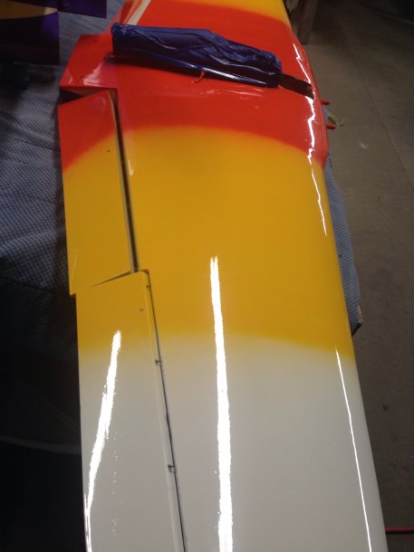

    Question.....When doing different colors on base coats (with a hard line), do you do any sanding to smooth the paint edge before clear coating?

    Never sand the base, if they show you can wet sand the clear. Base has almost no thickness to it. Most of the time two coats of clear makes them go away unless you sprayed your base thick and get build up against the tape.

    I kinda thought so, but needed to hear from the experts! Thanks Terry :cheers:

    +1 And I'll add one more thing. If you sand base before you clear it will turn very dark where you sand it, and if it's a metallic color it really turns to crap.
