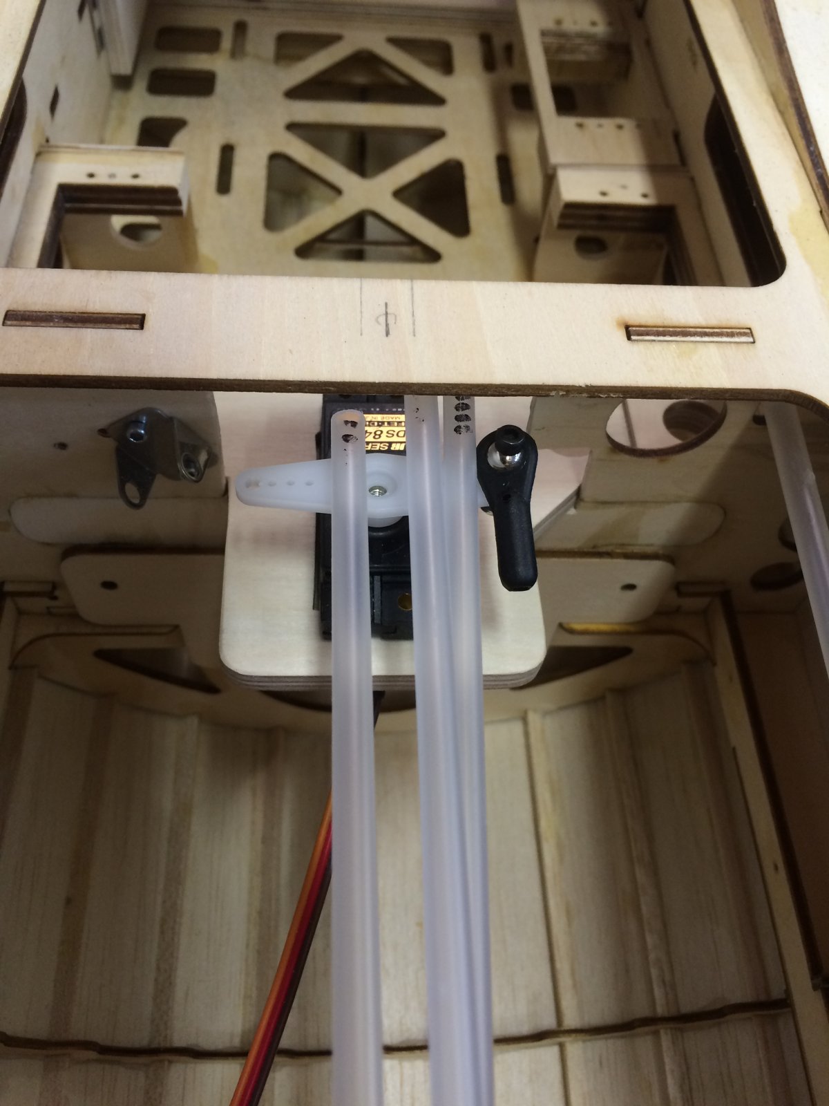

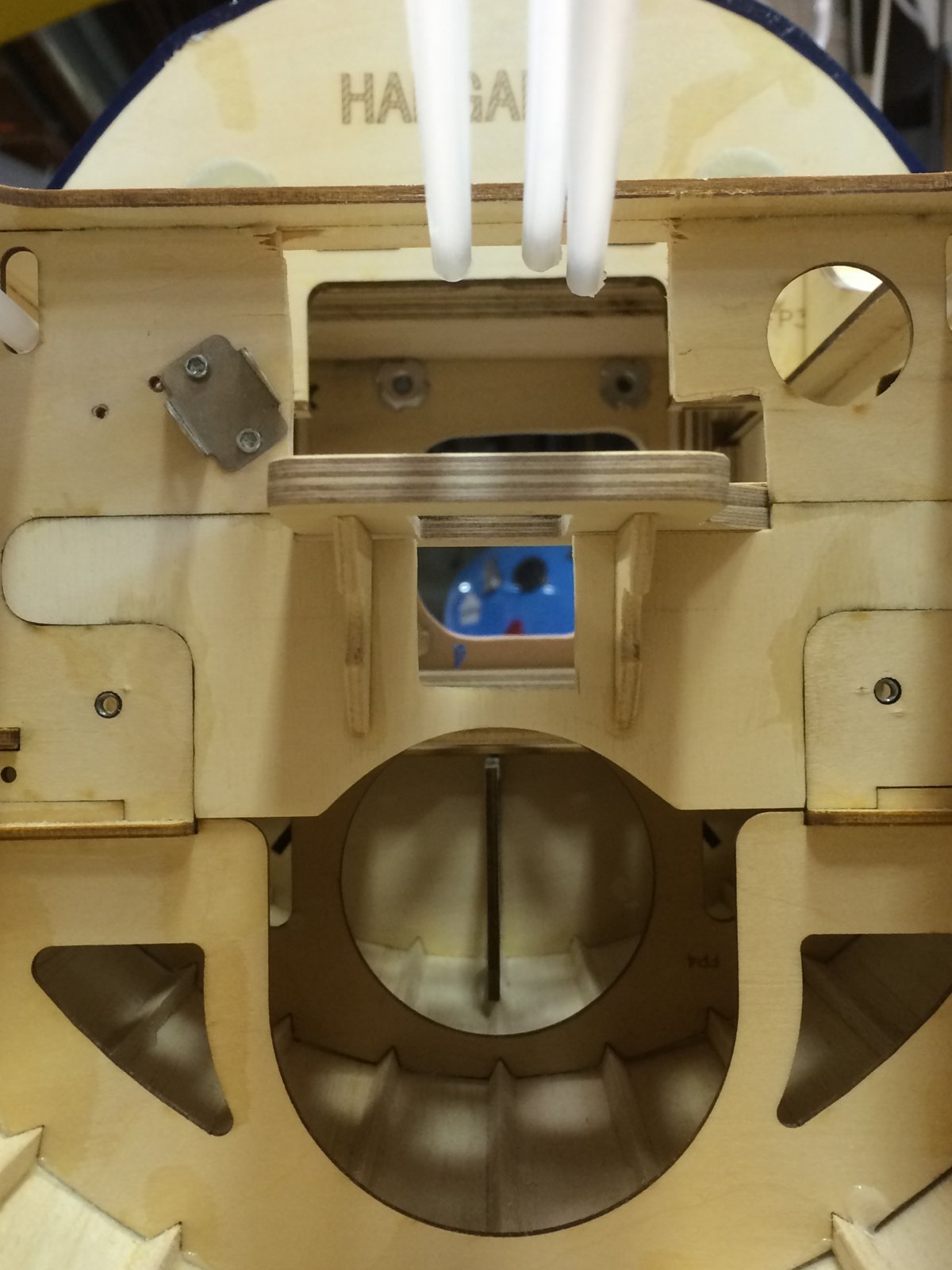

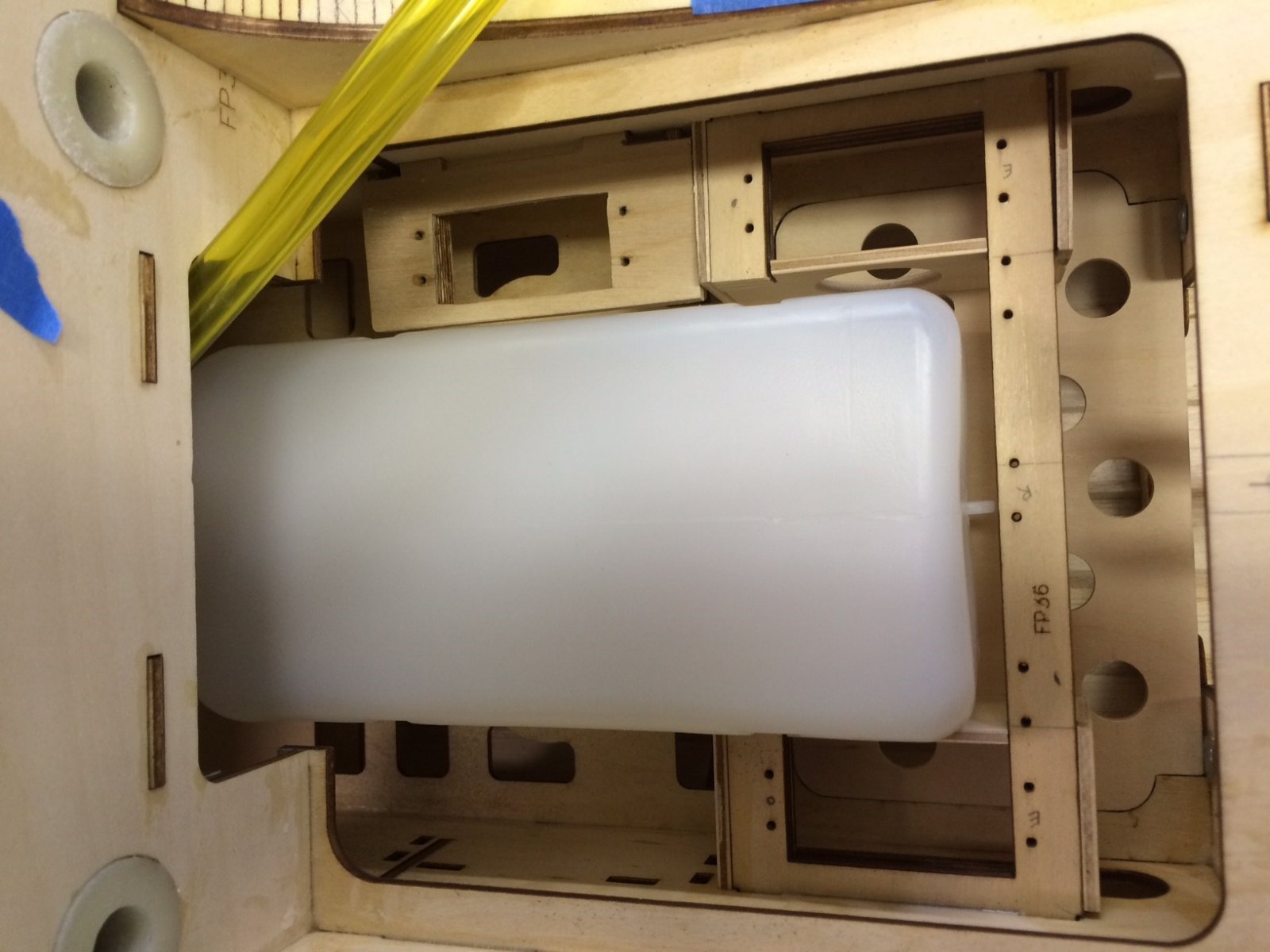

Tom what did you use for a fuel tank in your setup?

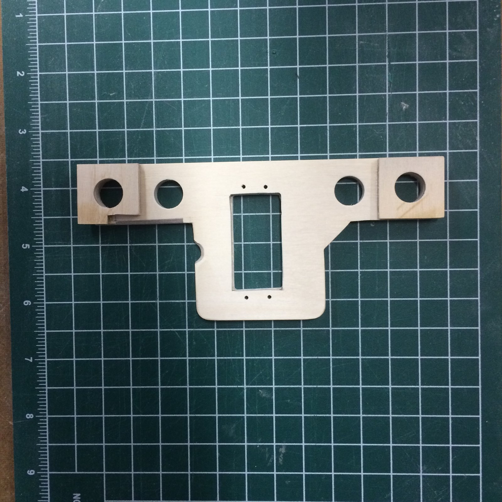

I installed the tank that came with the kit. The rudder servo was relocated to make room for the fuel tank.

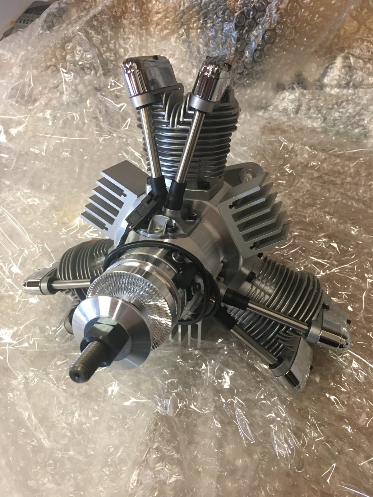

Finally, so shiny!!! Can't wait to hear it run!

WOW @camss69,
Those Saito radials are incredible. I just got my 60R3 for a T/F P47 ARF. I know EXACTLY how you feel. I'm dying to hear it run. Your Corsair should be AWESOME with the 90 in it. I cannot wait to see it finished. . . . :big_yes:

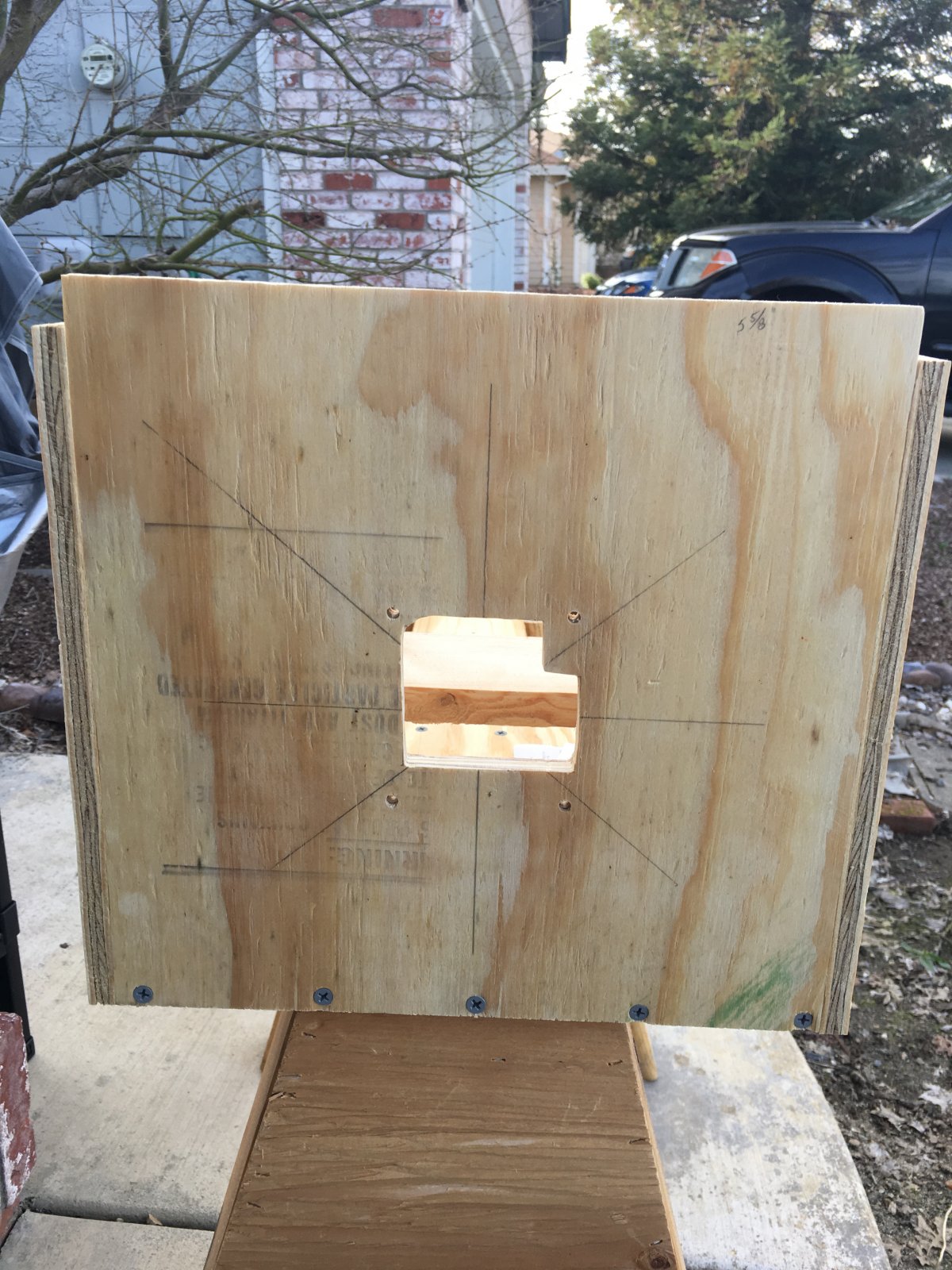

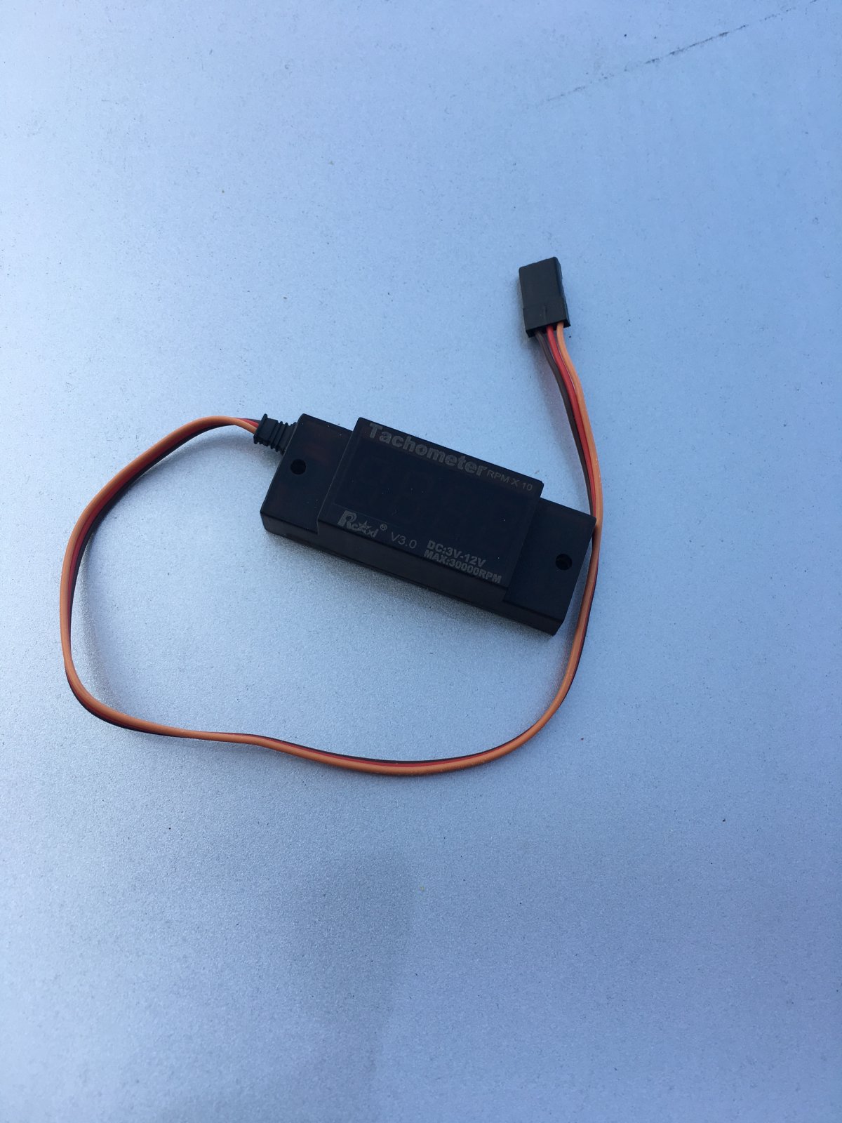

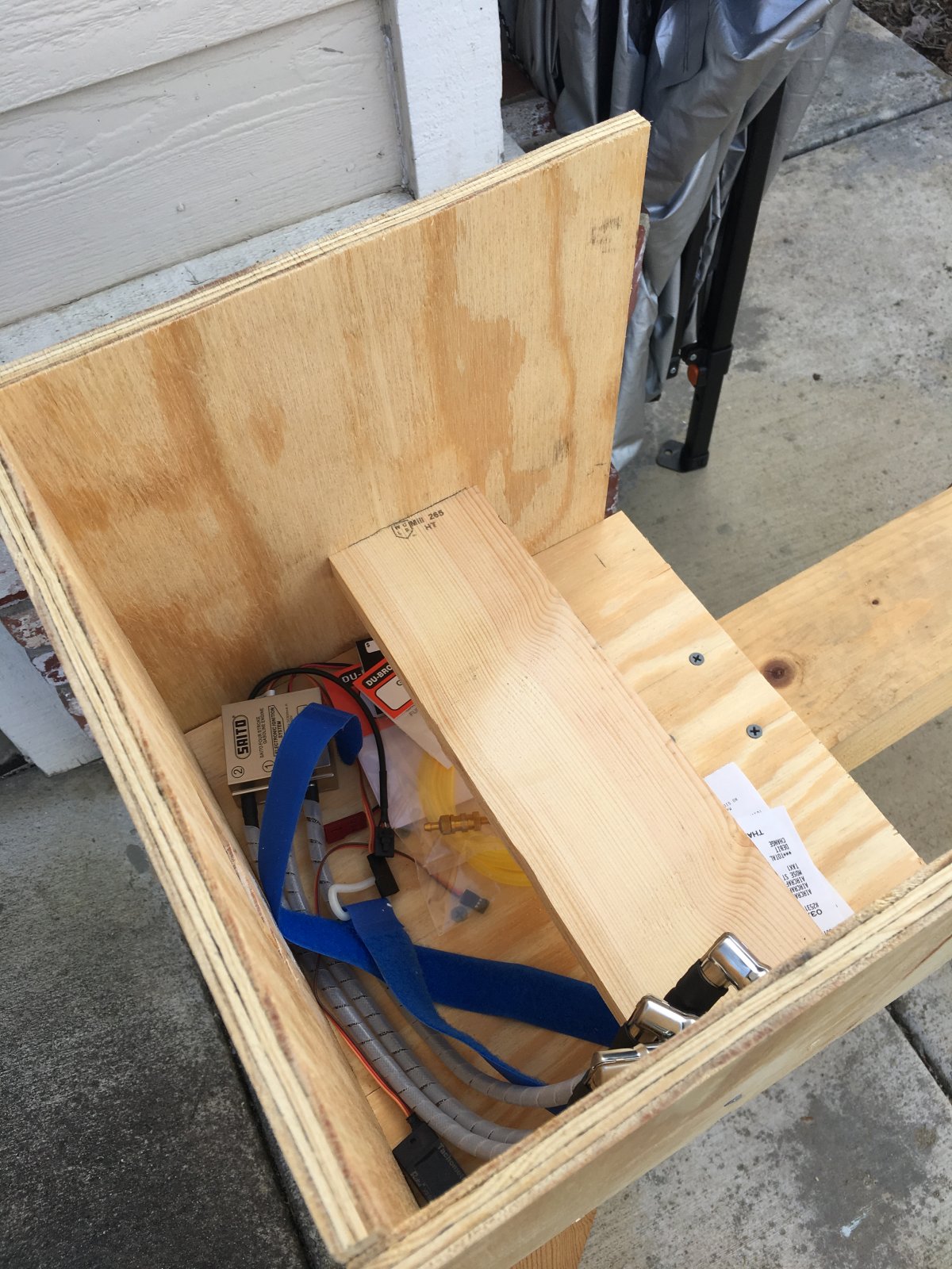

Only had a couple hours today, worked on putting a shelf for the fuel tank in the test stand. Also drilled the holes to mount the motor and the big hole for the carb. I don't have any real woodworking tools so I had to make due with what I had on hand so it took a while. I ordered the Rcexel mini tach which plugs into the tach output on the ignition to keep an eye on the rpm's during break-in, only $10.
