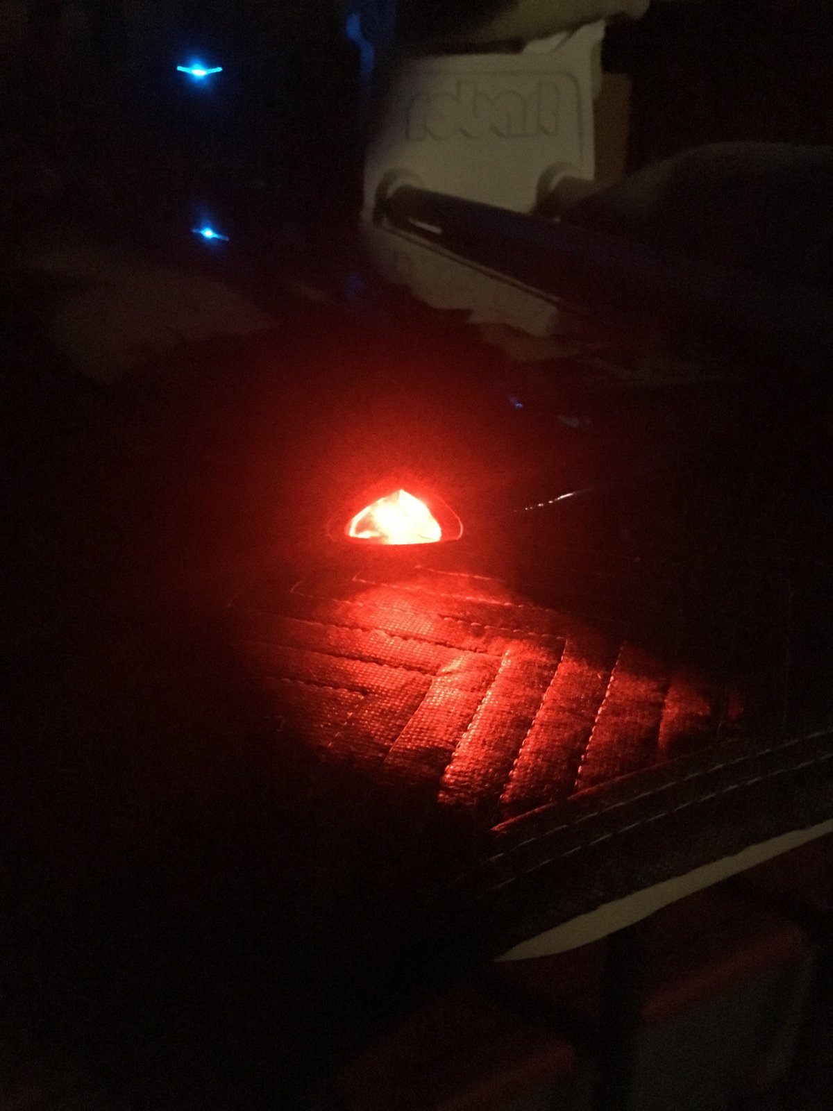

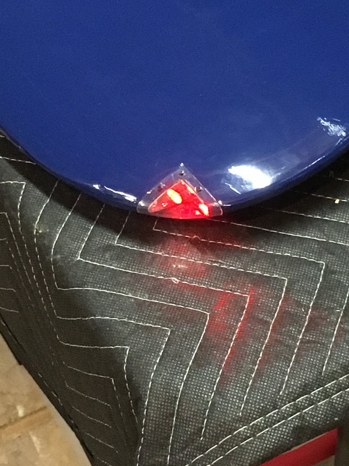

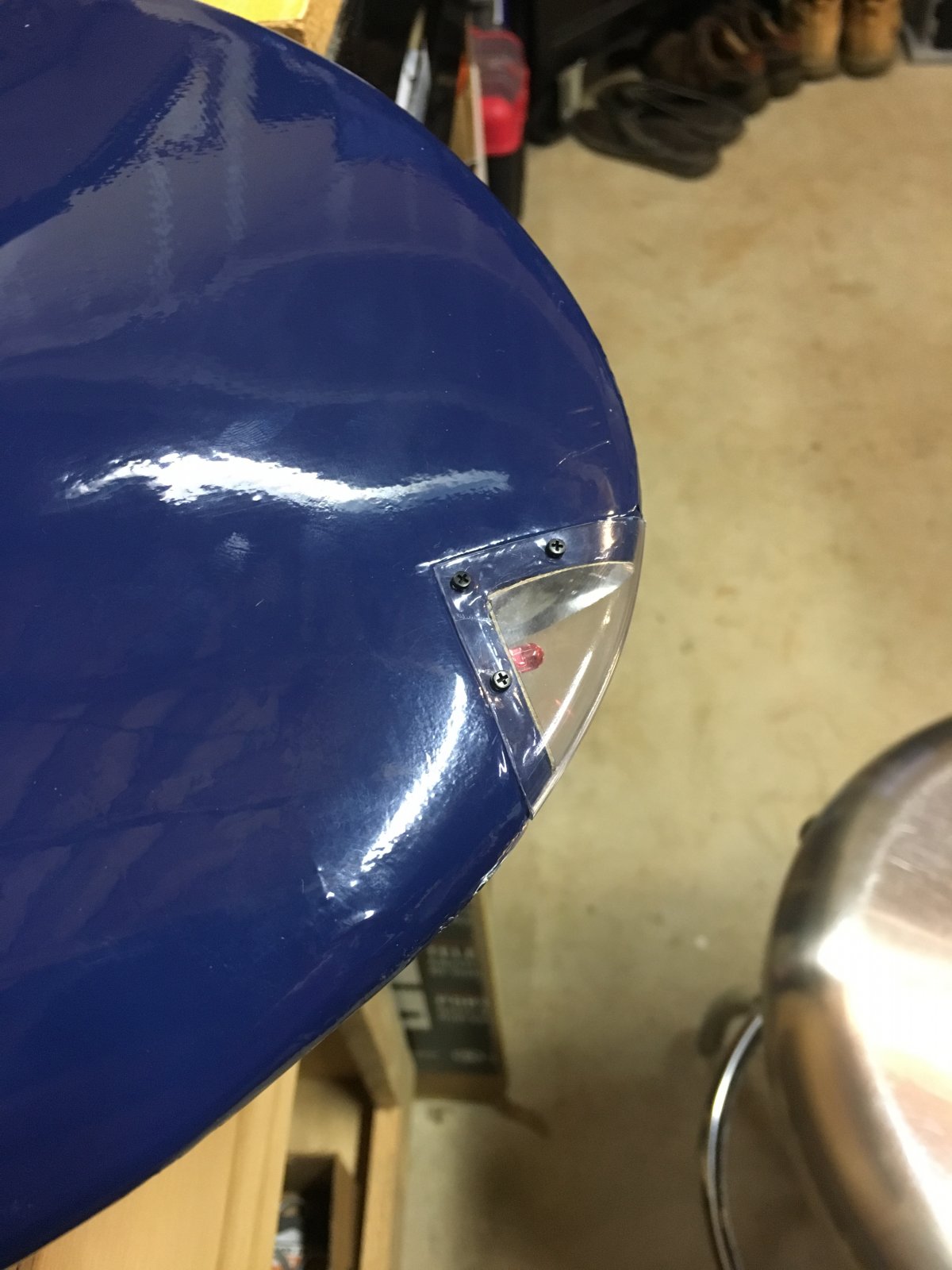

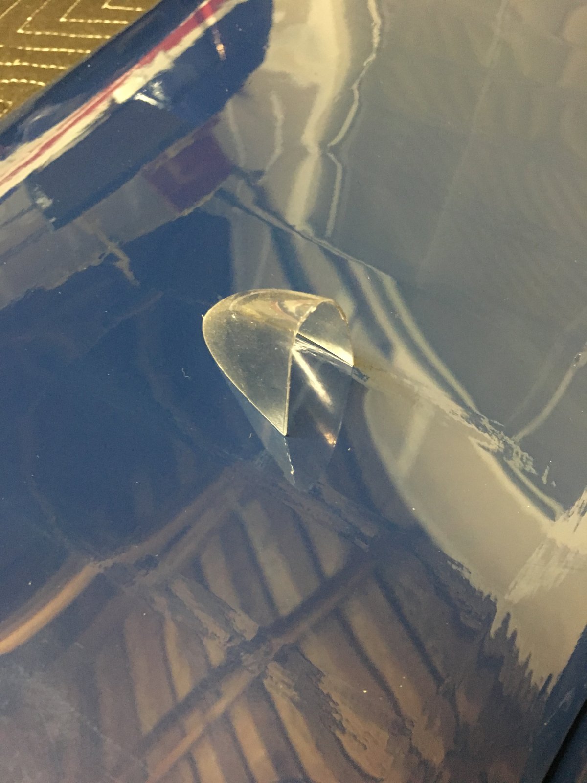

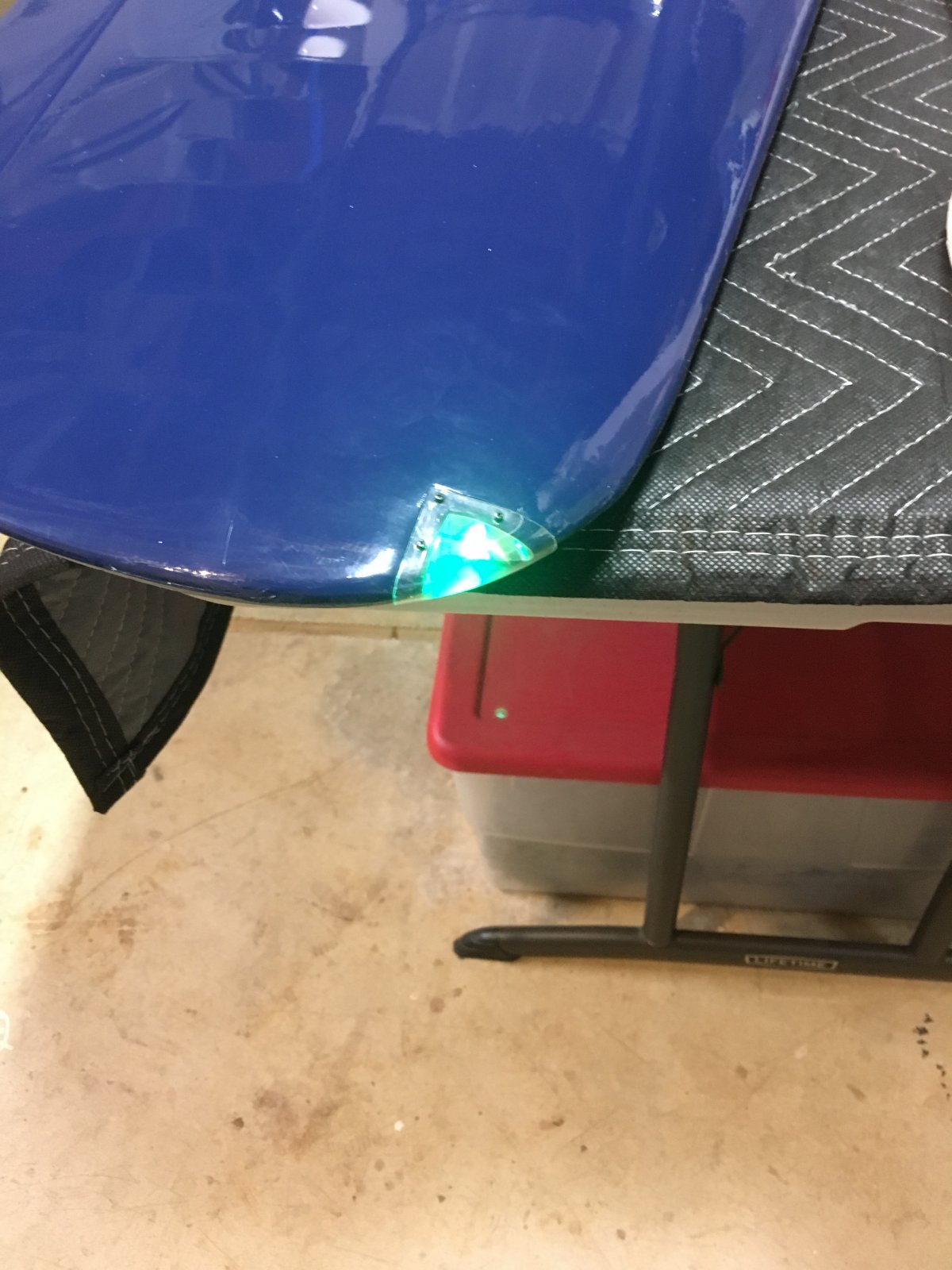

After a brief intermission, got some work done on the Corsair today. And you guys thought I was joking when I said this would be the longest build thread..

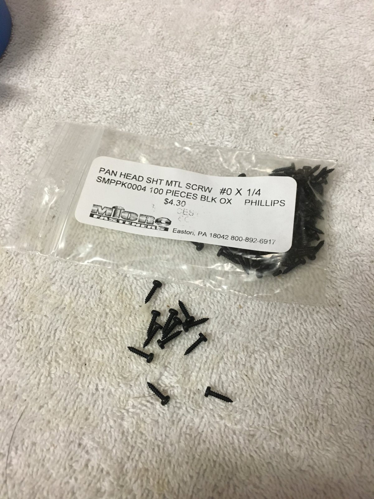

Installed the tail light and installed the wingtip lenses. The instructions have you glue them on but since they are clear I thought that would look messy and obviously not removeable if you need to swap out the LED for whatever reason. So I bought some small black sheet metal screws and used them to mount the lenses. Looks nice and clean and cool. LED's are pretty bright, have to see how they look in the daylight.
