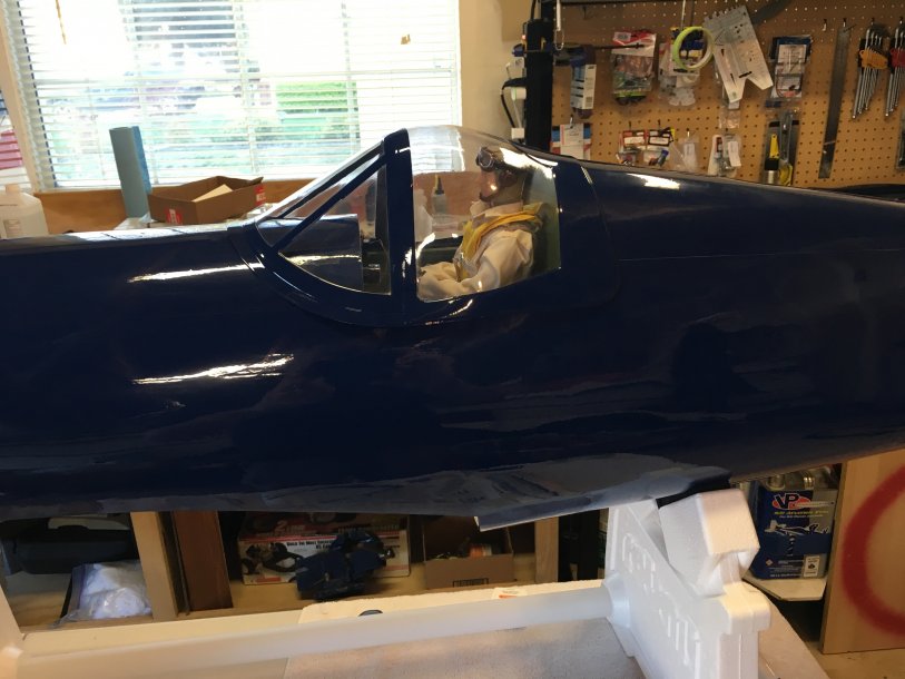

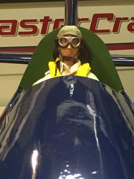

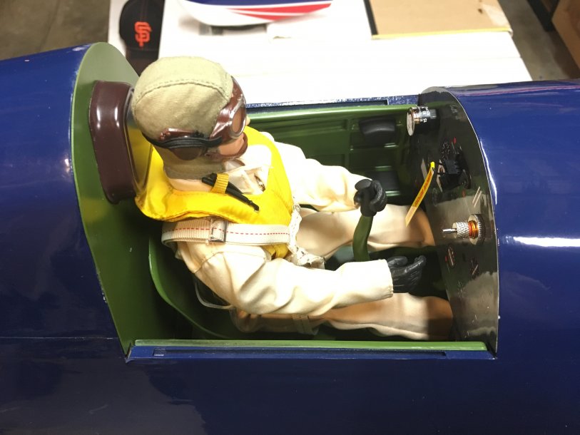

So... I couldn't, not work on the cockpit tonight, got the seat, headrest and stick installed. I was so exited to get it all together I forgot about making some sort of seatbelt! I have a plan for that though, similar to what Tom did with his. The pilot sure makes a difference, had to give up the parachute though... Saved him a solid inch of headroom.

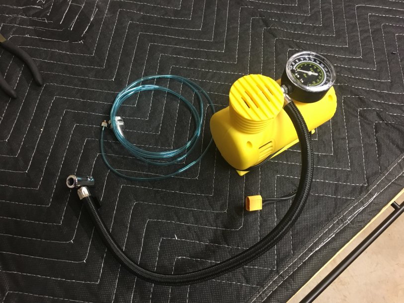

Been a while since I've worked on the Corsair, the weather has been too good so I've been flying in my free time. Made the drive down to Harbor Freight to pick up a small air compressor for the retracts. I'm not really a Harbor Freight fan but the pump was only $9 and I had the 20% off coupon so I figured I can't really go wrong. Soldered on a XT-60 connector to connect to the Hobby King battery and gave it a whirl, seems to work ok. I was able to cycle the tail wheel and it worked great. I hope to cycle the mains this weekend.

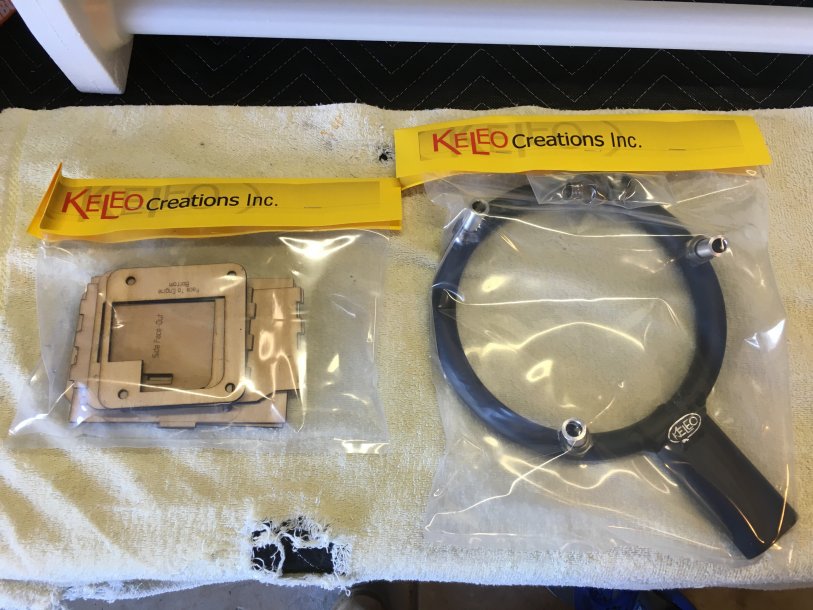

New update! Decided to switch directions on the Corsair, as if things weren't complicated enough! I've decided to go with the Saito 84cc. I've sold off the exhaust ring, glow driver, and prop I had for the evolution radial. I've bought and received the Keleo exhaust ring and firewall for the Saito. Well let me just say, after seeing the Evolution parts, these Keleo parts make those look like toys! The exhaust ring is awesome, really nice looking. The firewall/motor box allows you to mount the Saito without having to cut the cowl to get it to fit. The reasons for the switch are numerous, the biggest one was I didn't want to run custom mix glow fuel. The power with the Evolution was mostly described as "adequate", the 84 should have plenty of power and I can swing a 22-10 semi-scale 3 blade with it.
On another note one of these showed up at my field a couple weeks ago and I got to see it fly. Seemed to fly very well, he had a Zenoah GT-80 with a 24-10 prop and it flew the plane very well. If mine flys like that one does I'll be very happy.
I'm going to try to sell a few things and cut the cost down on the Saito. So that should hopefully be coming soon!
