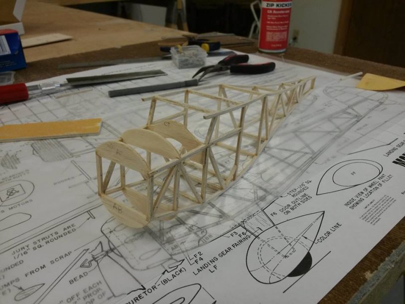

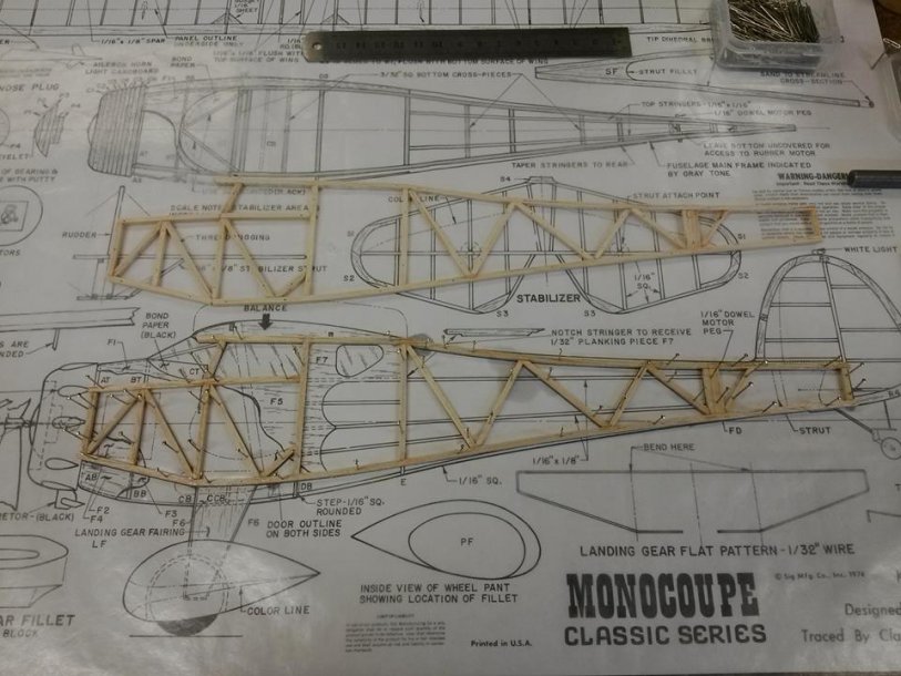

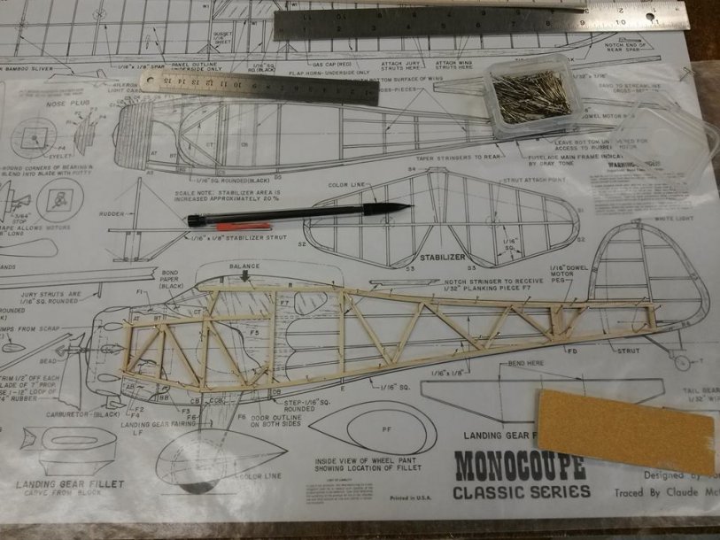

Going into winter/indoor season and I'm laid off of work right now so I don't have the cash to build a giant scale but thought I put together something different for indoor season.
Went old school and decided to do a conversion on an old Sig Monocoupe 90.
3 channel with 5 gram servos and a 2 gram airtronics RX, gonna have STUPID power because it is getting a Hacker A10-12s (what I have), Hacker X-5 SC, and a 2S 200 mAh 20C battery.
All the electronics add up to 40 grams, looking to be under 95 grams RTF, so I have 55 grams to play with to get the airframe built and covered.
Bipeguy03
Here's the progress after one evening :)
