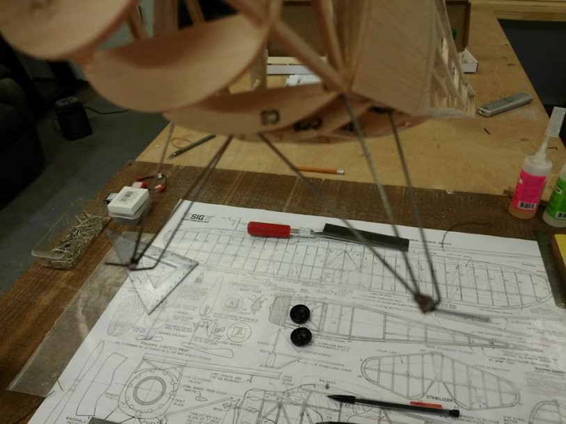

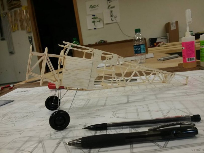

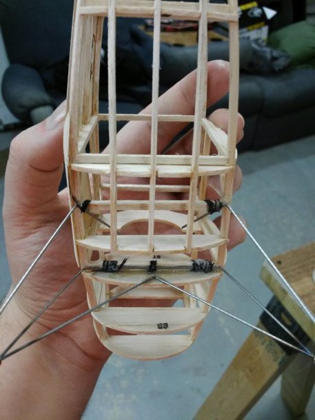

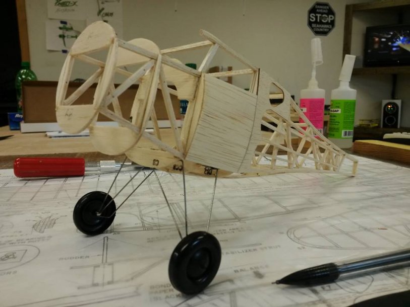

This evening I tackled the landing gear, when I was a kid and would build the Guillows warbirds for rubber power I'd always leave the gear off because I hate bending that little wire. That really wasn't an option here lol. Got the wire bent and attached it with epoxy reinforced with thread. The axels are a separate piece and part of the brace soldered to the gear.... When you're used building Giant Scale, this little stuff is a challenge!!!
Also started getting the stringers and sheeting attached :)

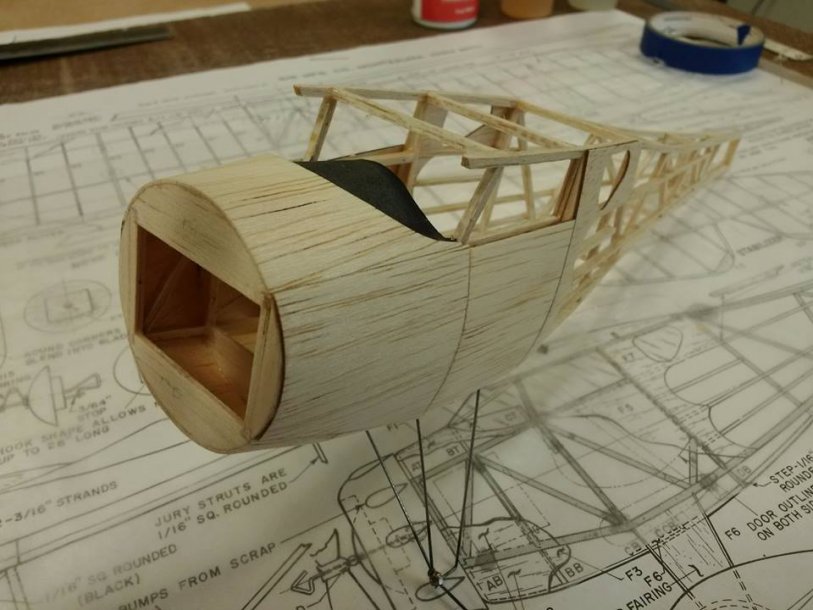

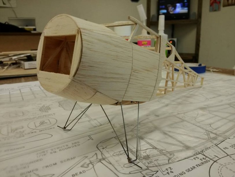

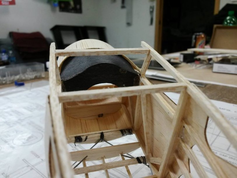

Tonight I just about got the stringers and sheeting finished, just got one more piece of sheeting on the belly to put in. The instrument panel glare shield is made out of a piece of sketch paper colored with black permanent marker.
To this point what I have built weights 13 Grams, so I'm on track so far!
