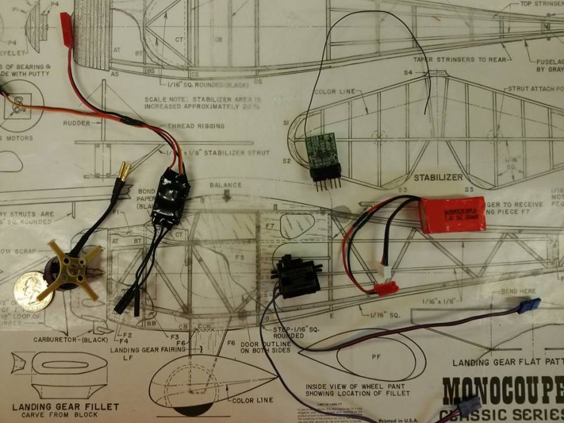

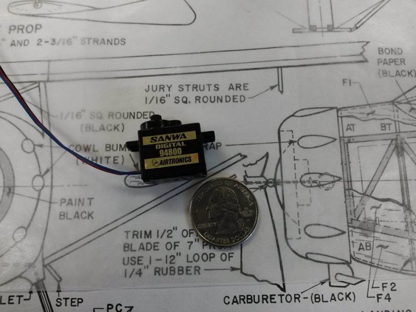

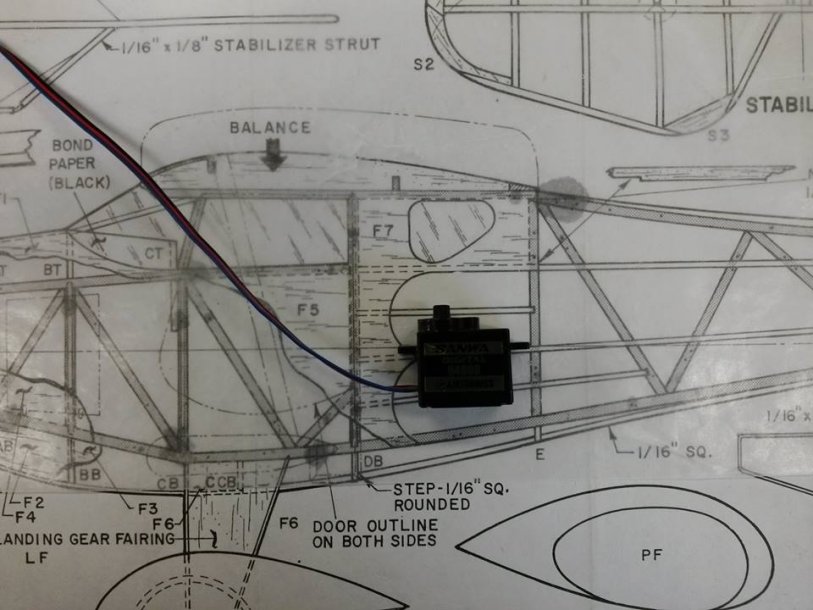

Got my servos today as well so did some mapping with pieces and parts.
SOMEHOW I gotta cram all that junk in a 16 inch fuselage!
Bipeguy03
So purdy. What will you power it with.
Hacker A10-12s, with a modified GWS 5x3 prop and a 2S 200 mAh 20C pack.
Going to be ridiculously overpowered as that set up should put out around 35 Watts (I want the plane to be less than 3.5 ounces) but I'll just keep the throttle pulled way back and my flight times will go through the roof.
