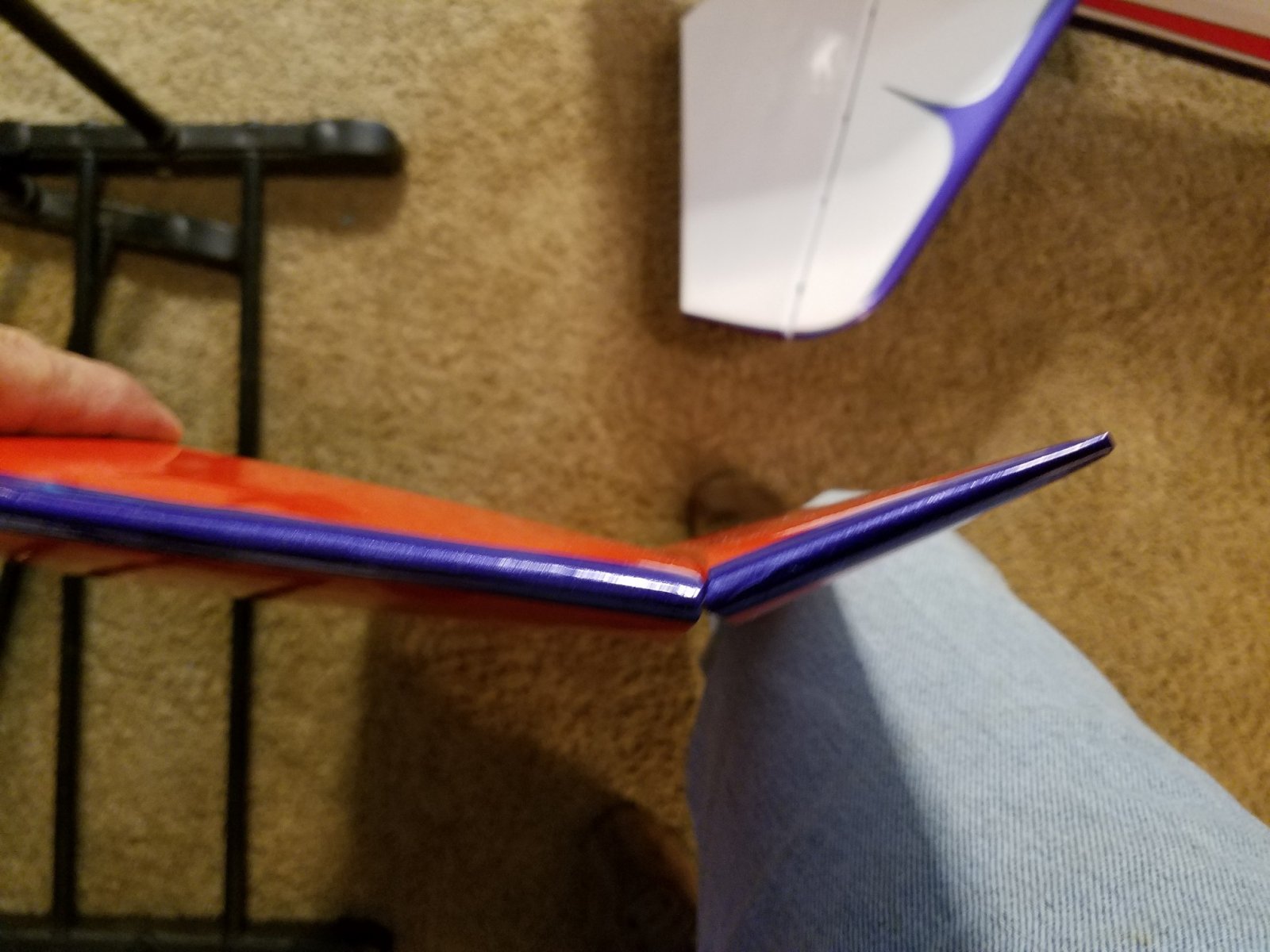

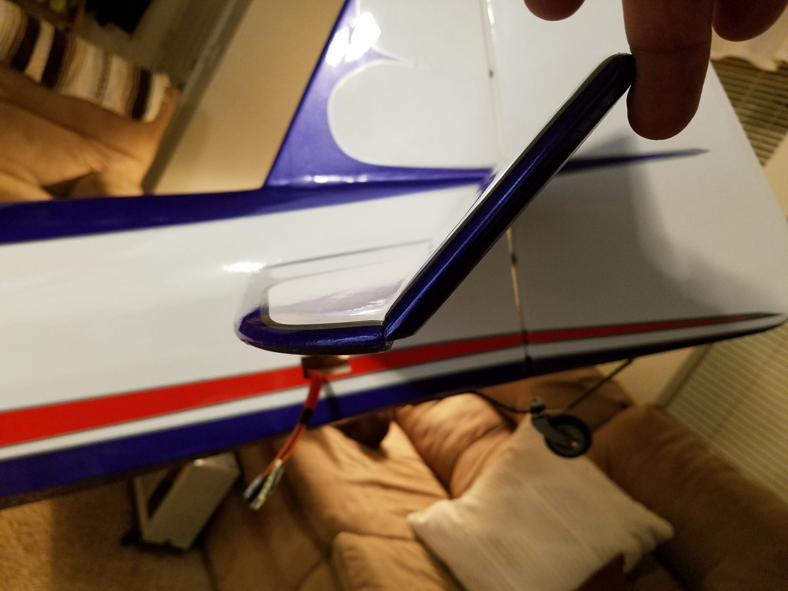

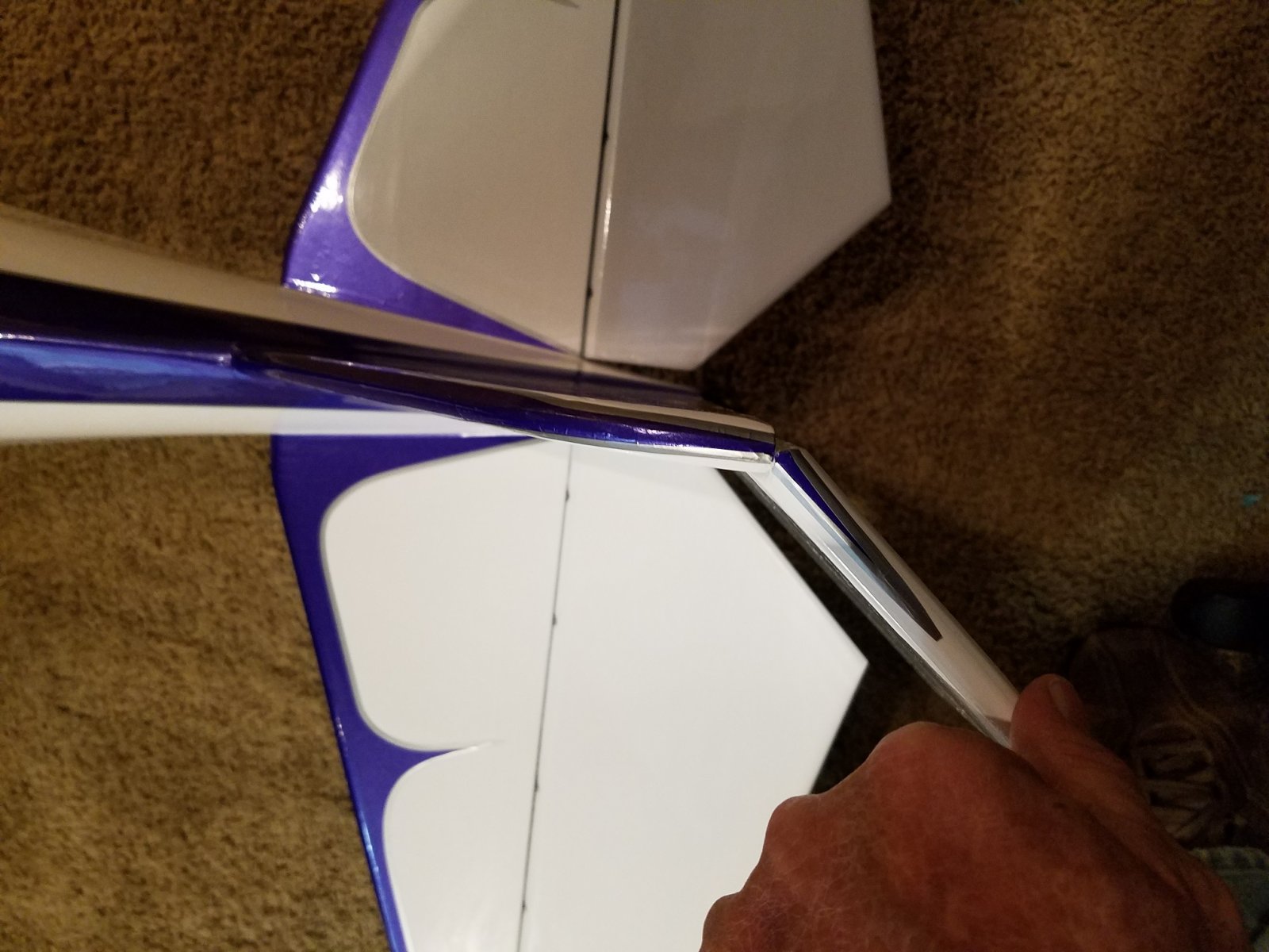

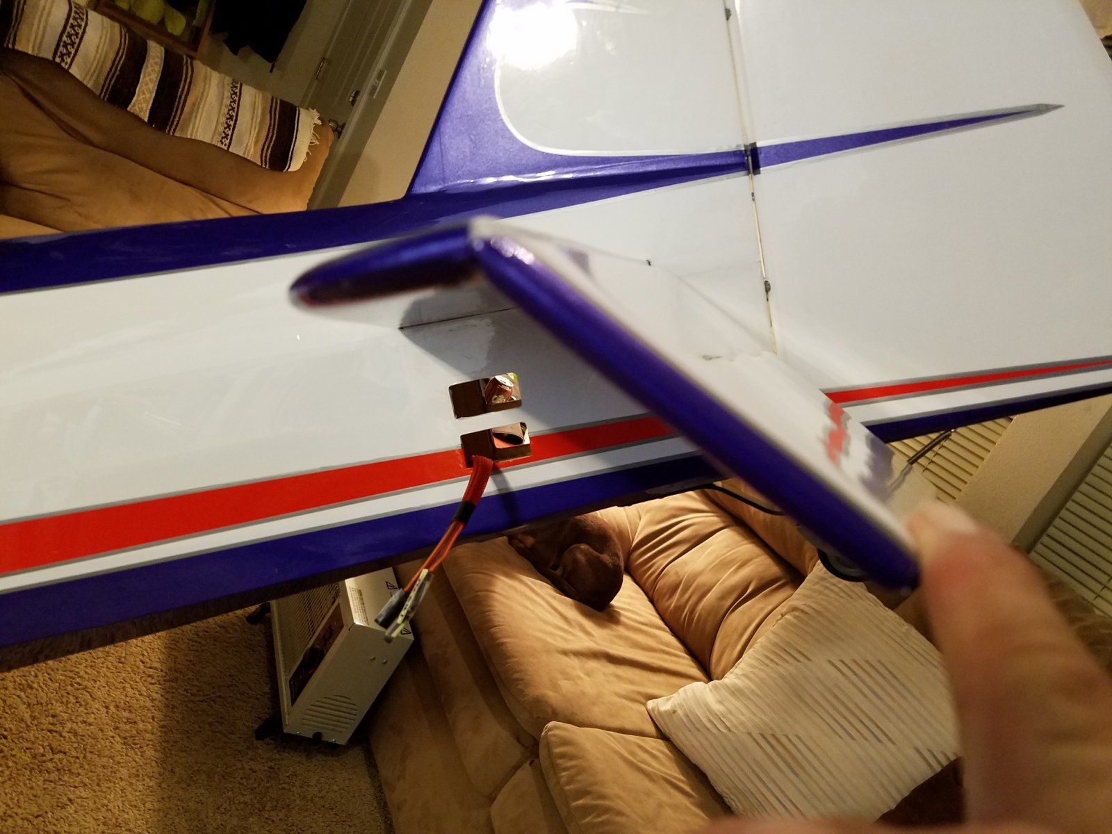

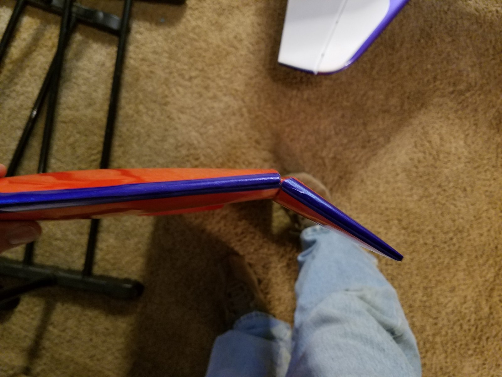

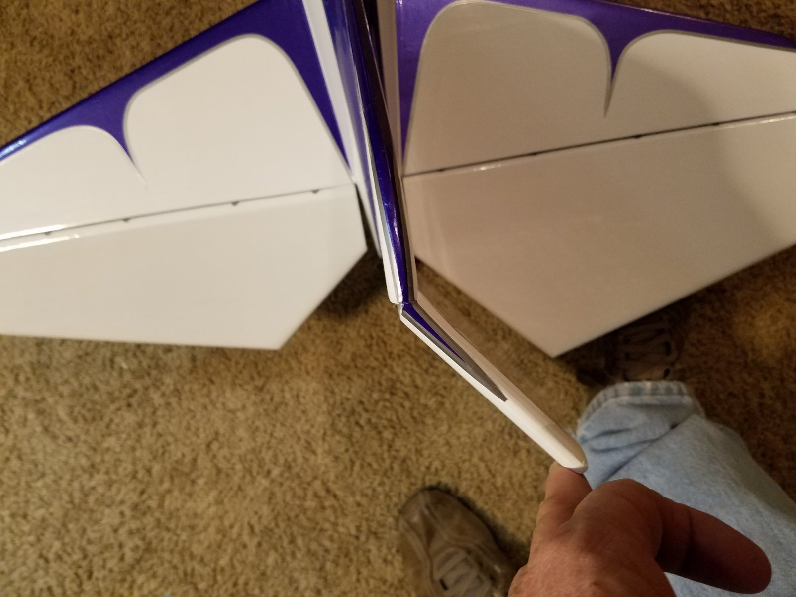

I did get what I feel is pretty good deflection with the control surfaces. Not as much as I wanted on the ailerons, but then again I highly doubt I am going to be doing any hard 3D'ing with the Pitts. However this does bring up a question for all you experienced Bipe owners. Al mentioned to take it easy on the setup and to not put in too much control surface deflection. What do you guys think? Did I get enough? I guess I don't have to program in everything that the control surfaces are capable of. Then again, I have a "very" light touch on my sticks when I fly. I have about 51 degrees on the ailerons, 48 degrees on the elevators and about 50 degress on the rudder of my 260, Sukhoi and Yak and usually always take off and fly with them at this rate, (even though I do have multiple rates programmed in). Landing on the other hand, I usually flip them down to low rates. But I have never owned a Bipe before so I am treading into new waters here. I could use a little input from you guys that have flown Bipes.
Here is what I ended up with.
I would appreciate some input so chime in Bipe owners.

I agree with Waco
My opinion is your throws are massive and will be more than you will actually use.
My Pitts S-1S uses very little throw because of the short fuselage
but then my Ultimate uses more like the mono wing plane.
Your going to love it
jtec/radiowave
The Pitts will take basically half the throw that you normally use with with a mono plane and that is the reason that you don't have to worry about double beveling things like the ailerons.
You have more than enough throw.
I agree with Waco

For reference here are my high rate surface throws (I fly IMAC style, not 3D but you'll get the point):
Ailerons: 12 degrees up/down
Elevator: 15 degrees up, 10 degrees down
Rudder: 30 degrees left/right (I only use this throw for hammerheads really)
