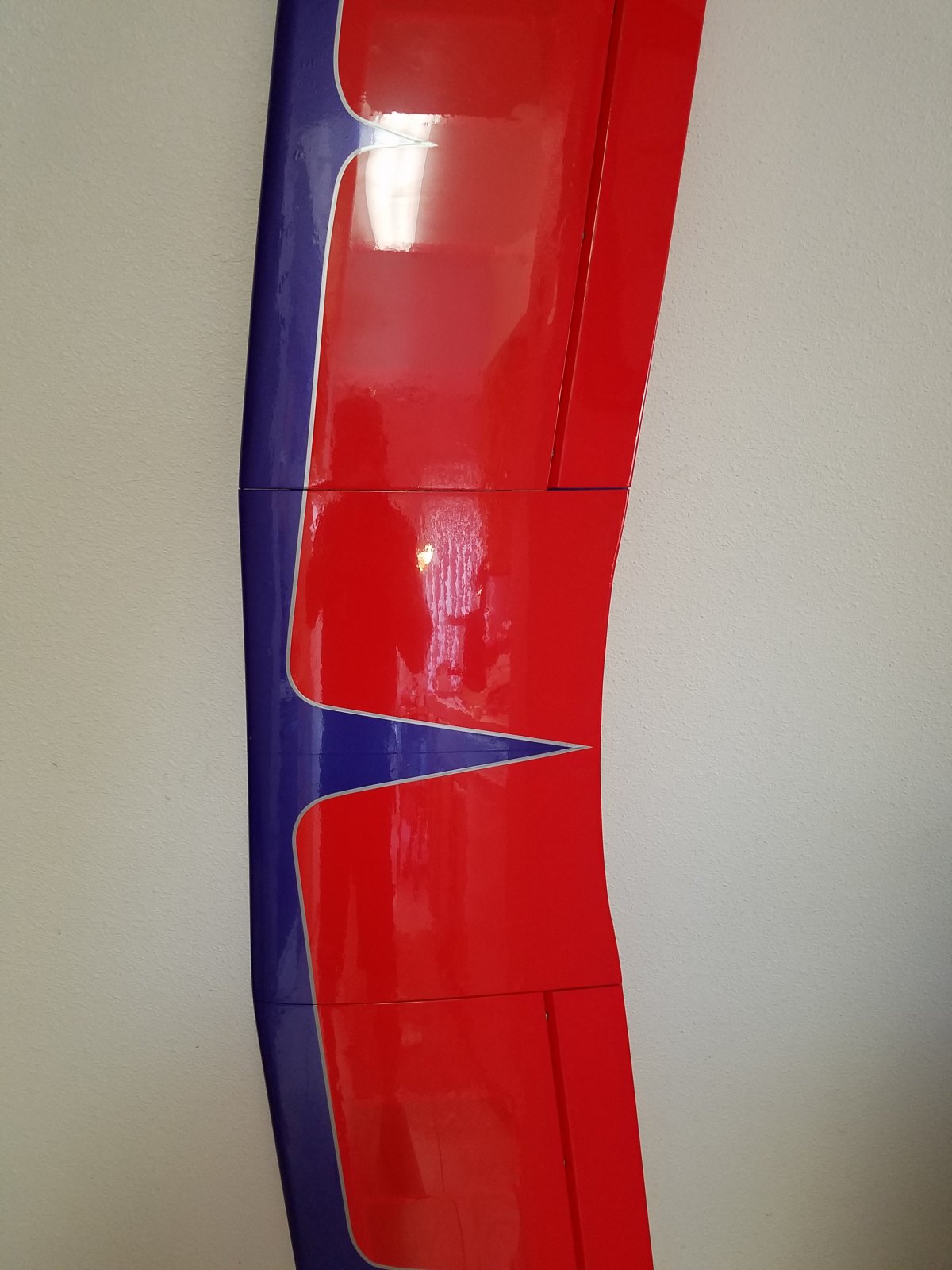

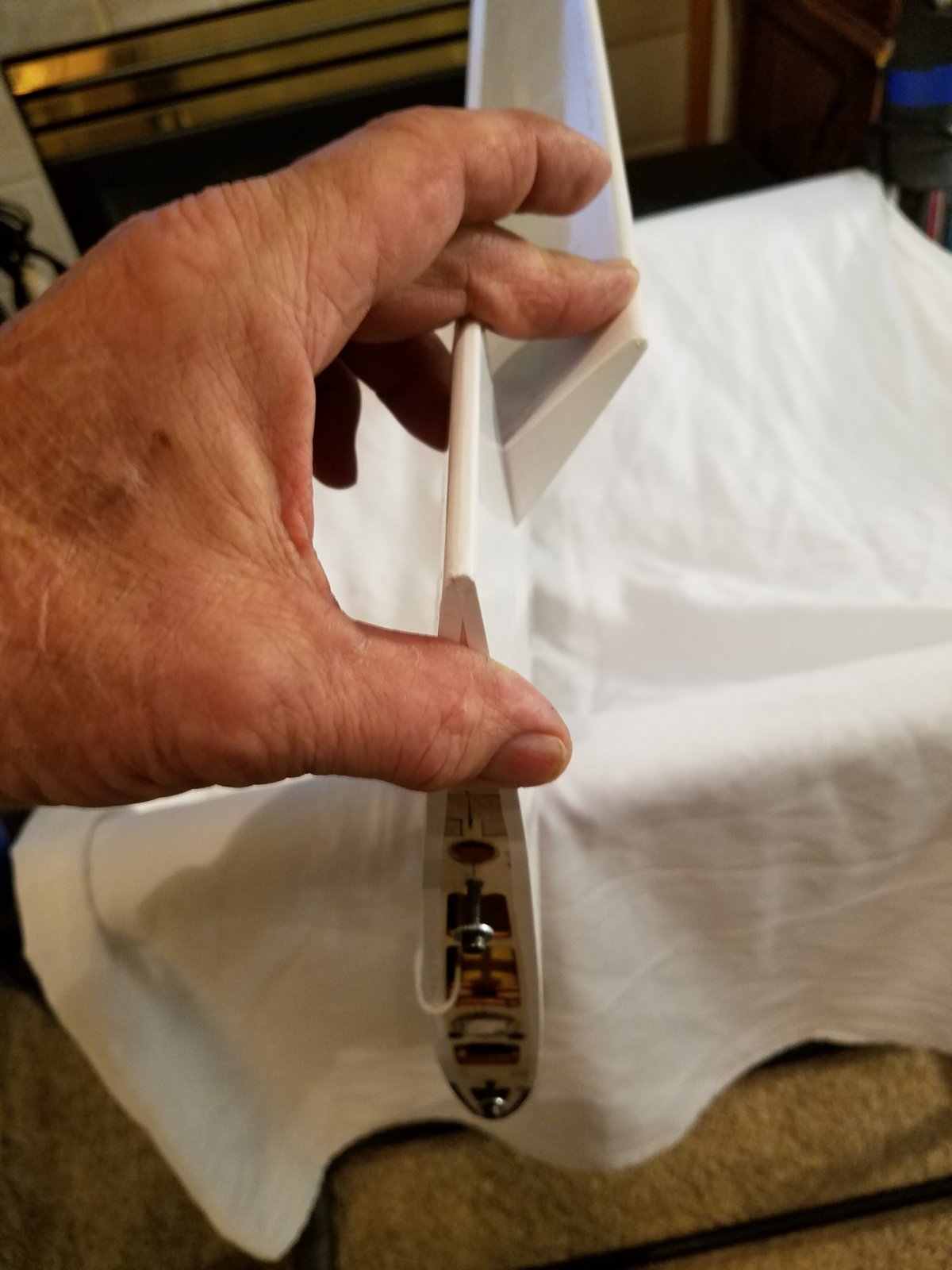

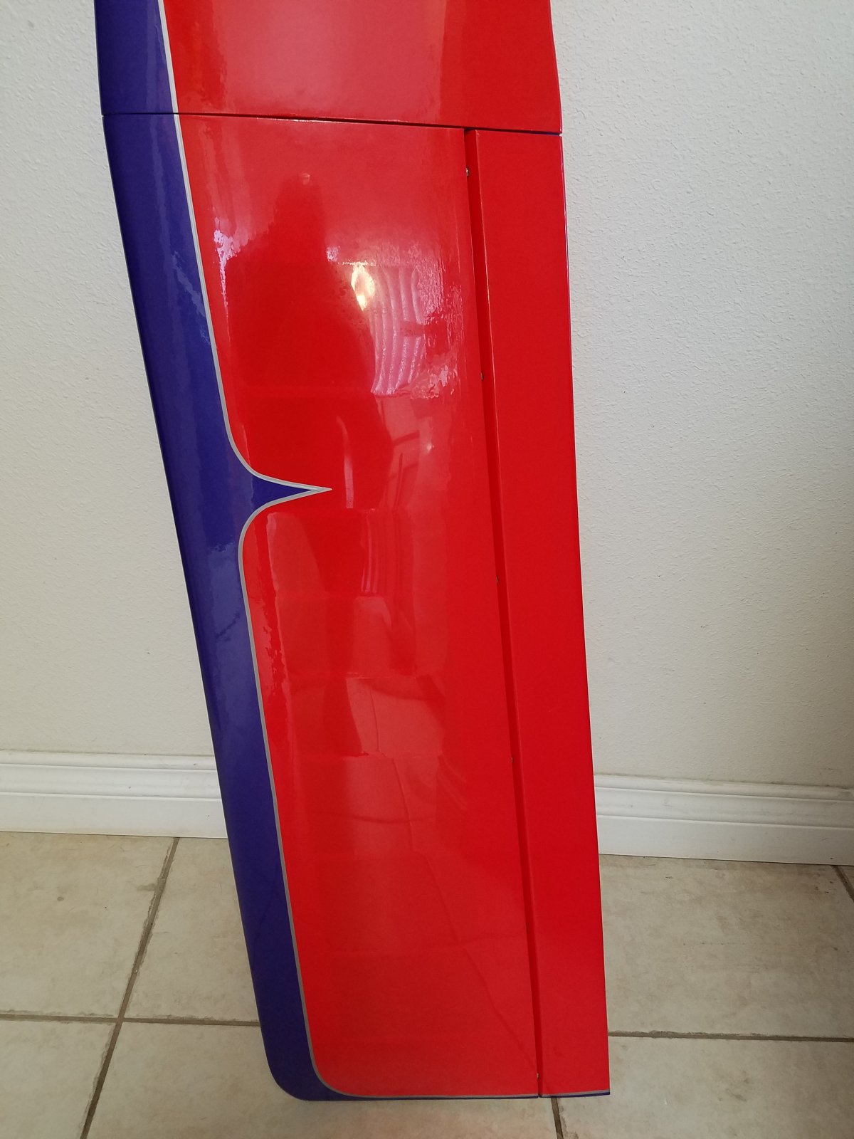

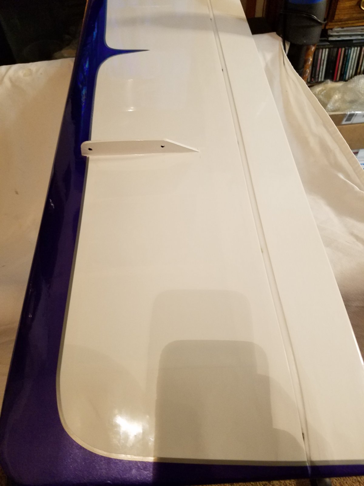

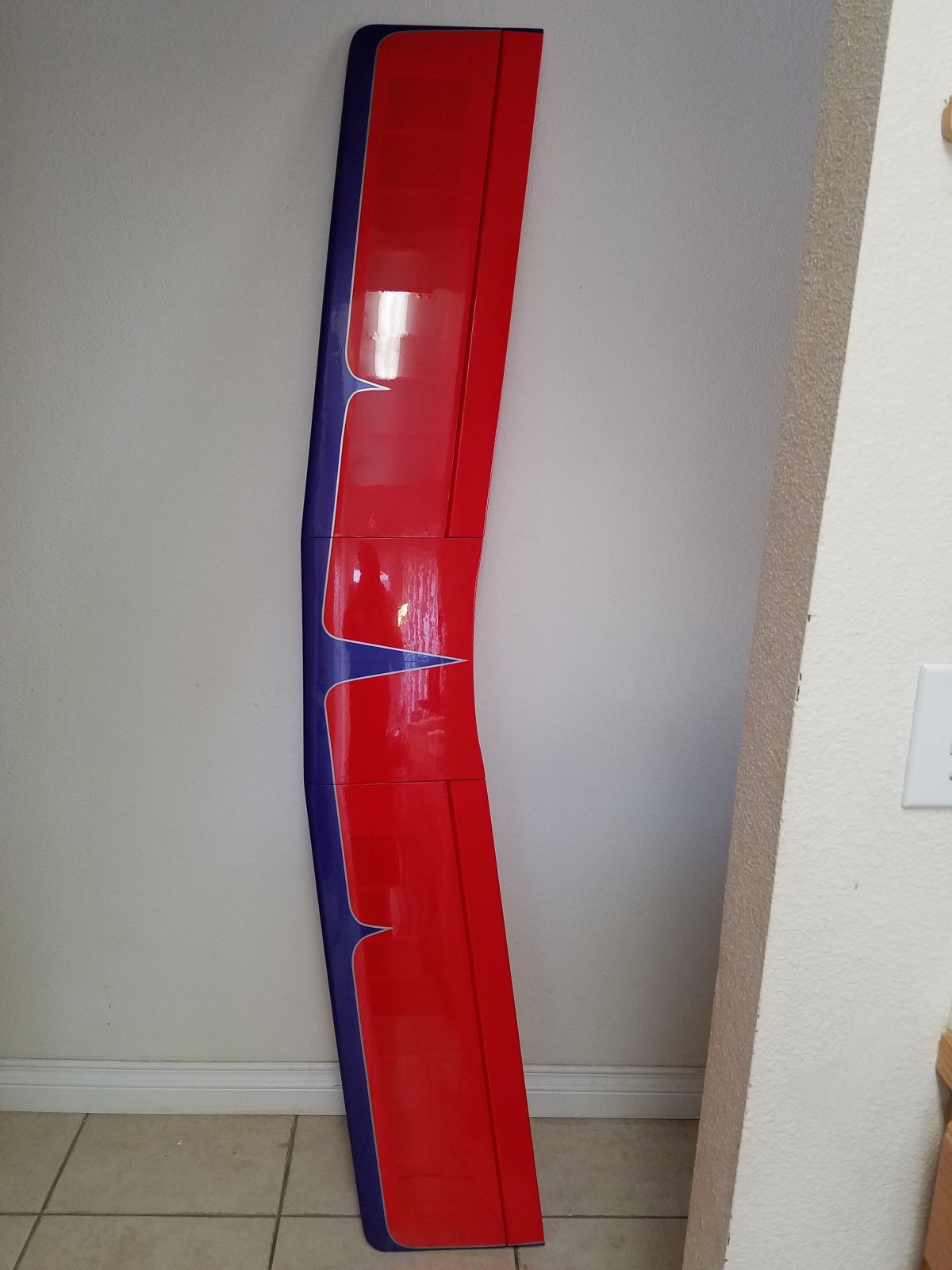

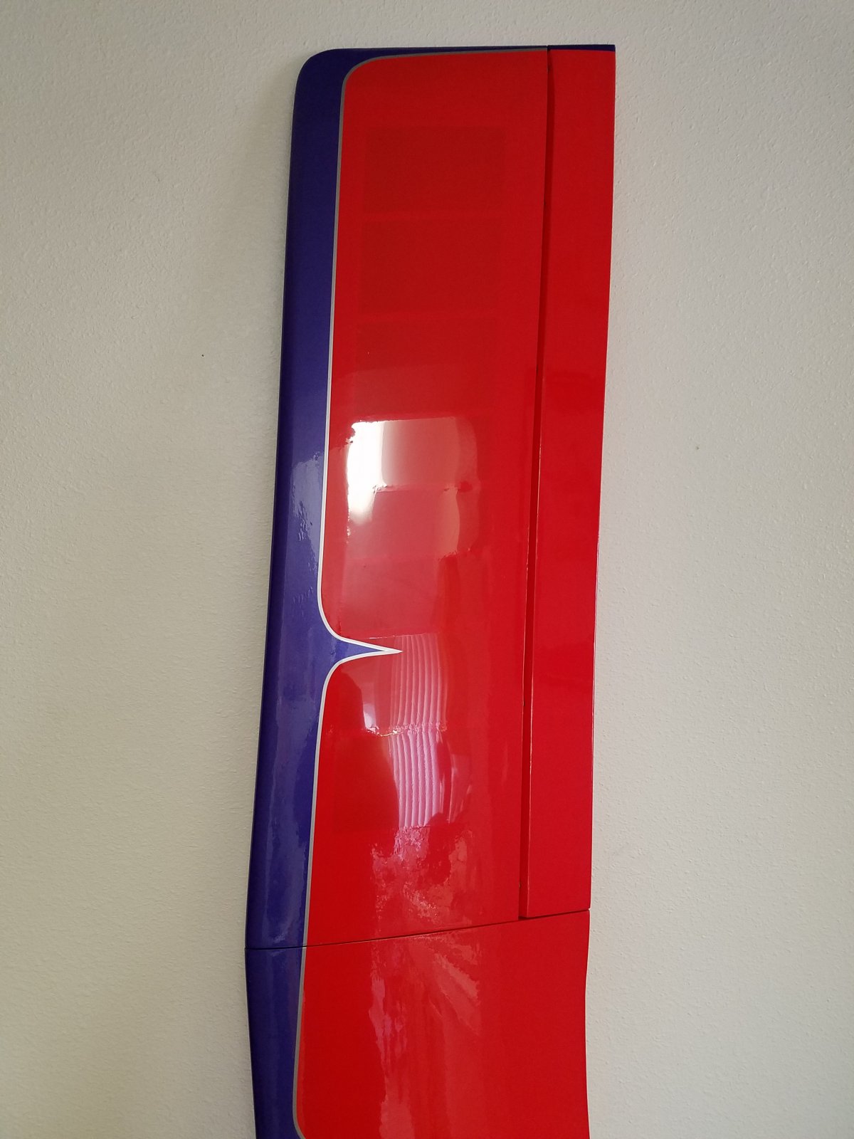

Just a little work on the Pitts today. Got the top of the lower left wing striped. No other striping. Just didn't feel much like cutting striping today. I also got the lower wing aileron hinges glued in.
I plan to finish the striping tomorrow and very likely start installing servos and programming the set up.
I am quickly running out of work on the Pitts. Guess I'll have to fly it soon. Oh darn. Lol

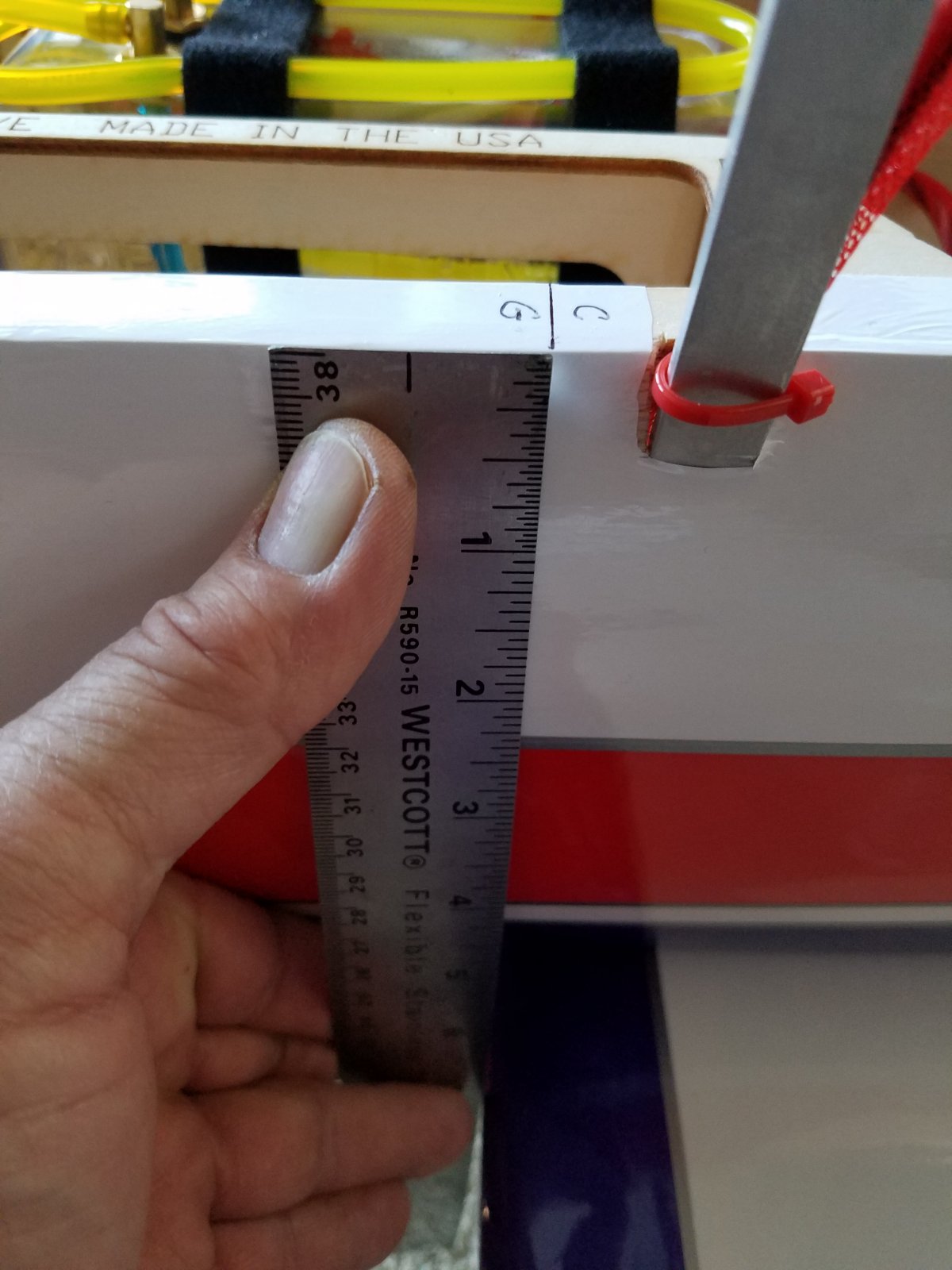

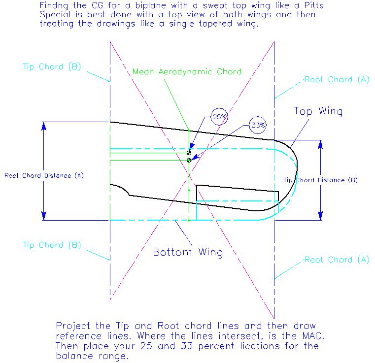

Oh, before I forget...@Wacobipe or @Maxwell1945....where do I start my cg from? Or anyone else that might know? I can pretty well guess cg on a mono plane. Completely lost on a starting point for the Pitts.
Awesome! Just did a quick visual check. It appears the suggested cg range is right where it is supposed to be. In front of the rear cabane/leading edge of lower wing. 1/2" in fact. However if I understand the drawing correctly, not even close to the 25-33% range that is depicted. But it is all cool. I now have a starting point. Thank you all so very much.
This thing is getting to be almost too pretty to fly. I'm very happy with the scheme choice. Top of upper wing striped. Have just the bottom sides of the upper and lower wings yet to finish. I've been second guessing myself on flight packs though. In the past I've used Fromeco LiIon 5200's on my bigger planes. And fully realizing I didn't need them, used the same on my 35%'s. Just hard for an old guy to trust something new when original setups have been working great. That said, original plan was twin Pulse Lipo's, 2s 3600 mah. The second guessing part is, will 2 3600 Lipos be enough? Or should I bump up to 4000's? I'm trying to save weight, but still want to be able to put 4-5 10 minute flights safely. What do you guys think? Open to suggestions.
