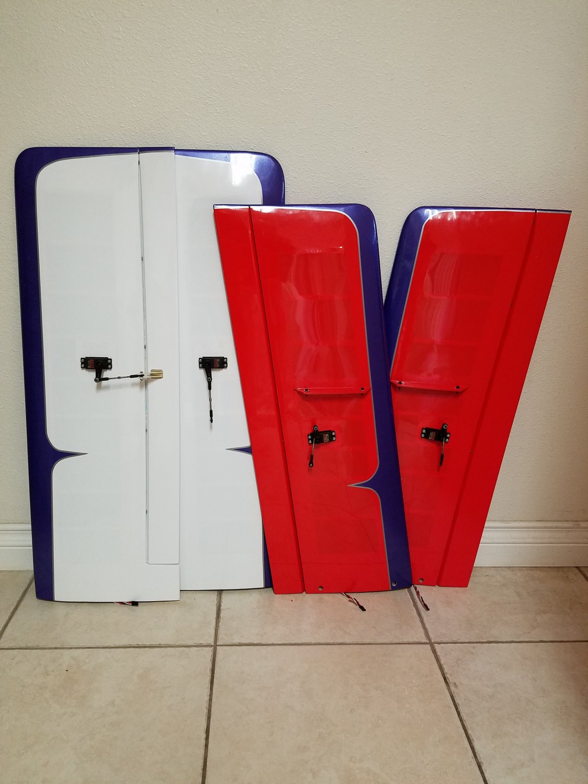

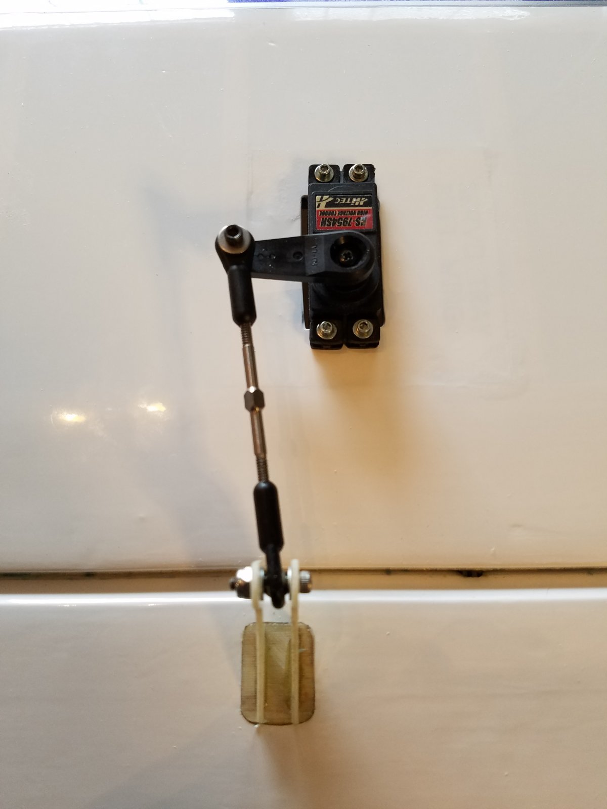

I finally got the aileron servos installed and pretty much tuned in. Final tuning will be done after all horns are installed and linkages connected. I did get one wing completely done though. With the double horn epoxied in, I connected the linkage and what do you know? Other than about half of a turn on the turnbuckle, it was pretty much dead on. Surprizing how easy it was to program four separate aileron channels into one. Unfortunately I can't get dual rates on all four channels. Top two wings I can do dual rates. But can't seem to get them to work on the other two channels. Oh well, not like this plane needs it. And while I am thinking about it, I made yet another change. I was going to go with the aluminum arms. But after measuring and double checking dimensions, the HD Hitec arms should be plenty strong enough. And also surprizing enough, there is as much meat left in these really thick arms after enlargening the holes for the ball links as the aluminum arms.
Although I'll probably never need nor use it, the throws are way more than sufficient. Then again, I may want to do some mean and wicked snaps and bullet speed rifle rollers. Lol

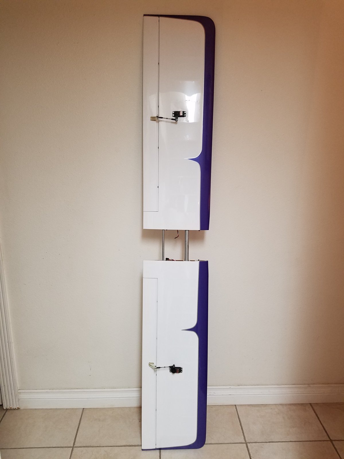

Well dang, second wing took all of an hour to complete. We now have two flyable wings. Do I really need the top wings?

Well dang, second wing took all of an hour to complete. We now have two flyable wings. Do I really need the top wings? View attachment 93226
