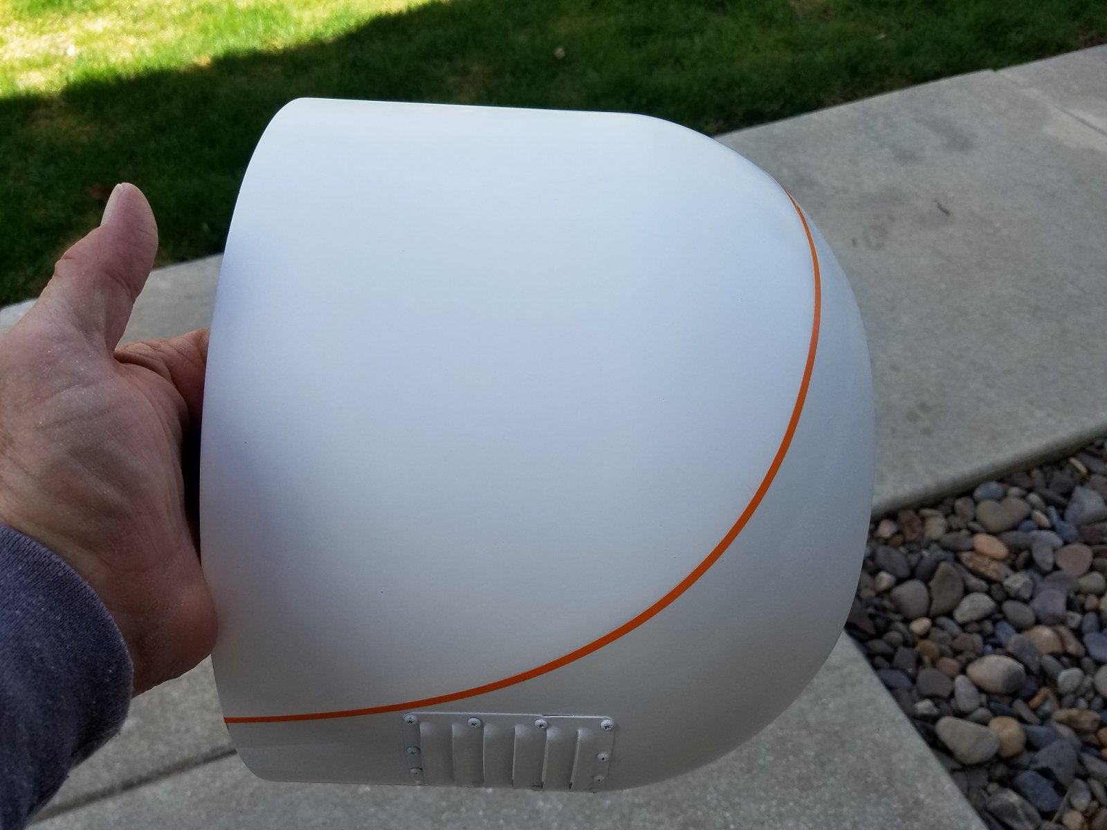

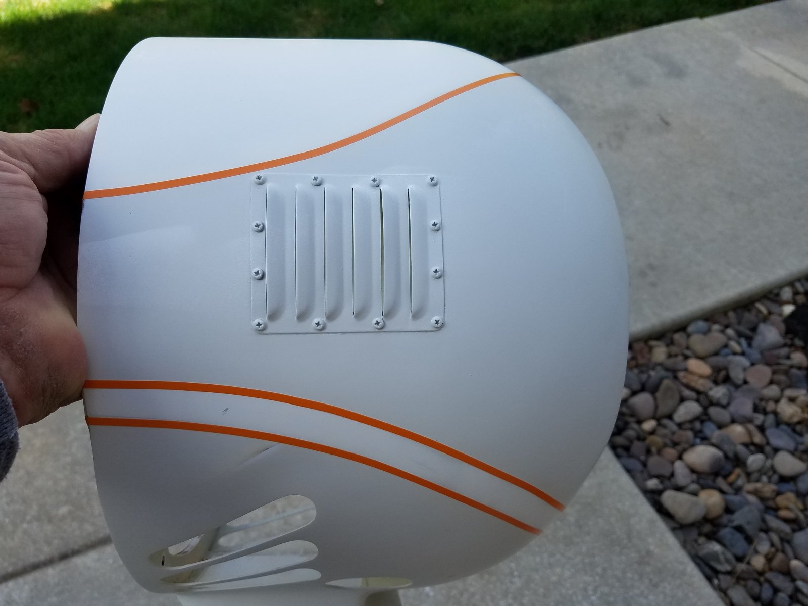

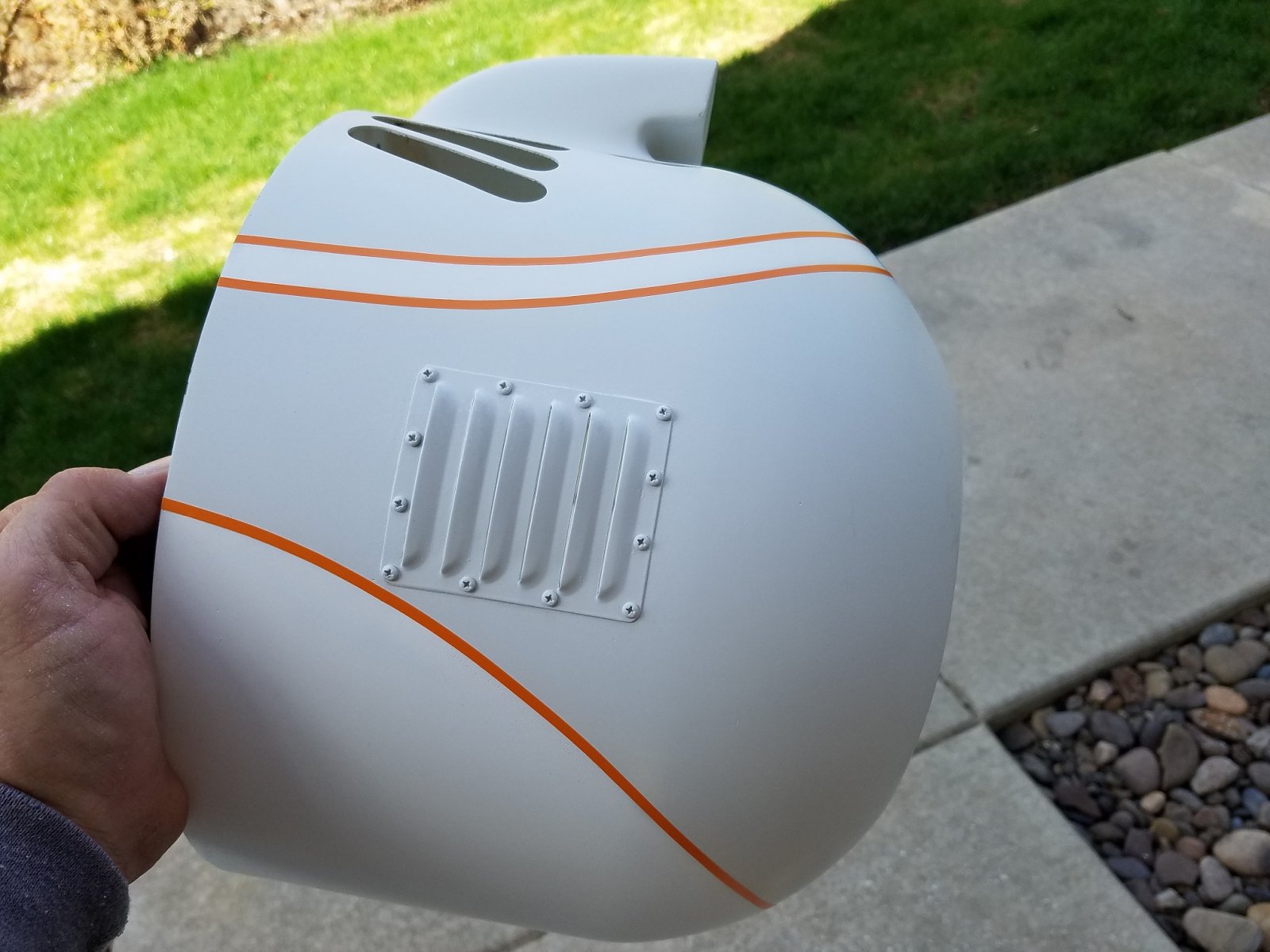

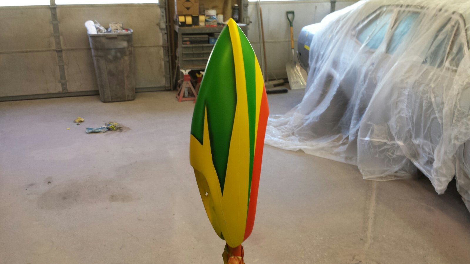

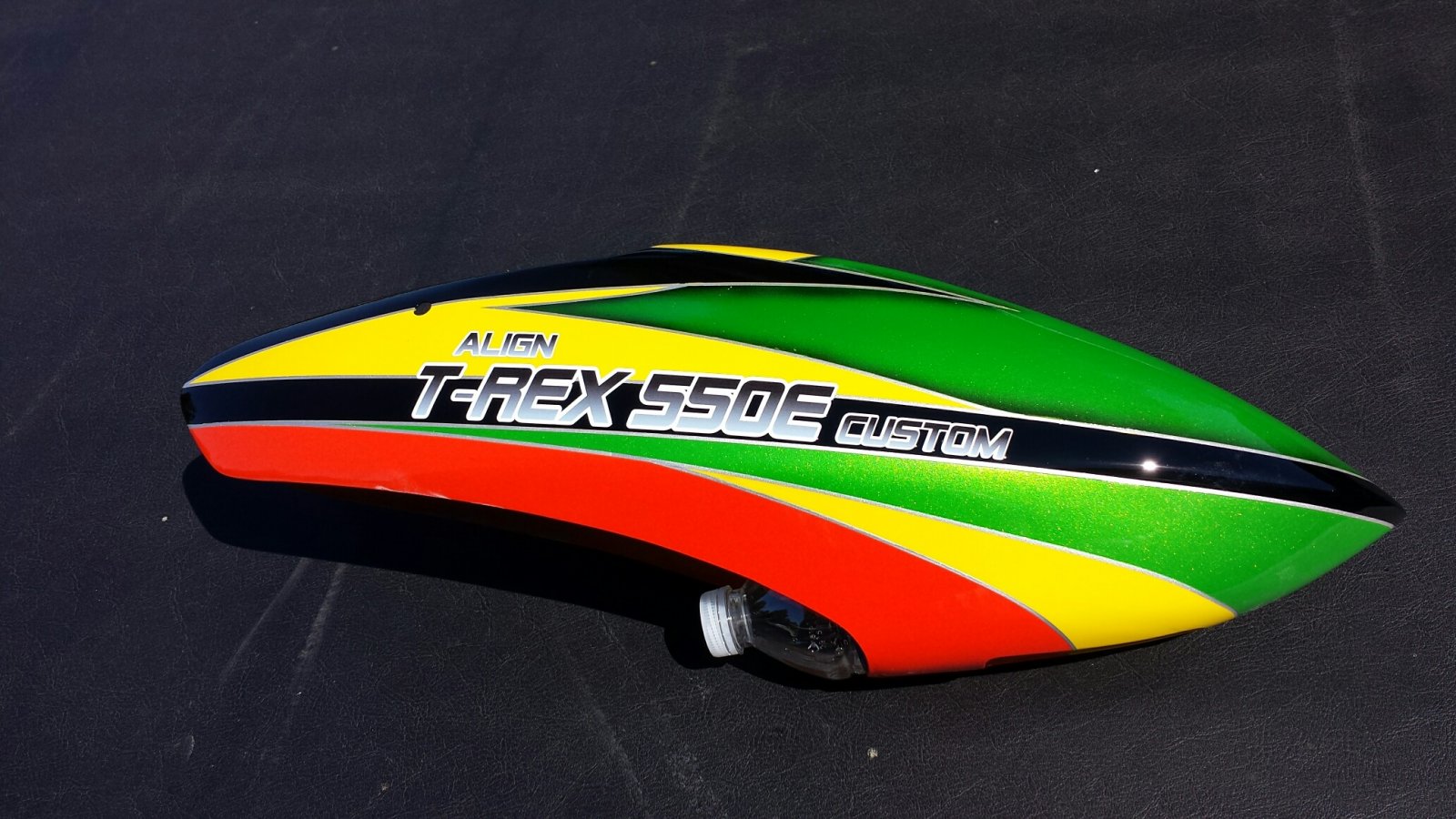

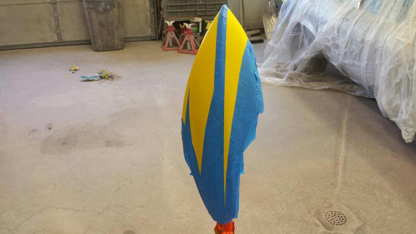

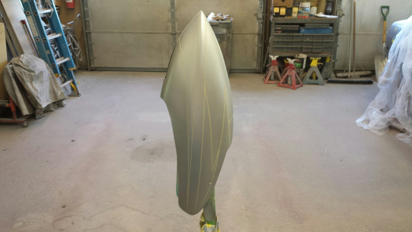

When I did the canopy for my Trex550e I sprayed it silver first, masked off everything I wanted to stay silver, and and used those lines as the edge for several other colors.
View attachment 94537 View attachment 94538 View attachment 94539 View attachment 94540

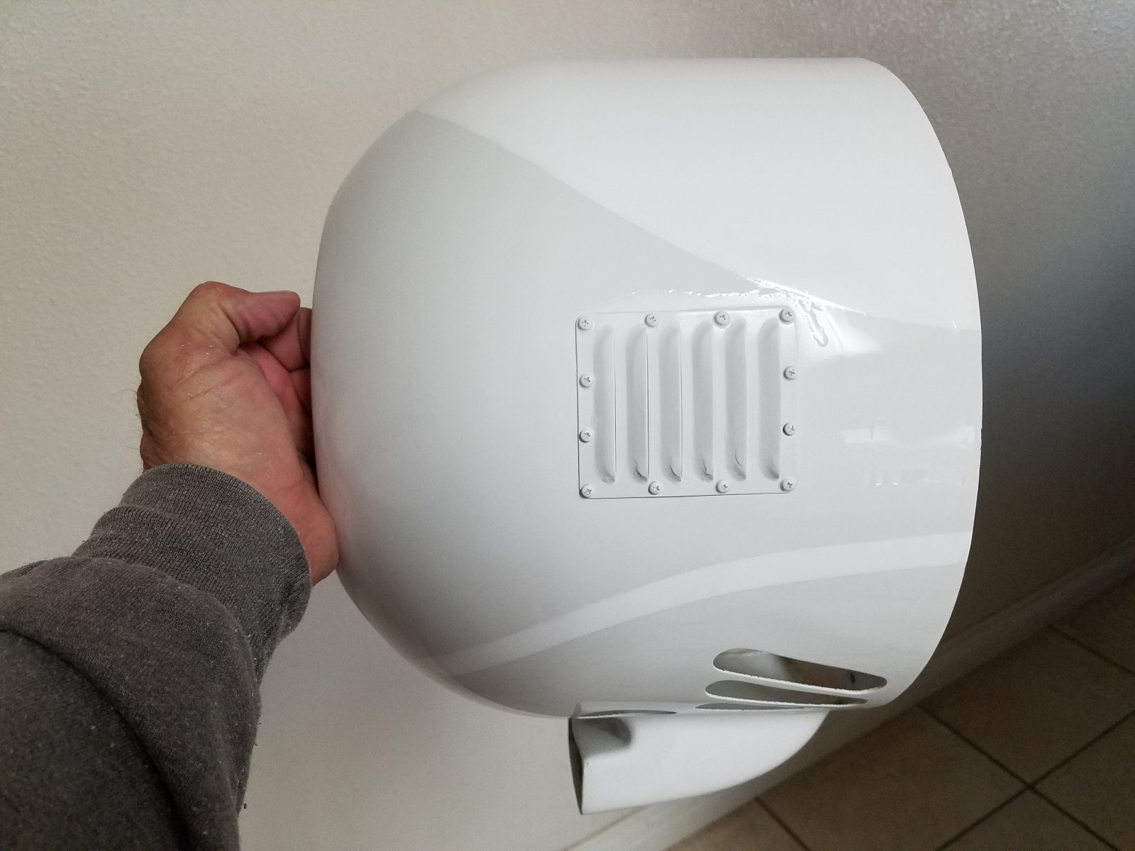

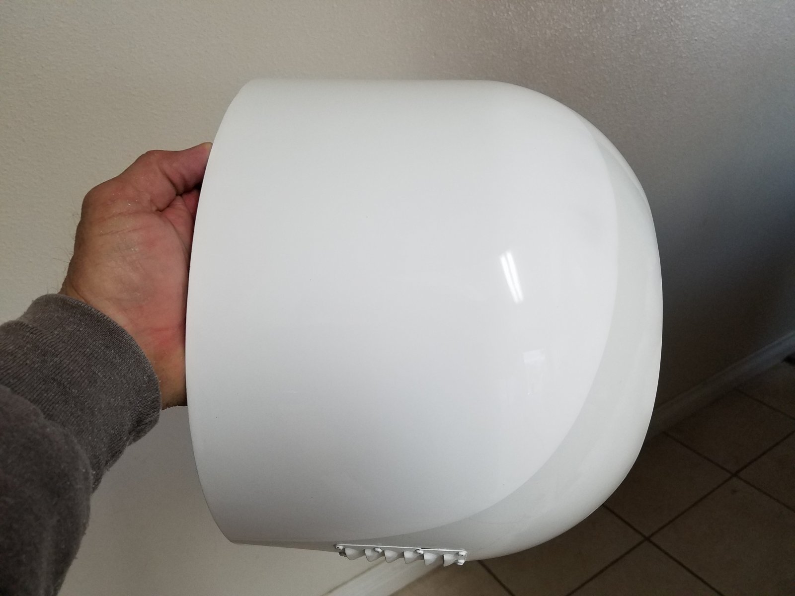

Okie dokie.... so here is my story and I am sticking to it. The photos I posted earlier were of the WingsWestRC White paint that was "supposed" to (1) spray very nicely, (2) match the Ultracote White covering and (3) when dried should give a smooth finish. None of the above happened. First, the nozzle on the can sprayed "clumps", inconsistent and uneven waves of "splattering". See the photo of the concrete below. That would be overspray from the can.
At any rate, I wet sanded the paint back down to a smooth finish and decided to swing by KC Auto Paint to see if they could offer some suggestions. What I was informed was either the paint separated for what ever reason, or the nozzle was defective. At any rate, a total loss of one full small 11.8 oz. can of $25.00 white paint.

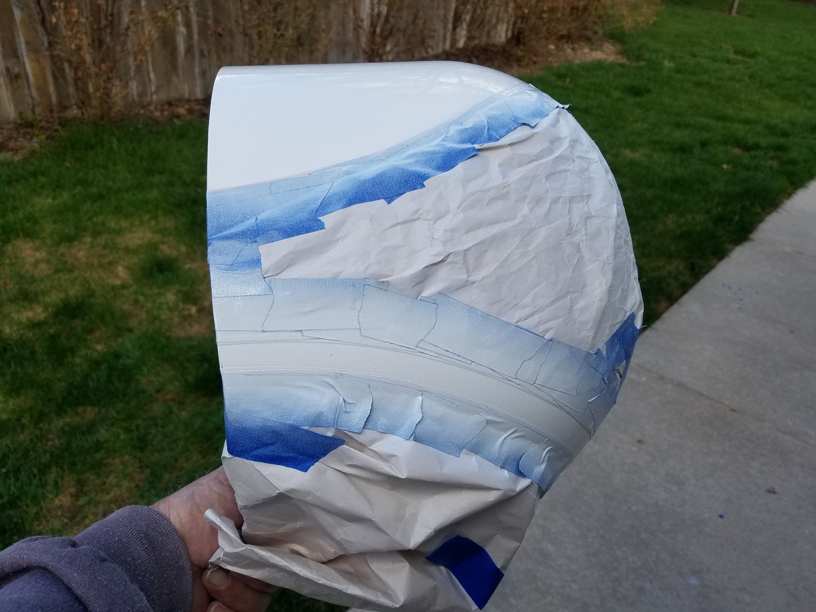

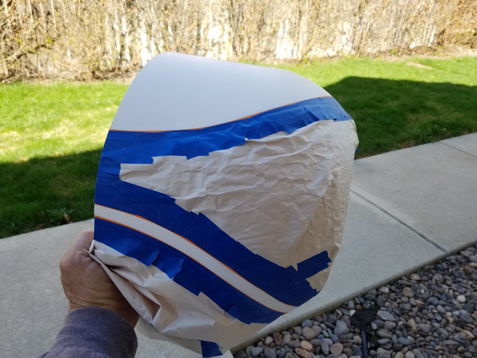

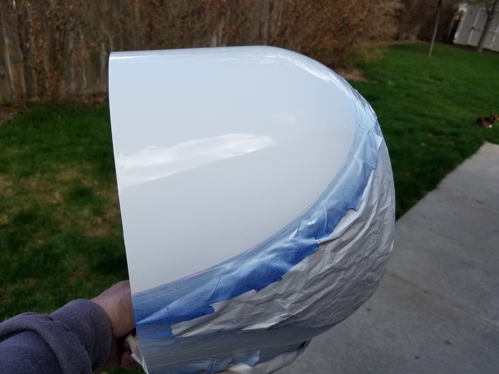

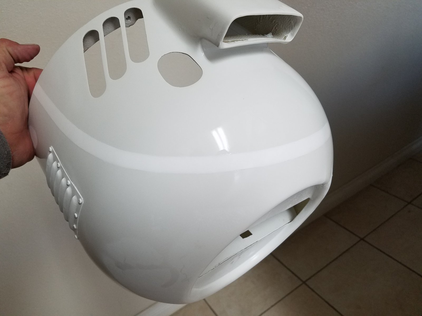

While there, I quizzed Andy about the cooling vent louvers and what would be the best way to get the best results when painting them. He handed me a roll of "fine line" tape. I know @Jetpainter will know exactly what this is. Anyway, back to home I go with the tape and a fresh roll of blue painters tape. After I was satisfied with the finish of the cowl...."AGAIN", I masked her off, papered her off and chose to attempt a real "CHEAP" fix to my paint issue.

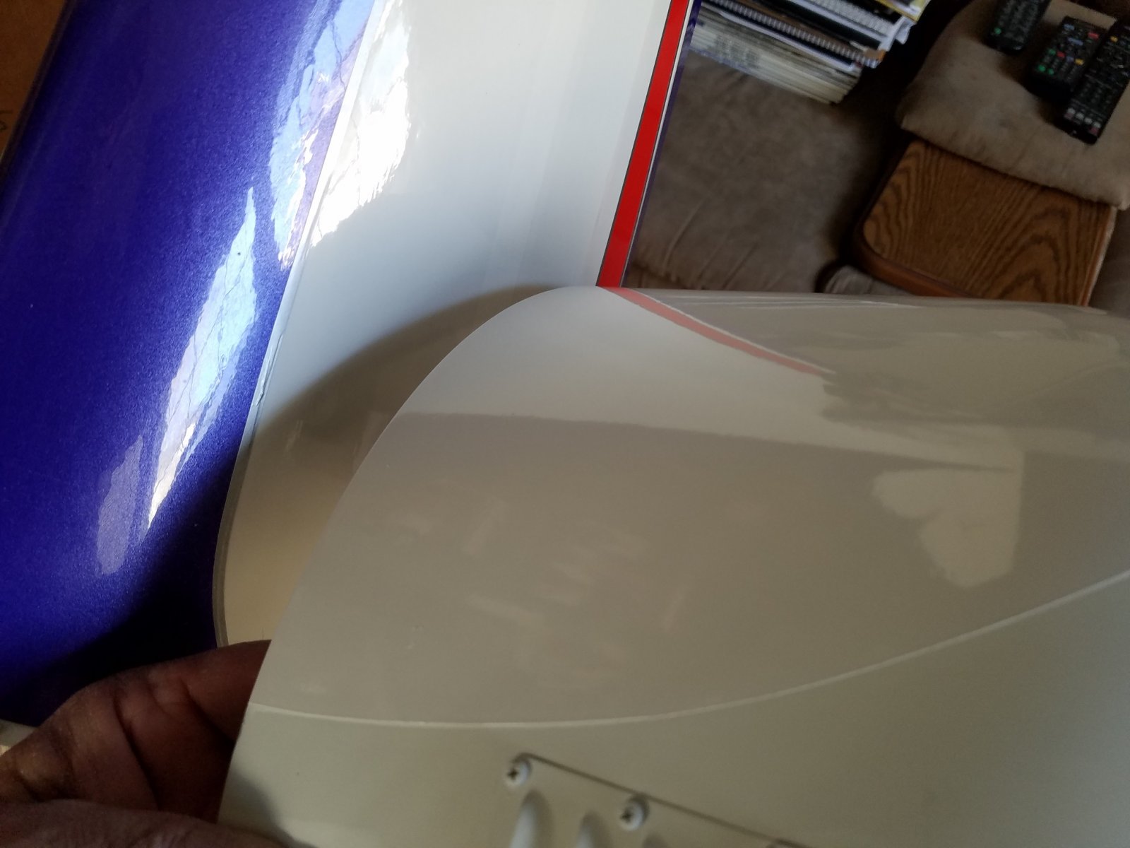

I purchased a $4.00 dollar can of "WHITE" Rustoleum Paint from Home Depot. I matched it the best I could with a scrap of White Ultracote. After trembling at the possible outcome, I shot a first coat and waited for the paint to "melt" off the cowl. It didn't melt off. In fact, the first coat was so much better than the first coats of the WWRC paint that I decided to proceed. After a second coat it looked even better still. And the final covering color "matching" coat was on, I could see that I was going to be very pleased. I waited for about 15 minutes and removed all the paper and tape and what the heck??....It looks really nice. Laid next to the fuse....it is a "spot on" match for color.
I plan to let this cowl sit now for a solid few days before I "EVEN" attempt masking it to shoot the Purple and Red paint. I have huge concern there with that too. Andy at KC Auto Paint did give me some paint cards to use for testing the WWRC paint. So I will shoot each color on the two cards to see how they spray. I can tell you all this...if the Purple and the Red spray anything like my White did....I will not even attempt spraying the cowl. The paint will go back faster than a speeding bullet from a gun.
