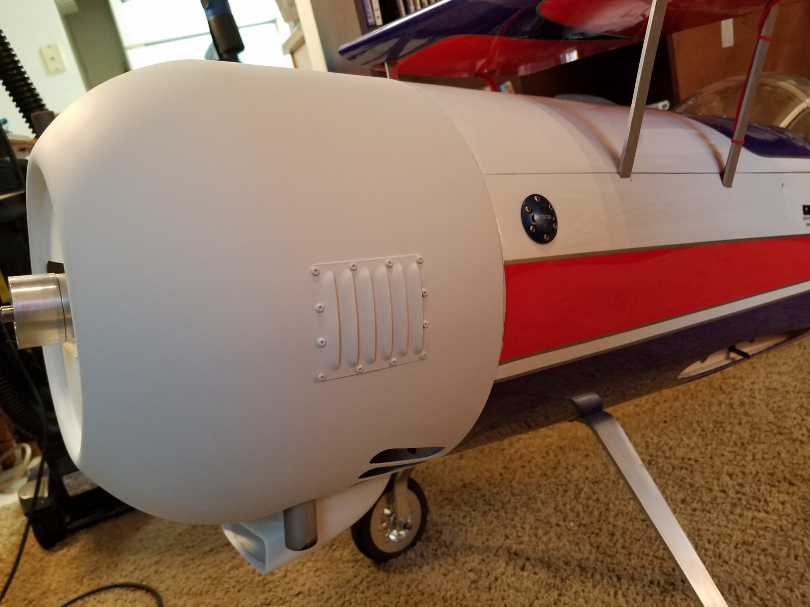

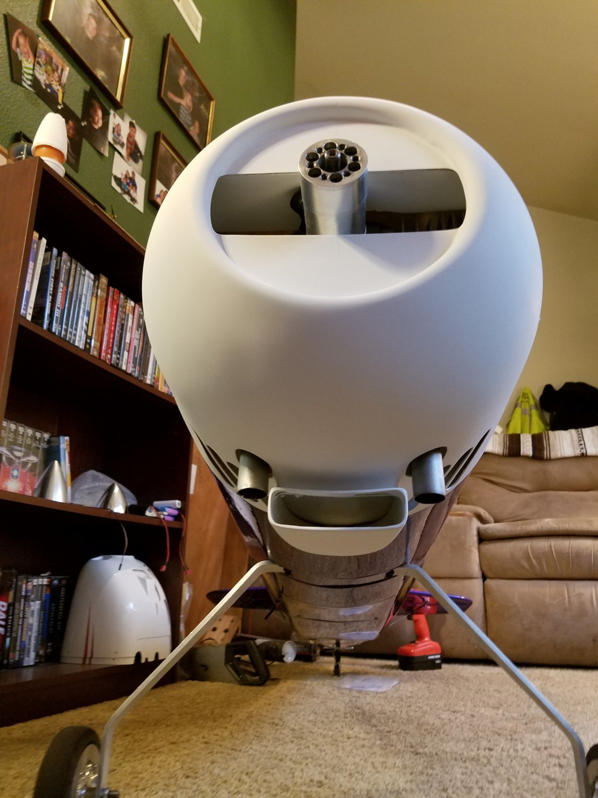

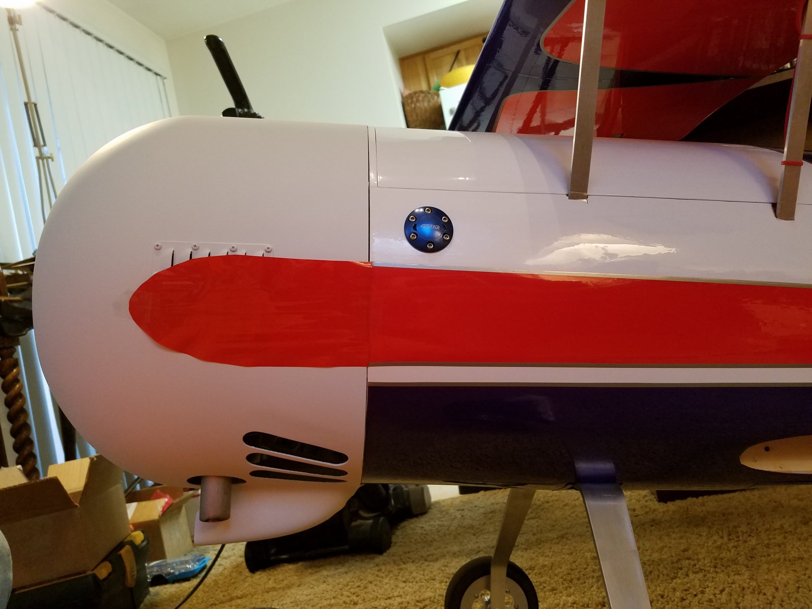

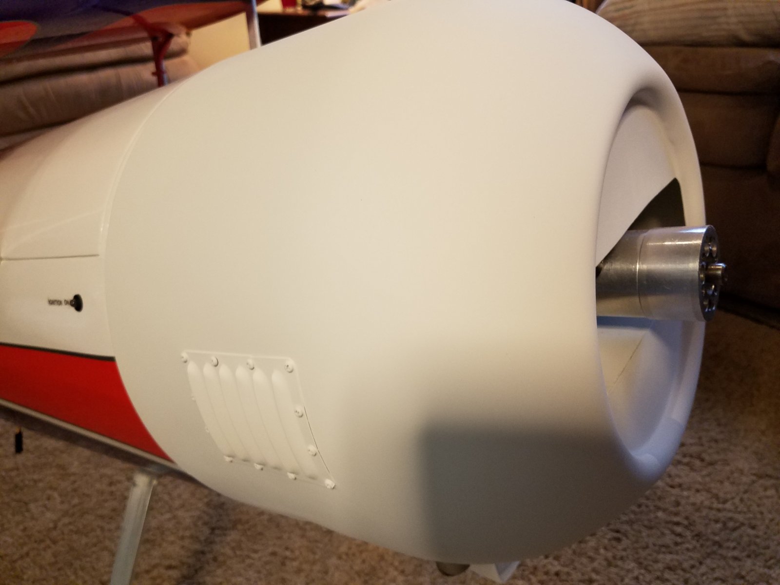

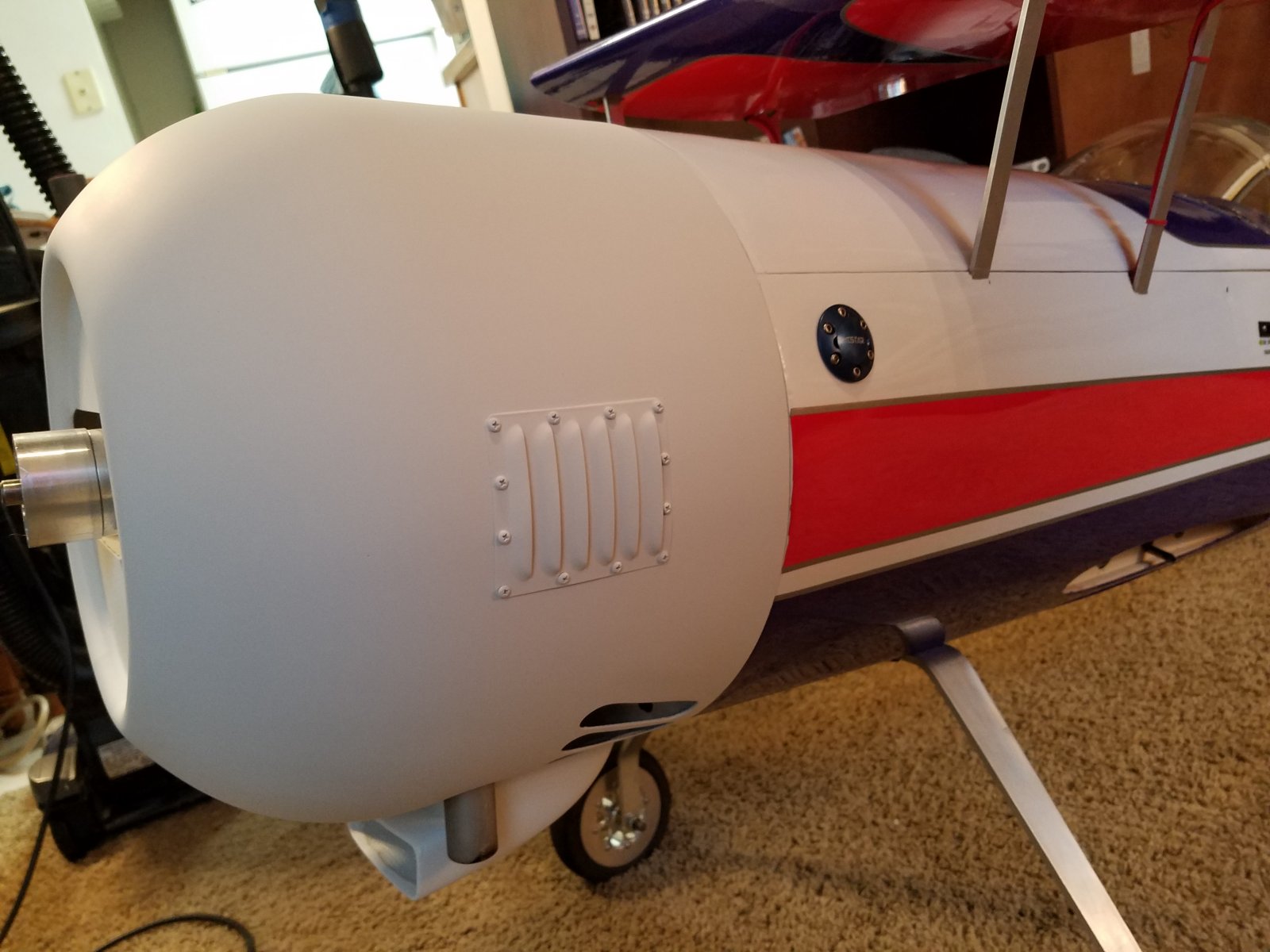

The cowl is very ready for paint. It looks good enough to be proud of it. I mounted it up to the fuse to start drawing out the pattern. First stencil cut. This is not going to be any fun at all. I am afraid to use tape to outline the break between colors. Do any of you have suggestions?

All I know is that it is going to be very difficult to Mask the louvres and prevent overspray. I believe you need to make the louvres one colour if you can.

We've been going crazy in the shop with other projects so this is the first I have seen the work on the cowl. First I am sorry about all the pin hole in the cowl you never see them until you hit it with that first coat of paint and every cowl is different.
I do really like the way you did your venting and of course the whole freeking plane is a work of art!!

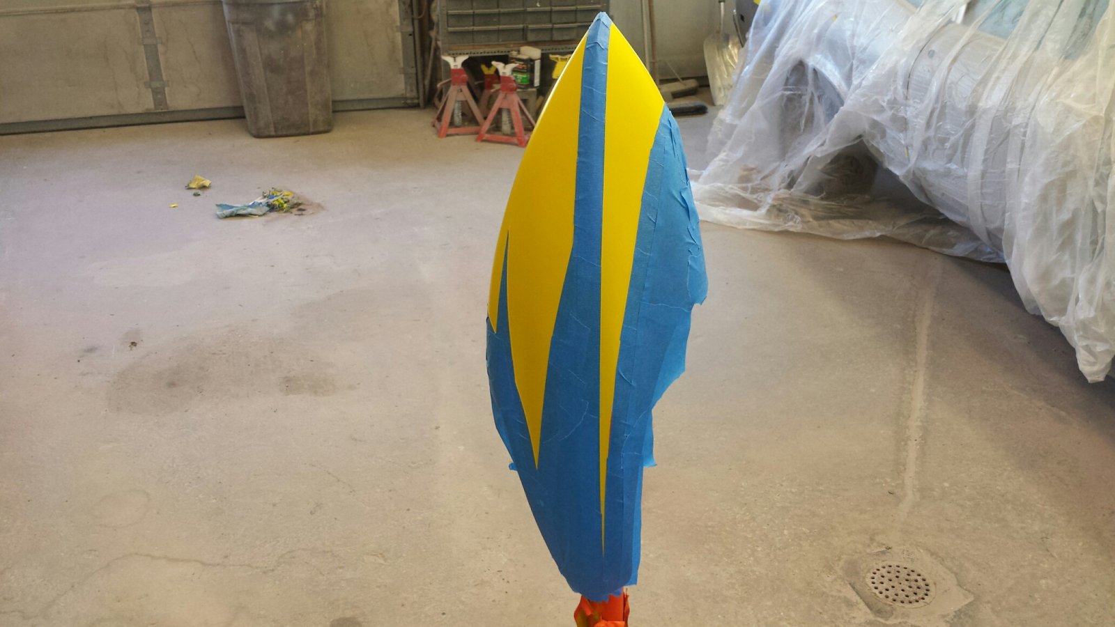

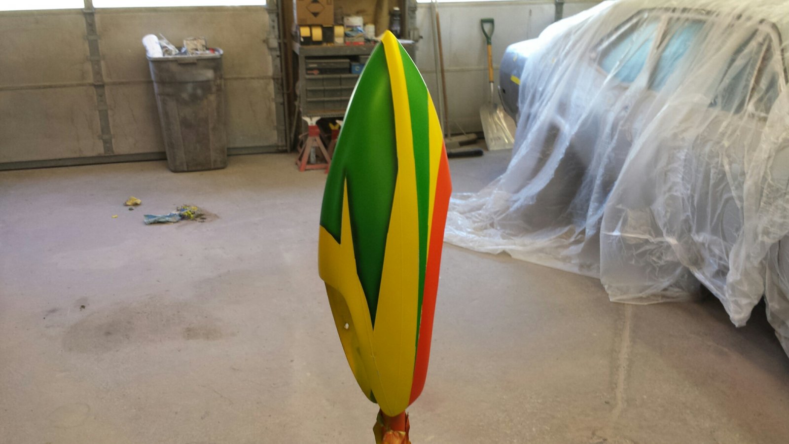

Hey Rob,
I'm afraid @Snoopy1 is right. Doing two colors on the louvers is going to be a giant PITA. Maybe you can flair the red out on the top and bottom just enough to cover the top of the louver with red.
One trick I've read about is shoot some clear along the edges of your stencils between colors so you don't get paint bleed under your stencils.

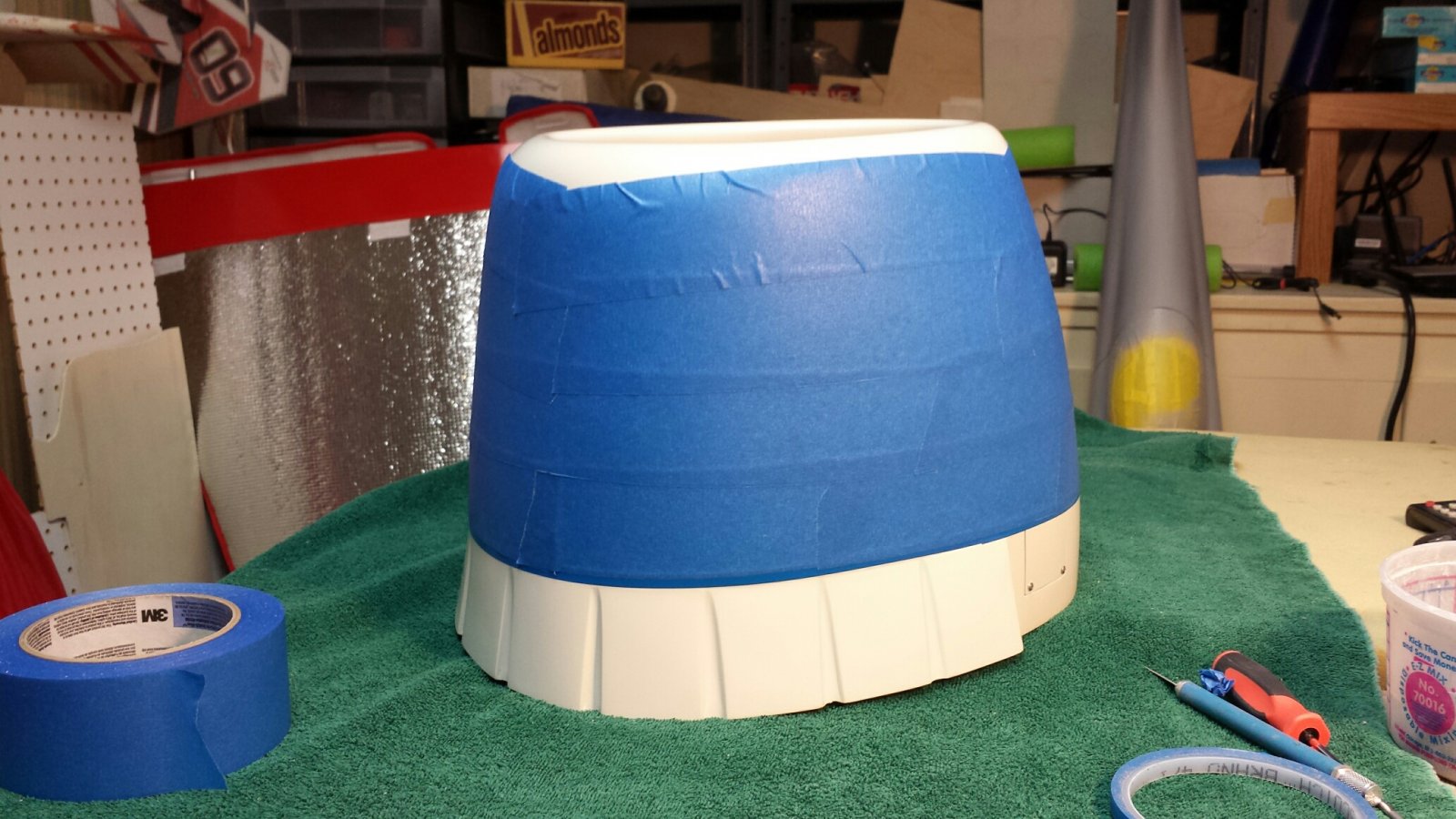

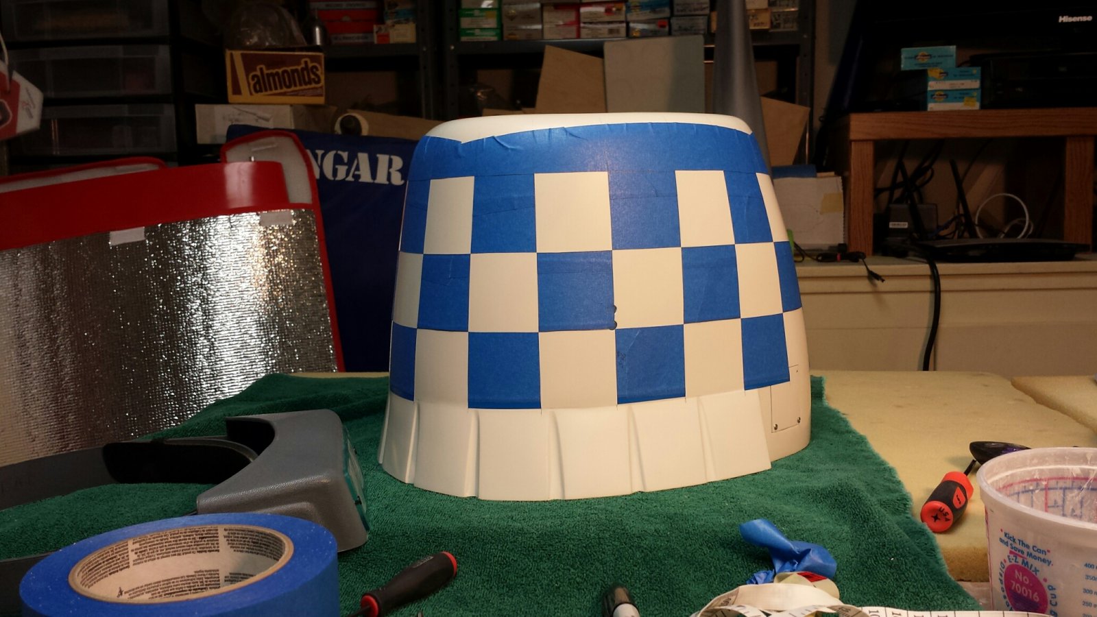

You could cover the area in question with 2" masking tape, then draw your pattern and cut it with an Xacto. I did that with the checkers on the cowl on mine. I painted it white first than masked, drew and cut out the checkers. But that would depend on weather or not you paint the silver or use vinyl stripe tape. If I was painting the silver I would paint that area silver first then use Fine Lines tape where you want it to stay silver, then you use that masked outline for all the other colors.
