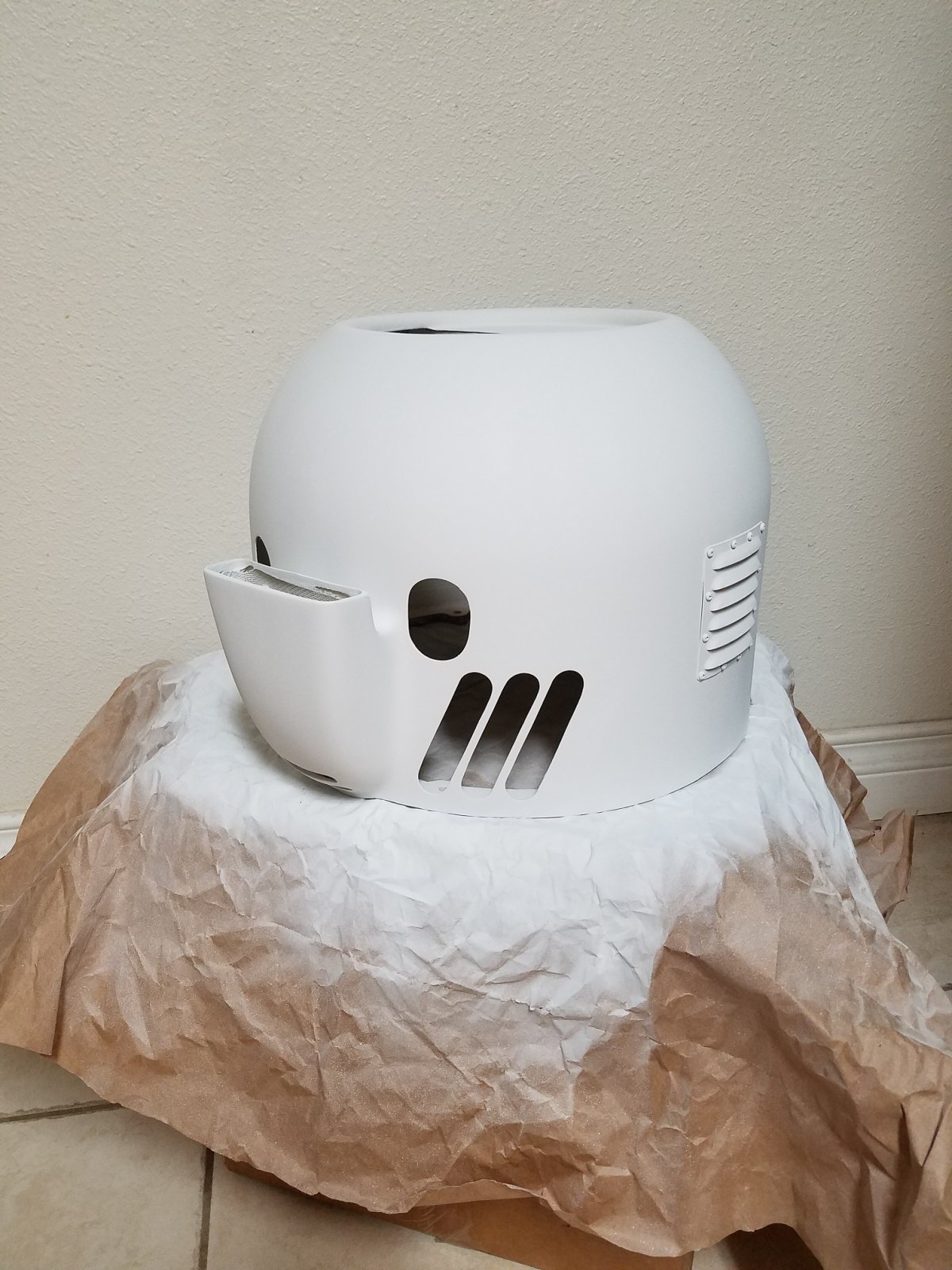

A little progress today after work. First, the paint from Wingswest arrived today. Goofy danged mail carrier "STUFFED" the package inside my mail box. Surprised it even fit. I got it out, but it was interesting to say the least.
I also sanded the last of my touch ups on the cowl. Yes, I think it will be just fine. I am going to let it sit over night and then tomorrow evening, I will do a final wet sand with 600 grit. I want that surface to be as smoooooth as a babies hinnie. I still need to mask off the canopy/hatch. So the actual painting processs will probably not take place for a few days. I will update everyone when I get to that point.
I actually am quite pleased so far. This is very doable for me. Even as anal as I can be from time to time. Stay tuned everyone. We're in the home stretch now.
