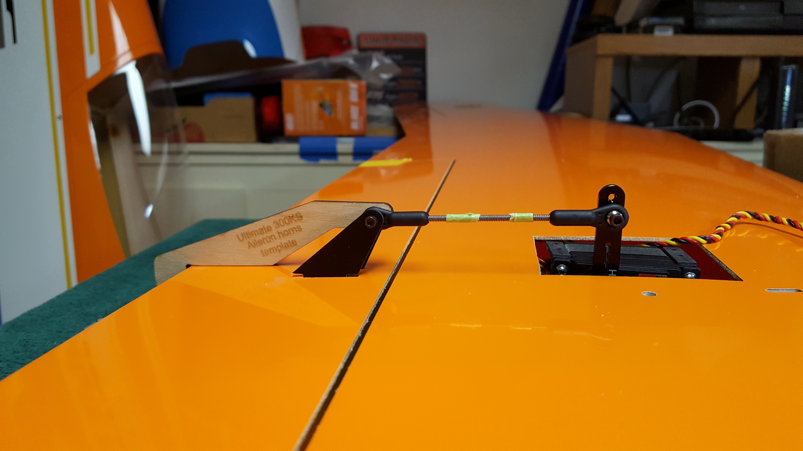

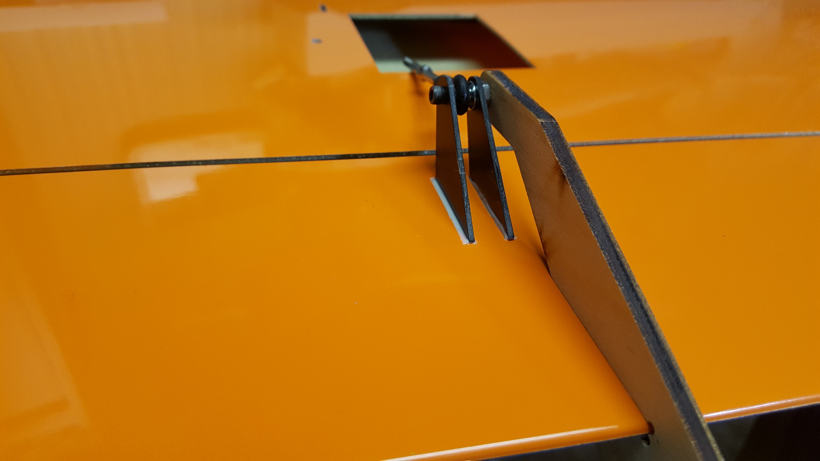

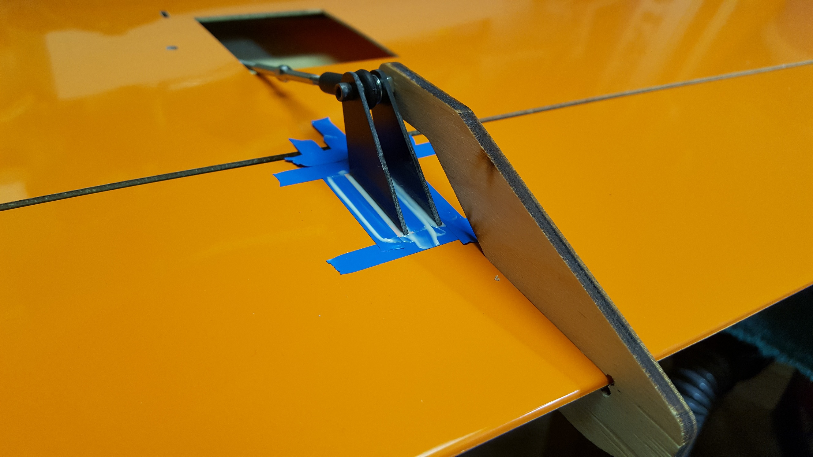

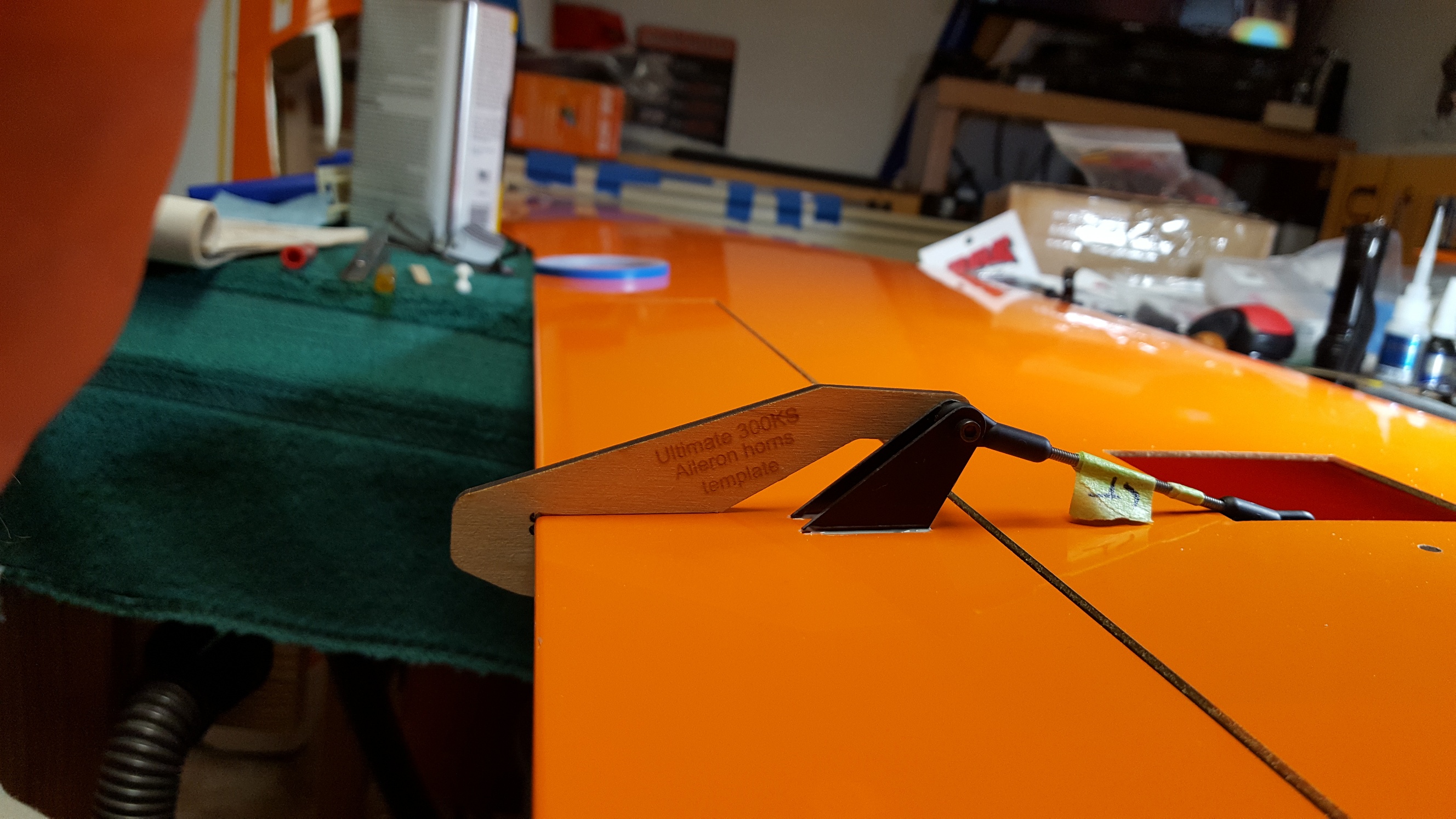

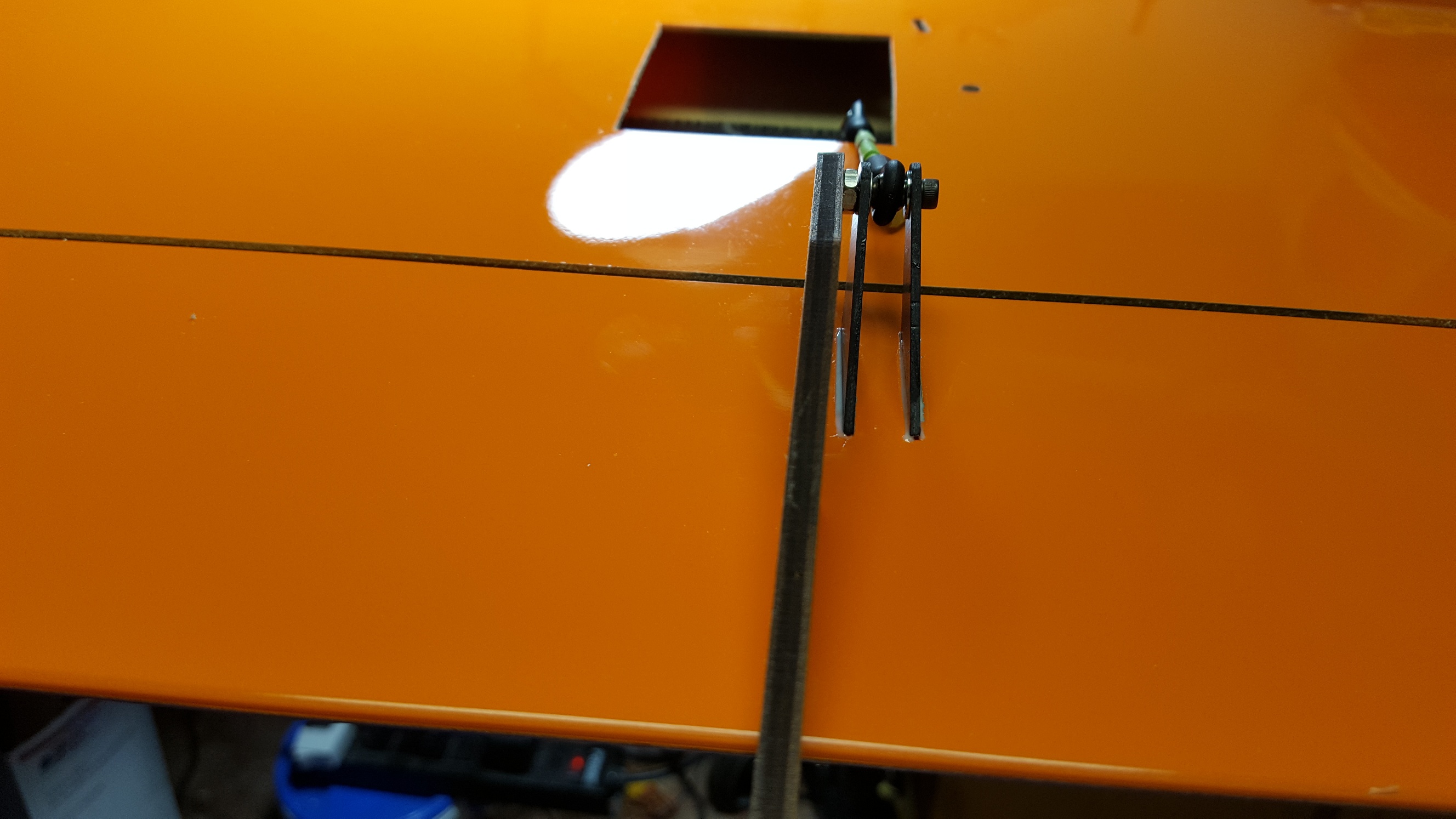

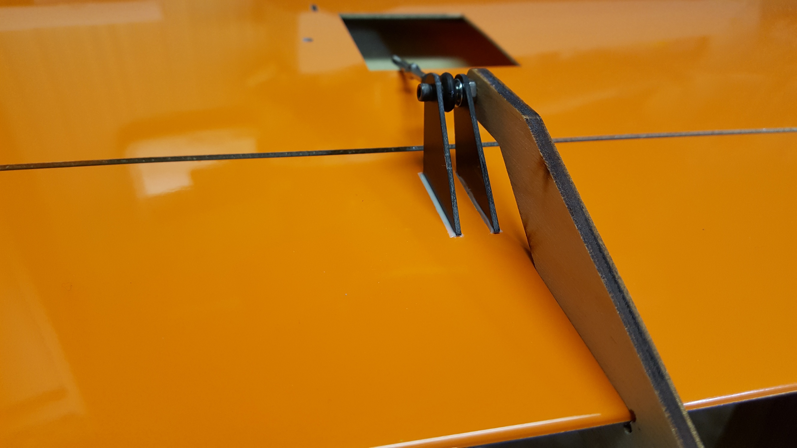

Not a lot got done in the last couple of days. A lot of staring and planning and figuring on the aileron servo mounts. I did get the control horns glued in the top wing.

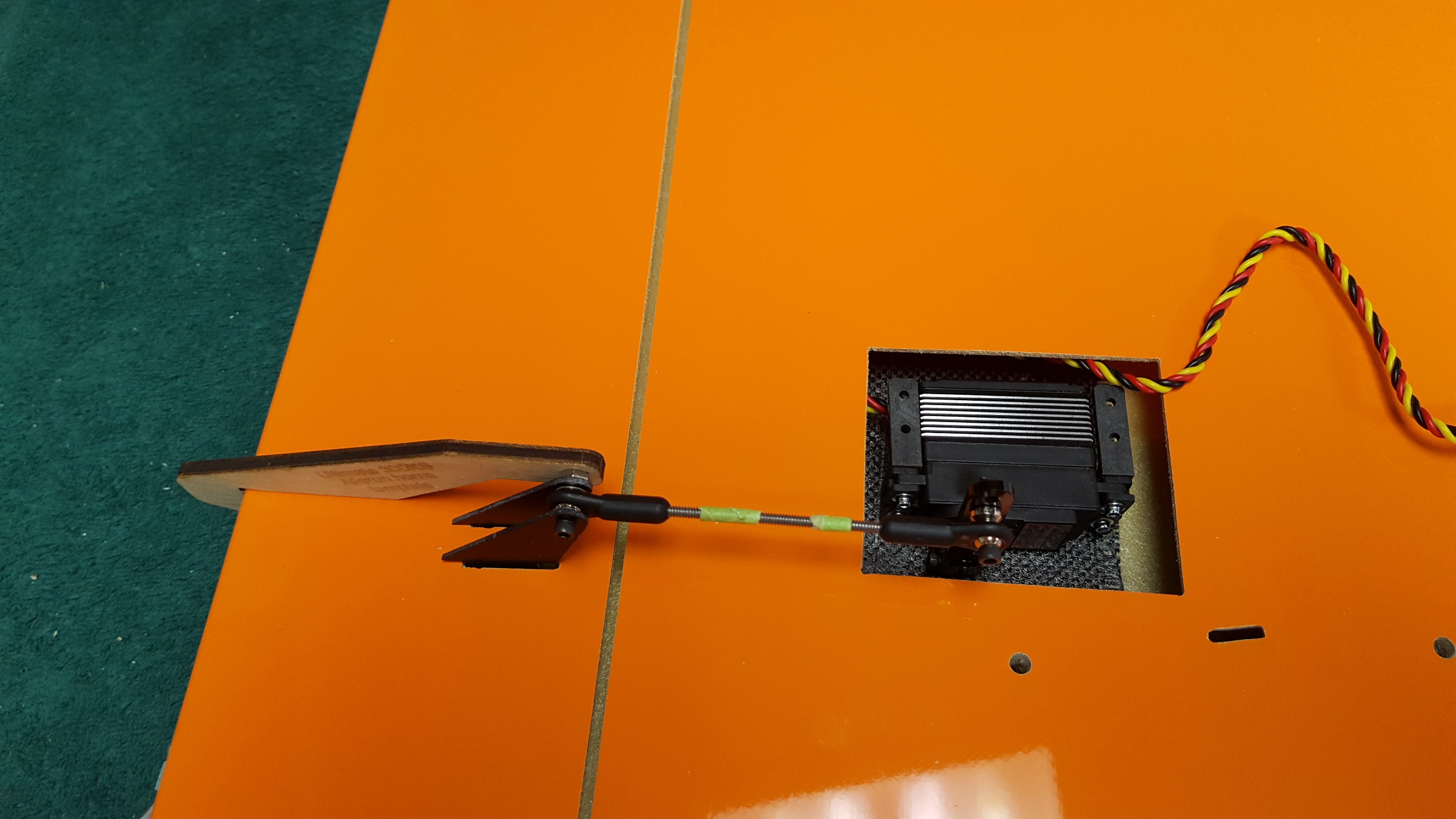

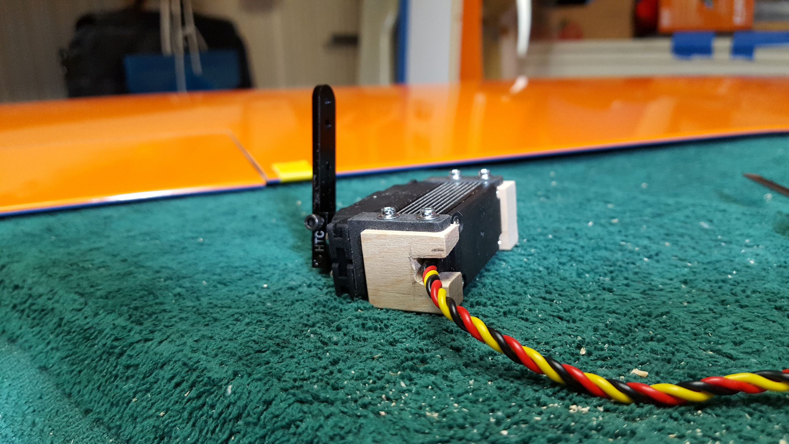

Looking at the servo in the wing how is it held down in the wing and how do get to the servo screws that hold the servo to the mount.

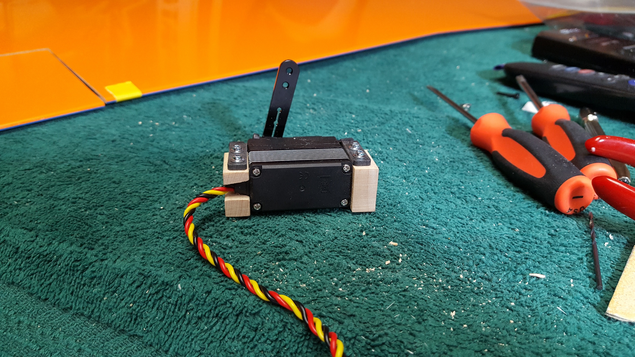

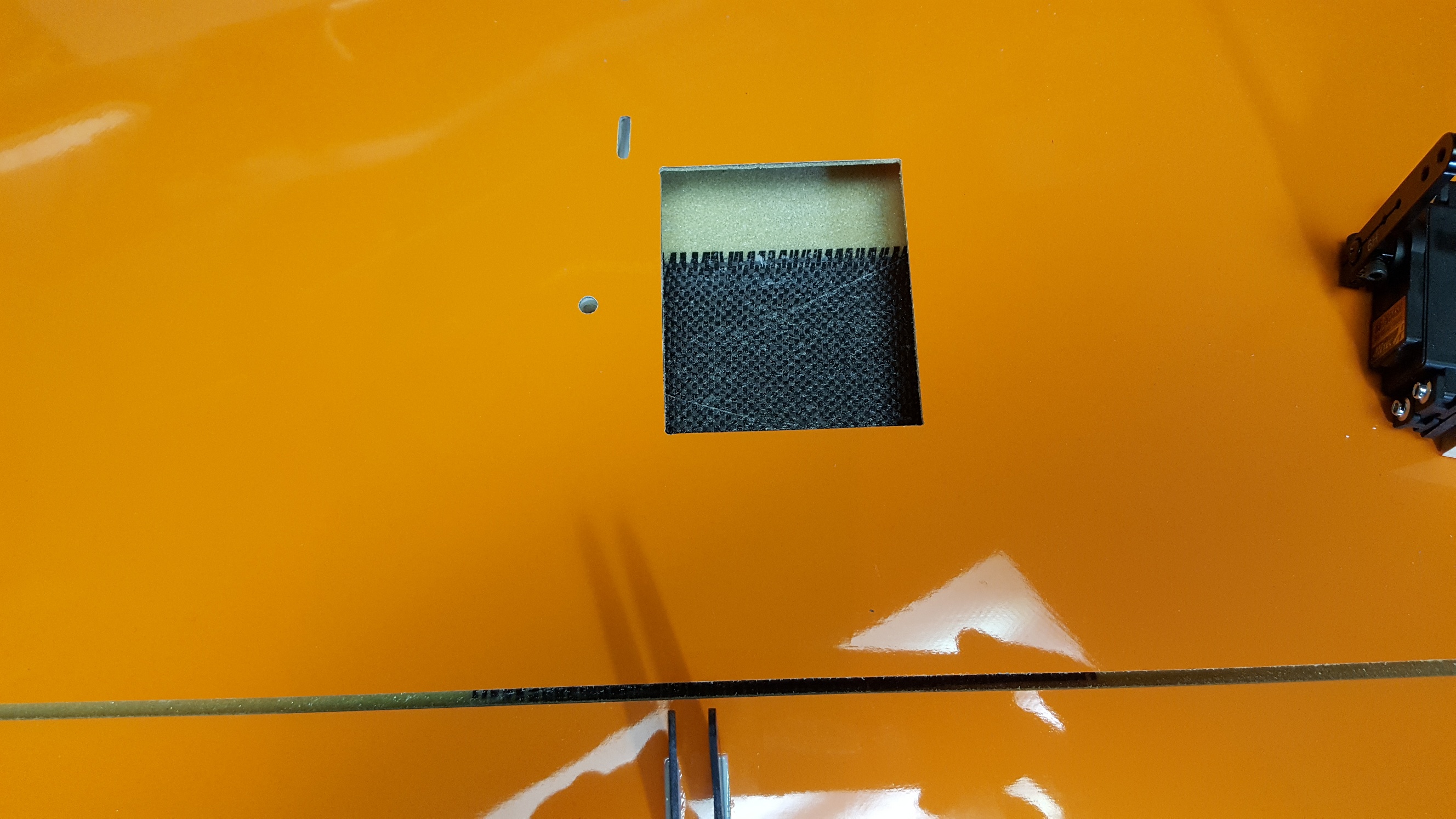

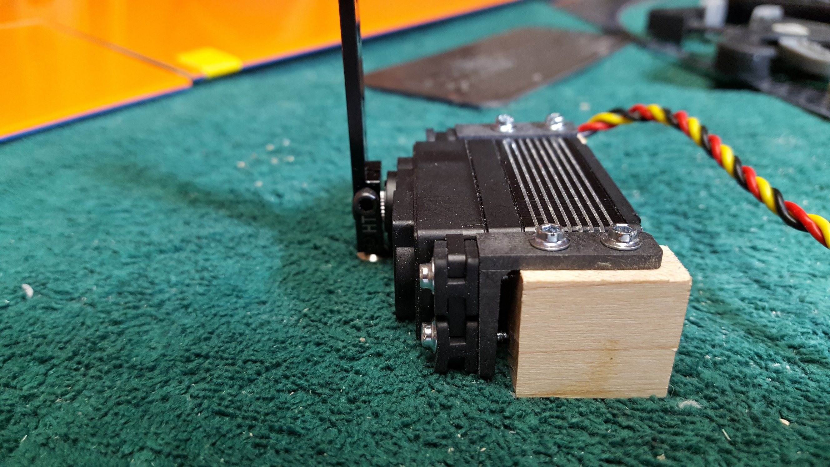

I'm going to use some Bob Violett aileron servo mounts. They have carbon fiber L brackets that screw to maple blocks. The hard part is the servo wires. There needs to be a notch in the block for the wiring, which doesn't leave you a lot of room for one of the screws. You also need enough room to be able to get the servo out of the mount past the wire.
I'm planning on gluing the blocks to a carbon fiber plate, then gluing that plate to the wing skin. There is carbon fiber in the wing there already, but it doesn't cover the whole area where the mount will be glued.

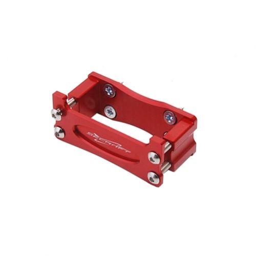

I have used this one once from Secraft. Little more gluing area on the bottom plate and the servo wire is not a problem, just a suggestion.
View attachment 106803 View attachment 106804 View attachment 106805 View attachment 106806
Nice solution to the problem. :way_to_go:
