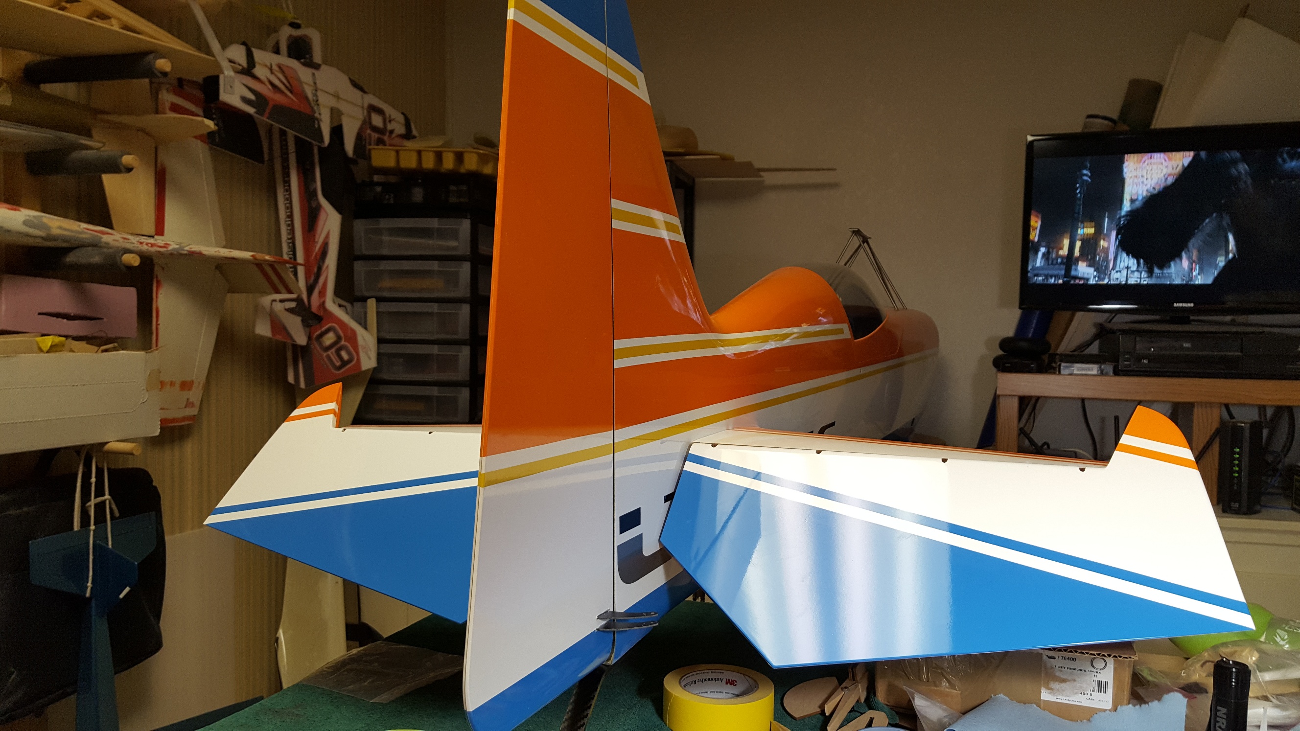

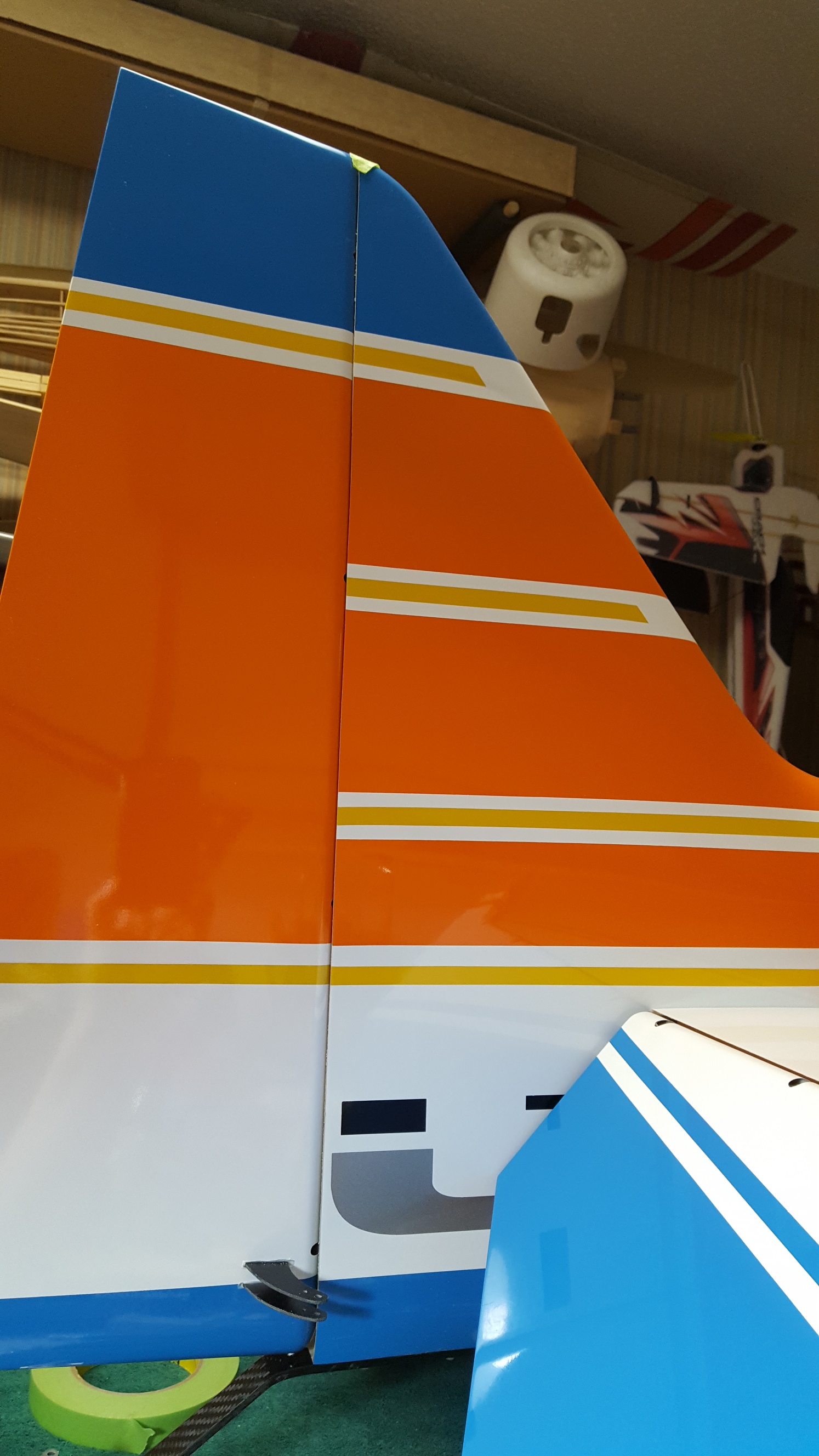

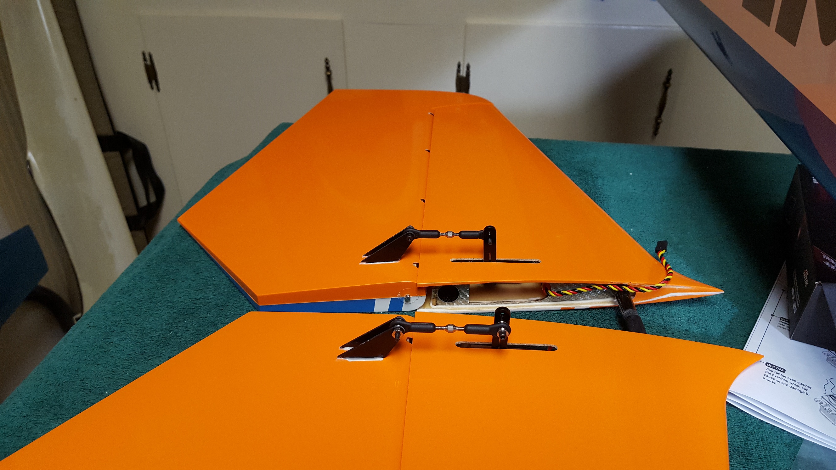

Well despite my best efforts the rudder actually fits! It has about 45 degrees of travel just like the elevators so that worked out okay.

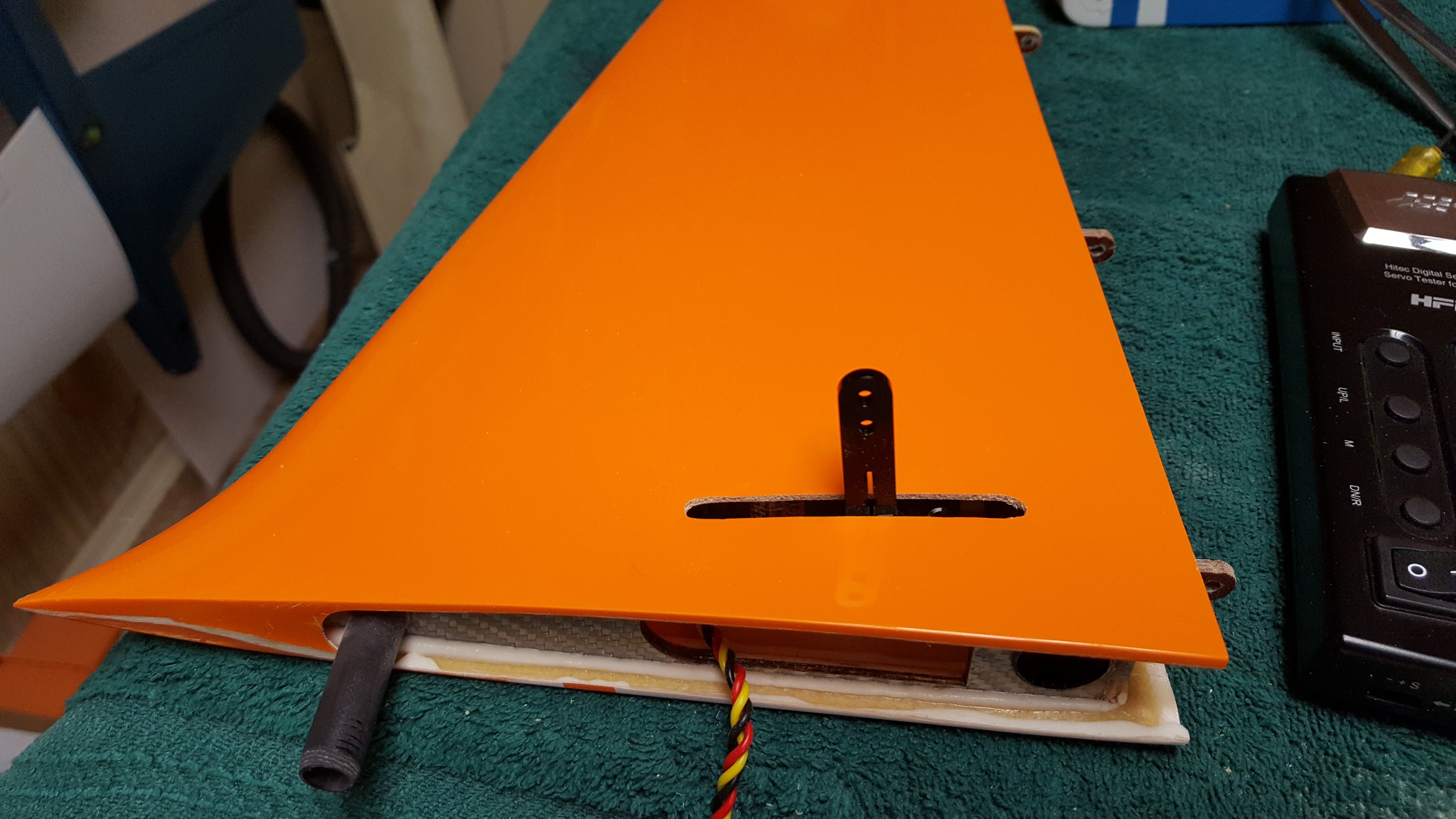

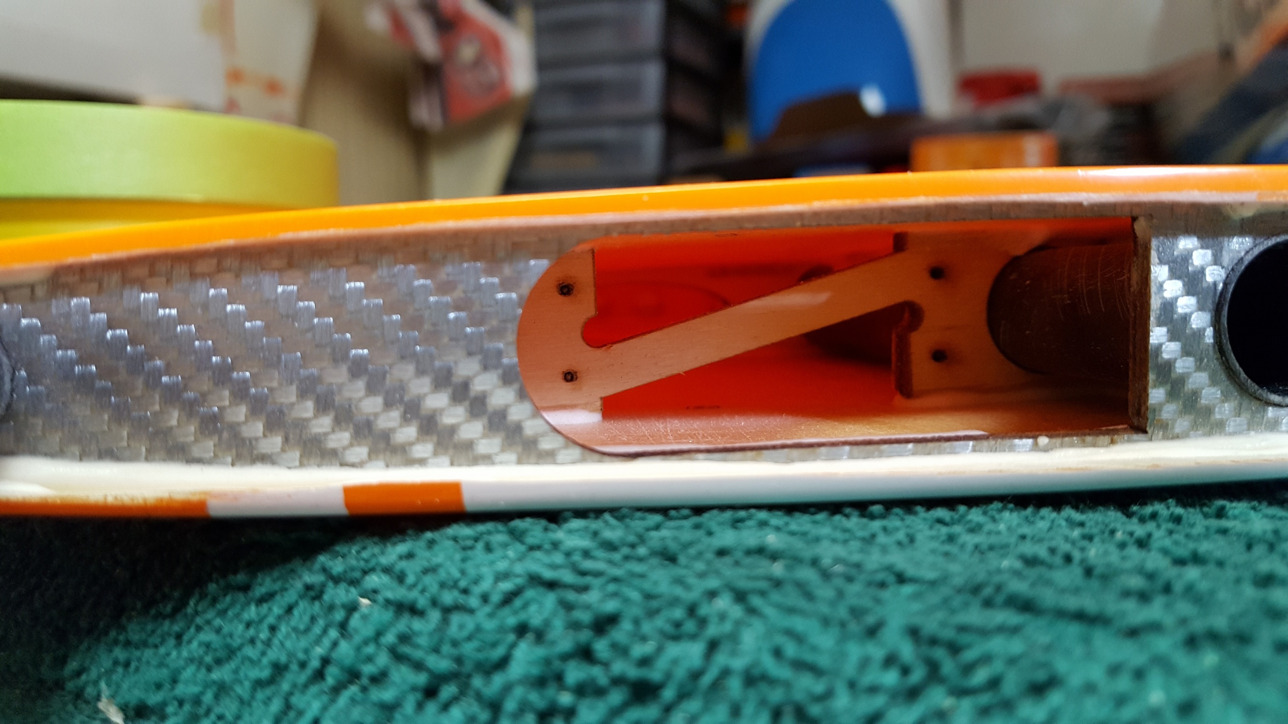

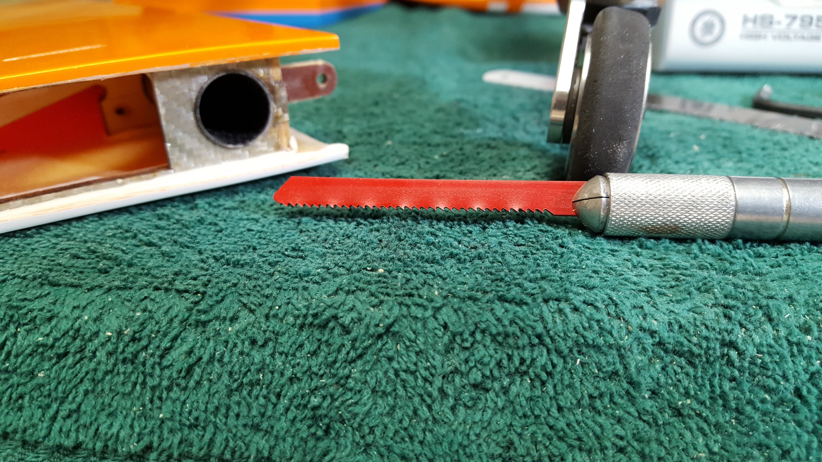

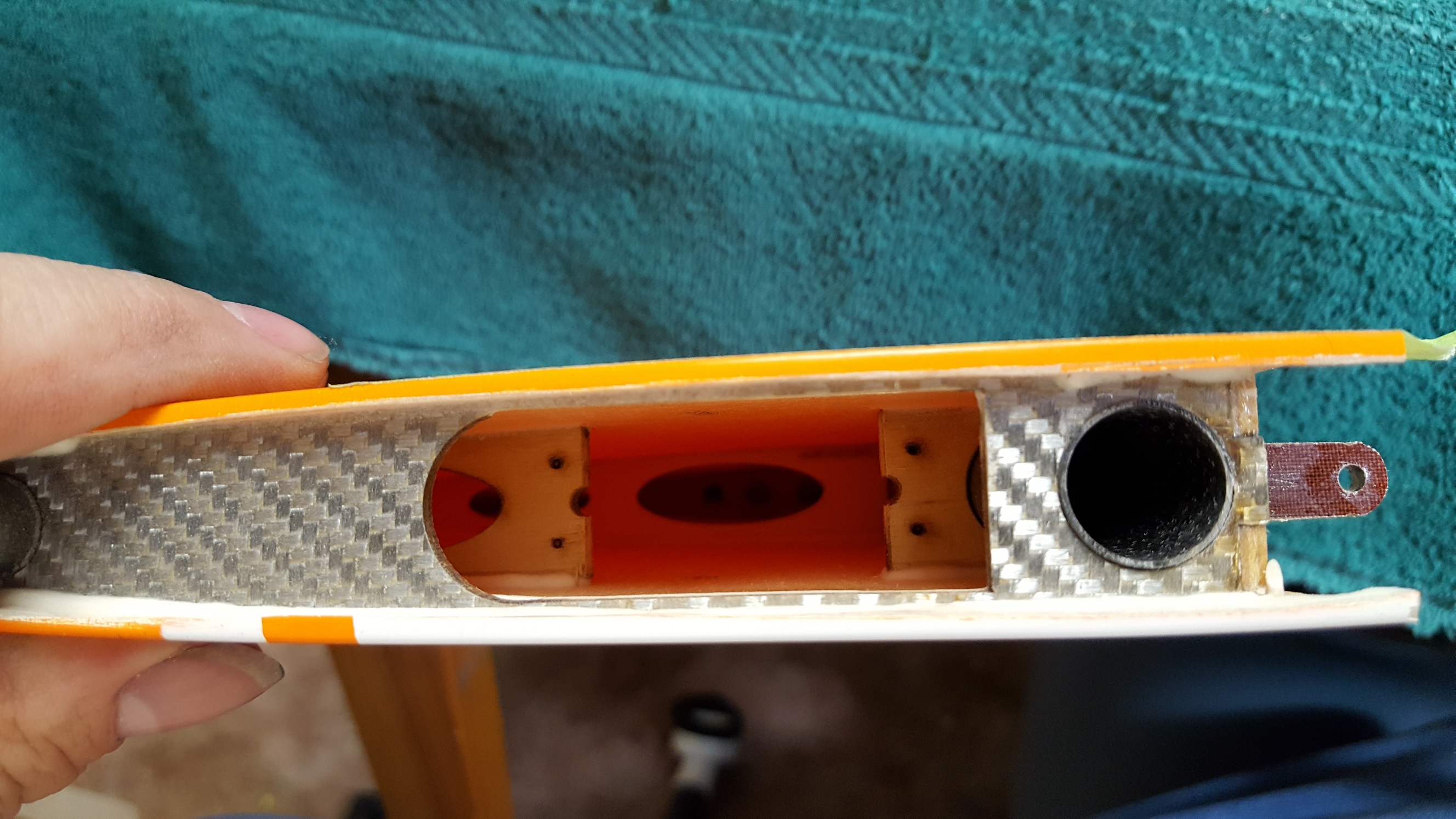

Before I quit last night, I started prepping one of the stabs for it's servo. I had to cut out a ply brace over the servo hole. I put a jig saw blade in a knife handle. It worked well.
View attachment 106569 View attachment 106570
View attachment 106571 View attachment 106572 View attachment 106573
Good idea on the saw blade. The rudder looks perfect. Looking at the photos the plane looks like it is well built. Is the rudder not missing some stripping.
Good idea on the saw blade. The rudder oooks perfect. Looking at the photos the plane looks like it is well built. Is the rudder not missing some stripping.
Believe it or not that us the way it's supposed to look. It is missing the letter U from one side and E from the other, and the stripes don't line up and they're not straight, but none are missing. That is a result of being a replacement fuselage. The plan is still to repaint it.

saw
Well despite my best efforts the rudder actually fits! It has about 45 degrees of travel just like the elevators so that worked out okay. Before I quit last night, I started prepping one of the stabs for it's servo. I had to cut out a ply brace over the servo hole. I put a jig saw blade in a knife handle. It worked well.
I have one of the Excel saws with only one blade left but have a box full of jig saw blades. Great idea or tip!!! Thanks!!!

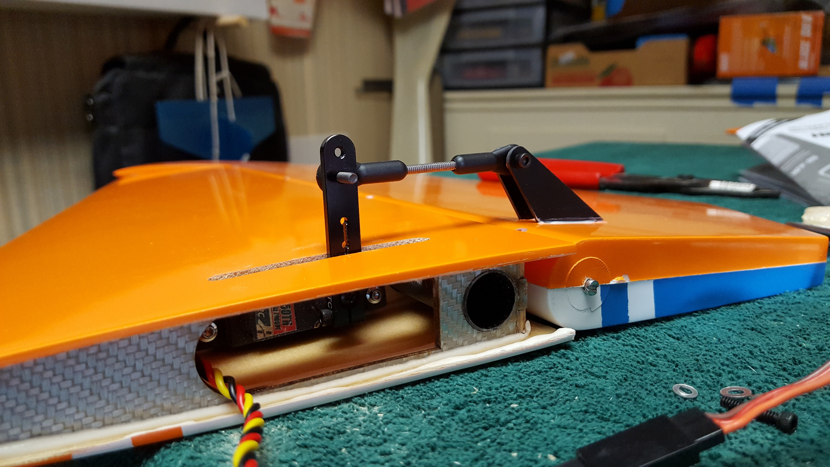

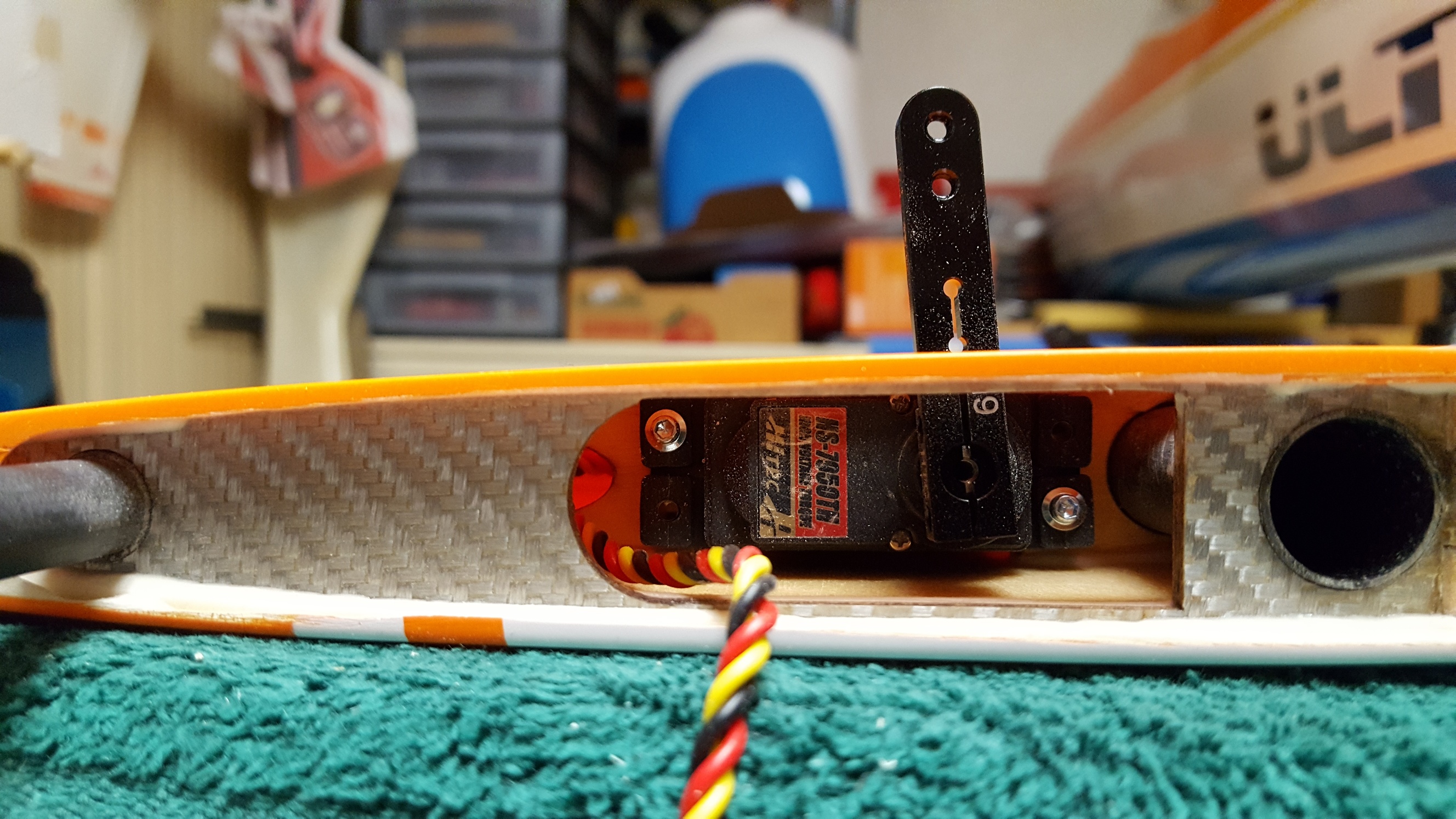

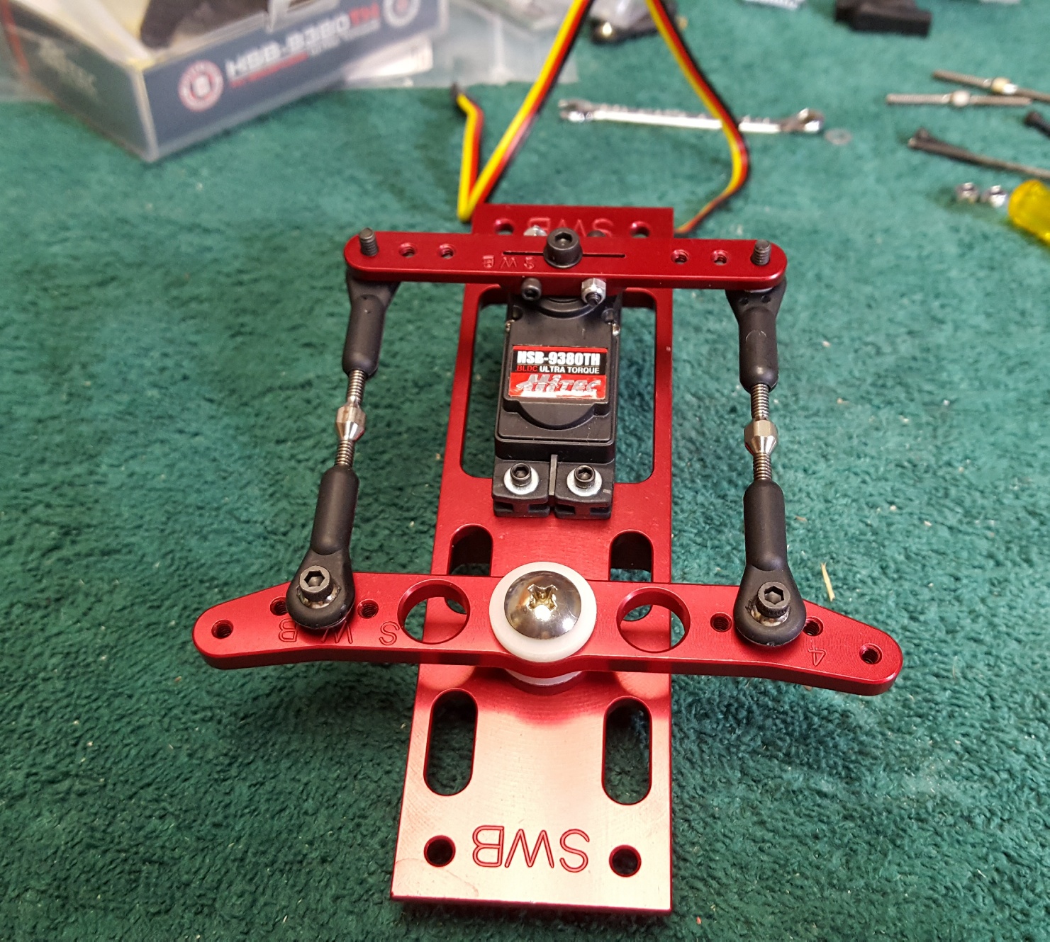

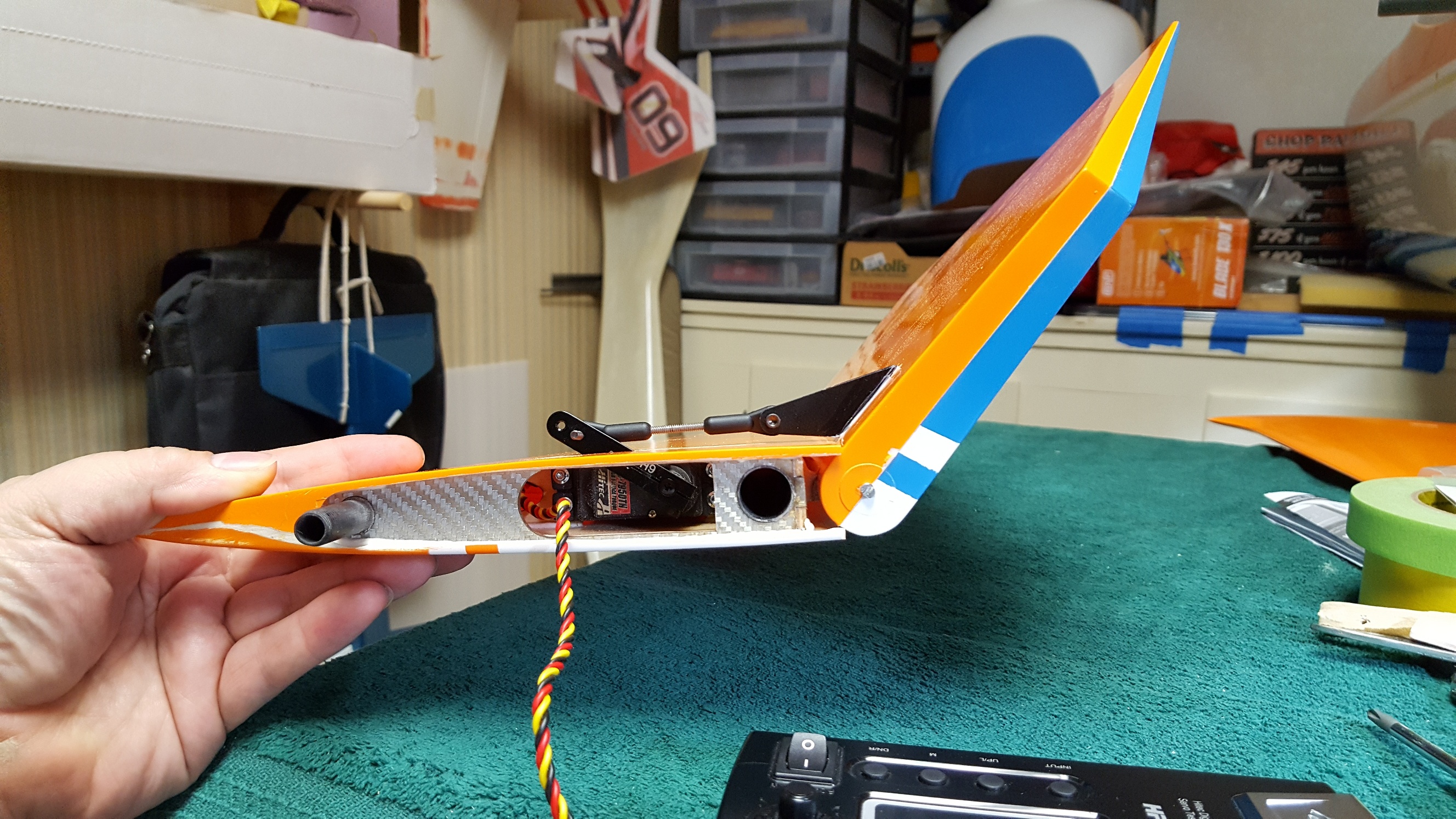

I've been working on one of the elevators, test mounting the servo and checking to see if the recommended servo arms and turnbuckles we have are correct. It turns out they're both wrong. I'm getting the maximum throw in the 1 1/4" hole of a 1 1/2" arm, and I need a 1 1/2" turnbuckle, not a 2".
Turning the servo around would solve the turnbuckle length, but the slot would be wrong. Some of the slot was precut so it was obvious which way they wanted the servo. Plus I have Krill pictures that show it this way.
Hopefully the throw is good enough.
