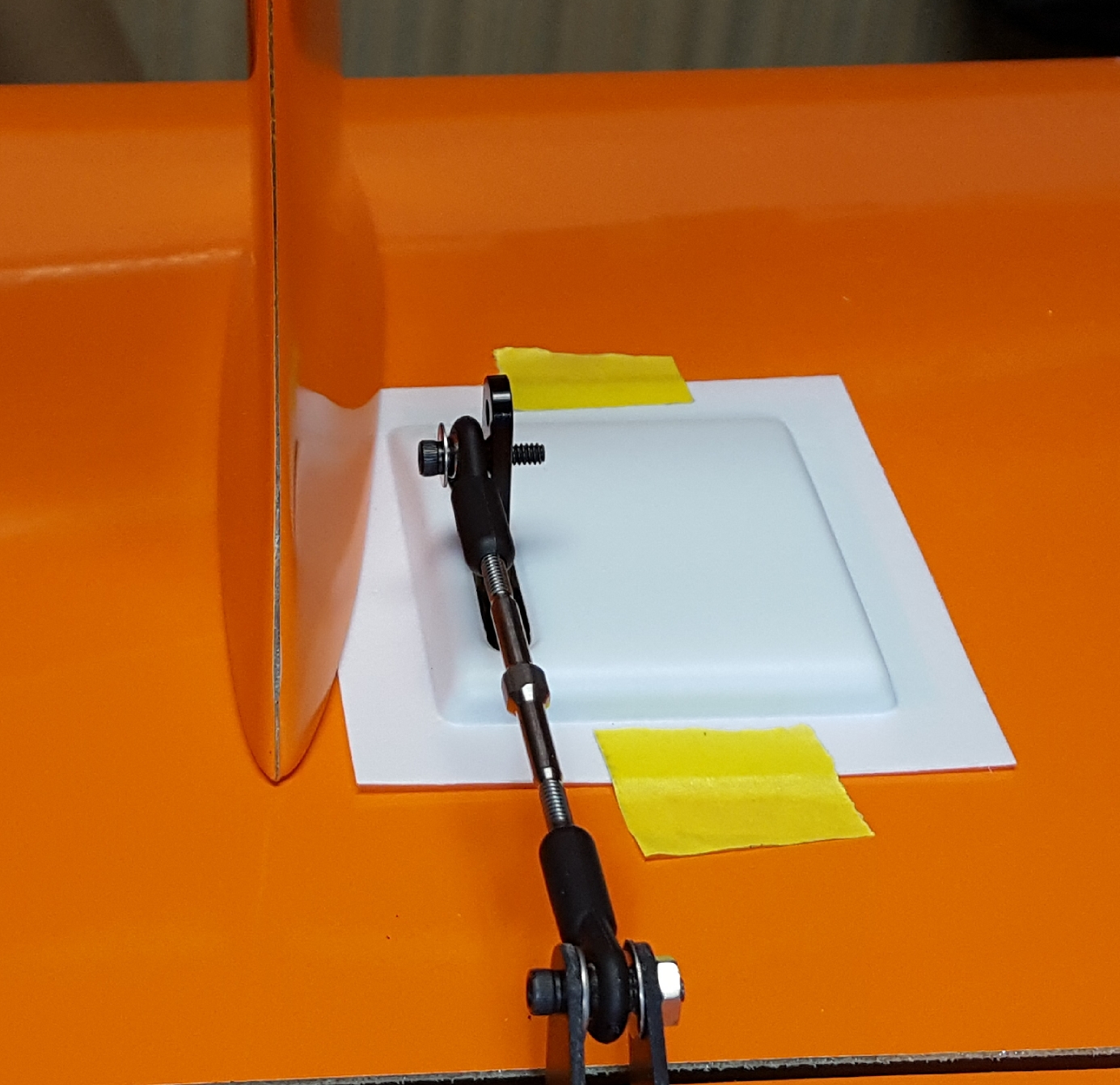

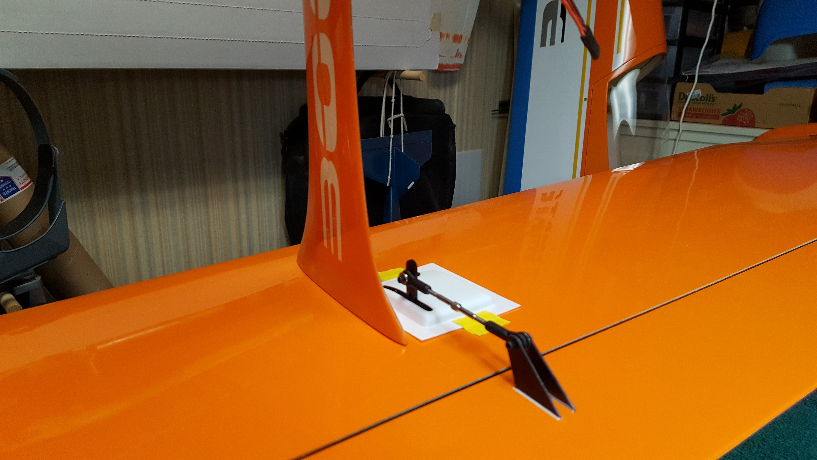

I decided to test and see just how bad the servo cover for the upper wing and the wing strut interfere with each other. It will work if I trim it, but I wish they would have put a bit more thought into it.
View attachment 107104 View attachment 107105
All of the servo wiring for the top wing is completely hidden. It goes through the bottom wing, up through the outer strut, and into the top wing. The problem with that is you'll need to feed the wire through the strut every time you assemble it. I think I'm going to take a piece of carbon fiber rod I have and attach a servo plug to the end with shrink tubing. It should be easy to feed that through the strut then plug it into the lead from the bottom wing, then pull it right through. That's the plan at this moment anyway.
Not quite sure what they were thinking when they designed it that way. My guess is they weren't thinking at all. But I know you'll make it work and look great in the process.

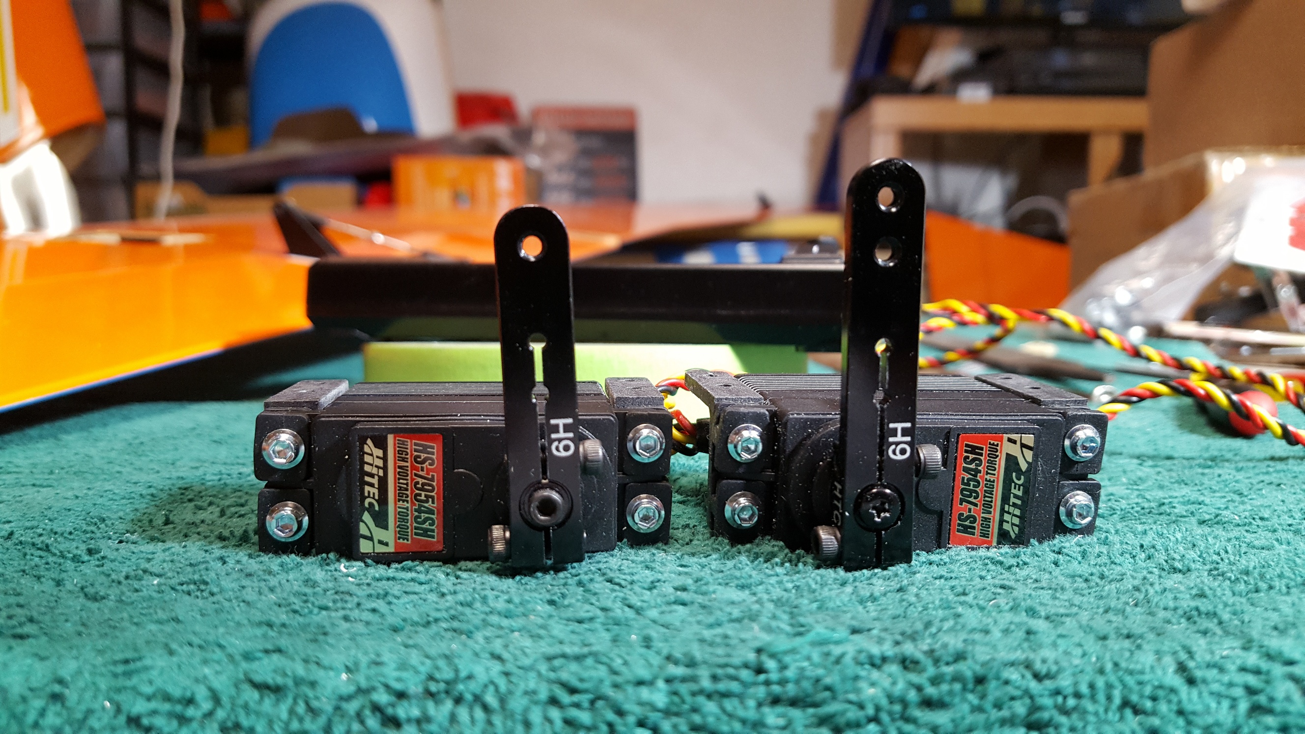

Yesterday after the glue on my wing skin reinforcements was hard I temporarily installed the servos in the top wing and tested them. There is no more flex on the top wing skin. Before I installed the servos I shortened the servo arms to 1 1/4". It only takes a few minutes and it looks so much better than part of the arm sticking up past the ball link.

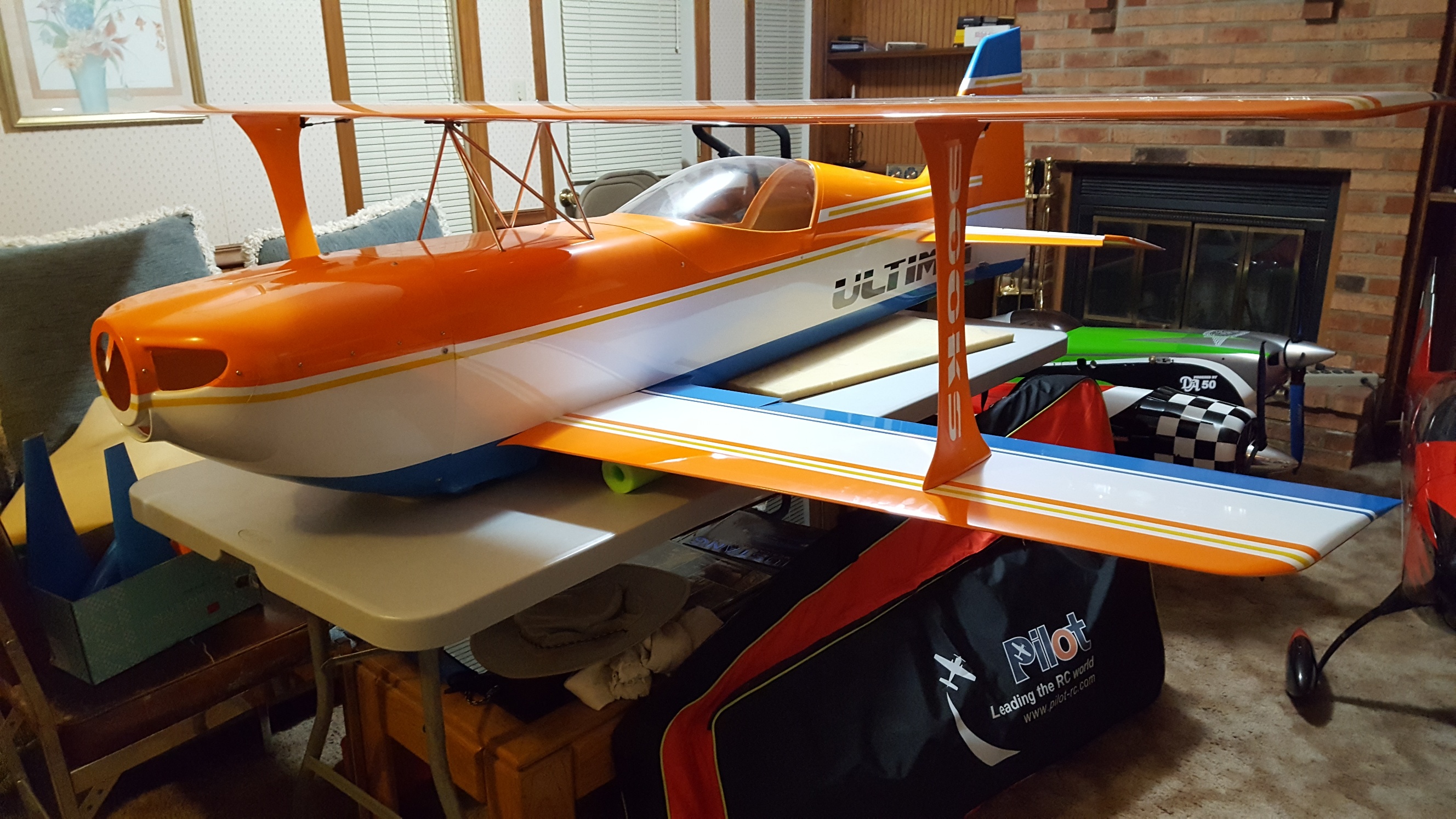

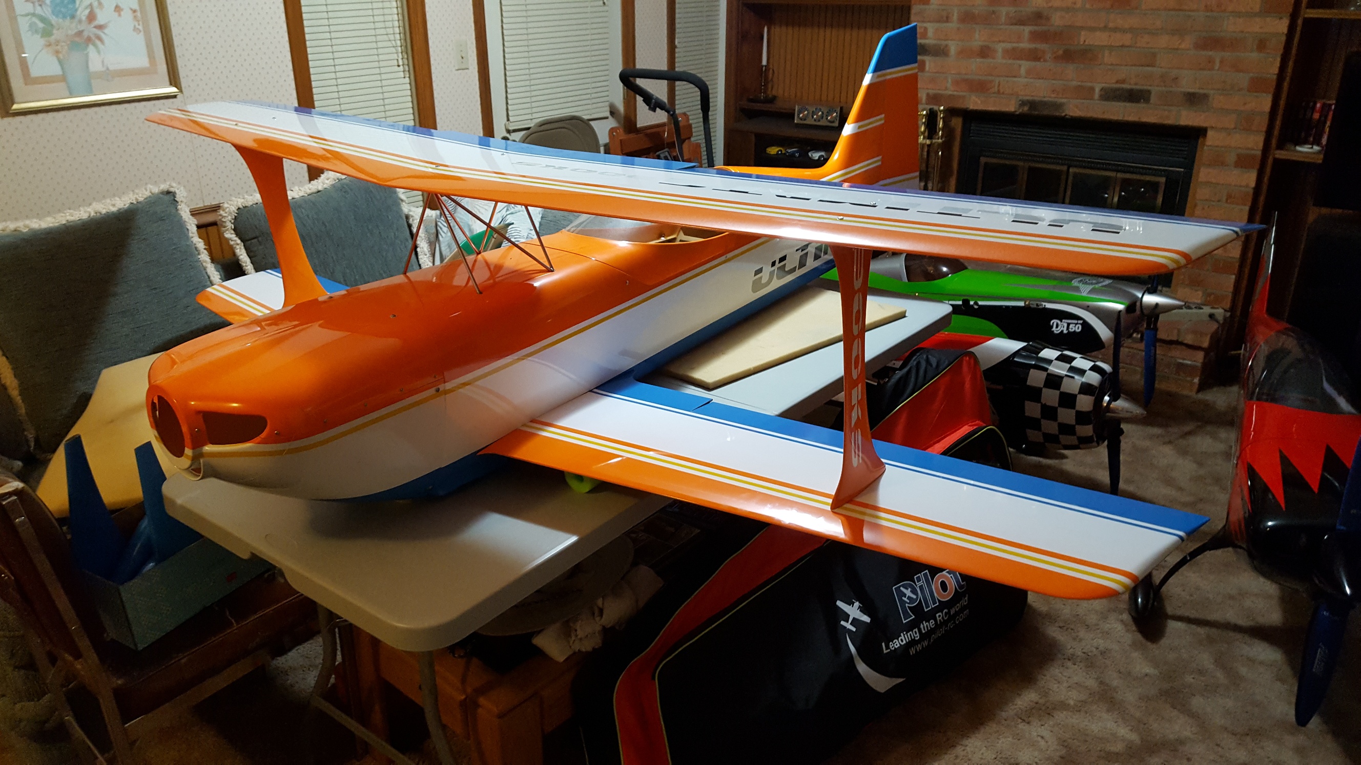

In the afternoon I decided it was time to assemble the airplane and see how everything fits, and how hard the assembly is. It went together pretty well, but the lower wing bolts to the fuselage have to go. They need to be replaced with studs and nylon nuts of some kind. Since there are no alignment pins in the lower wings the single bolt on each side does everything. Getting the wing in just the right place for the bolt to start sucks. The bolts themselves are a plastic headed thumb screw. The head is so short that when you get close to the fuse side there is nothing for you fingers to grab to tighten it. I way worried the way they want you to wire the top aileron servos through the outer struts would be a pain, but I think it will work fine, and wont be too big a pain at the field.
One thing I did decide is this thing is BIG for a 120cc airplane. :yesss:
