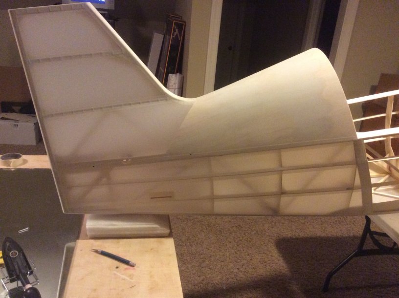

Scale MattyMatt's Exclusiv Modellbau 50% Challenger II
MattyMatt

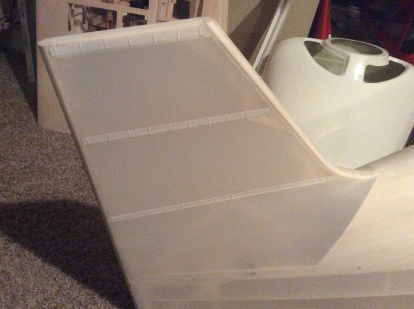

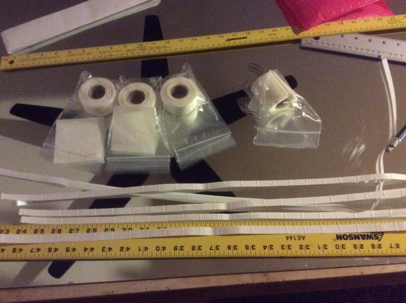

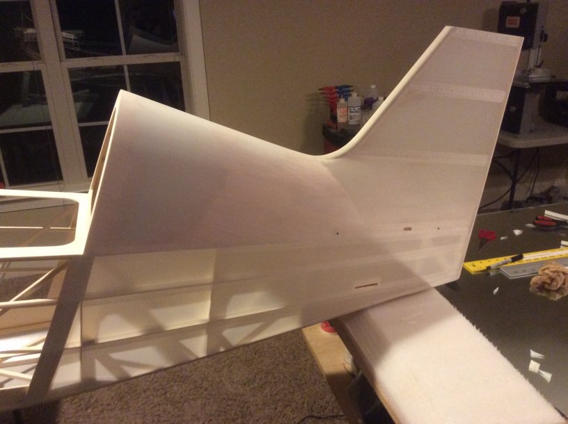

The rib stitch is the strips, where the pinking is in rolls.
MattyMatt

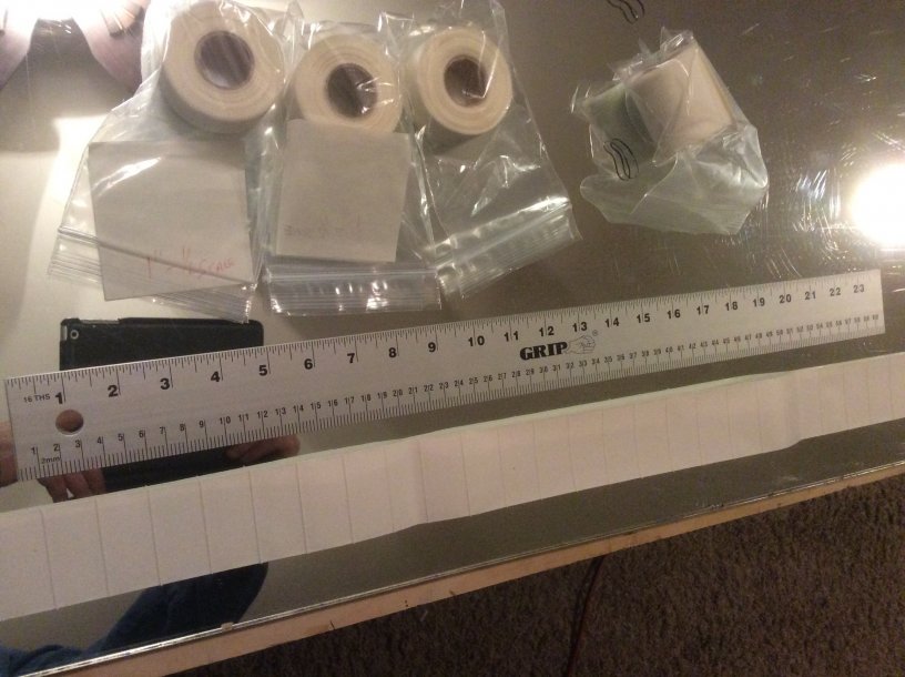

BTW: I cut all my covering on a mirror... So the picturs may look weird.
I cut a few strips 3/8" wide for the stabs.

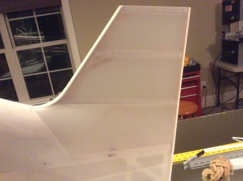

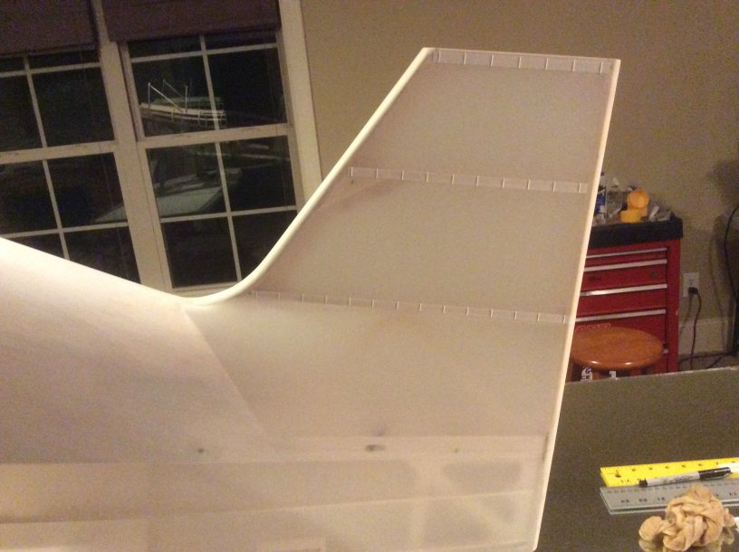

Matt....please don't take the tape around the leading edges, as it's not done on the full scale. The LE's are usually aluminum with the tape and stitching starting at the front spar and going back.
