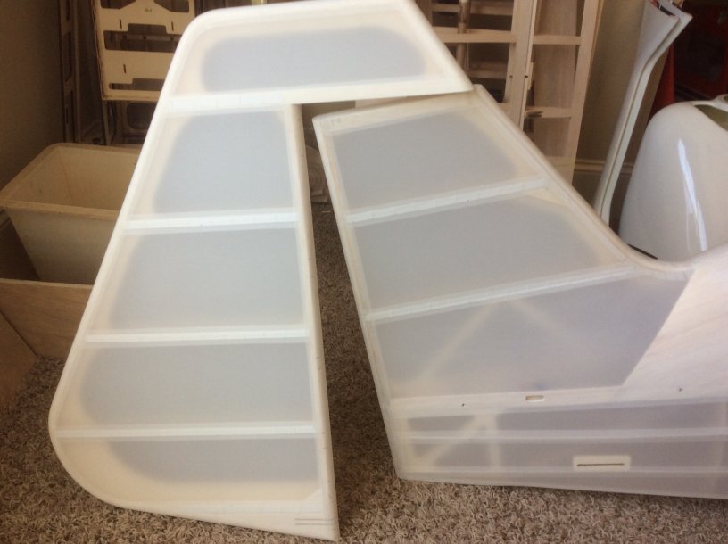

Ahhh.....yes they are taped on the stab LE's. I thought you were going to do the wings as well. Guess I should have paid more attention! Carry on....:cheers:
MattyMatt
Man.... You had me double checking...lol.
Yeah, the wings will be covered differently.

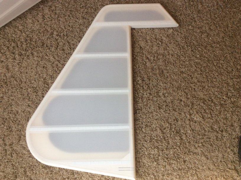

I finished up the Rudder this AM...
MattyMatt

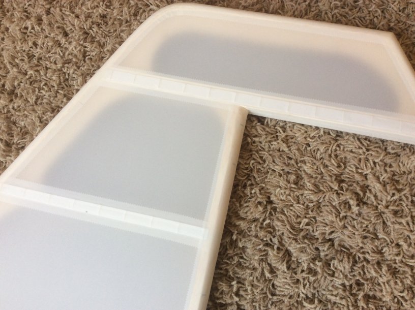

I had to make an "adjustment". The top of the stab shouldn't have stitching.
Same with the bottom of the counter balance on the rudder. Fixed, now on to the horizontals.
