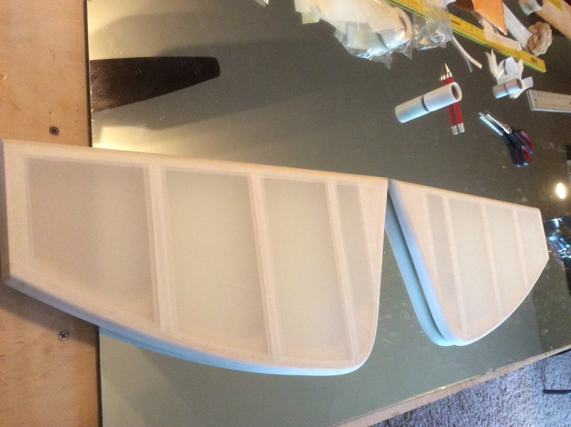

Elevators done....

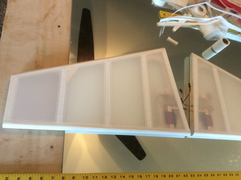

So, my plan was to cover the fuse, and completely finish the stabs. Then put the panels on the front of the fuse and mount the canopy, but I'm digging this covering work. So, I'm going to start the wings.
As Earle mentioned earlier, the front of the wings (the D tube) is aluminum and there is no seam at the leading edge. So I will be covering the wings as full scale. More or less.
I'll start with the bottom of the bottom left wing. This is with the covering tacked.

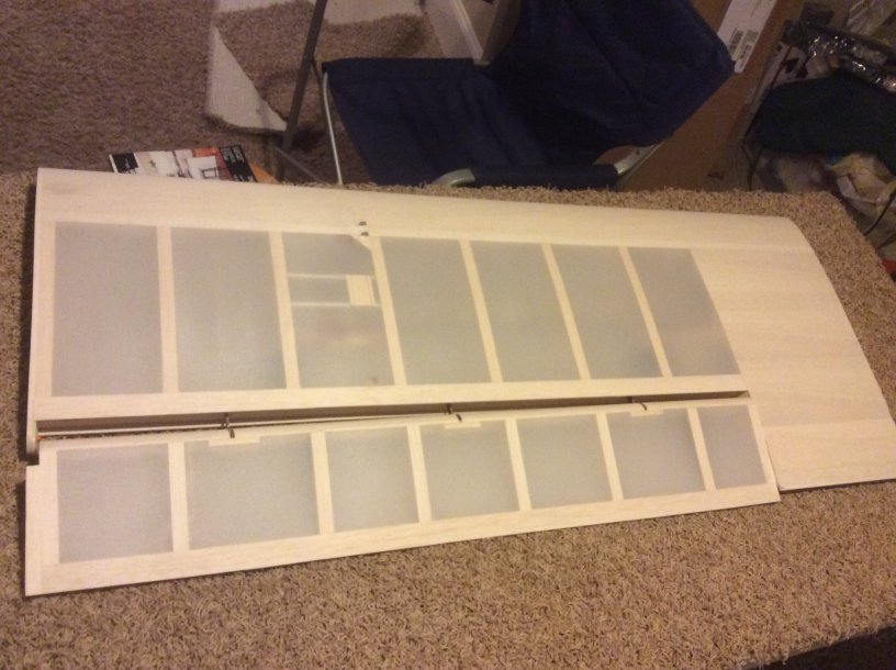

MattyMatt
Left bottom wing, stitched and pinked... Ready to paint.

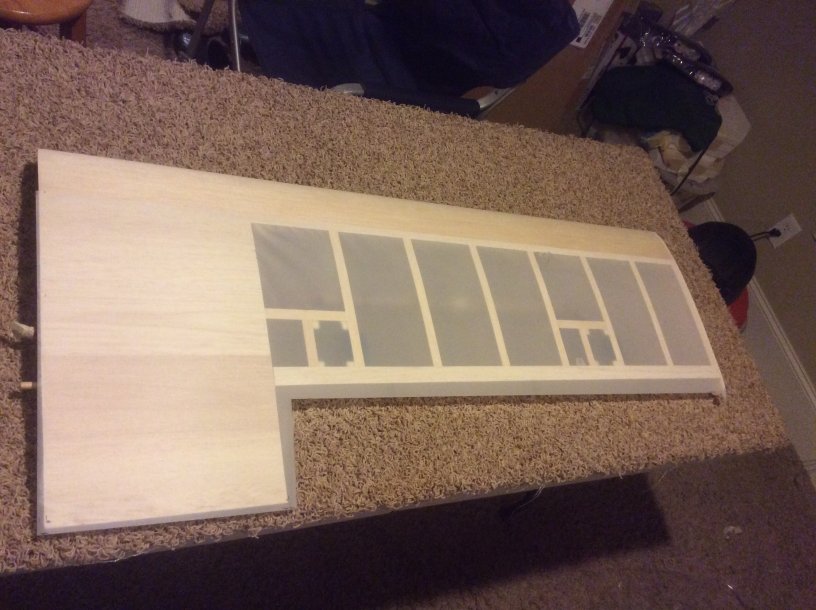

Now 3 more wings... Lol. I had to order more Solartex from Balsa USA today.
