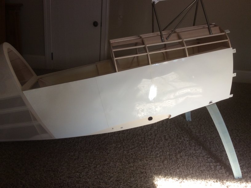

Yesterday afternoon I started putting in the fiberglass panels. Both sides are done.
I'm going to cover the firewall before I do the top.
MattyMatt
They actually do look like aluminum panels. They are CA'd in place, but will get drilled and 200+ screws then go on to hold everything in place.
